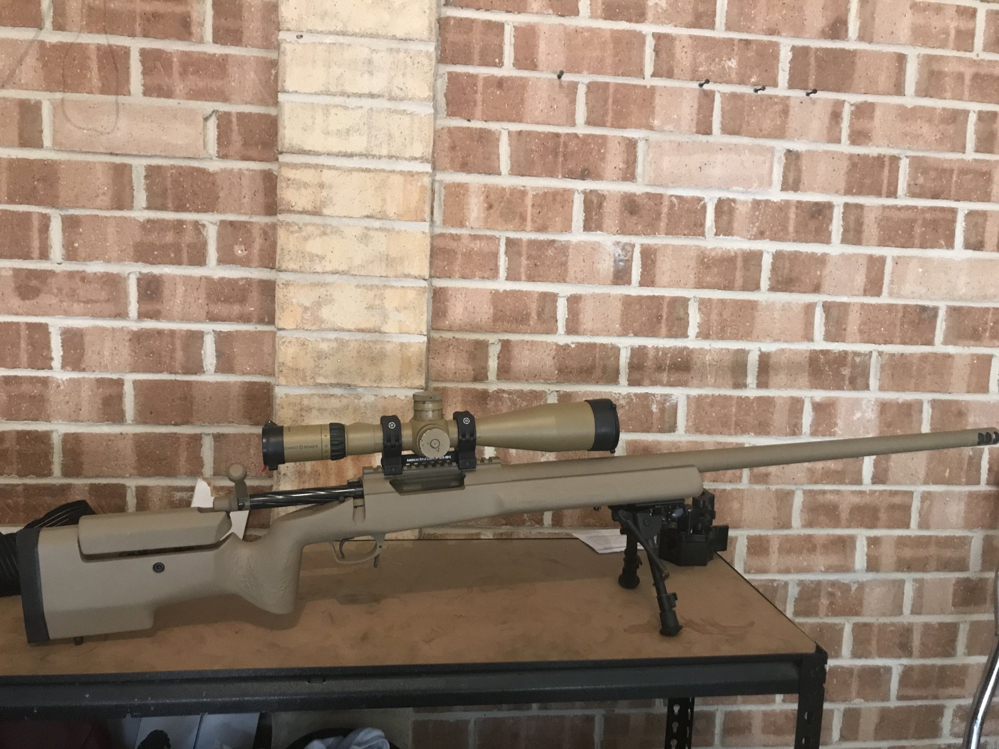

I use an ARC M10 QD-L mount. This is the low mount with 50MOA of total cant (rings are 20MOA), I don't have any issues with scope height and this rifle is zeroed at 100m.
Reactions: diverdon
I run mine on a flattop with an ADM 40moa qd base. Works great.
Your base setup sounds fine, moa is additive in that context and should work.
Regarding your ring height, manufacture numbers are from the rail to the middle of the rings. A 56mm objective is about 2.2 inches, half that is 1.1 inches. Assuming you're running it on a flattop rail that'd leave you about a quarter inch on the bottom if you run 1.35" rings (probably less, because the scope housing must be larger than the objective in order to contain it, and there's a bit of a cant because of the moa), but it's definitely adequate spacing.
However, if I'm not mistaken, on an XLR you don't really have to worry about the objective hitting the rail since it's not a flattop. You maybe might want to opt for lower rings, depending on how your cheekweld is setup. I'm not certain though.
