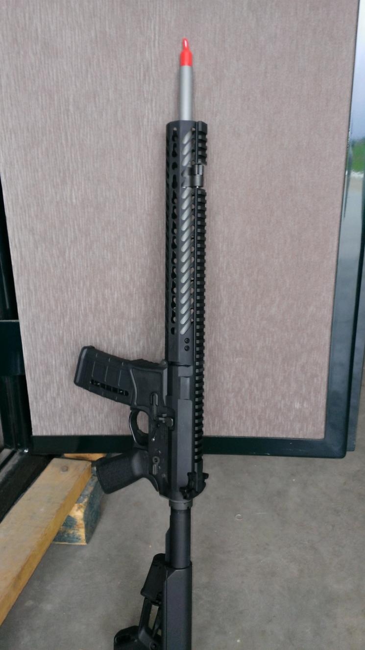

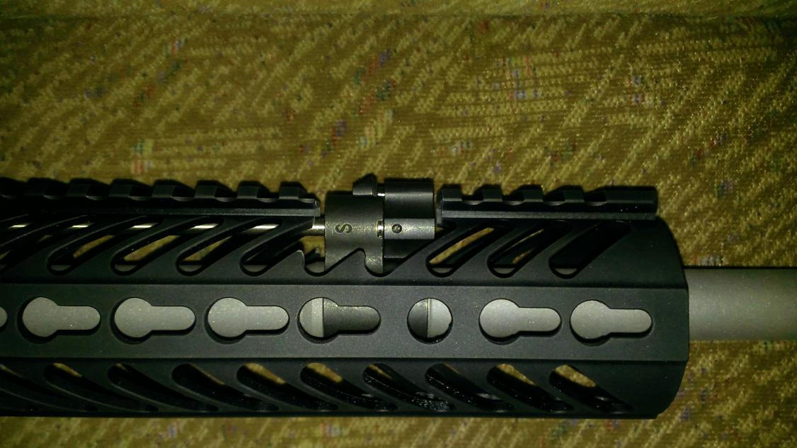

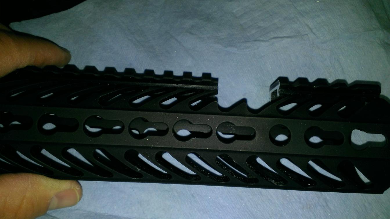

Well after learning the mcsr rail does fit on a standard upper I ordered the 12 mcsr. Just got it in the mail last night! Was so excited I snuck out to the shop once the family was in bed. Pulled out the hack saw and went to town! I was thinking I have lost mind when I was cutting on a nice new rail. I then took a file to clean it up. Overall I am very happy with how it turned out. I test fit everything just to make sure I cut in the correct spot and will post some pics once I get a chance.
here is a few pics
I got side tracked on this project, but I'm picking it up now. Grohs02, two questions, please. Did you simply slide the modified MCSR over the SwitchBlock until it was able to drop into place and slide onto the barrel nut or was there more to it? Second with it cut as closely as yours (which looks great), can you still get the SB wrench onto the SB? Mine seems to require the wrench a lot.

No I had to slide the switch block and rail on at the same time. I lucked out and the set screw on the SB lined up with one of the holes in the rail, however the pin was tough to install but with enough messing around I got it. I do not have the SB wrench so I do not know if it will work. I hope this helps let me know if there is anything else you have a question on.
