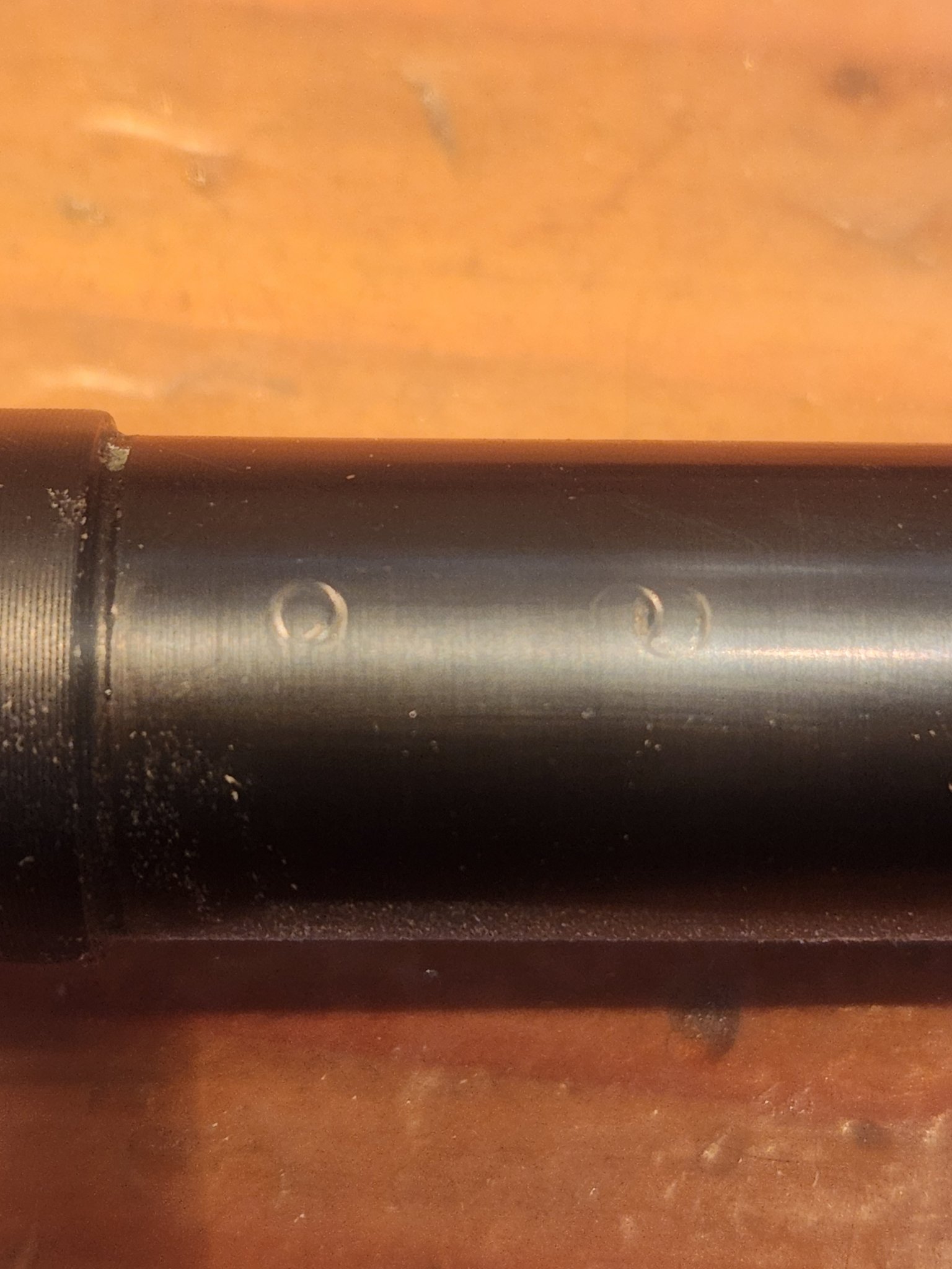

Dimple or no dimple, the grub screw or serrated grub screw that gas blocks come with find a way to bite sufficiently into the round barrel. Is a dimple or two dimples better? In theory absolutely, especially if you have an exposed gas block or GB/front sight post that can catch on things. That said, I've got 4 un dimpled barrels in my dead barrel pile that never once had a gas block move.
You can see this one had two different gas blocks, with different screw spacing. Hence the reason many dimpled barrels are only dimpled at the rear.
Reactions: msgriff
Very good explanation. I am a retired Structural Engineer. Forgive my over-thinking. I can see the mechanical engagement of the 2nd screw
