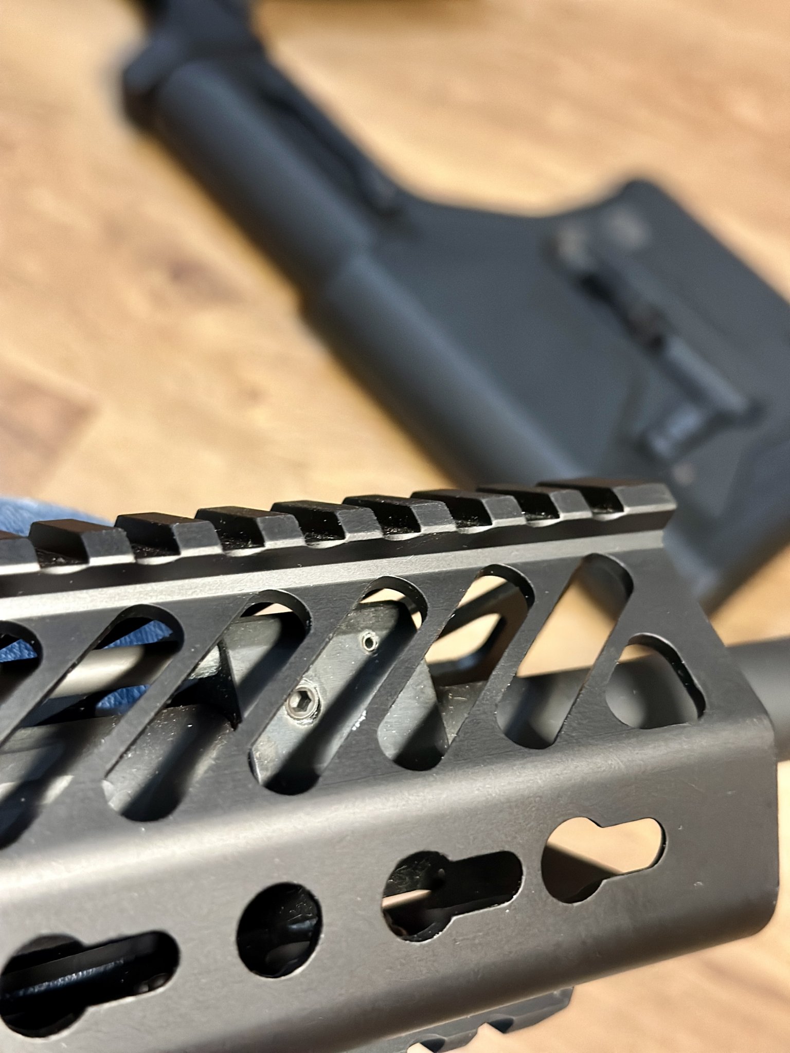

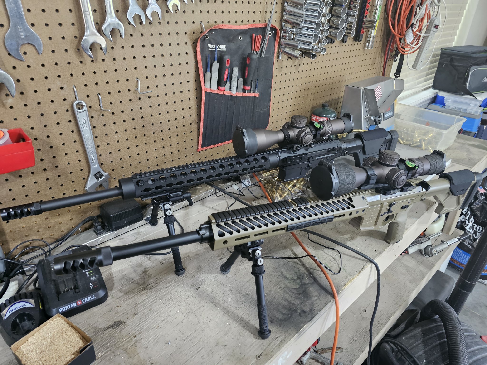

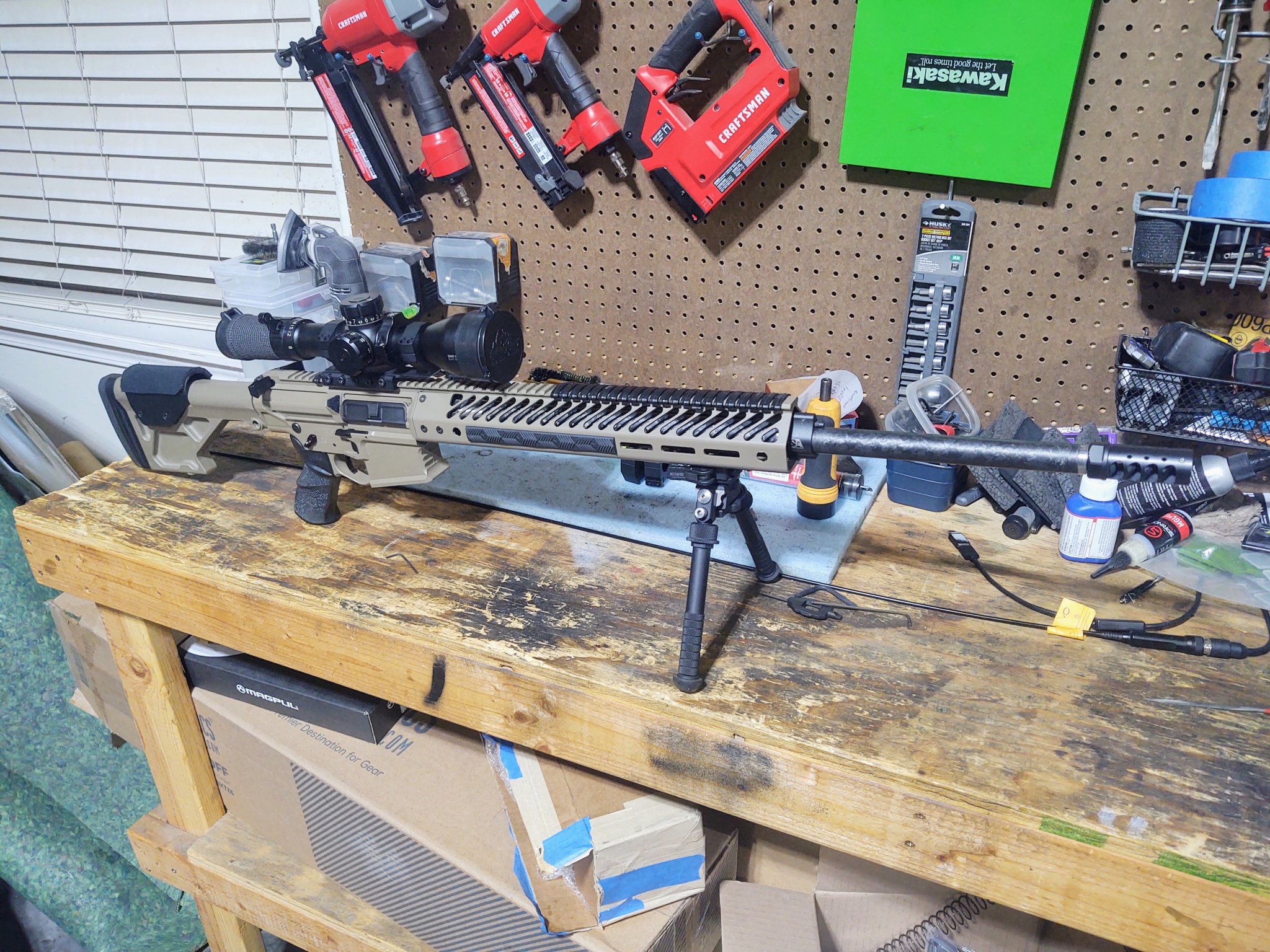

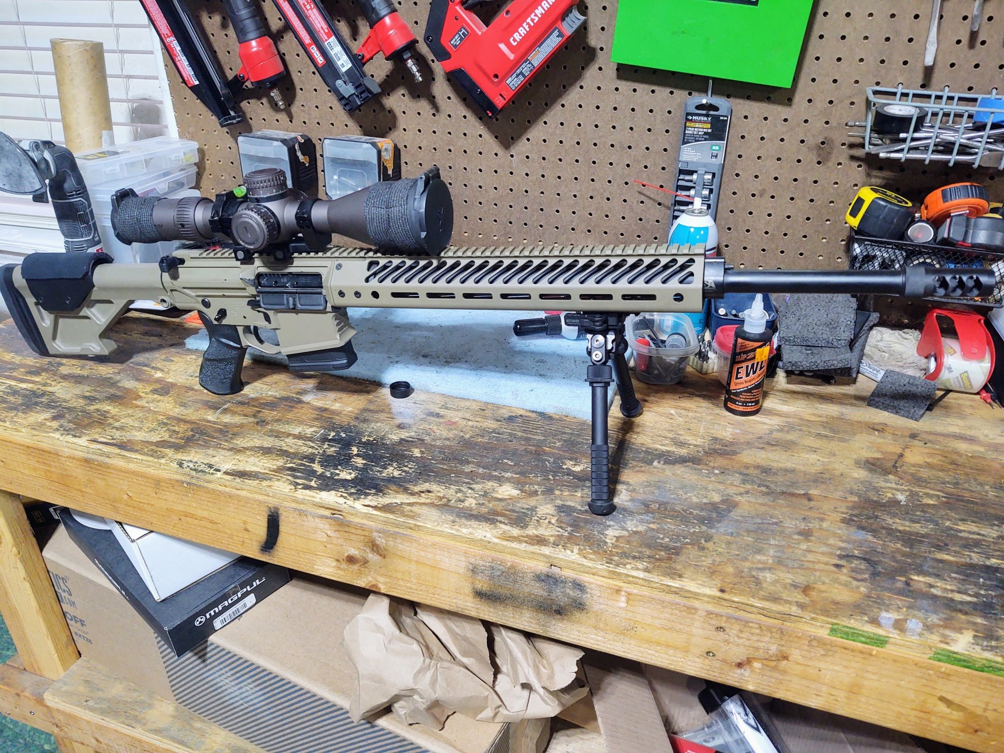

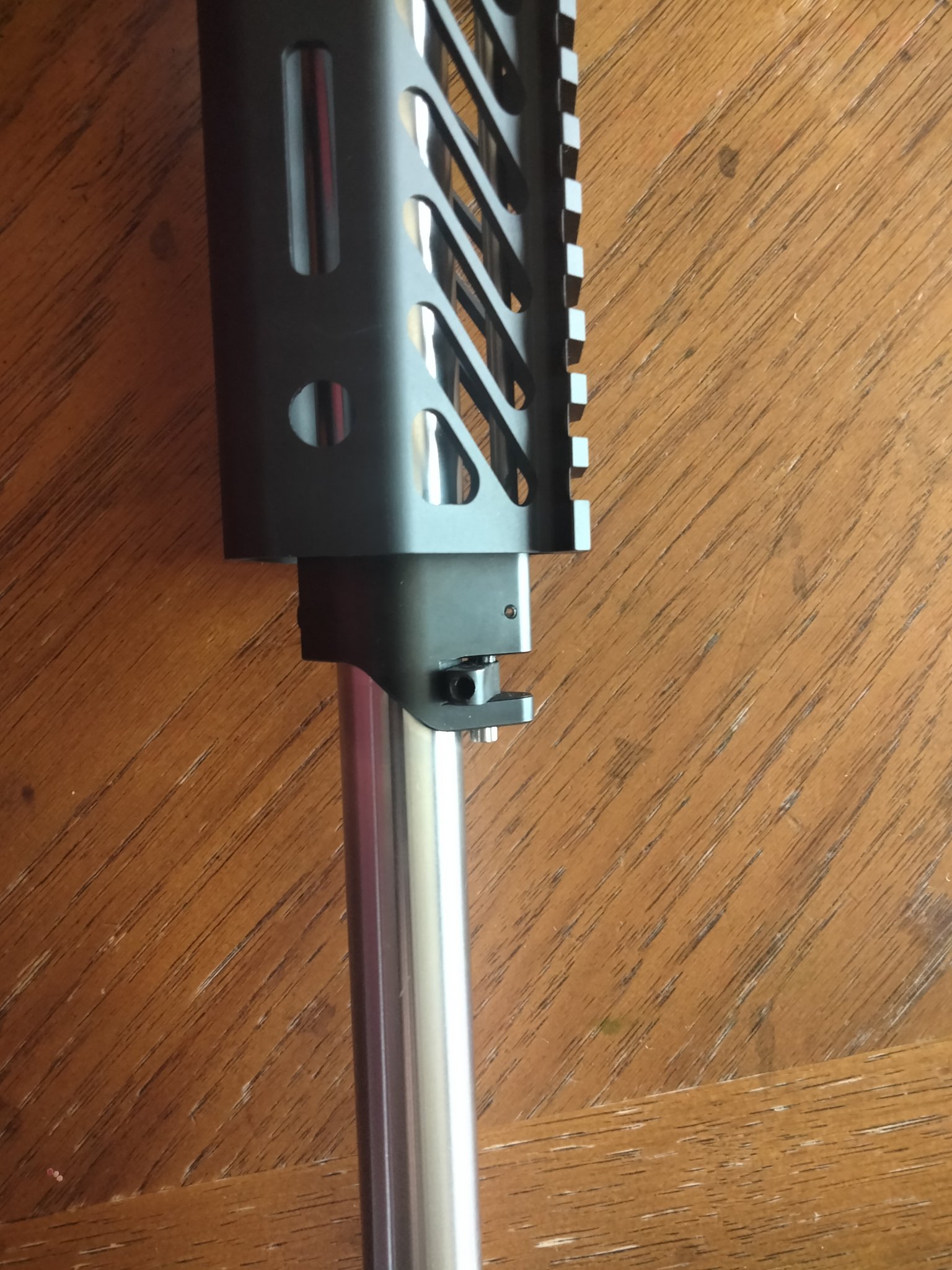

I have an SP10 (not 10M) with the heavy barrel profile and the extended gas system. The barrel is 0.85” at the muzzle and also at the muzzle end of the gas block. My gas block extends 1/2” beyond the handguard. I attached pics showing gas block extension. I also have the select adjustable gas block with the short lever. The barrel is a Rock Creek 5R stainless steel barrel, 22” long. I have never had better customer service from anyone and I’m 65 years old (meaning I have had many experiences with customer service). I don’t think they have a huge staff and I think their products are in high demand. It’s a nice problem to have for them. They will call you back in my experience but it may take 2 days. If no one called you back, that won’t meet their expectations. I attached a 3rd picture which is a screenshot of an SP10M gas block. The rifle is owned by Matty Nelson who is the marketing director for Seekins. It’s in a Utube video of him describing how the select adjustable gas block works. I can‘t tell how far forward the gas block extends past the handguard? So I don’t know if it’s the same as mine.

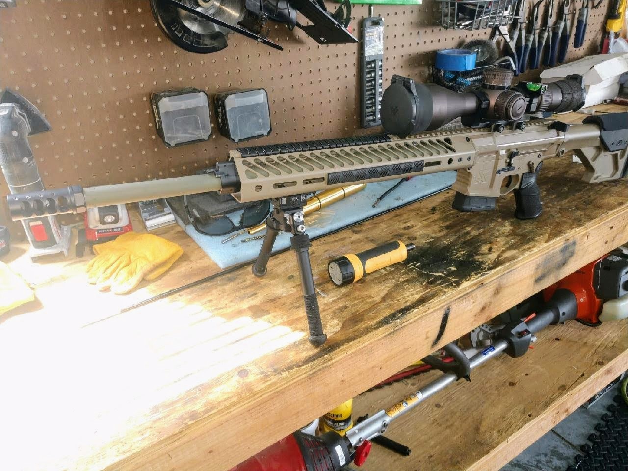

Happy to post pics of mine I bought it in December off euro optic the trigger feels way better that the one in my local scheels. Not sure about barrel.
Pics are always welcomed. If you have a dial caliper, measure the OD of barrel at muzzle. The standard profile barrel is 0.75” OD. The heavy profile barrel is 0.85” OD. From what I understand, the longer rifle length (either +1.5” or +2”) gas block will protrude past the end of the handguard. The standard gas block is flush with the end of handguard. I’m not sure how to tell the +1.5 from the +2. Mine extends 1/2” past the handguard but I don’t know if that’s +1.5 or +2. It’s just not flush with the handguard.

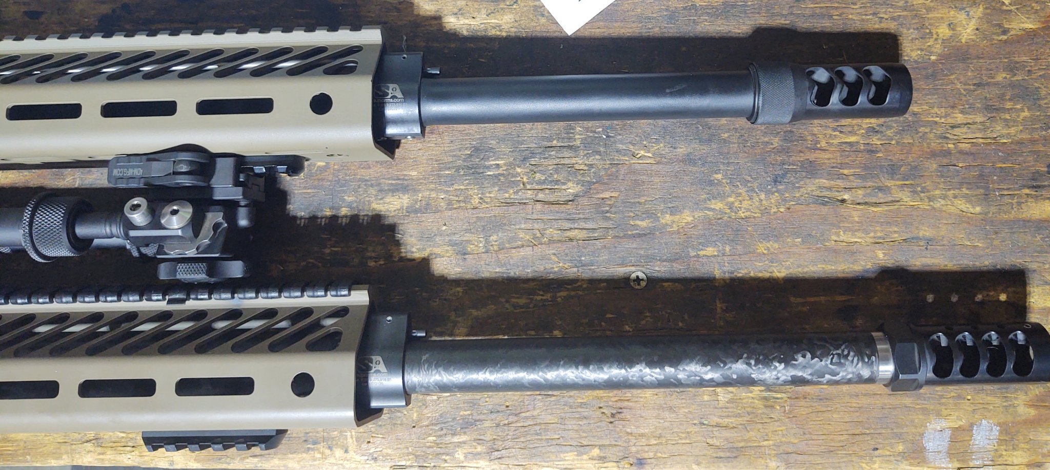

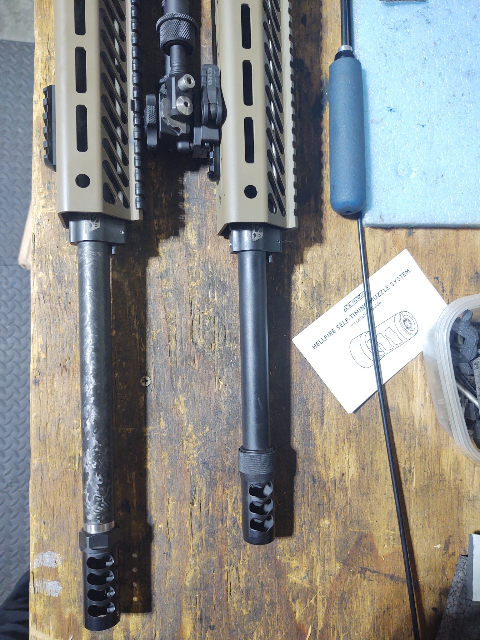

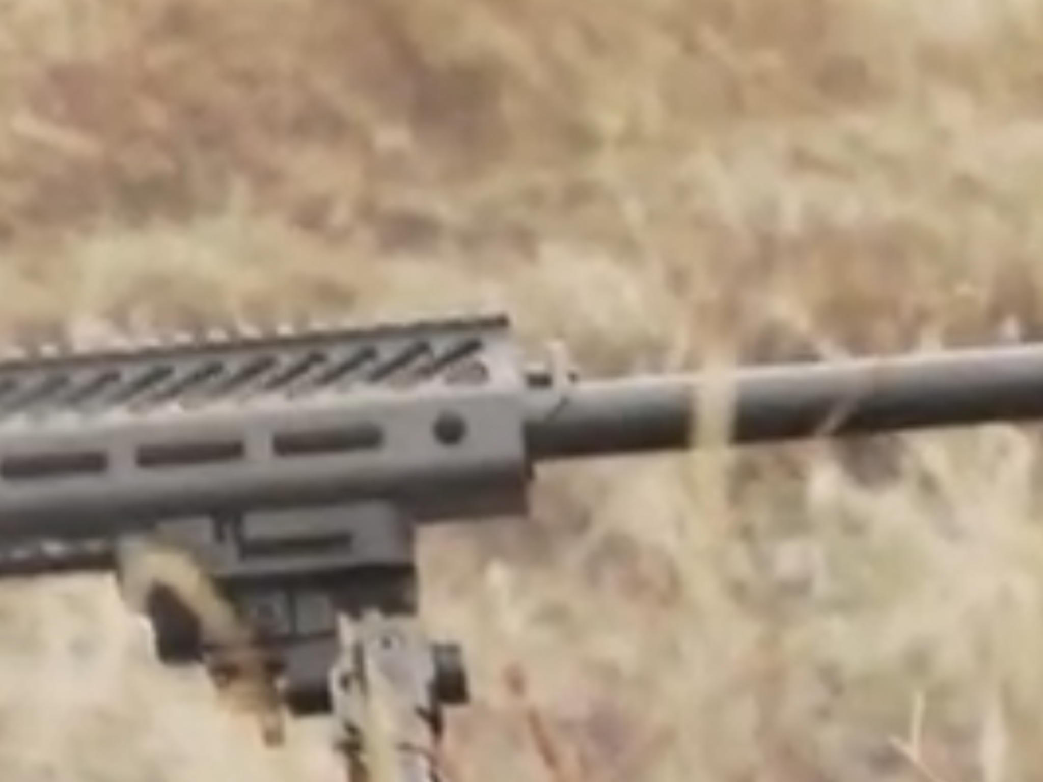

You have the +2
The +1.5 is flush with the end of the handguard and the +2 protrudes out a 1/2" also making the switch lever adjustable GB easier to access.
These are all +2 systems.

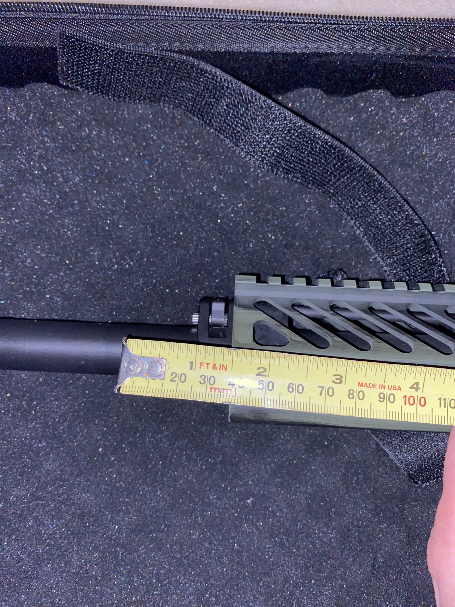

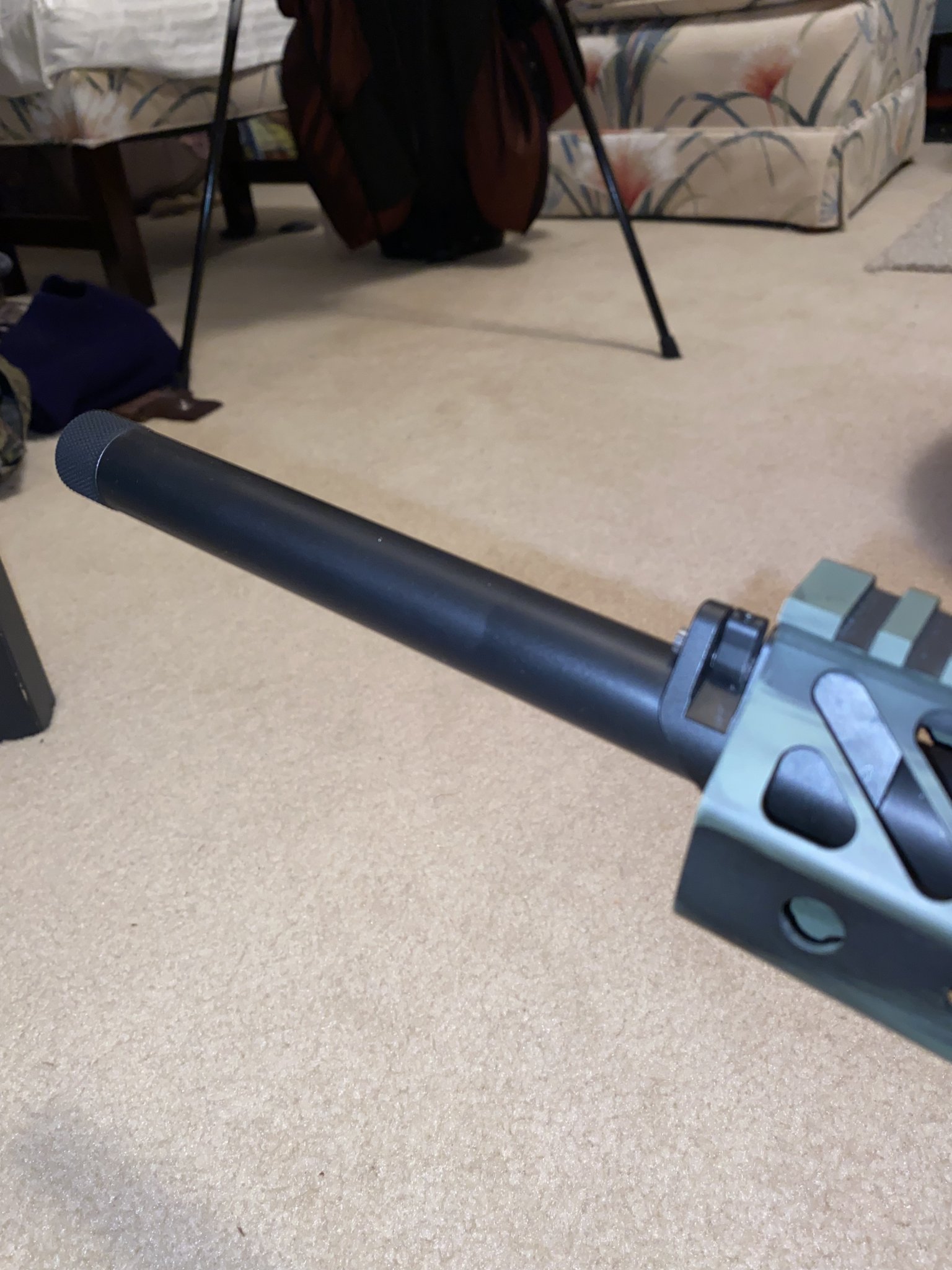

You have the +1.5".
Here is a +2" with the same gas block.

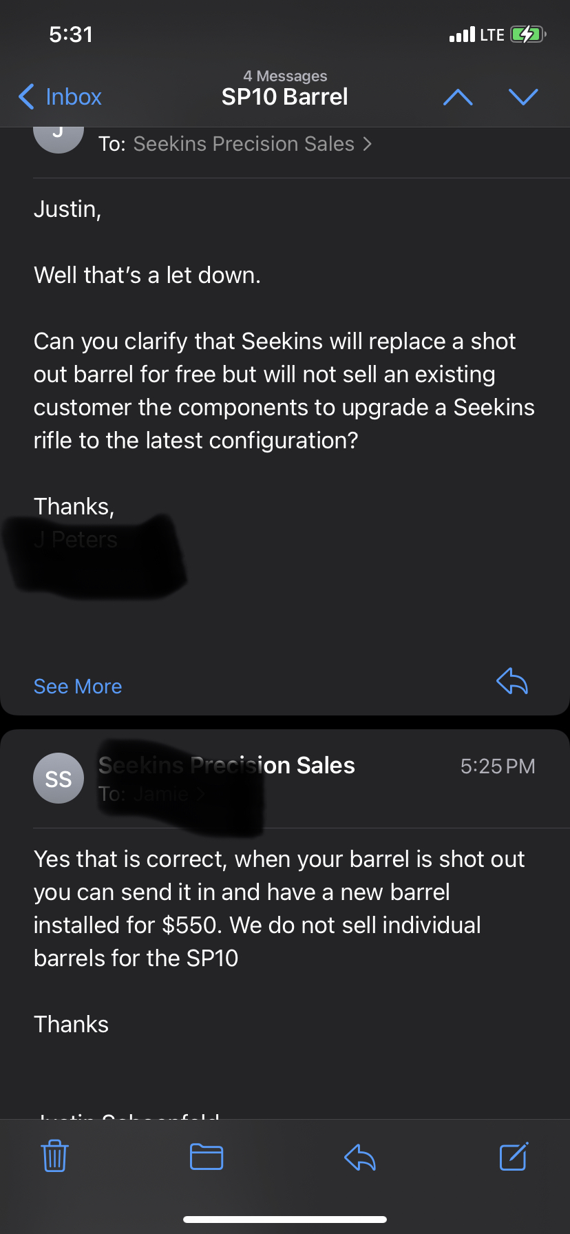

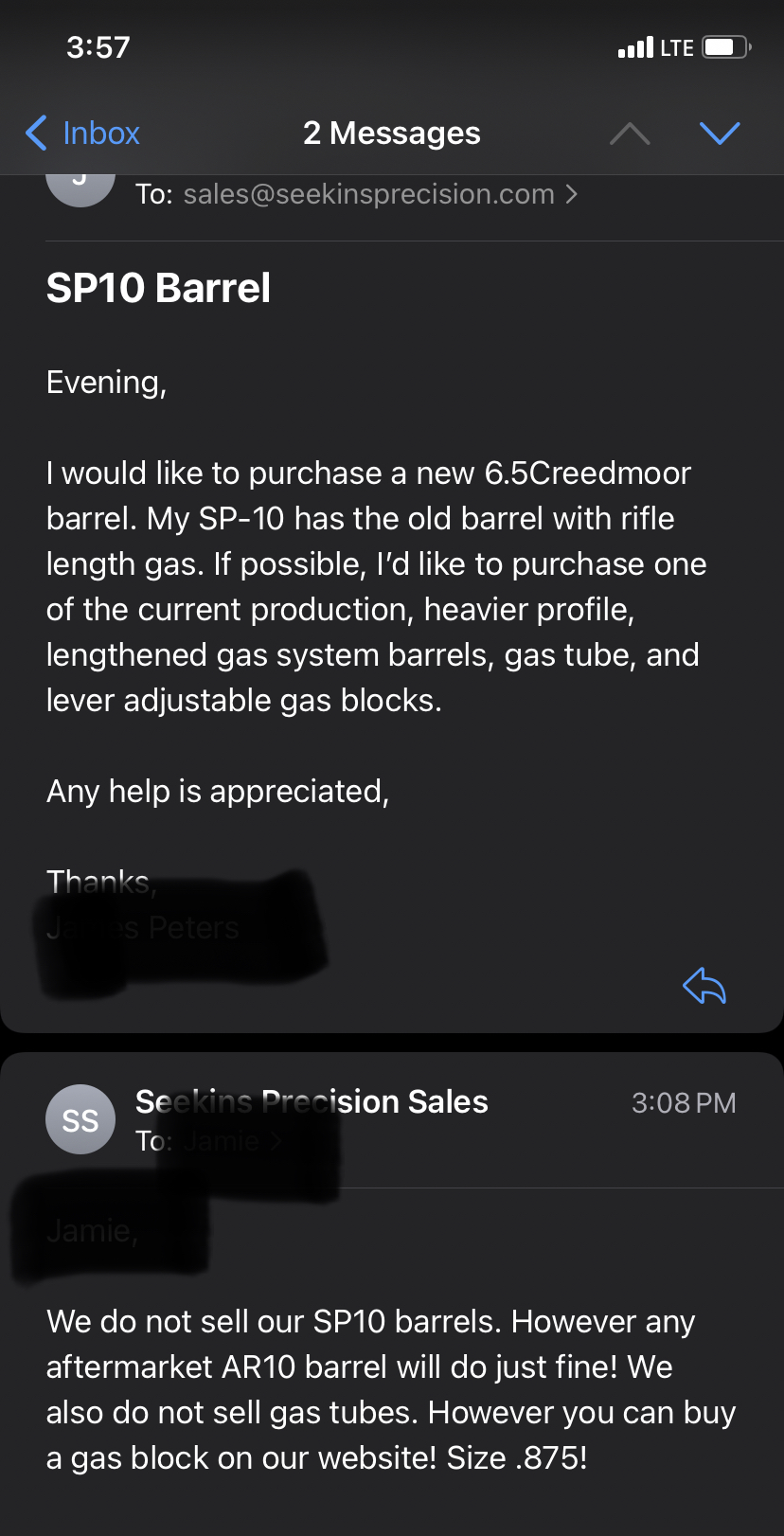

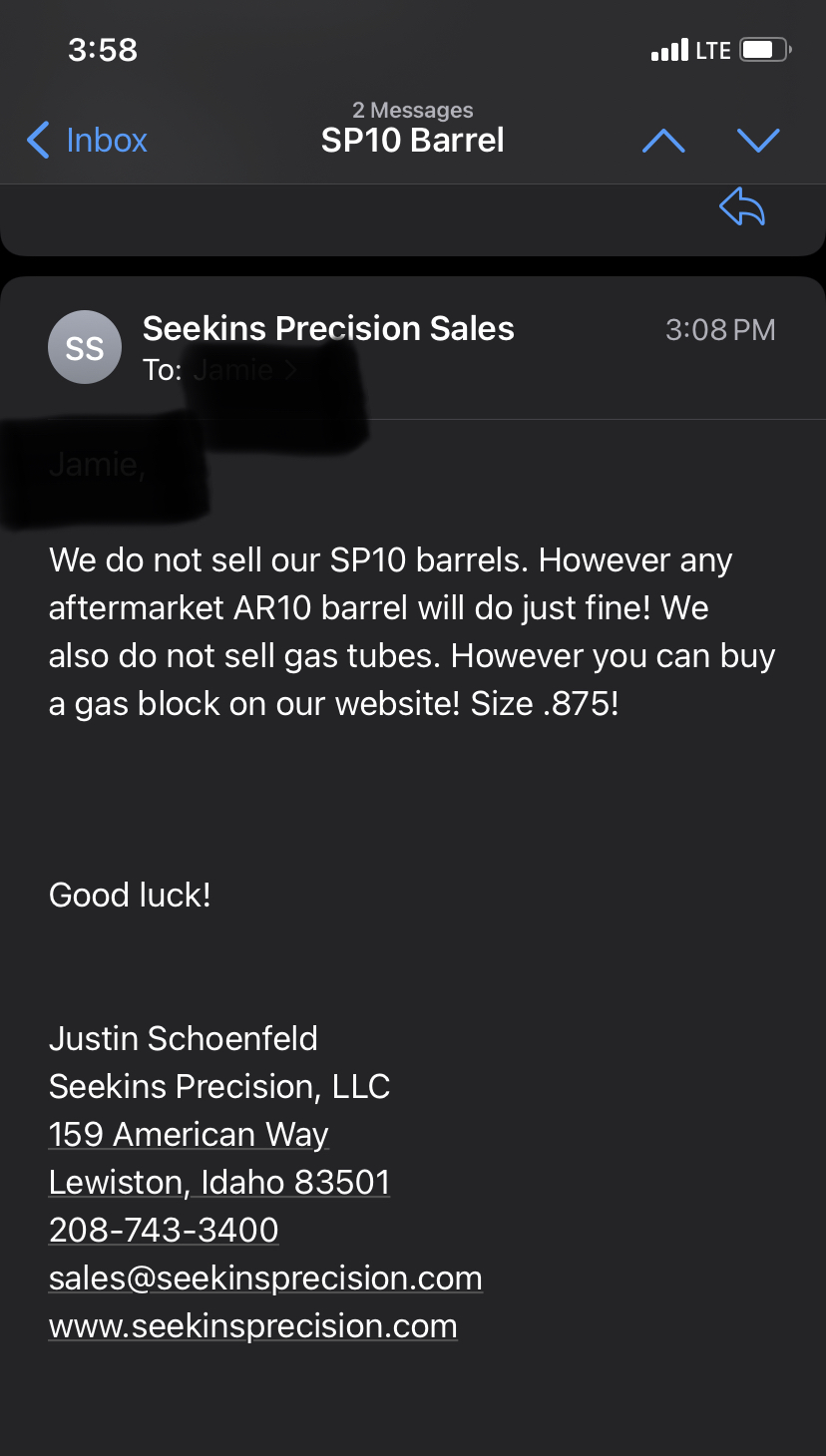

Seekins finally replied to my email. I’m still not impressed. This is the second email since they never responded to the first.
Buddy says use any ol AR10 barrel. Does he not know that their guns use DPMS pattern barrels, bolts, etc? Oh well. I like the gun but doubt I’ll be buying any more of their products.
So much for that stellar customer service. Maybe I should have fried it and sent it in for warranty.
ETA latest emails.
Oh well.

So I brought this post to Seekins attention. First and foremost Justin is the FNG and was only replying as he was instructed about available inventory.
As for the reply itself, yes he needs to work on his bedside manners.
Due to the current SP10 Rifles using the same barrel contour as the SP10M the allocation of available barrels to the general public has changed, and has affected current inventory.
What Justin said is true, the SP10 can be easily rebarreled with a wide array of barrels that are available.
@Jsp556 if you would like me to rebarrel your upper id be more than happy to discuss it with you. Just cover parts and shipping.

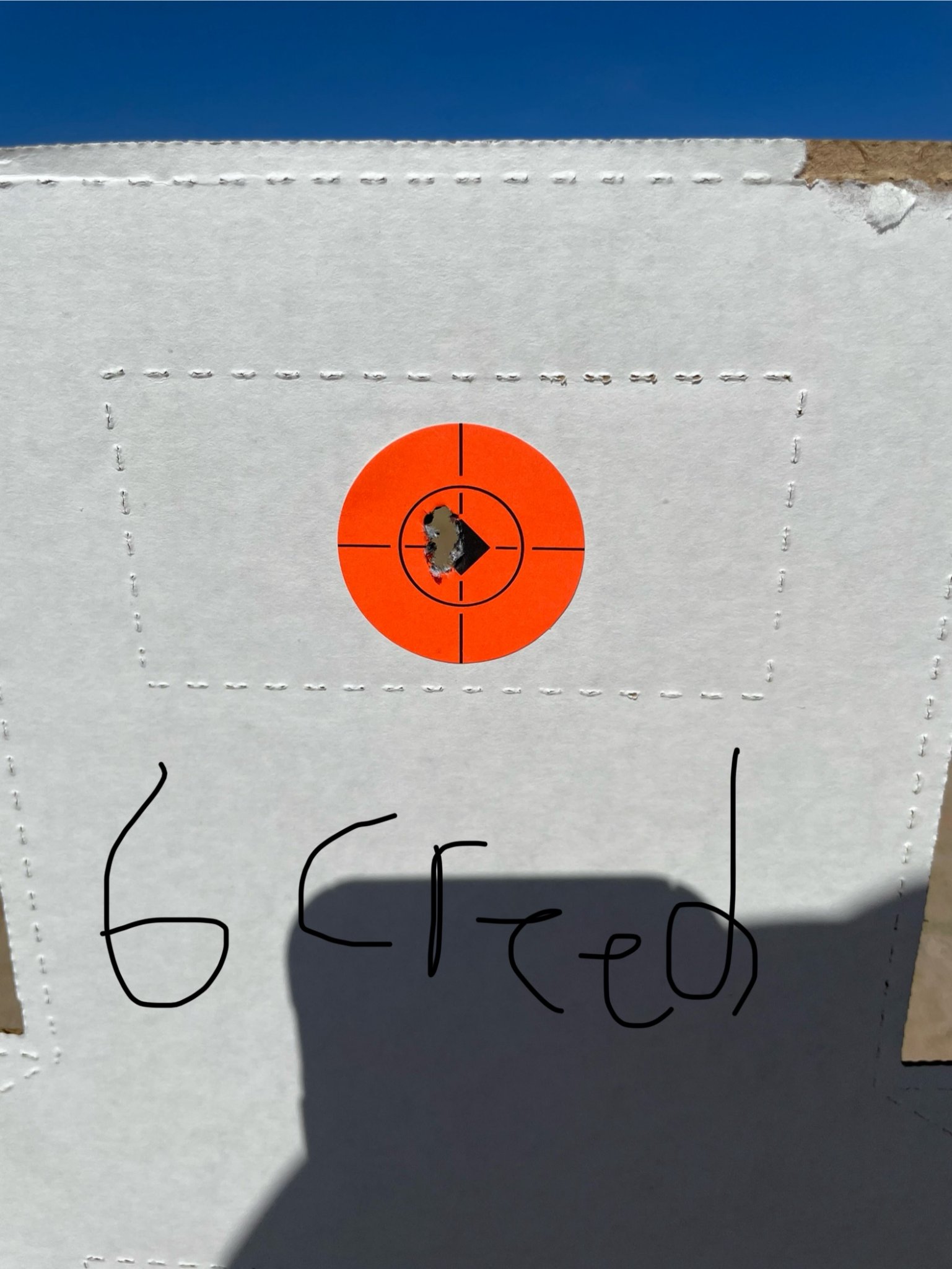

Here are some results with my sp10 in 6 creed.
100 yards 3 shots factory ammo from the prone. The circle is 1.5inches.

Nice shooting. Mattman215, are you shooting off bipod or front rest like Caldwell or front bag? I am new to Bipods and while my vertical shot dispersion is good, I get lateral dispersion much worse than vertical from a bipod. I generally shoot 3 shot groups also but not exclusively. I don’t compete and mainly hunt so my main interest is the first shot. Since I’m not claiming to be a professional, I feel like any more than 3 shots is just testing my human repeatability rather than the rifle’s capability. I understand the rifle heating up can affect POI, and in a PRS type environment that could be a big deal. And if I was doing things like that, I would shoot 5 and 10 shot groups. If I can shoot 3 shot , 1/2” groups at 100 yards with a gas gun using factory ammo, I’m tickled.
I shoot off both bags and bipods I think that group was bipod. A good stock/chassis that is properly bedded poi should not change from bipod to bags but if it does I would say just shoot it how you hunt with it. I like 3 shot groups and could care less what other people say ha
