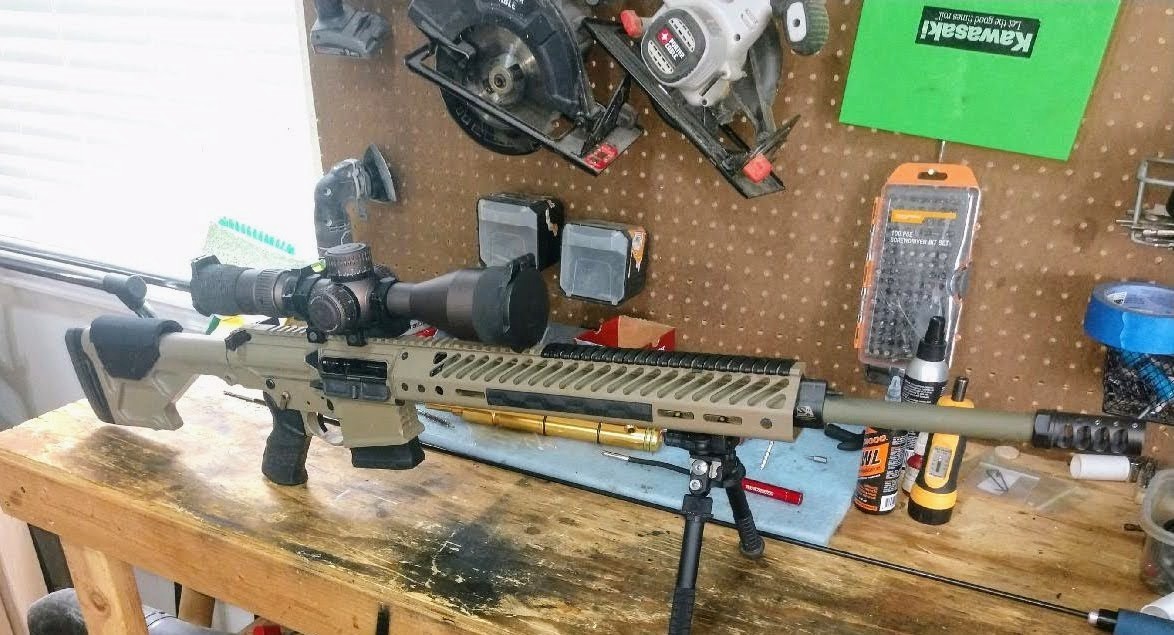

    Starting with the basic SP10 rifle as it came from the Factory with the standard rifle length gas system.
    First with the bad.
    Unfortunately the version I received had the Rifle Length Gas and no matter of fine tuning with the Gas or buffer weight could fix the abuse it played on the brass and crude cycling and bolt bounce that started premature wear on the rear of the bolt lugs.
    The OEM Timney trigger had substantial and very noticeable creep when doing a slow controlled trigger pull so I replaced it with a TriggerTech AR10 Diamond. When I first received the rifle it had a bent gas tube that was binding inside the gas key of the BCG. I didn't care much for the barrel contour after the .750 gas block journal it would step down to .730 to the muzzle and seemed to suffer from poor Barrel harmonics and substantial barrel whip.
    After encountering these issue one phone call to Seekins they completely revamped the rifle no questions asked with the exception of the barrel as it was thier current barrel offering and it was still shooting satisfactory, but bar none Seekins Customer Service is one of the best in the industry.
    Now for the positives.
    The Receiver Set and handguard have been phenomenal to date and after several thousand rounds the receivers still lock up tight with absolutely no slop. The 15" Handguard is perfect for shooting from barricades and fits a Arca rail perfectly.
    The ATC Muzzle brake was surprisingly effective with maintaining sight recovery.
    Out of the box as it originally came it maintained .75 MOA with all Harnady ammo but had unexplained flyers.

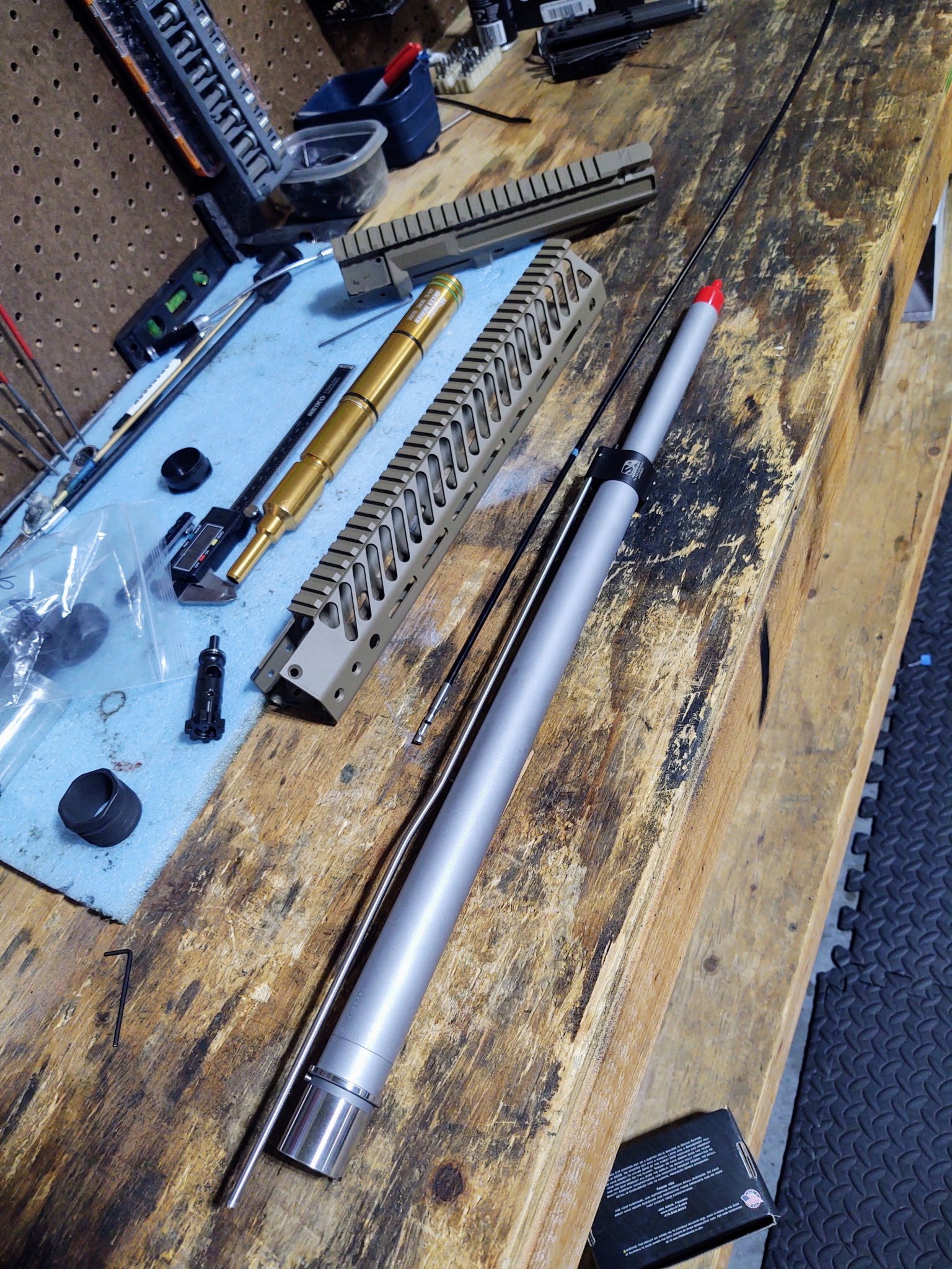

    At this point I decided to pull the barrel and BCG and replace it with 22" Craddock Bartlein with the +2 gas system headspaced to a JP Bolt, APA Gen3 Little Bastard adjustable muzzle brake and a Lantac Carrier with the oversized rear boss and forward facing gas vents and a SA AGB. The end result is the softest shooting 6.5CM I've even owned.
    The results were nothing short of spectacular.

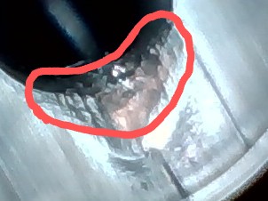

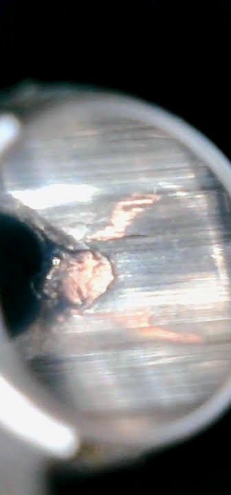

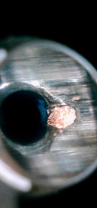

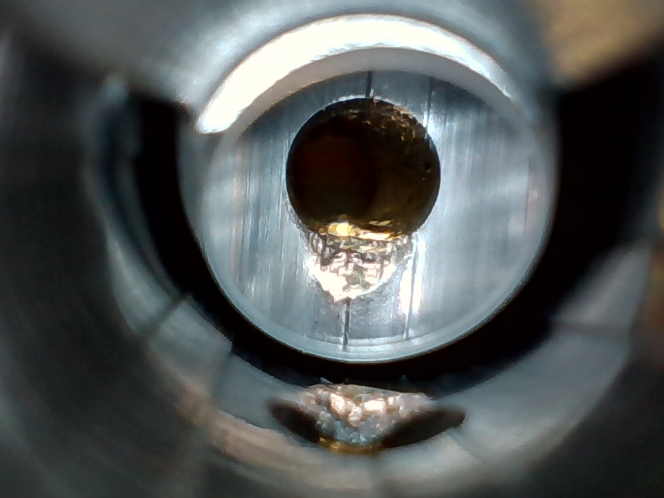

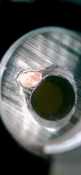

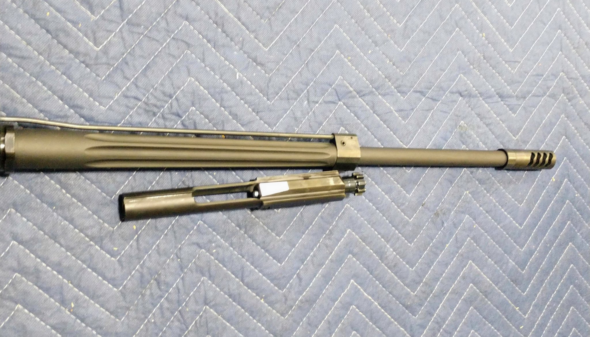

    But unfortunately the gas port in the the Craddock barrel took a catastrophic turn for the worst and developed a burr at the gas port that was unrepairable.
    After contacting Craddock the current wait time for a barrel replacement would of put me 12 months out, but again with exceptional customer service Paul issued a full refund.
    At this point instead of waiting 12 months I opted to go with a 24" Proof Research Carbon Fiber barrel that has shown to be a solid performer right out of the gate the PRCF barrel shot .5 MOA with Factory ammo.
    After a healthy 200rd break-in the PRCF has become one of my top performers. I initially had some hesitation with how the barrel was performing with the groups opening up especially under high heat. It turns out is was just mirage causing sight disruption the illusion of the groups opening up.

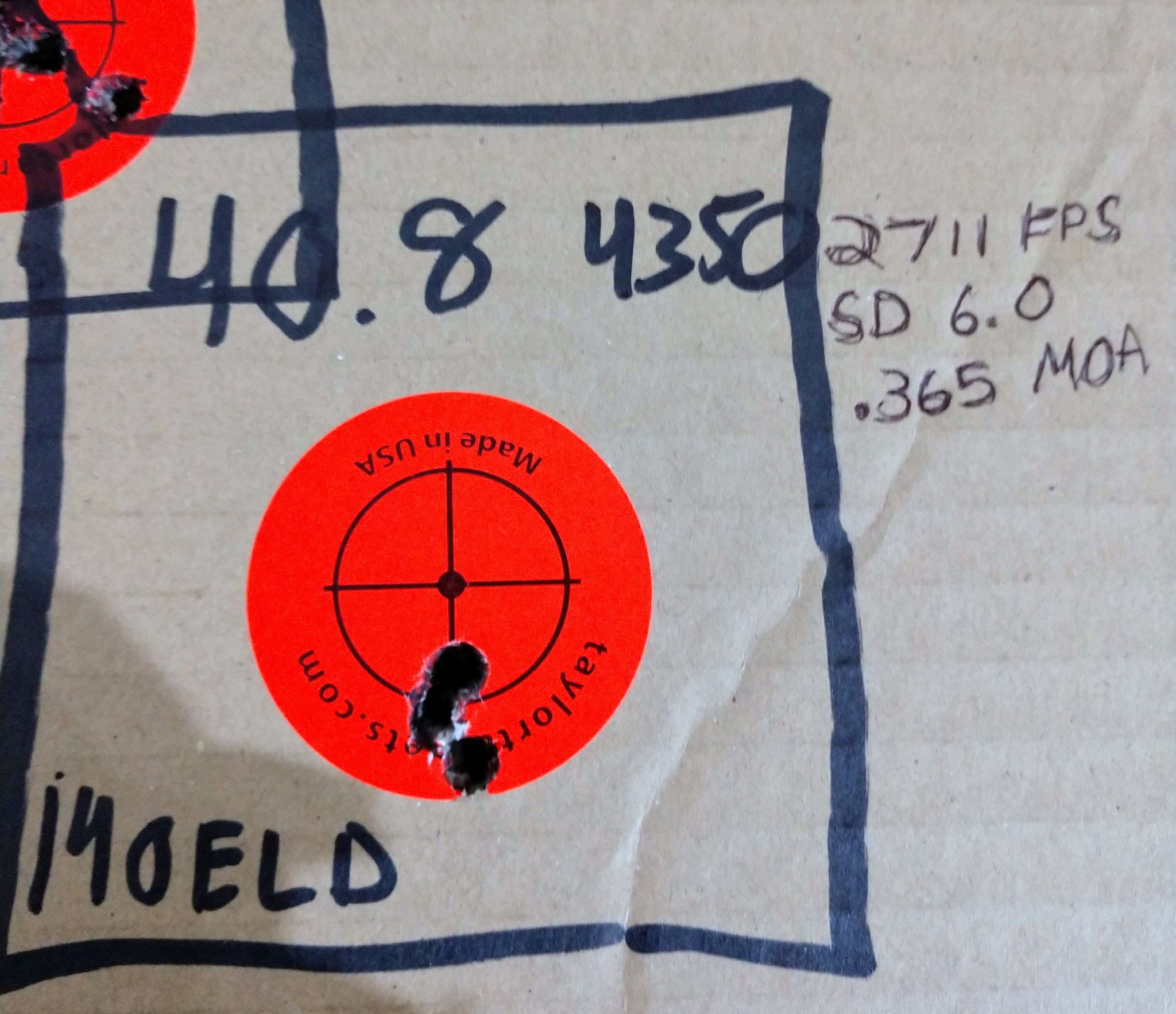

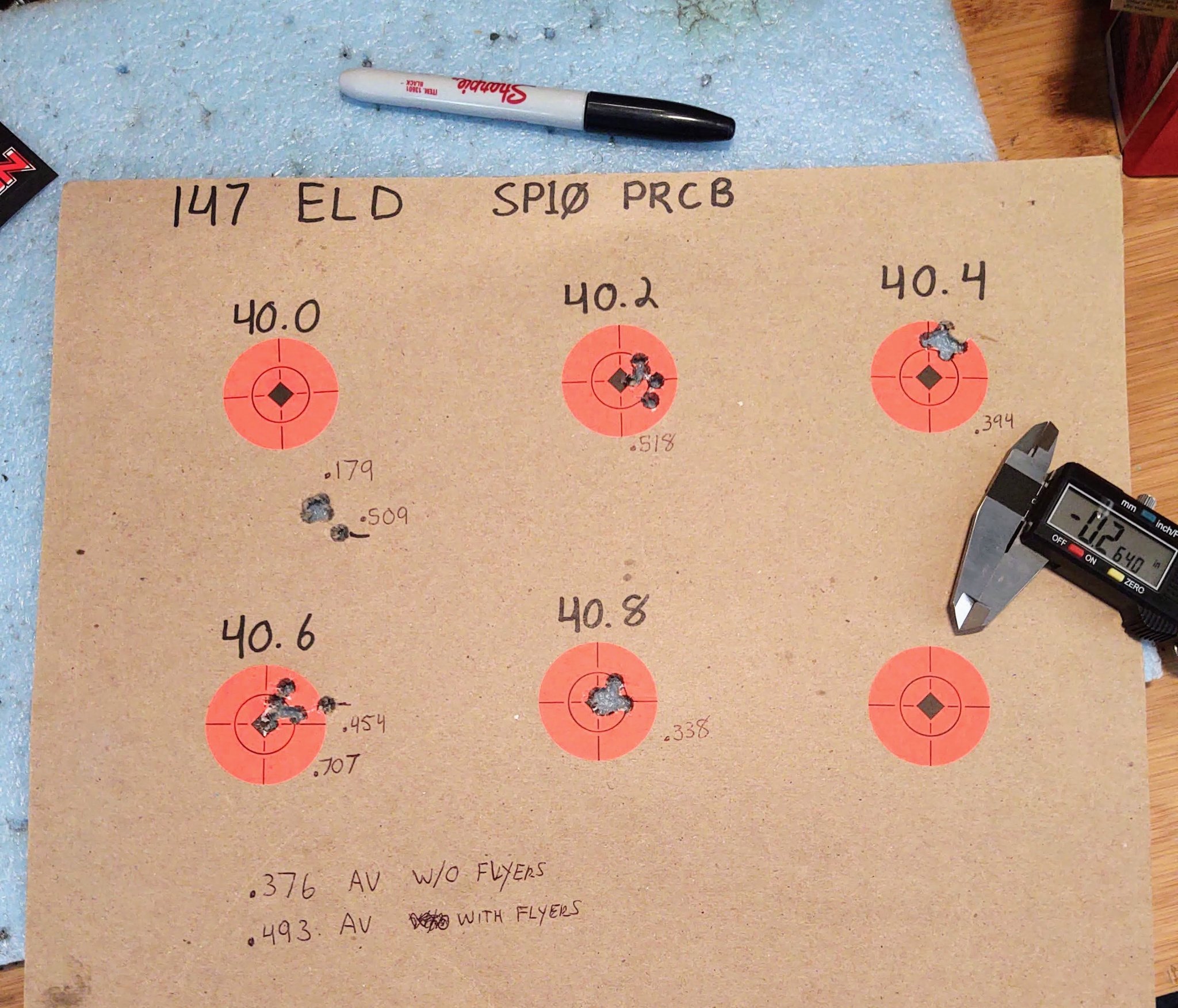

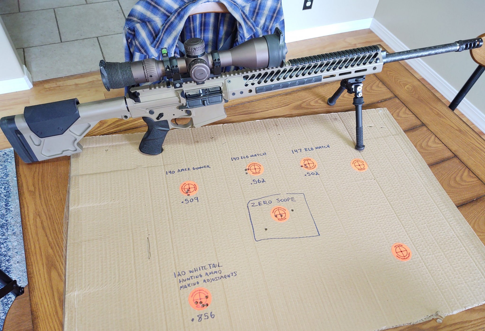

    First round of load development.
    The below groups were shot today solidifying several load options that are all Sub .5 MOA
    The Seekins SP10 has shown to be a true performer no matter what tube I install.
    To date Seekins has rectified the earlier discrepancies with the addition of a + 1.5 Gas system and a updated bolt. I have absolutely no reservations recommending the SP10 to any shooter.
    Thanks for reading.

    Good info on the Seekins rifle and the various barrels you've had installed.
    With the burr in the gas port of the Craddock, was the barrel still shooting well? I ask because I have a Compass Lake barrel in 6 ARC that has a gas port that looks nearly identical to that, yet it hasn't lost any of its accuracy. And according to the response I received from Compass Lake, the erosion is normal and acceptable.
    Yes the groups opened up to around 2 MOA, gas port erosion is normal it's when the port develops a burr that strips the copper jacket when shit will go sideways.

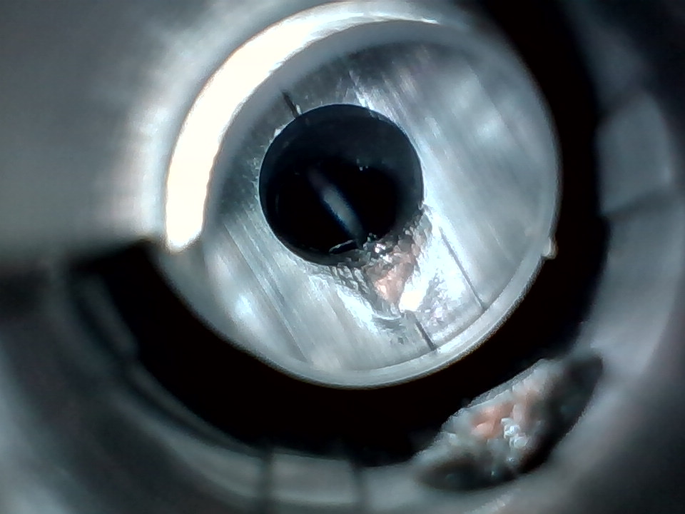

    Yes I tried everything, it wasn't about the copper. If you look at the first bore picture you can there is actually a sharp ridge and that is what was stripping the jackets off the bullets. After sending those photos in Paul said there was no fixing it. Obviously it wasn't anybody's fault shit happens! but I still give huge amount of respect and credit to Paul for his outstanding customer service.
    What solvent did you use when you soaked a patch and let it sit at the gas port??
    I thought about doing the same thing but a lot of the copper removing solvents have high amounts of ammonia and can damage SS barrels if left too long.

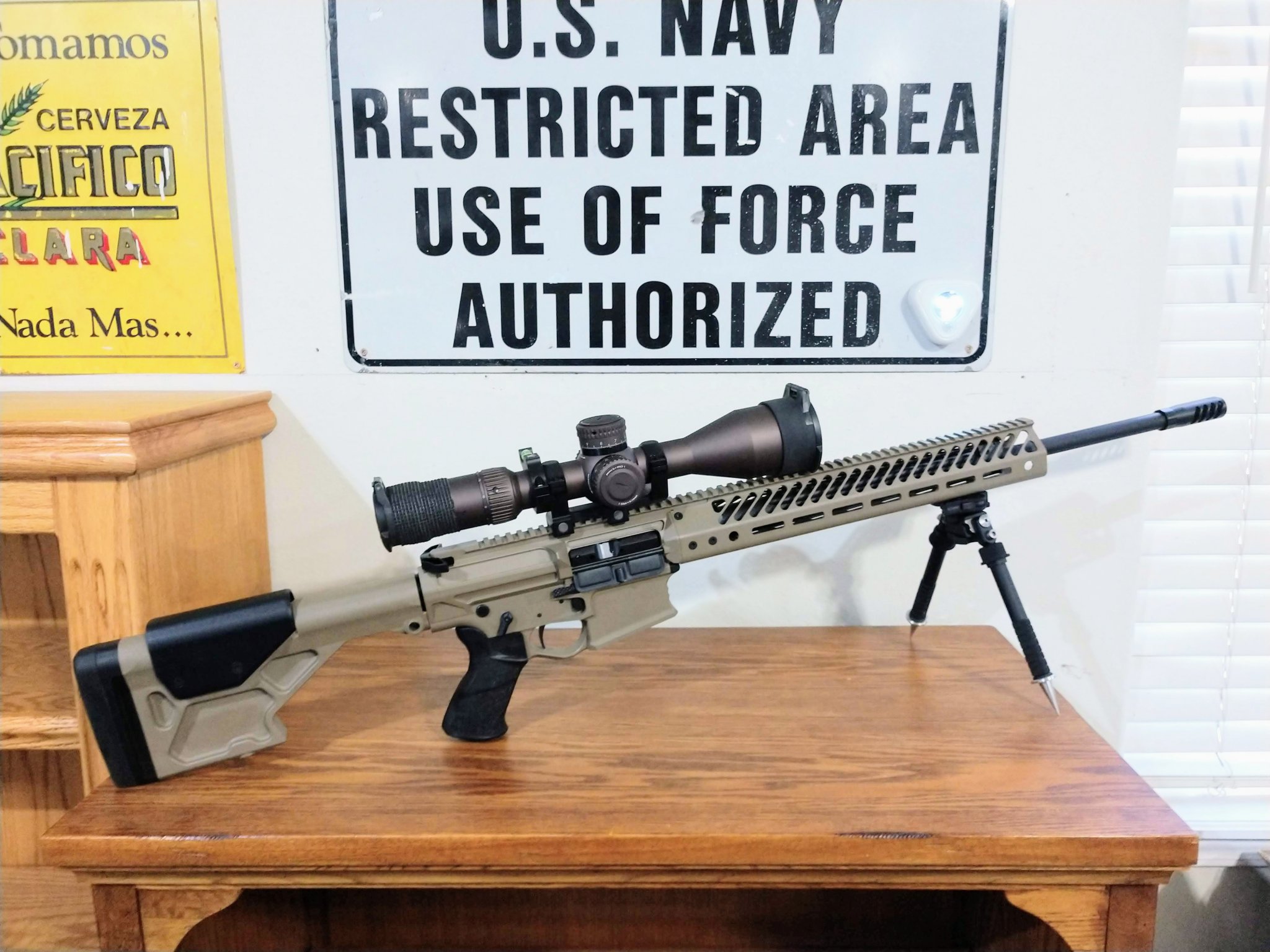

    What does the rifle weigh with the Proof CF barrel?
    Great review and shooting. Seekins went above and beyond to handle a issue I had, will be considering them for future rifles or builds.
    Thank you Sir, told ya fuckers I'd get the review out eventually..lol

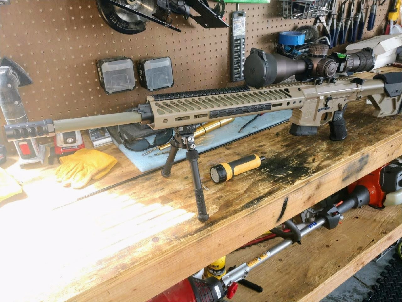

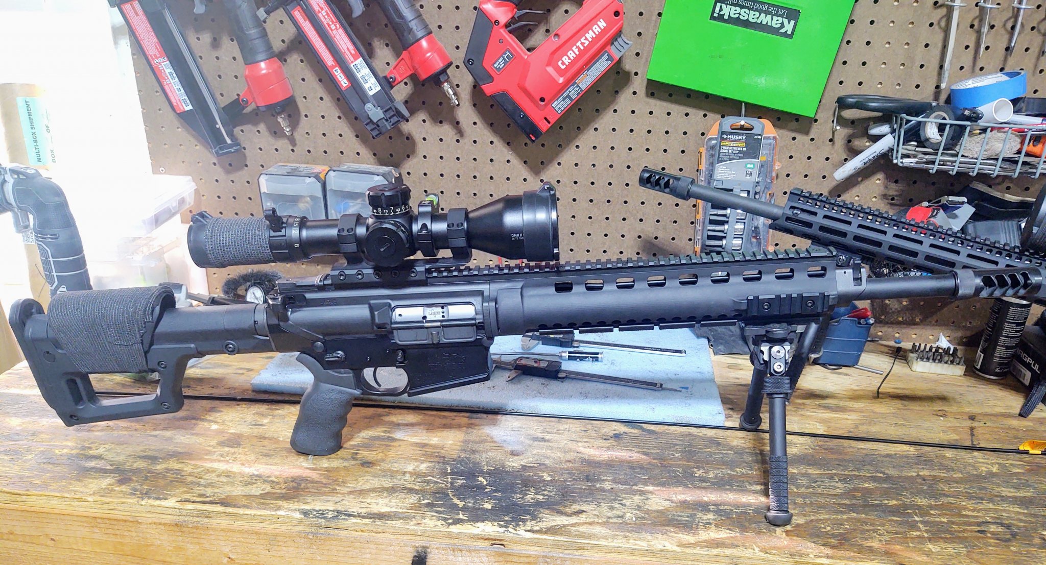

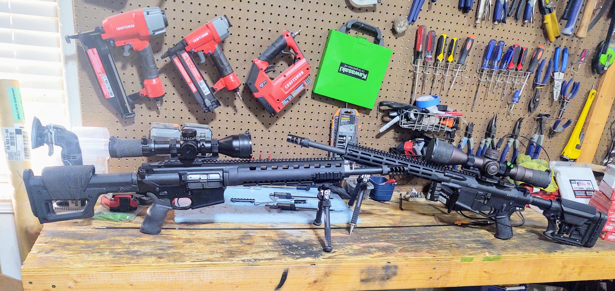

    The SP10 with the PRCF comes in at 13.6 LBS as pictured above.
    That 18" OBR is what shocked me she comes in at 15.6 LBS

    Did you bed or shim the proof carbon and Bartlein barrel into the upper? I asked Seekins customer service if they bed the barrel extensions into the factory sp10 uppers and was told they do not. Was this true when you pulled the factory barrel?
    I don't recall any bedding compound being used on the original Seekins Barrel, the barrel nut however was very tight at over 90 lbf-ft.
    Im pretty sure Seekins does something different for the M-series uppers.
    I did use Loctite 620 on both barrels. Be very cautious and clean up any excess after seating the barrel and pay close attention to not get any inside of the internal barrel nut threads.
    I used boretech eliminator. It supposedly won’t harm metal at all and they say you can actually just leave it in there indefinitely. Yep yours is pretty chunky. Mine was more of a peel than a chunk so it was tapered vs jagged. After some rounds and some cleaning it’s pretty smooth and doesn’t grab anymore.

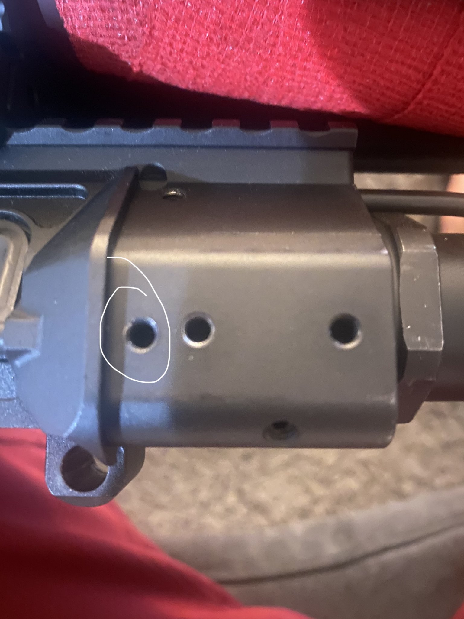

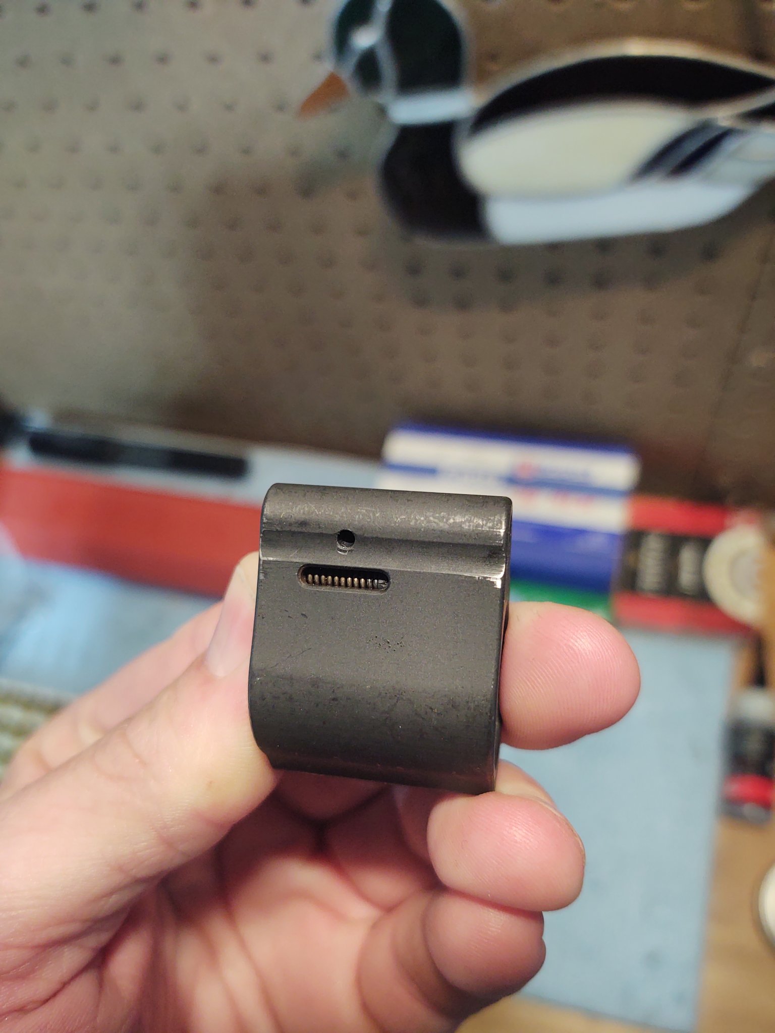

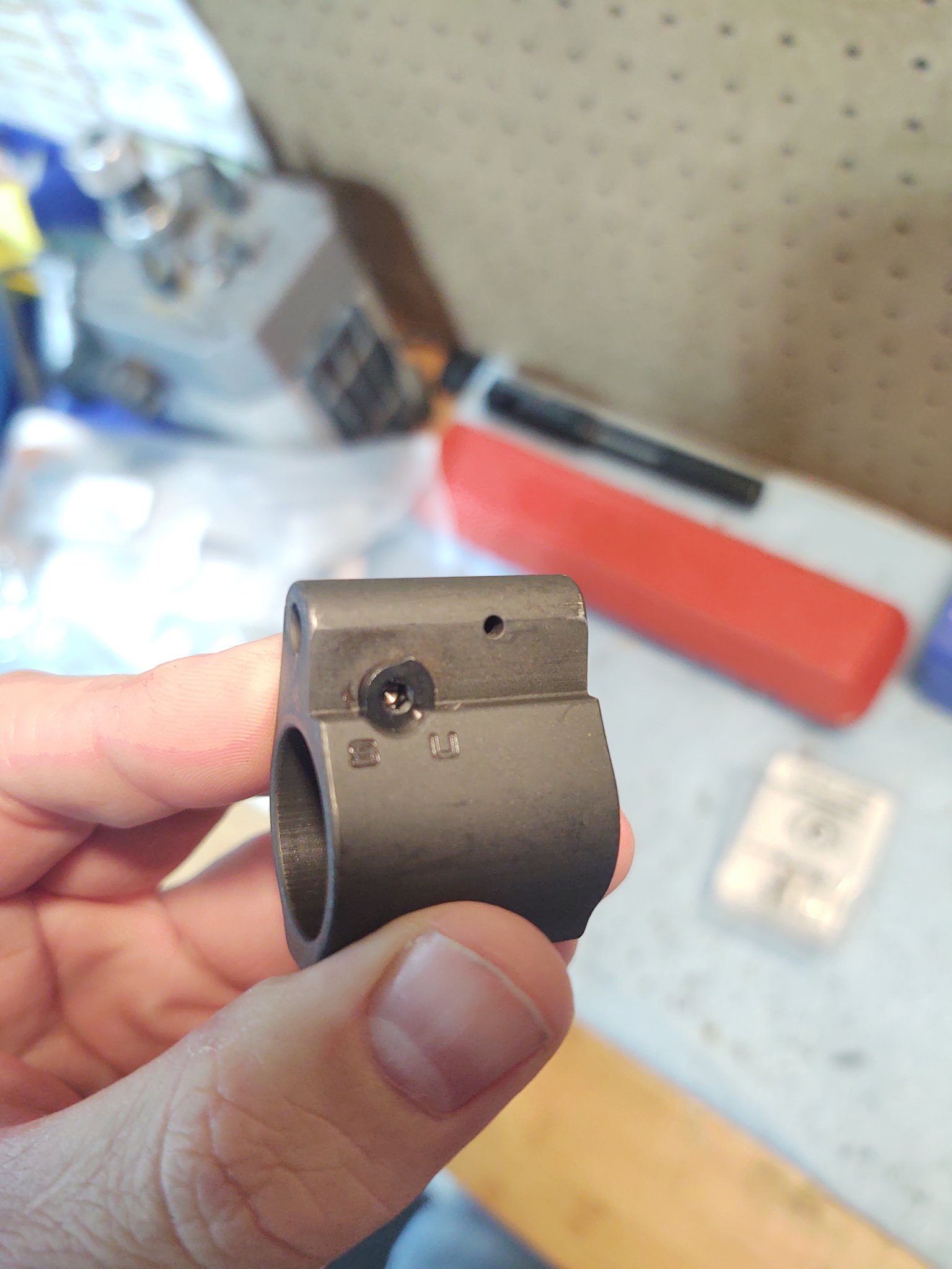

    One of the first things I noticed when removing the handguard the OEM gas block showed signs of wear from making contact with the inside of the handguard I'm assuming from barrel whip during recoil or loading the bipod, it didn't take much pressure at all to make the GB and handguard make contact.
    The rifle was very over gassed with FGMM with the ejection pattern being between 12-1.
    The OEM AGB is only adjustable for surpressed and unsuppressed so I installed a low profile AGB to fine tune the system.

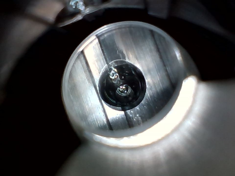

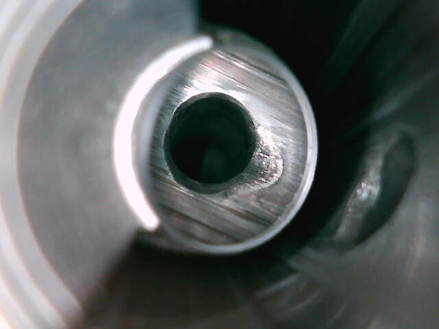

    It happens to them all sooner or later. I have a JP Supermatch 224v barrel that has a similar burr at the gas port, and accuracy as one might imagine has been horrible. It's hard to see in this picture but once I cleaned more of the copper out more you could really see the steel burr. I'm currently trying to work with JP on getting a resolution but unfortunately they no longer make the .224 barrel. It's interesting that Craddock concluded it was non-repairable because JP offered to try and clean it up or replace the barrel with one of a different caliber but they've gone dark for a few weeks now. At the time of these pictures this barrel had probably 200 rounds though it, I'm guessing it either came this way, or happened very early on because accuracy was bad from the start.
    Man that’s a clear borescope. I looked back at mine bc I couldnt remember what it looked like. First thing I notice is how bad the Lyman scope was lol. I also see why my accuracy came back and y’all’s may not. Mine was a chunk out of the lands vs out of the actual port. Now that it has smoothed out it’s almost like the throat of a nicely broken in chamber. It’s basically a ramp on the land vs a chunk out of a groove.

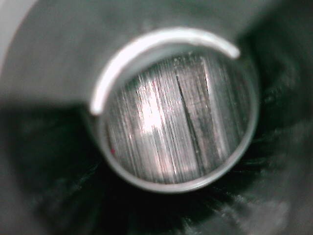

    Those dents in your gas port look like damage from improper cleaning, next time scope your barrel before starting barrel break-in.

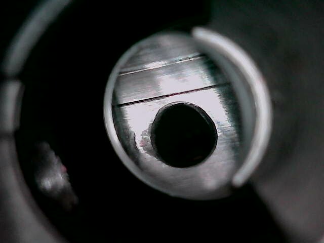

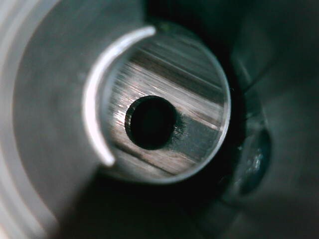

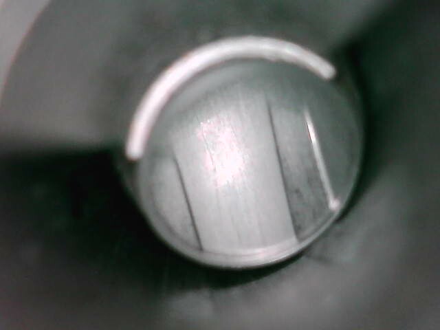

    This is how the gas port should look, this is around 500rds Bartlein (.308) the wear on the gas port should be smooth.
    Proof Research CF 366rds (6.5CM)
    18" Bartlein OBR 186rds (6.5CM)

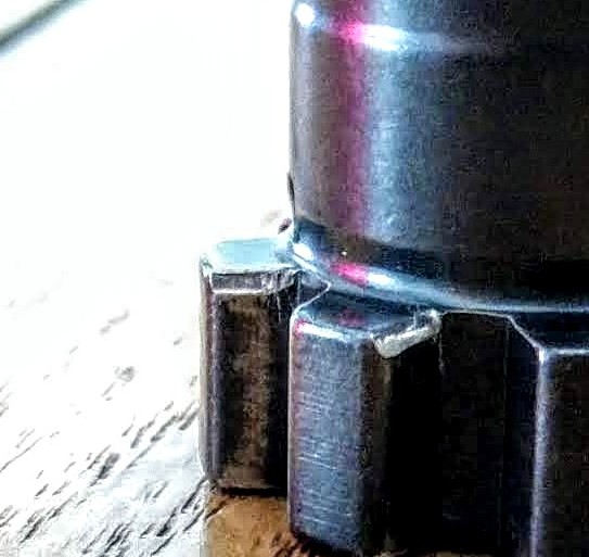

    Any other thoughts , concerning the OEM Seekins barrel, and the bolt lug "battering" cause ?
    Do you think the barrel could have been slightly out of "clock" ? ( Lack of a better explanation / word )
    I ask, because a friend had a 308 that was battering the holy crap out of his bolt lugs, and his was out of clock... guessing by only a few minutes / degrees.
    Ultimately, when it was taken apart the barrels receiver extension alignment pin fell out.
    So when the barrel nut was tightened, the barrel twisted slightly, and the alignment pin was acting like a wedge
    That tiny amount of off alignment, threw off the timing badly.
    I will have to look for the pics of his bolt lugs... they had ( while far worse then yours ) the same wear pattern.
    For me, His battered bolt lugs showed me how important "timing" really is, even on such a taken for granted spot.

    I spoke with Matty a few times about the issue with the bolt, My take on it was due to bolt bounce from the over gassed system.
    Everyone at Seekins was more than accommodating, and basically said if it breaks we'll send you a new one so just keep shooting.
    It would have been a good idea to bore scope it first admittedly, but even if I had, you see dozens of forum posts about how burrs on gas ports are no big deal and will shoot out, even manufacturers saying the same thing, and not to believe various things you see in a bore scope until you shoot the gun. So I probably wouldn't have complained about it even if I had seen it new until a couple range trips.
    It's hard to trust what you see in a bore scope and predict accuracy, I mostly use it to verify how cleaning is going, carbon rings etc. I have a Clark S&W41 barrel that looks so bad it would make you throw up in your mouth but when tested shot 1/2" groups at 50yds. Also have an old LTR that has ugly chatter marks most of the barrel but shoots as well as anything else I have. I have another JP 223 barrel that was part of a sale batch they had and came pitted, or it's the only gun that pitted on it's own in the safe in a climate controlled room with the same care process applied to it.....not likely, that one I wish I would have caught but it still shoots very well.
    Also here's a view of the gas port on my JP 6.5, it's been cleaned quite a bit more with the same process and has 5x the rounds down it. Pretty sure if it was my cleaning this one would show it.
    Reactions: mettee

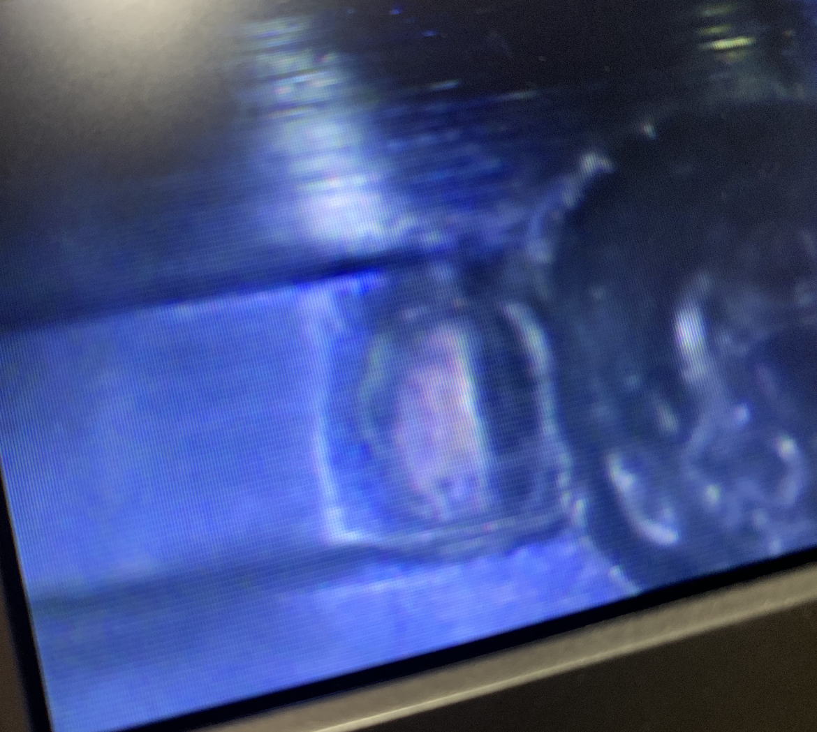

    Yeah I had a Lyman for a bit and then I started seeing pictures from the Teslong that many are using and returned it. They've shot up in price though, I bought mine a couple years ago for $70 and now they are $130, still 100x better than the Lyman is though.
    It seems like it's not uncommon to have a burr at the gas port, and many of them "shoot out" over time or even very quickly. Some clearly though cause issues and don't go away.
    I’ve got a teslong now but I don’t think it looks that clear. Maybe it is, I haven’t used it in a while. It’s def 100x better than the Lyman.
    I now shim all my barrel extension alignment pins to the upper to minimize any barrel rotation when you
    tighten the barrel nut.
    Reactions: bfoosh006

    I didn't have to do shit! I chose to replace the barrel because I knew a +2 gas system works better and is easier on brass. Seekins wasn't offering the extended gas system at the time when my rifle was built, The rifle still performed quite well, I'm just picky.
    Every firearms manufacturer has gone through some growing pains at one point or another it is pure ignorance to think any one company has been perfect out of the gate.
    And yes I would absolutely recommend Seekins!

    How much neck tension are you running on a gasser?
    Depends on the brass, usually start .002 smaller on the neck after I've ran it through a FL Sizing die. After that I'll make up some dummy rounds and chamber them a few times checking my seating depth from the Ogive.
    Reactions: kriller134
    Thanks man!
    Reactions: bigjake83
    Great information. Looking forward to the comparison between the proof and CLE barrel.
    Which scope are you running - 18 or 27?
    You use a mandrel .002 under plus brass spring back?
    Just making sure Im tracking, brain is fuzzy this AM.
    And no, not too much whisky. Maybe its from none. 🤣
    I size the brass in a standard Redding FL Sizing Die, then I size the neck down even further with a Redding neck sizing Die.
    As far as how much further I size the neck down for the appropriate neck tension, it all depends on the brass it takes a little bit of trial and error making a few dummy rounds in .001 increments.

    I have a similar setup but with Proof regular SS barrel. When the barrel gets warm (not hot), the accuracy drops noticeably, and there is also a ~1MOA POI shift to the down right. The cold bore can give me 0.3-0.4 MOA with 140 ELDM Hornady factory ammo, then I had trouble to shoot sub MOA group when the barrel gets warm. Do you see this with your Proof CF barrel?
    I initially had some concerns with my groups opening up under high heat after conducting a 15 round mag dump and then tried to shoot for groups. But after my last several range trips in colder weather and using a heat shield the group expansion I was experiencing was due to mirage. All barrels are going to open up as the heat increases, I'm not seeing the PR barrels act any differently. I personally don't care for the contour Proof uses on their SS 6.5CM barrels, it's too light I'd much rather have the old M110 Profile they first used and still do on the .308 SS barrels.
