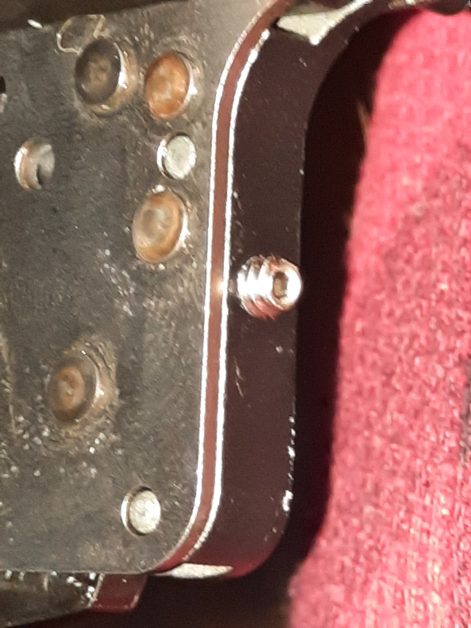

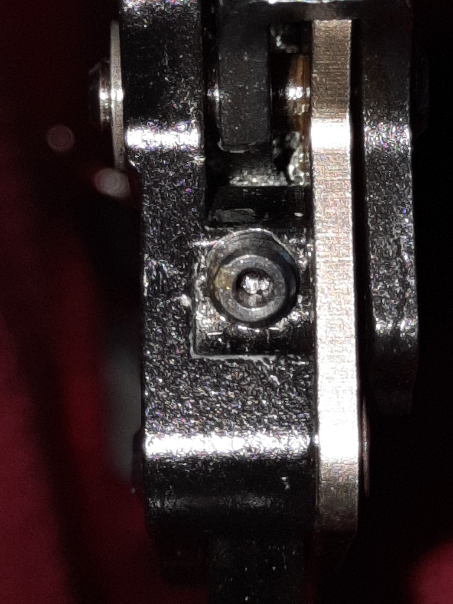

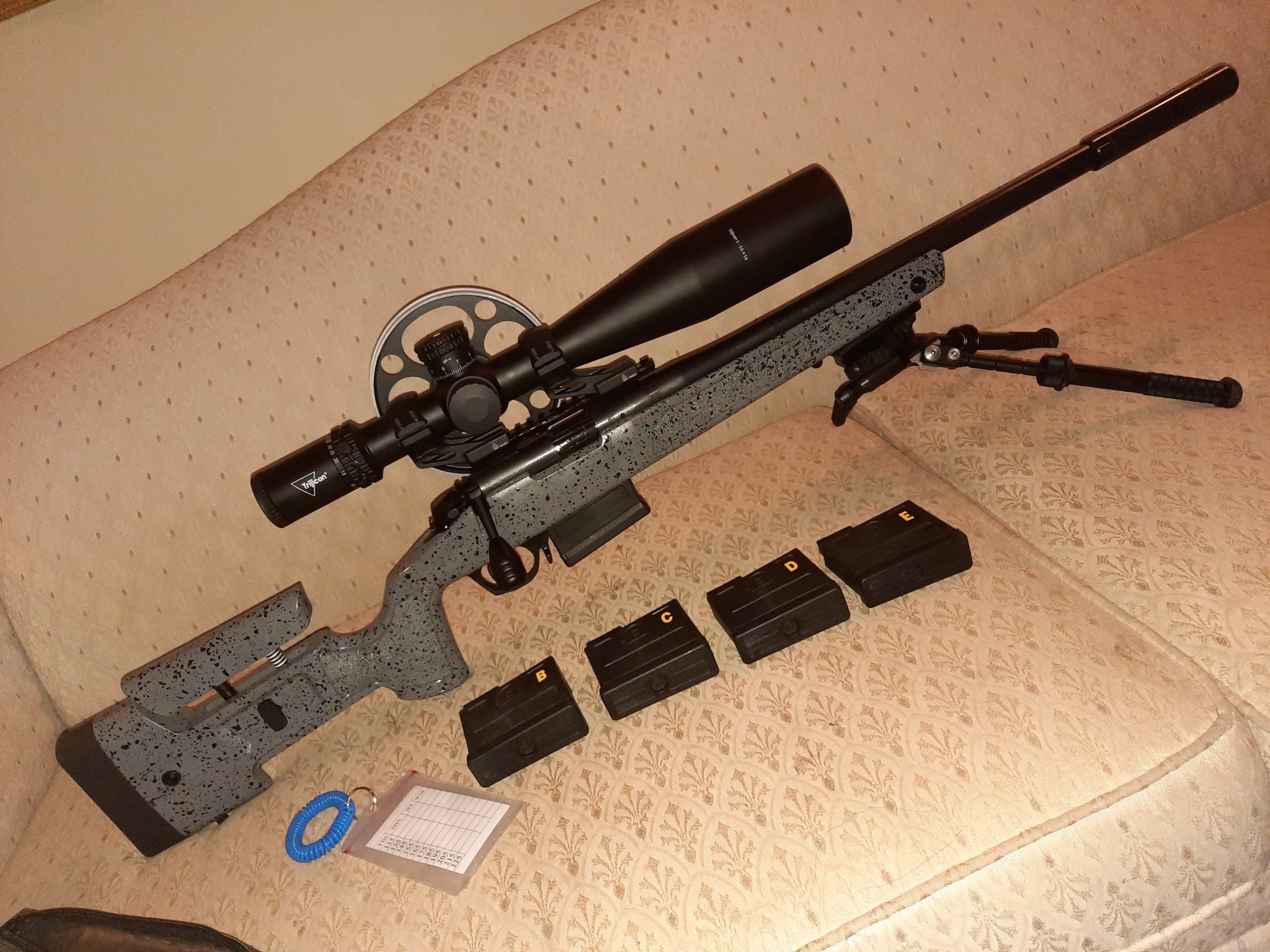

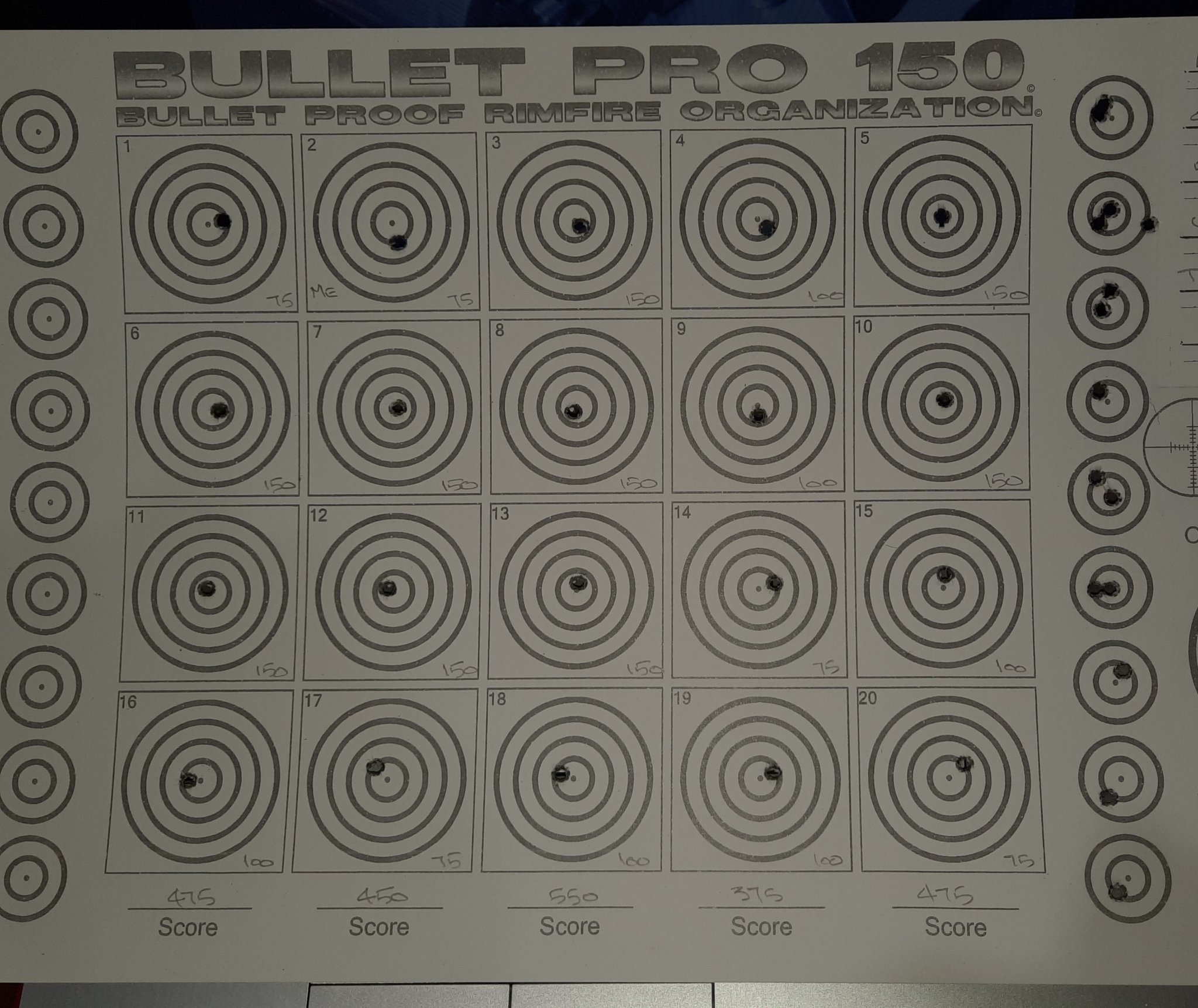

As my B14R shoots well out of the box and is reliable, I would buy one of those. I would then put a Vudoo bolt knob
on it and make a $4.56 trigger mod that will bring it down to 11 ounces. It will also provide you with an adjustable sear stop.
The trigger mod is to drill the housing for a #6-32, 4.5 pound long nose spring plunger, install it and adjust the sear.
The trigger already has hole drilled in it so all you need do is enlarge it. There is also a pre drilled hole for a trigger over
travel screw if you would like one. Shown in image number 7. Both are #6-32 screws. The plunger is about .62" long and
has a nylon locking element to keep it in place. The OT screw is .50" long, has an oval head and a nylon locking element.
Then save your money for your Vudoo.

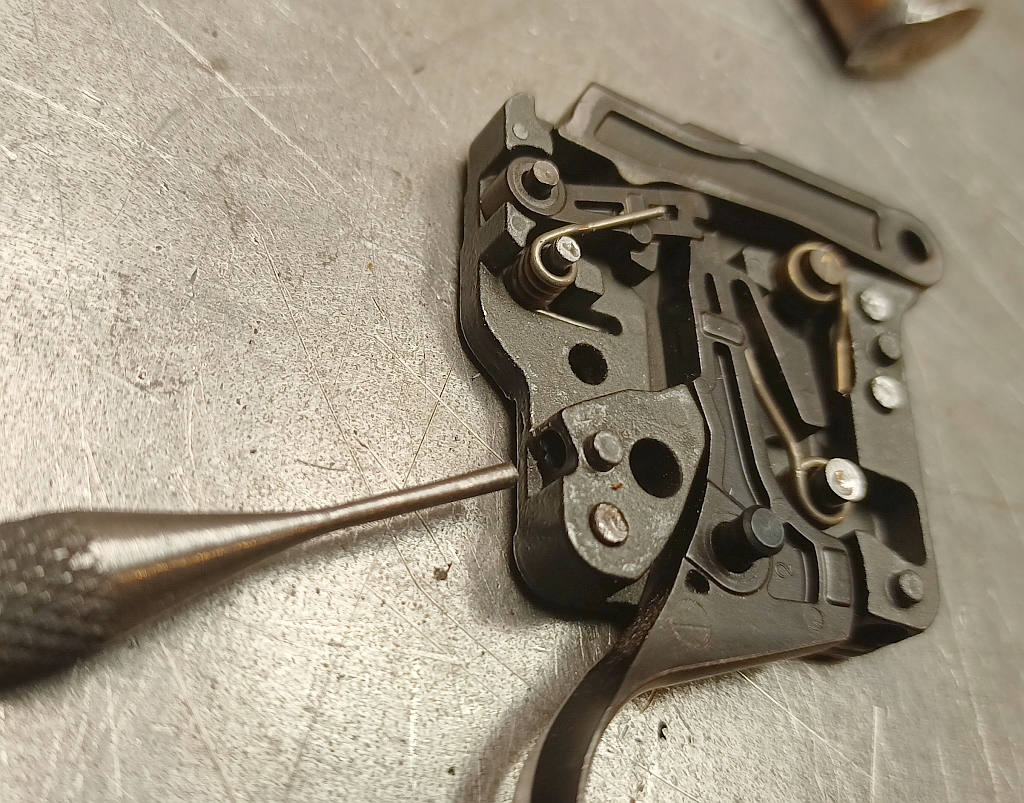

If you buy a bunch of cool parts to make yourself a shooter........ who will buy it from you when your done with it?
Every change I make to any gun can be undone. The only exception is when I lap the trigger sears.
Even then, I could re-lap it with a courser grit lapping film and restore it to the factory finish.
btw... I lap in the direction of trigger travel. I don't change any angles, I only refine the surface finish
This was done with 9 and then 3 micron Aluminum Oxide PSA backed lapping film.

I’ve seen something like this before 😉
Can somebody please direct me to the section on SH to buy triggers from the island of un-Wanted tools?
B14R trigger that I want to work on...
Thank you
