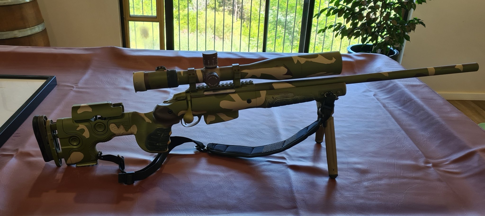

Rifle pic for the people
A Tikka Super Varmint 6.5 Creedmoor, GRS Bifrost stock, with Vortex Razor HD scope.
I carry that with a Butlers Creek sling.
Across the salt flats, up hills, and bush bashing.
It's my everyday rifle.
Kangaroos, pigs, deer, camels, foxes,cats, etc.
They die fast with my very accurate Tikka.
Knocking steel with it at 1400 metres.
Pretty much does everything I need.
I have two favourites loads, one for 129gr SST, and the other for 147gr ELD-X.
My scopedope is set for both, and now it's just pick and choose according to target and distance.
Without a doubt, my most versatile rifle.
Hope you have fun with your final choice.

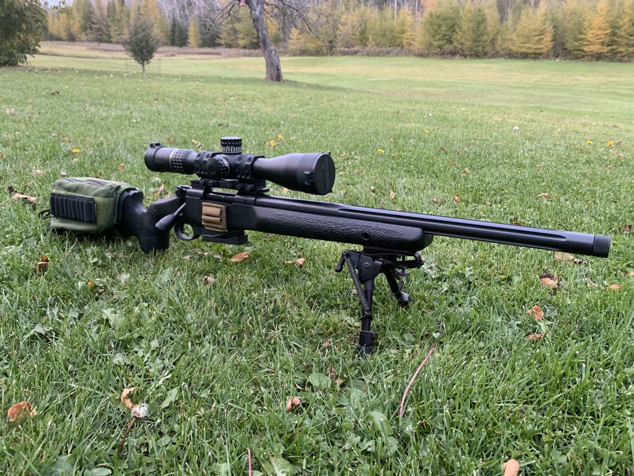

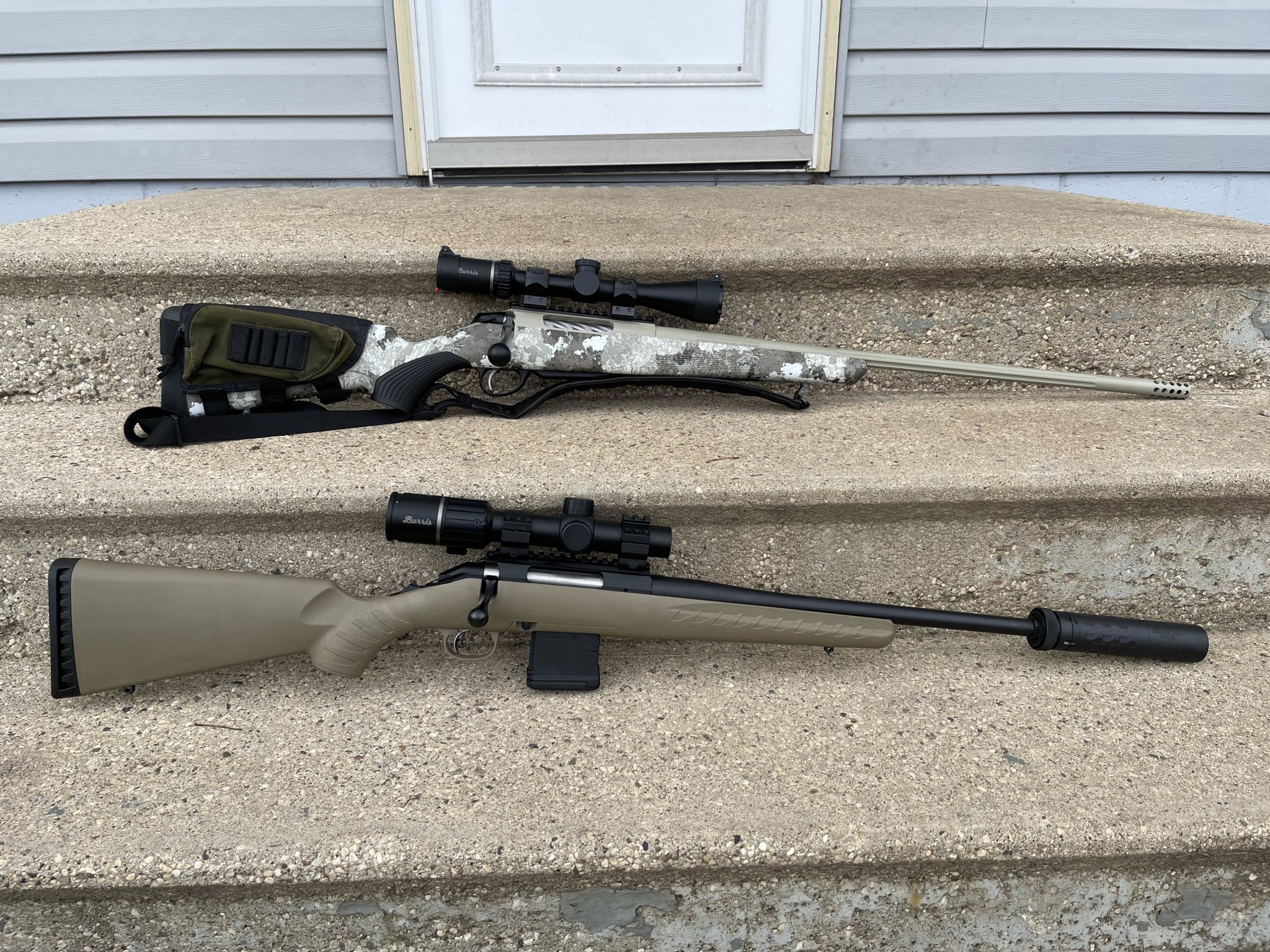

I’ve gone back and forth with precision rifles for hunting rifles. From basic savage and Rem 700’s to FN SPR and AI’s. I personally grew to appreciate the heavy platforms for LR hunting and targets but prefer a totally different setup for standard hunting. Be it blind or walk/stalk
These are my precision rigs used for target and open field hunting (crop damage)
And these are my “hunting” rigs for deer and Varmint. The top is a Tikka T3X Alpine in 300 WM. Simple Burris E1 drop reticle 4.5-14 optic. Very light and very accurate. Easy to 500 yards. You could get something similar in 6.5 PRC and load to match your Bergara. Get a lightweight scope and dial for elevation and you’d essentially end up with two rifles in the same caliber, same ballistics for two different types of shooting

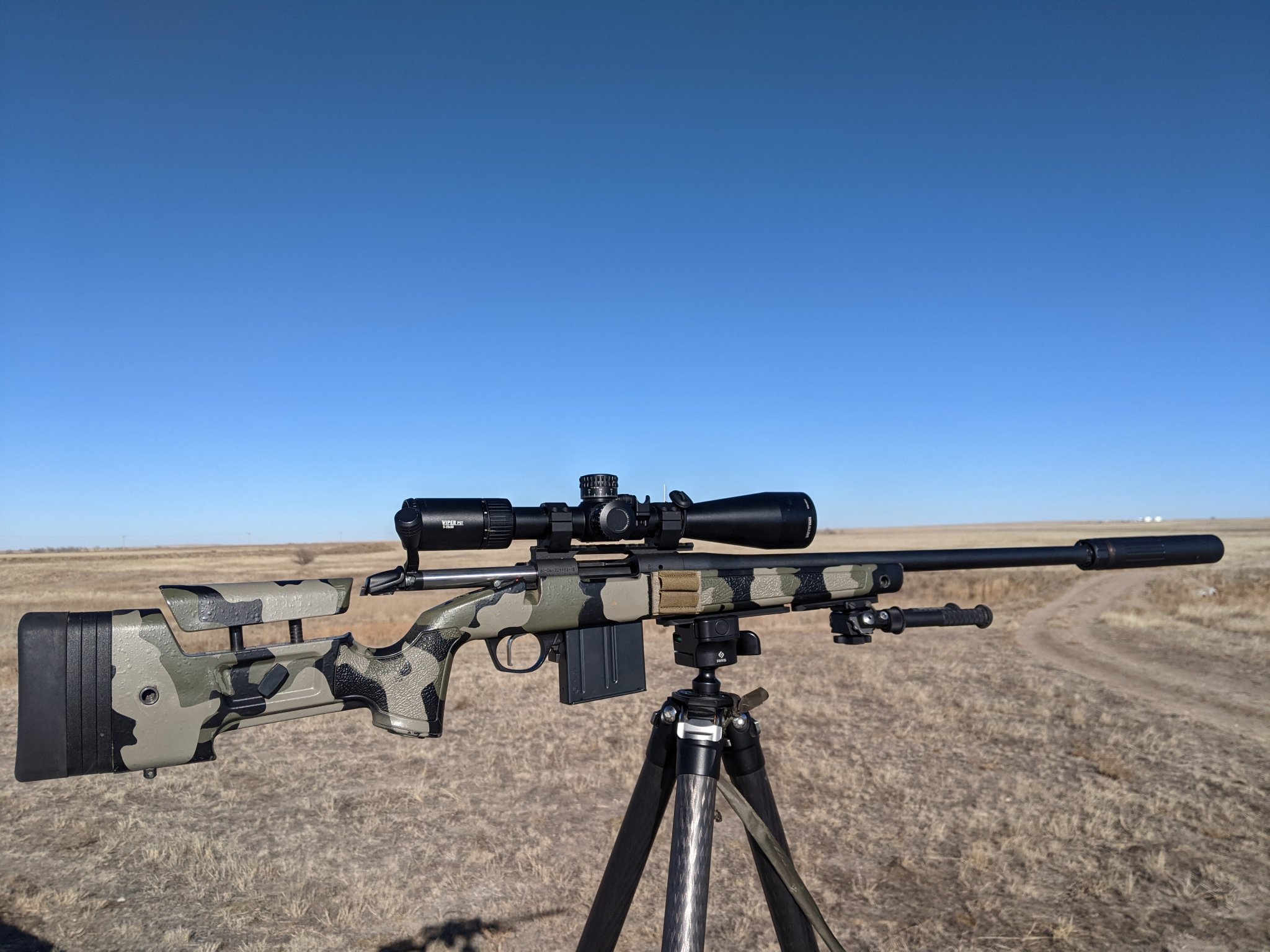

No real suggestion here, just something that might be of interest to you. I've got a 6.5 CM (yes, baby brother, I know) that goes 11.8 lbs all up. That includes a:
Action: ARC Nuc Gen2
Barrel: Proof CF, 20"
Stock: Manners CS-2, Elite/CF shell, w/ mini-chassis, 2x QD, 1x pic rail section, cheek riser
Rings: Seekins (on the included ARC rail)
Scope: Athlon Ares BTR Gen2 2.5-15x50
Bipod: Harris (eek!) w/ Area 419 adapter and LW-17 pic rail QD
Suppressor: Dead Air Nomad 30 w/ Armageddon Gear cover
Balance point is just forward of the barricade stop and it handles wonderfully, carries well (my opinion). The current gen Vortex LHT didn't exist when I put this together, you can save almost a half pound there. You could also save a good half pound on the stock, easy. A Ti suppressor can get you another few ounces. Might let you run a 22-24" barrel and still meet your weight goal.
