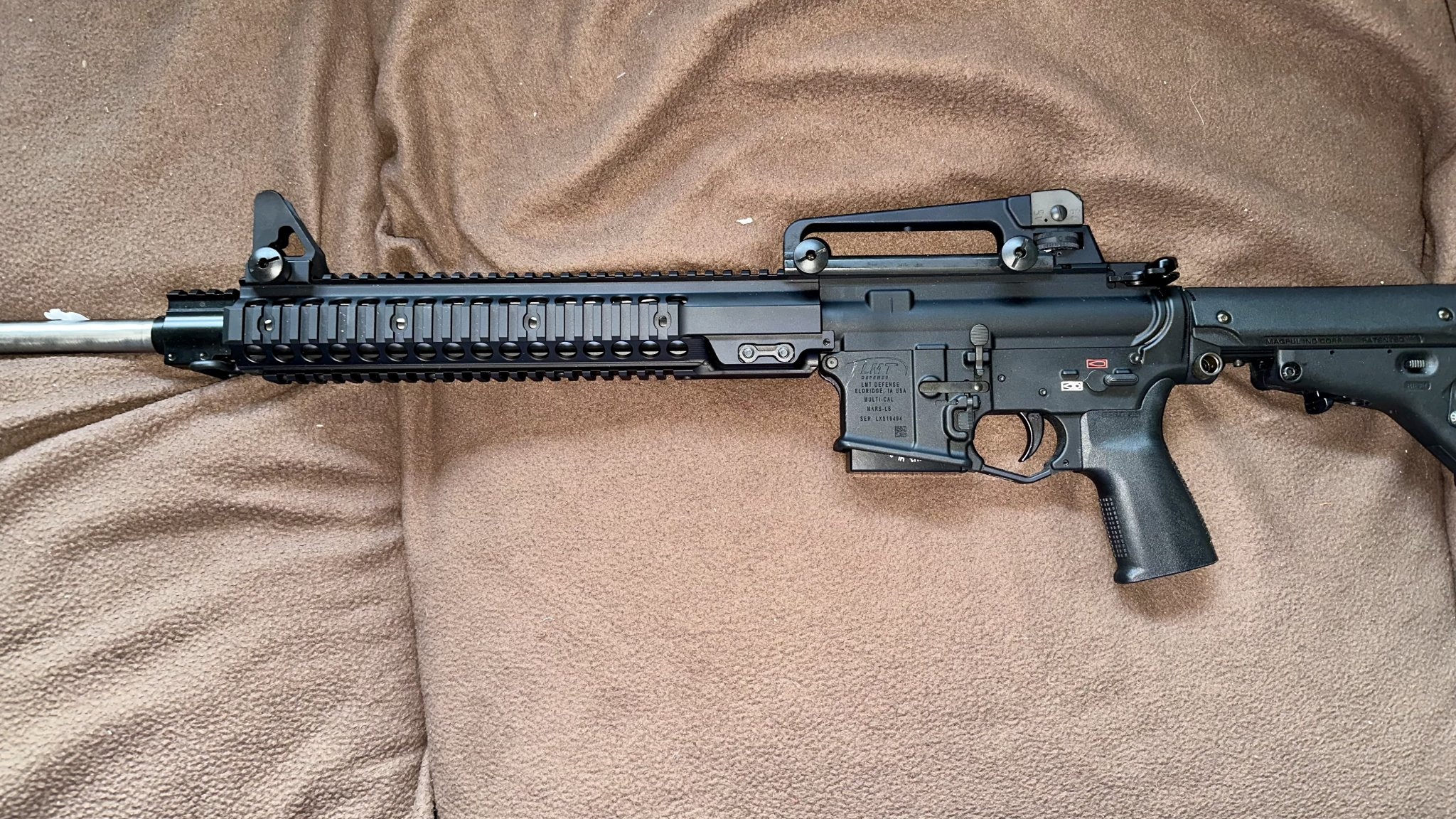

Here is what I went with.
The guy running the matches wanted ‘military’ type sights, so I ordered an F type front with a 0.074” square front post and a handle carry upper with the rear sights modified to 1/4MOA adjustments from Compass Lake. A fixed long hooded aperture was installed.
I initially mounted the front on the rail but could not get enough elevation so moved the front to the Gas Block and adjusted the front down one or two revolutions.
Now we were on at 100 yds with the rear bottomed out and lots of UP left on the rear wheel.
Target is M193 at 100yds shot by my son. These are the second, third and fourth shots he took, where the first went, we don’t know unless he was using one of the sight protectors as the post.

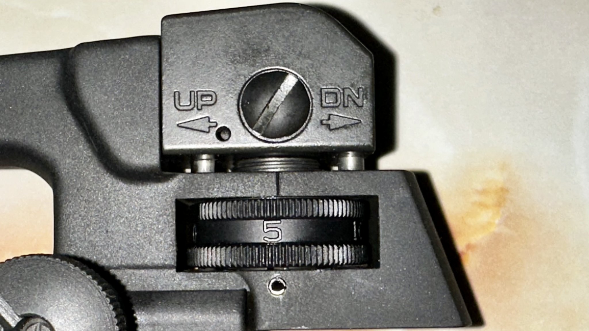

The Compass Lake handle sight works great but the rear elevation is CW and does not a match a normal scope.

I have purchased the White Oak modified carry handle sight with CCW elevation adjustment. just because.
The present sights work very well and satisfy the Match requirements.

A little confusion on my part.
The White Oak carry handle adjustments are the same as the Compass Lake.
Windage adjustment matches a scope but elevation adjustments do not match a scope unless you have CW scope for elevation.
In any event, these modified carry handle mounts are very nice and will serve the purpose.
