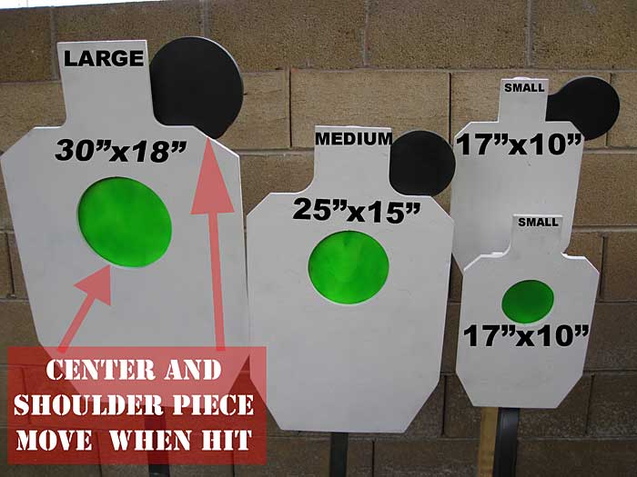

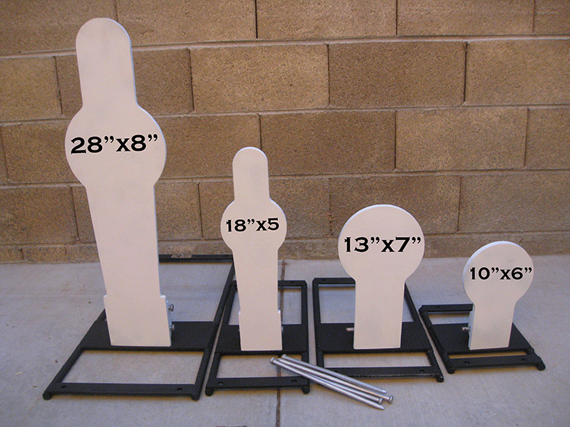

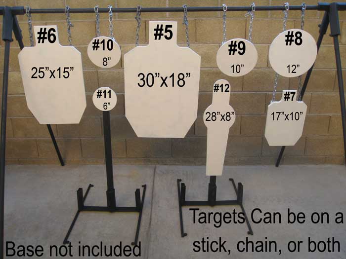

Edit: Spring Loaded Steel Targets See attached pics.
For target shapes and sizes - I routinely shoot the 25'x15" steel torso plate at 1K and find it challenging on a windy day and so, so on a calm day. A challenging target down to 500 yds is the small one (11.5"x7"). Once you get bored with the static steel targets, look into something like the hostage targets and poppers.
