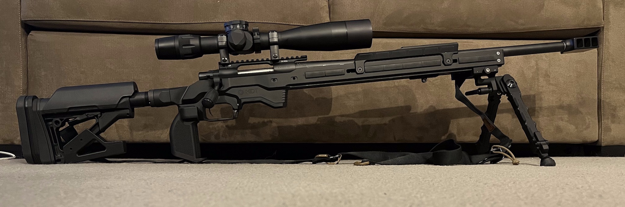

I dropped a Howa barreled action (in 6CM) from Brownells into a KRG Bravo for my first long-range rifle. I was coming from a USPSA/IDPA/3-gun and LEO background, I was weary of the expense.
The rifle ended up sick, full stop. It's what got me addicted to this shit.
Now I'm running a custom rig, nothing too fancy (Origin/Proof/TT Diamond/Manners/Razor HDG2) and know I could be every bit the same intermediate-advanced-middle-upper-mid-pack shooter I am now had I kept rocking the Howa.
I only "upgraded" to see what all the fuss was about being that most equipment in the sport is R700-platform derived, and that is the undisputed "industry standard" platform ...and because my friend was looking for a solid rifle for him to get into it and had offered to buy the Howa.
When I was done with the Howa/KRG, I had ~$700 into the Bravo for it to hang with anything out there (chassis + weights/KRG side dishes), it weighed a balanced 21.5lbs, I was getting kick-ass MTU-profile prefit "Howage" barrels from Crown Ridge Barrel Works for less than$500 a pop, and was running the Jard trigger at ~9ozs (the Howa version of a TT Diamond IMO, if you have a Howa, do it).
For what it cost to put together... bang for buck in unheard-of territory, just a great rifle, '70s-'80s Japanese engineering is amazing and the Howa M1500 is a fantastic piece of steel.
Now, all that said... if you think you're going to dig it... start with an Origin or whatever and go whole hog, the gun is absolutely, unquestionably, the cheapest thing... in no time you'll be buying $100+ bags of sand lol.
The old Howa:
