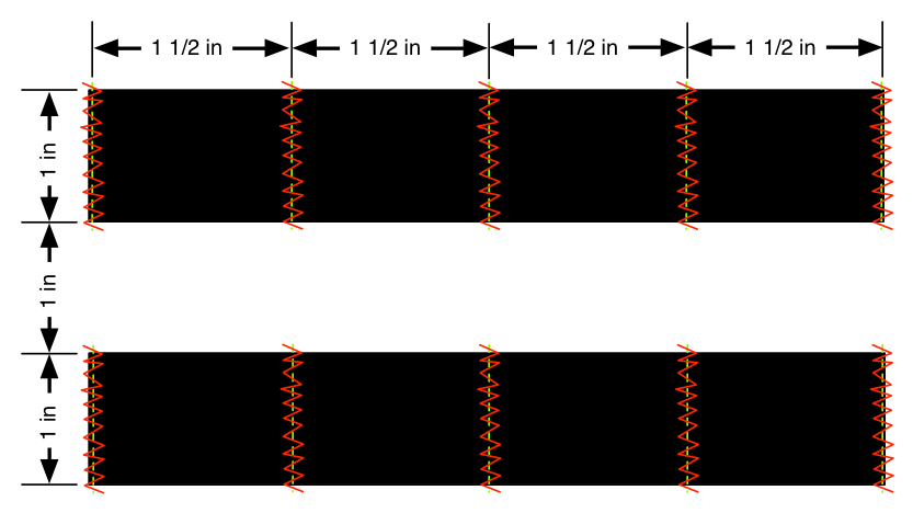

Have her web the snot out of all your gear.
