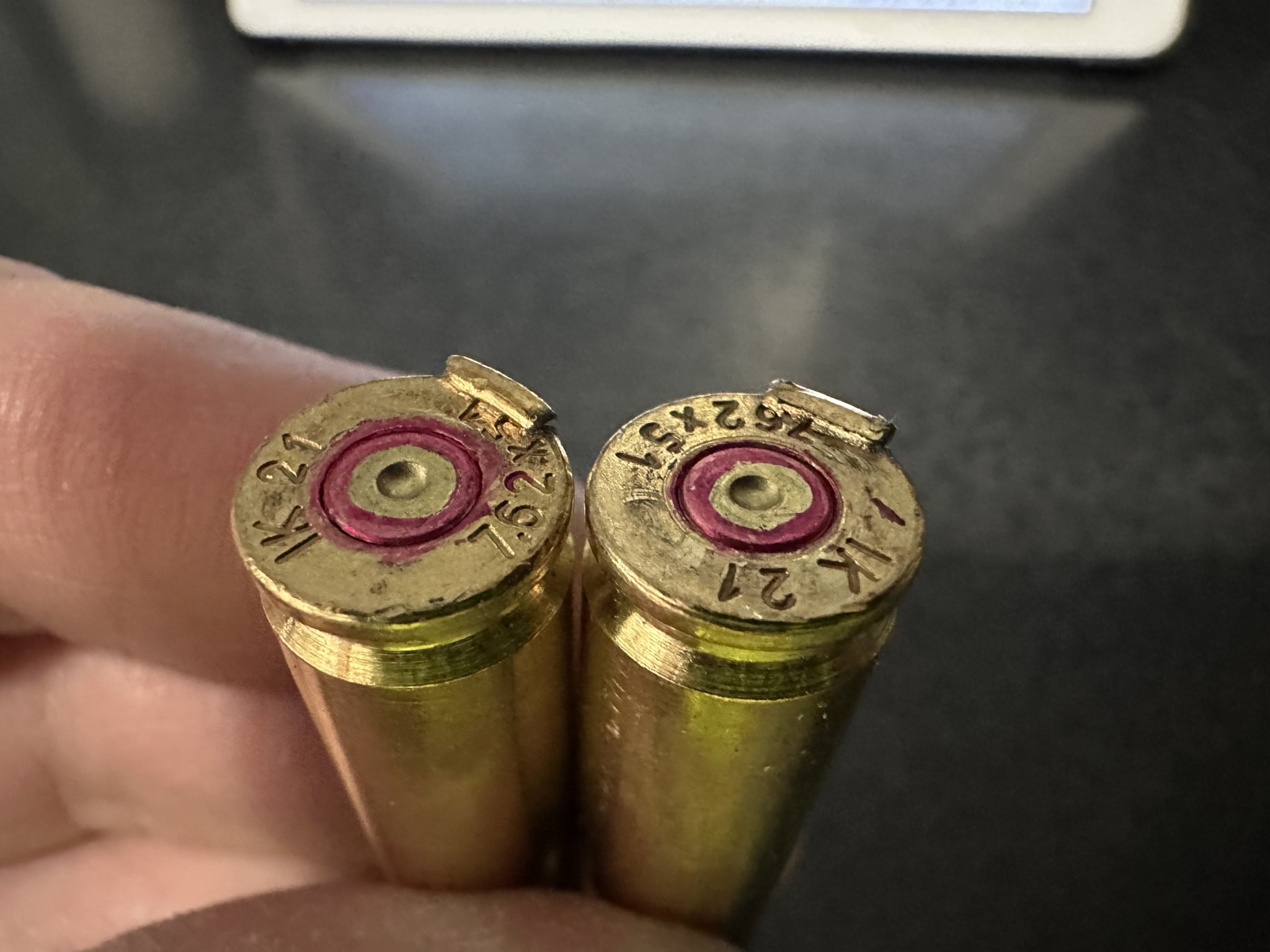

    I have a new 20” Ruger SFAR.
    I took it out to sight it in a few weeks ago, and all was great. No issues whatsoever.
    Yesterday I took it out, with two full-size .308 AR10’s, while verifying 100yd centers with different ammos. The good ammo - 168gr Hornady Superformance was accurate and golden in all three rifles. I also took 147gr M80 milsurp from Malaysia, Switzerland, and Germany. The two AR10’s ate everything without issues.
    The SFAR ate all except one.

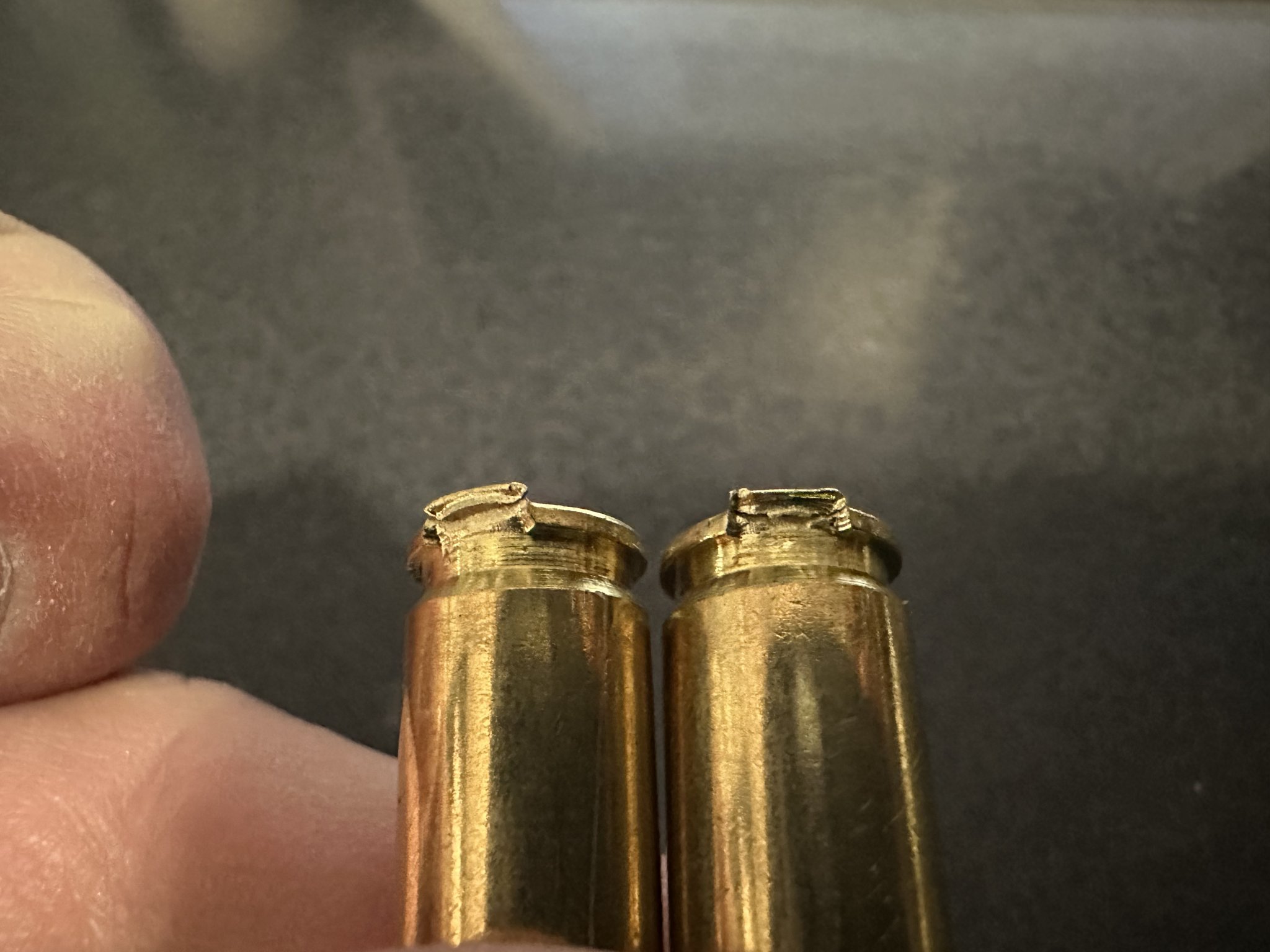

    It failed to eject with only one brand of ammo… and it not only failed to eject, but had to be mortared to get the BCG freed, then each brass pounded out with a dowel rod.
    WTF is going on?
    The other weapons had no issue with the ammo at all. Only the SFAR had an issue with it… while acting perfectly normal in operation with all other brand presented.
    There are no odd marks anywhere else on the brass.
    Anybody have any ideas?

    The case head on the right in your picture looks like there was some brass flow into the ejector.
    Have you measured the case dimensions on the problem cases and compared to the unfired dimensions ?

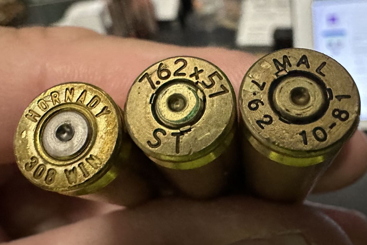

    Yeah thats kind of odd, was it the Malaysian ammo out of curiosity ?
    If it was brand new and not commpletly clean i might question residue in the chamber left over from the nitride process but that generally leaves a smoked looking soot on brass that isnt there.
    Reactions: MadDuner
    I was wrong.
    This ammo actually came from Bosnia.
    I thought it was German.
