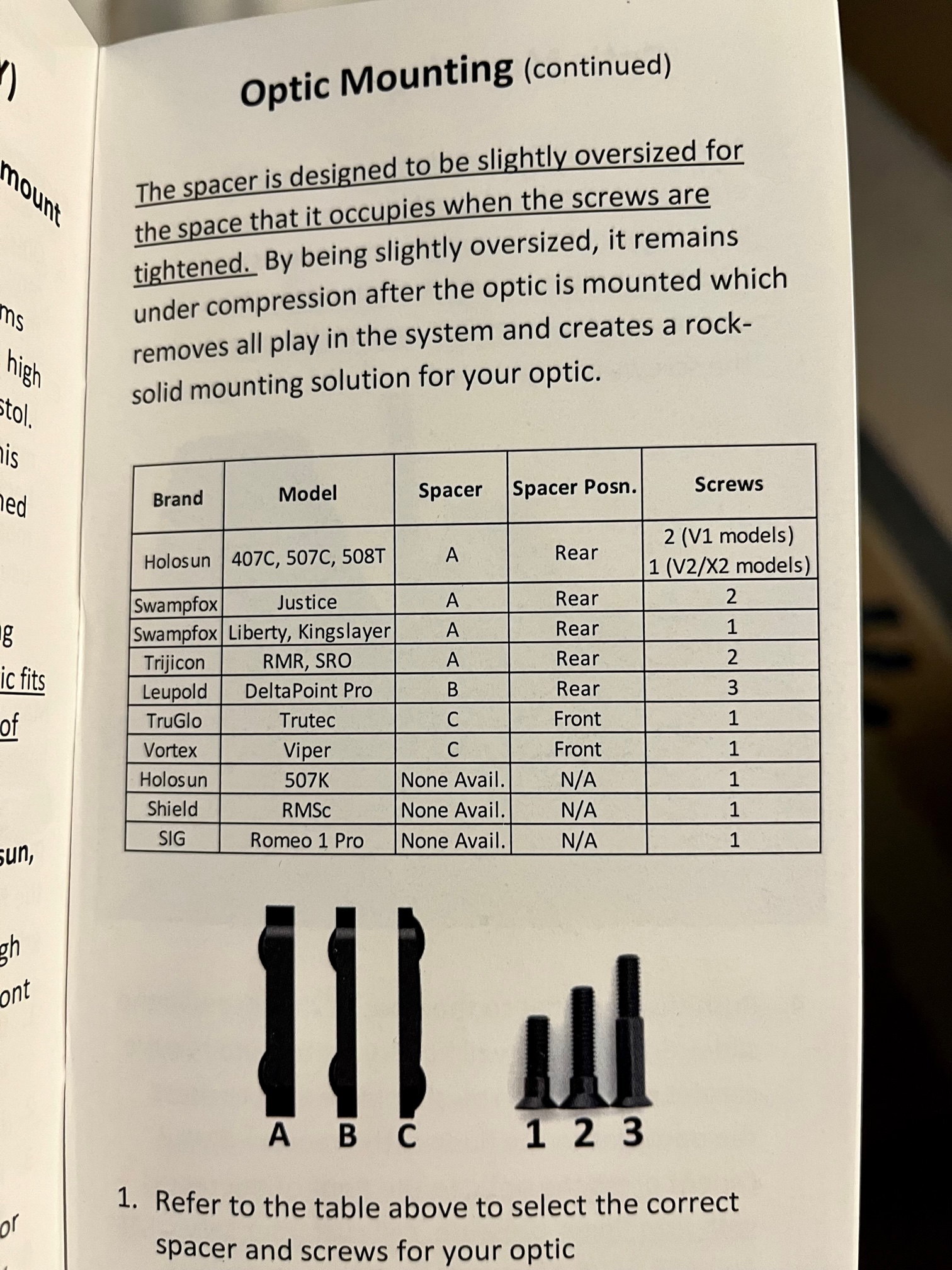

There's no recoil bosses what so ever for any optics. It's just a bigassed oversized cut and a little polymer spacer goes in the rear and thats it. They are tight on the rear but a gap in the front so you have the screws holding it down, the spacer holding it from moving rearward at all, but putting forward pressure on those screws that should only ever be holding the optic down to the slide. Then you have a gap in the front along with that forward pressure.
When setting up bolt guns there's a big reason why we push the mount forward and have the front of the recoil lug against the rail... RECOIL.
I just don't see how it can be an effective solution. There's recoil bosses on these optics for a reason, they need to be there to hold the optic under recoil, a spacer at only the rear isn't going to do it.
They did it to make the slide work with as many optics as possible without plates because that's all people seem to give a shit about, no concern if the optic will actually stay on the damn gun under recoil or not.

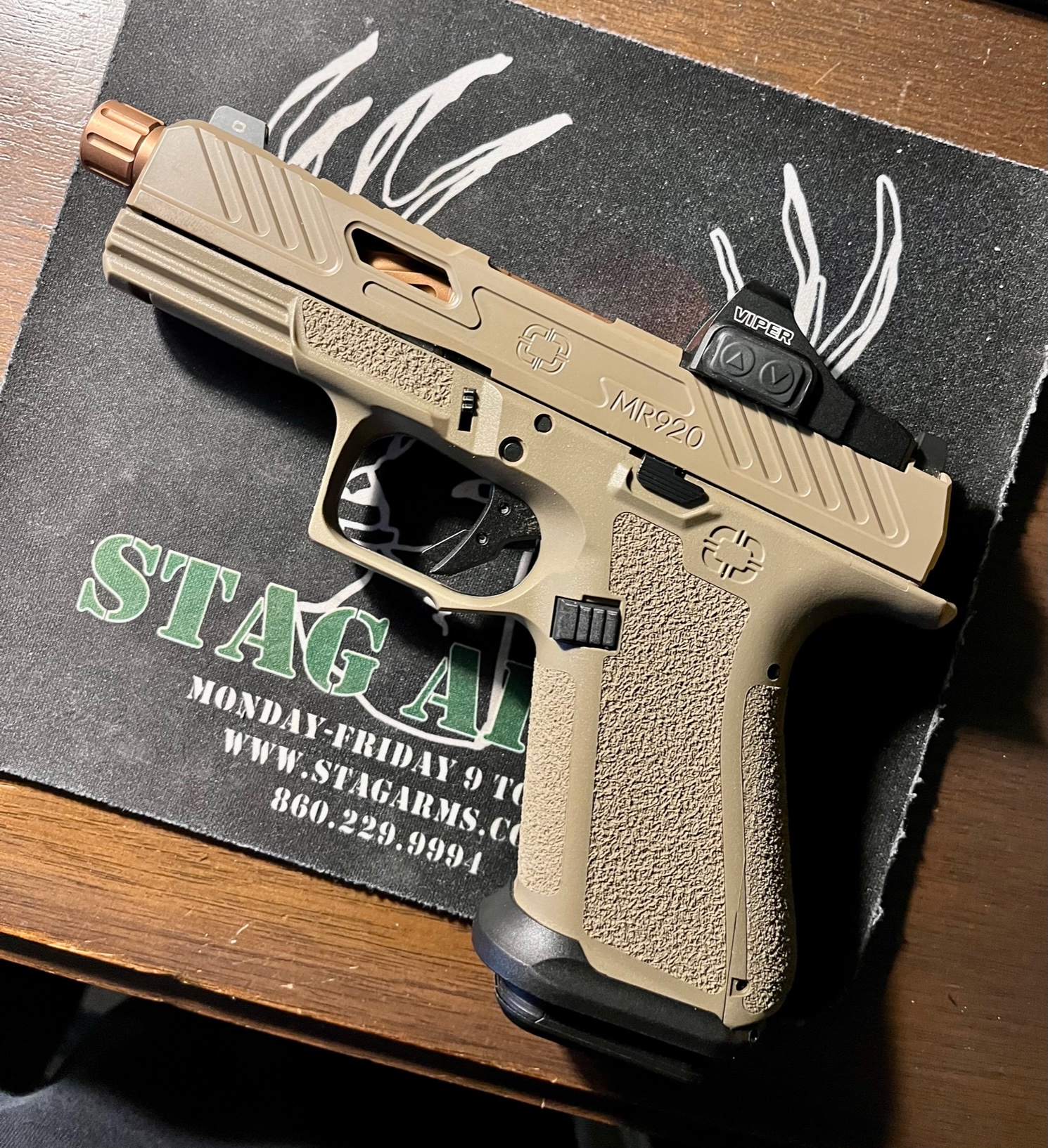

The spacer goes in FRONT thereby removing ALL slop. If all else fails, read the directions, or since you don't have one anyway you can probably access a manual online. OPTIC CAN'T MOVE.

You don’t have a fucking clue what you’re talking about. Here’s a vid from Shadow Systems explaining the mounting system and showing that the spacers go in the rear. 😂
Furthermore I had several in my hands on Saturday that all had optics on them in the store and they ALL had spacers in the back.

OK, I dug my manual out, and there is a table in it showing which spacers to use with which optics and whether they go in front or rear of the optic. As seen in the picture in my previous comment, I put a Viper on mine and the spacer goes in front per the table, but I see several of them do go in the rear of other optics. So, you have a point, however regardless of front or rear the spacers take up ALL the space in the cut-out so I still don't see the problem. Several of us at my shop run MR-920's and none that I know of have had any problems with the optics mounting system. So at least I didn't make it up, even though I don't have a fucking clue what I'm talking about. So sorry.

Dude I literally looked at 4 of the things in my local shop on Saturday that had Holosuns and RMR’s mounted and every single one of them had a gap in the front. Like .020” or so which is significant. No, they do not fit tight.
It’s a shitty mounting system. Period.
