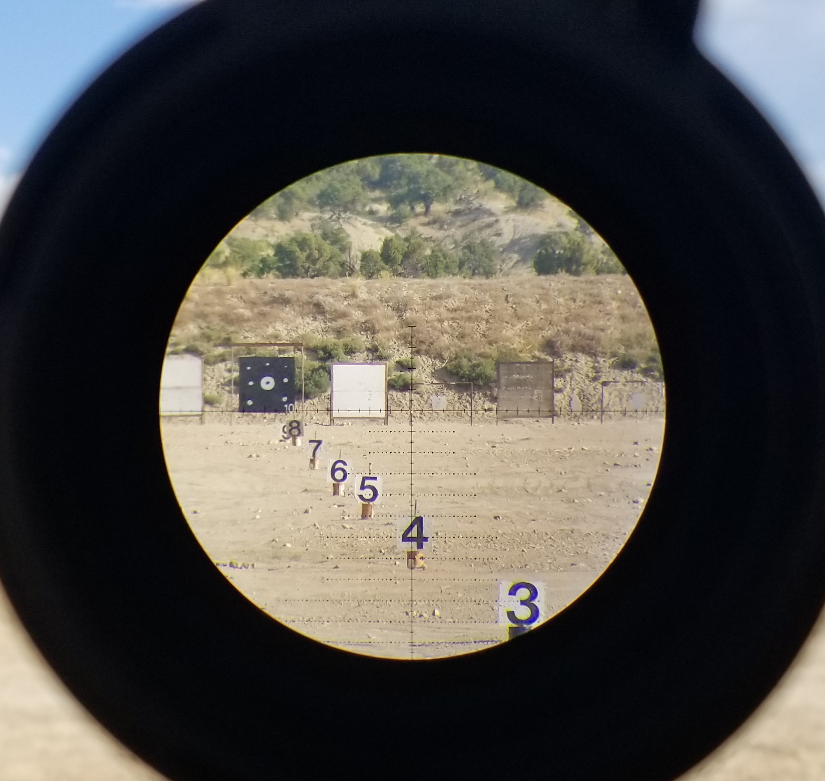

I cant speak for the 5x50, but i have the 4.5-30x56 and i love the reticle and the glass.
