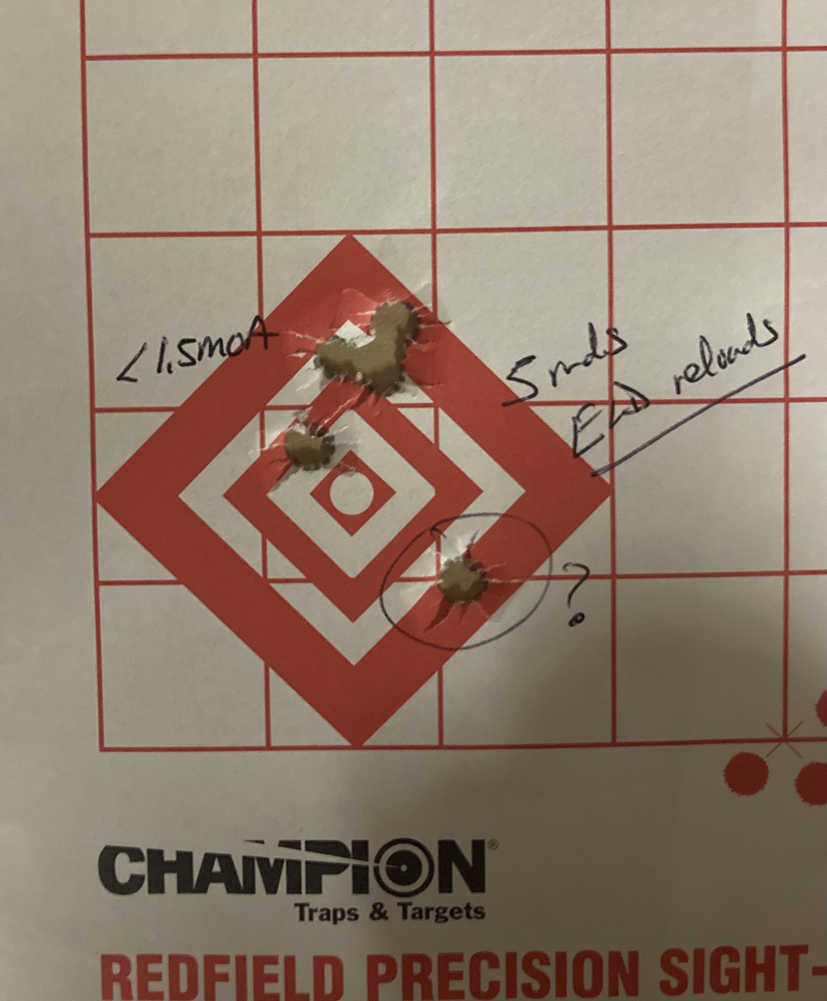

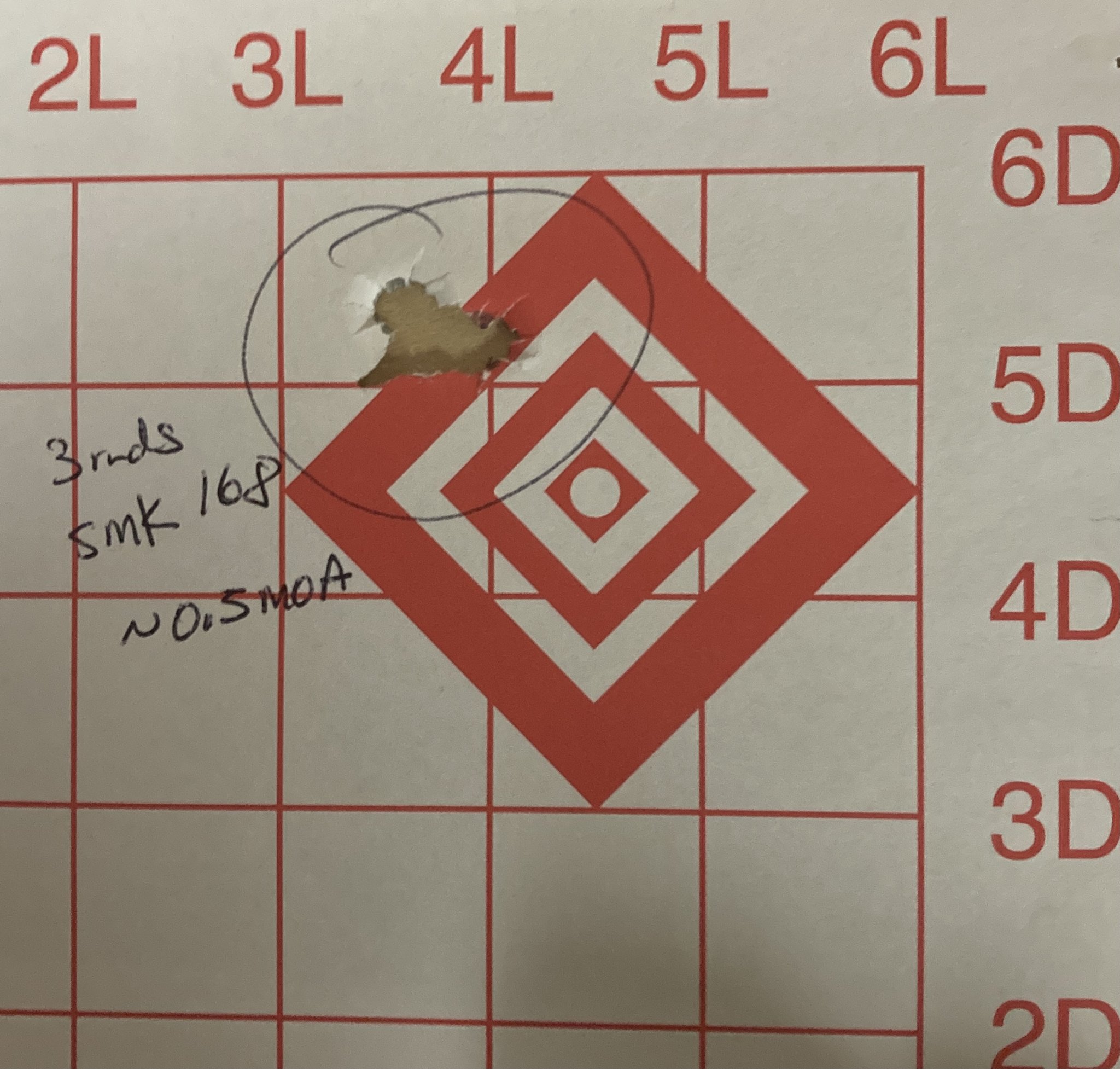

Working up load data for RPR 308 using CFE223 powder in case anyone’s interested. First pic is SMK 168, my reference standard. Second pic is Hornady ELD-M, 168 using CFE223, 46.5.46.6 grains, Fed brass, WIN LR primers, COL 2.800” nominal.
With exception of probably flier, I’m reasonably happy. Just sharing.
