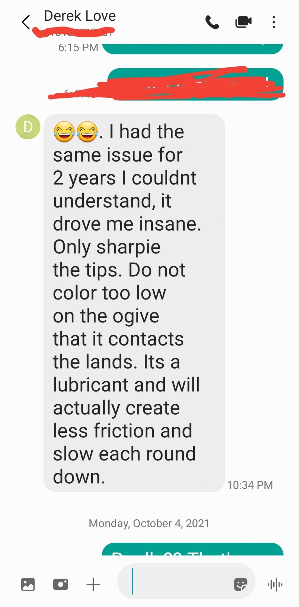

Ive never noticed the shift myself. And going back digging through my records I find some that agree with your hypothesis that marker slows it down and also some that dont because the marker is going faster.
But its always been a different weekend between the two events and not straight up marker vs non marker.
Guess I have a test to do myself in a couple weekends when I can get back to it on the bench. God, I hope that I cant prove it one way or another because its so damn convenient to have the holes colored.
