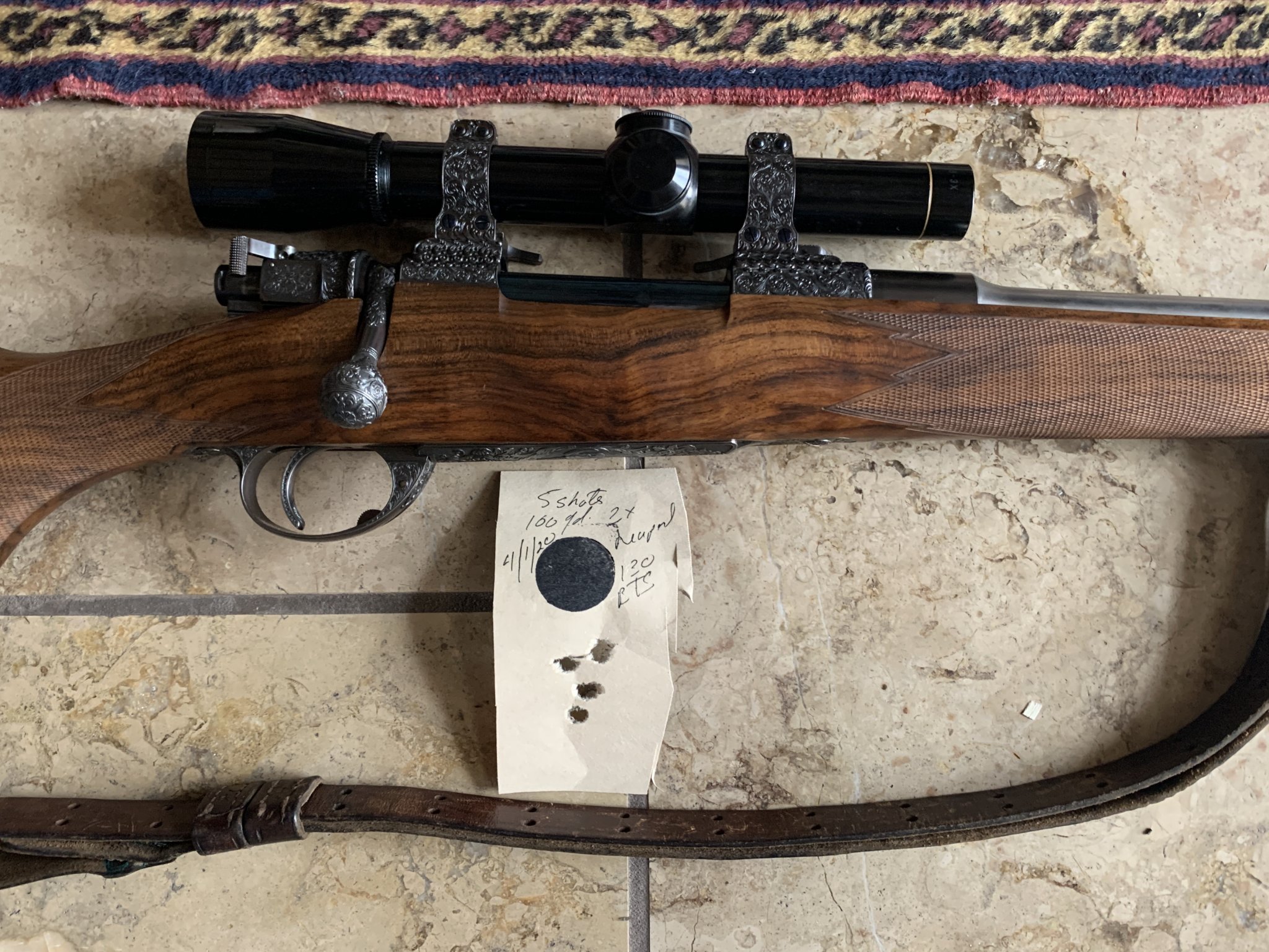

I have done just under 20 backpack sheep hunts. Also over 40 backpack hunts for other game.
Long range shooting is not needed. Heavy rifles are not needed. I see the reasons listed above. Get a rifle that weighs 7-8# for a 6mm-7mm cal and get good data to 500 yards. You won’t likely need to shoot beyond 350 but should have 400 yard equipment and skill set.
Below is a photo of my current sheep rifle. A few ounces under 8#.
It puts 5 shots inside 1” at 100 yards. Not super accurate but good enough for 4-500 yard shooting on rams.
Now just wait for the “selected group” folks to show up. I have rebarreled far too many hunting rifles on short notice to sit at a bench and shoot twenty 5 shot groups out of light sporters.
Oddly, in mountain hunting other factors come into play more than absolute accuracy.
Good handling, ability to shoot from odd or uncomfortable positions, ability to quickly get a shot off on a running wolf etc. Spare me a pig of a mountain rifle.
