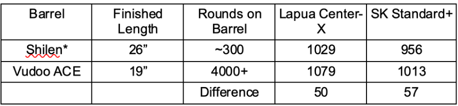

Does anyone have experience comparing velocity with a known lot of ammo in a Shilen ratchet barrel versus barrels from Bartlein, Vudoo/ACE, etc - especially Vudoo/ACE?
I am breaking in a new RimX build and have found the 26" Shilen ratchet barrel to be 50fps slower with my Lapua-tested Center-X compared to my Vudoo with 20" ACE barrel (1029fps vs 1079fps at 54 degrees F.). I have a slow lot of SK Std+ that's even worse: 1013fps with Vudoo/ACE, 956fps in RimX/Shilen (57fps difference). Please note that each lot's ES/SD values are very similar in both rifles; to me that points away from potential ignition issues.

Even allowing for additional length in a new barrel (<350 rounds fired), a 50fps difference seems excessive - I wouldn't even try to run that combination in a match. A buddy of mine has a 26" Proof prefit on his RimX, and that barrel shoots notably faster than his Vudoo with 20" ACE with the same ammo.
