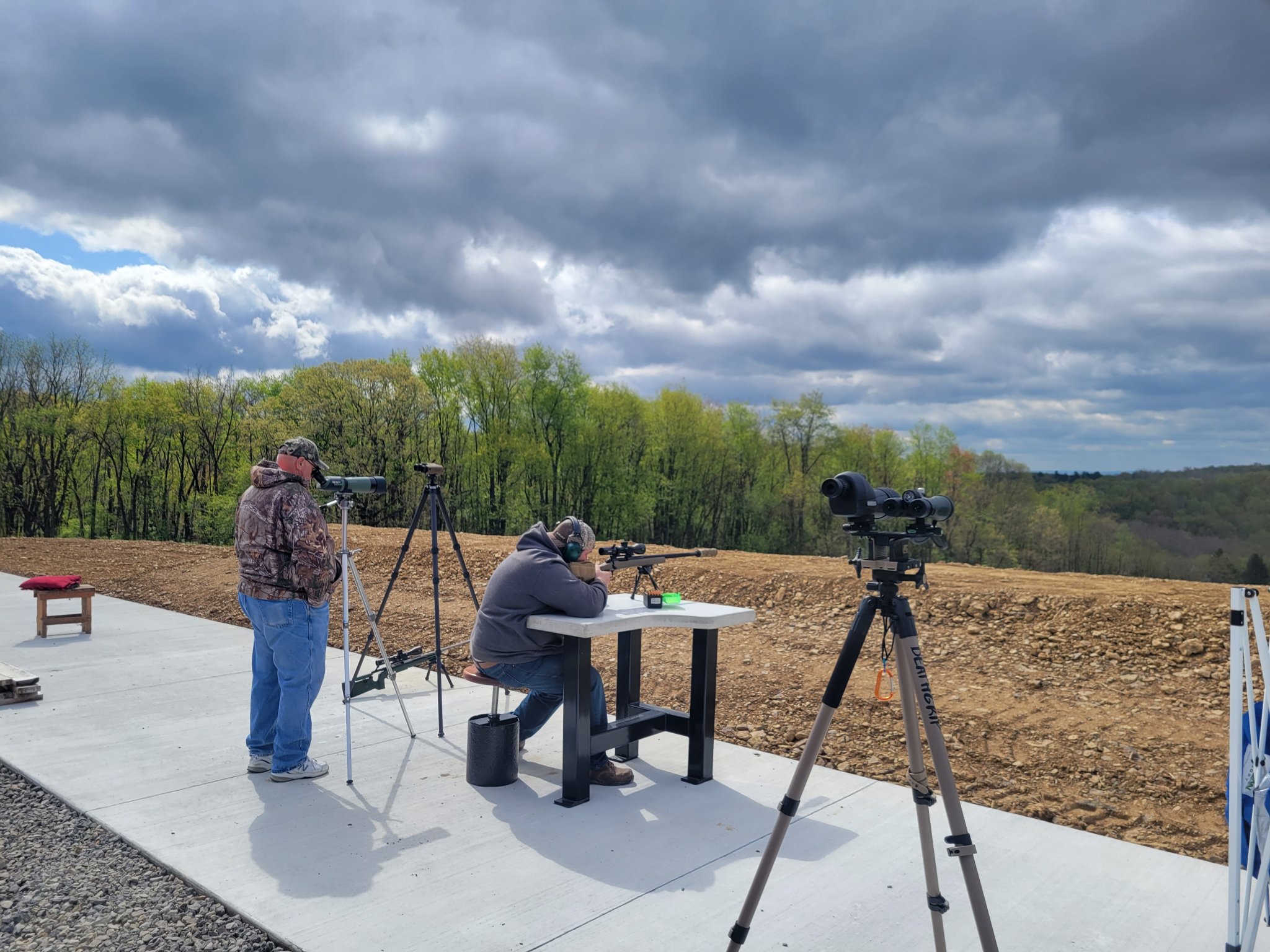

Unless you need elevation because of the terrain, I'd just pour a slab on grade and call it a day.

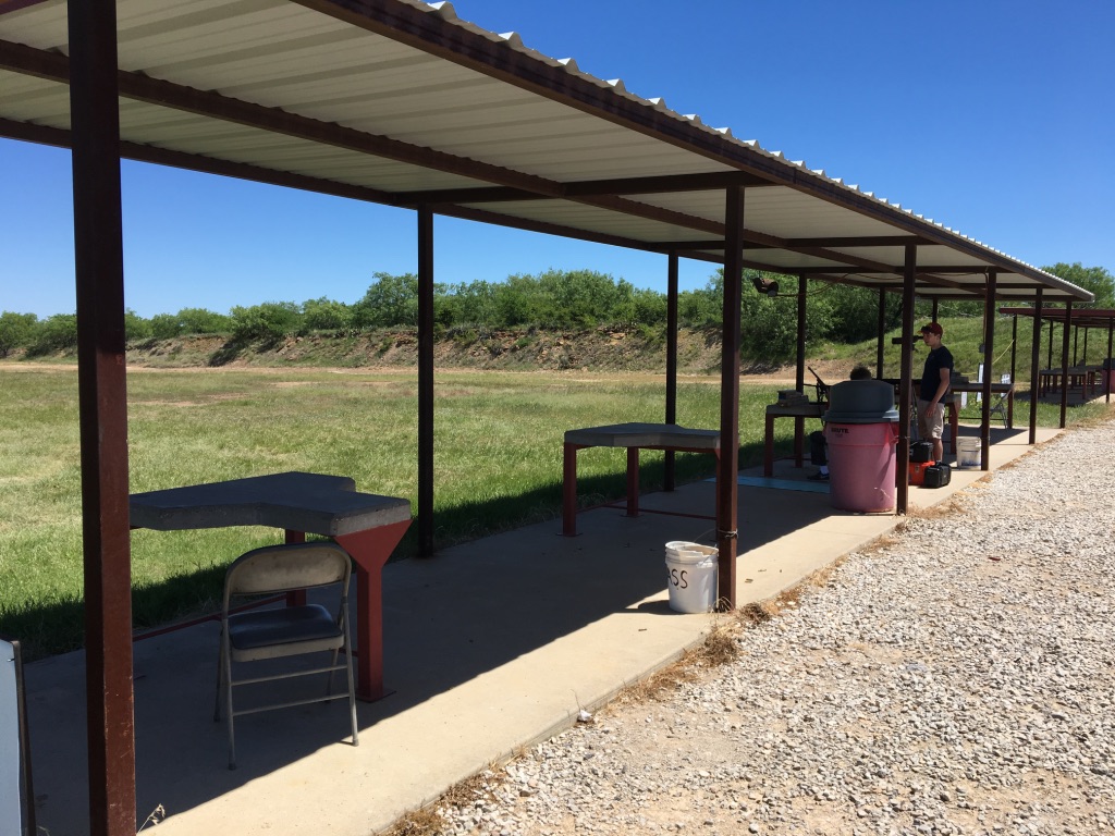

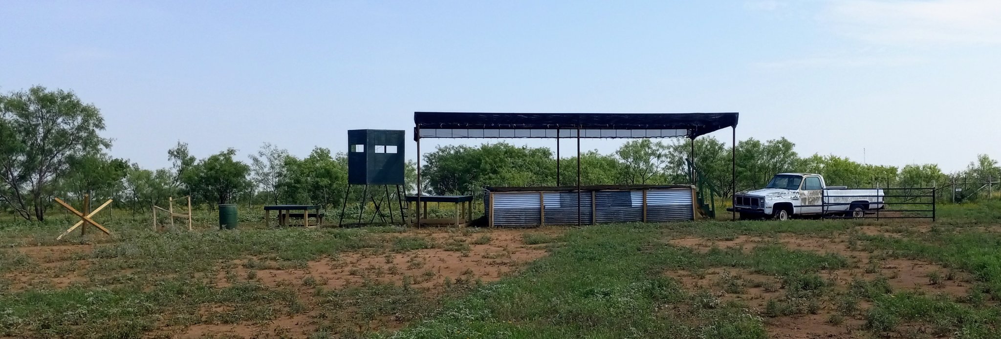

On a north facing range, I'd extend the roof to ensure that you're still in the shade depending on the angle/track of the sun.
There's a north facing, covered range that I frequent here in Texas. During the fall, winter and early spring. the sun can roast your legs and back because the roof is only about 8 feet from front to back.

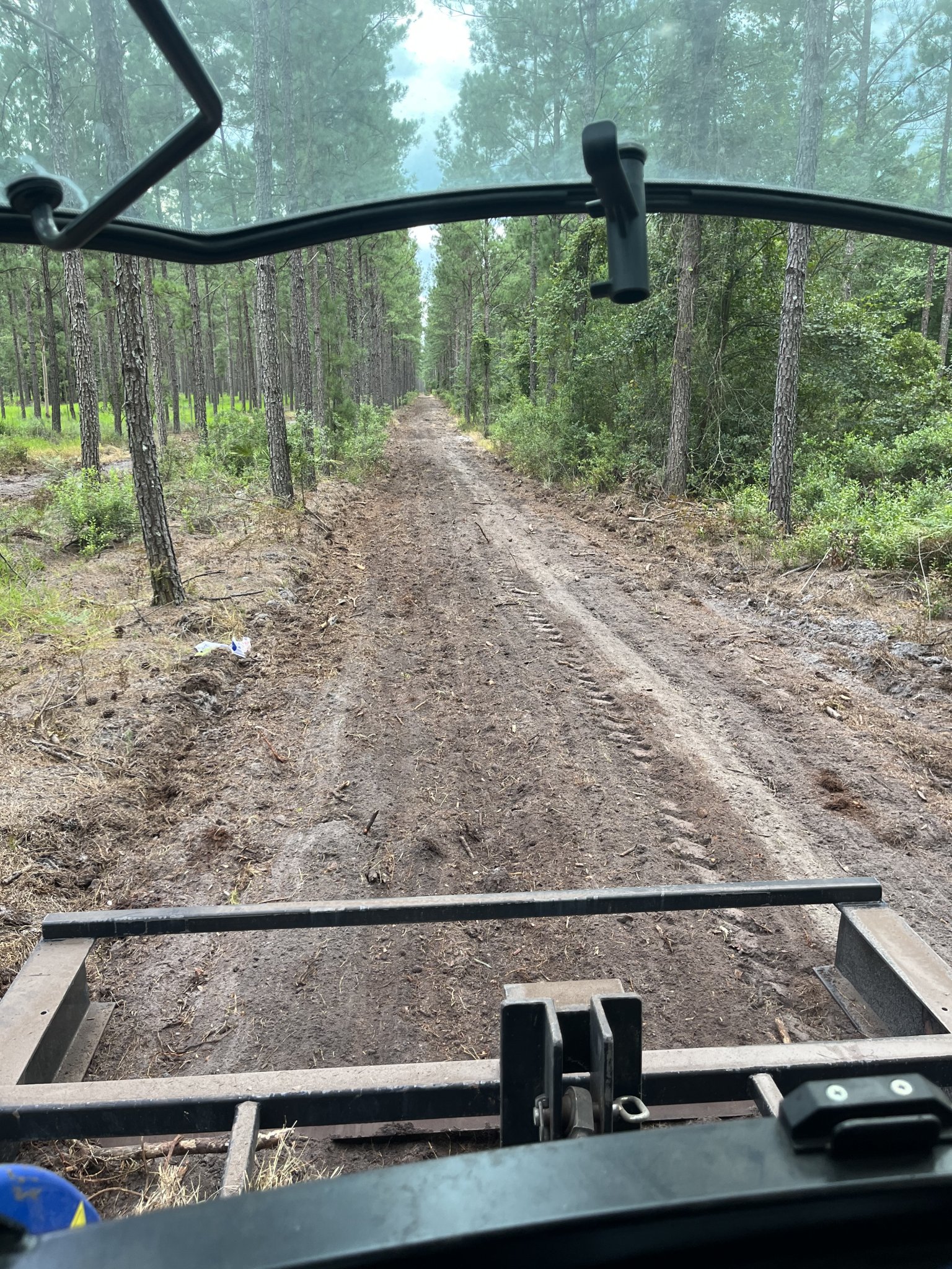

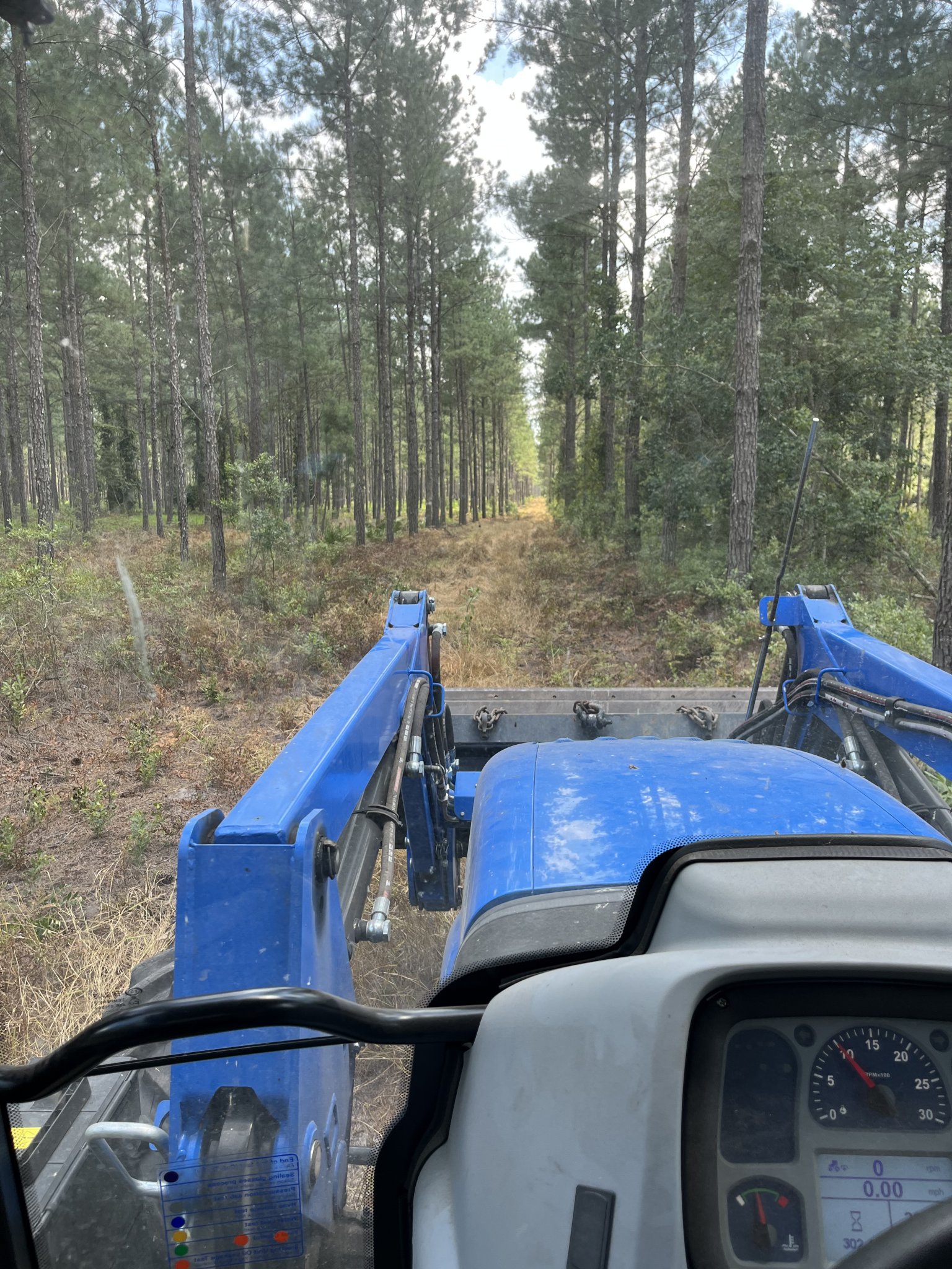

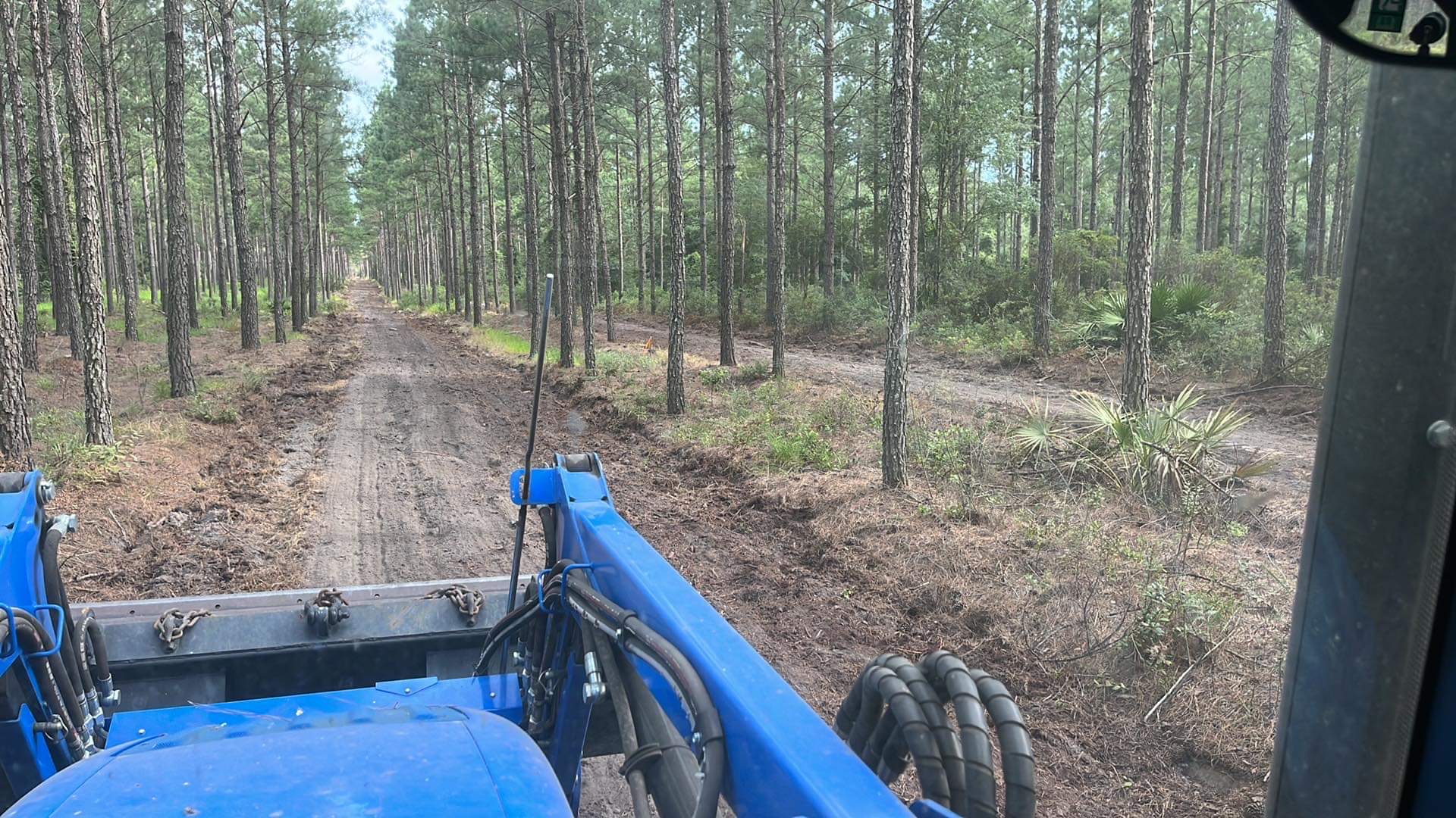

The beginning, after some time for the Herbicide to work. Going to work the dirt here for a road, then jump over and start working it for targets. After turning the dirt over I’ll run it with the land leveler. Next step, platform going up

Lanes clear and level. One will be a road flanking the range to drive to targets. I’m putting the platform at the far end close to the property line so I’ll be shooting into our property.
Don’t think I’ll get 1000 yards, it’s 976 to the back, but the rows start to curve enough you can’t get full use out of the plat form without being on the extreme edge. Looked like the best I can get will be 850 +\- 25yds to have full use of it.
Hope to start on the platform next weekend.

I did my prone berm elevated 4', essentially making it a giant planter box. Filled it with dirt and topped it with leftover turf from a local football field getting an upgrade. Its 12'x24' which is workable for 5 shooters with spotters behind. Did a 70% sunshade overhanging 3' on all but one side that's extended, so I can tuck props, table, etc underneath. Range faces South, which works fine in the terrain and wind pattern here.

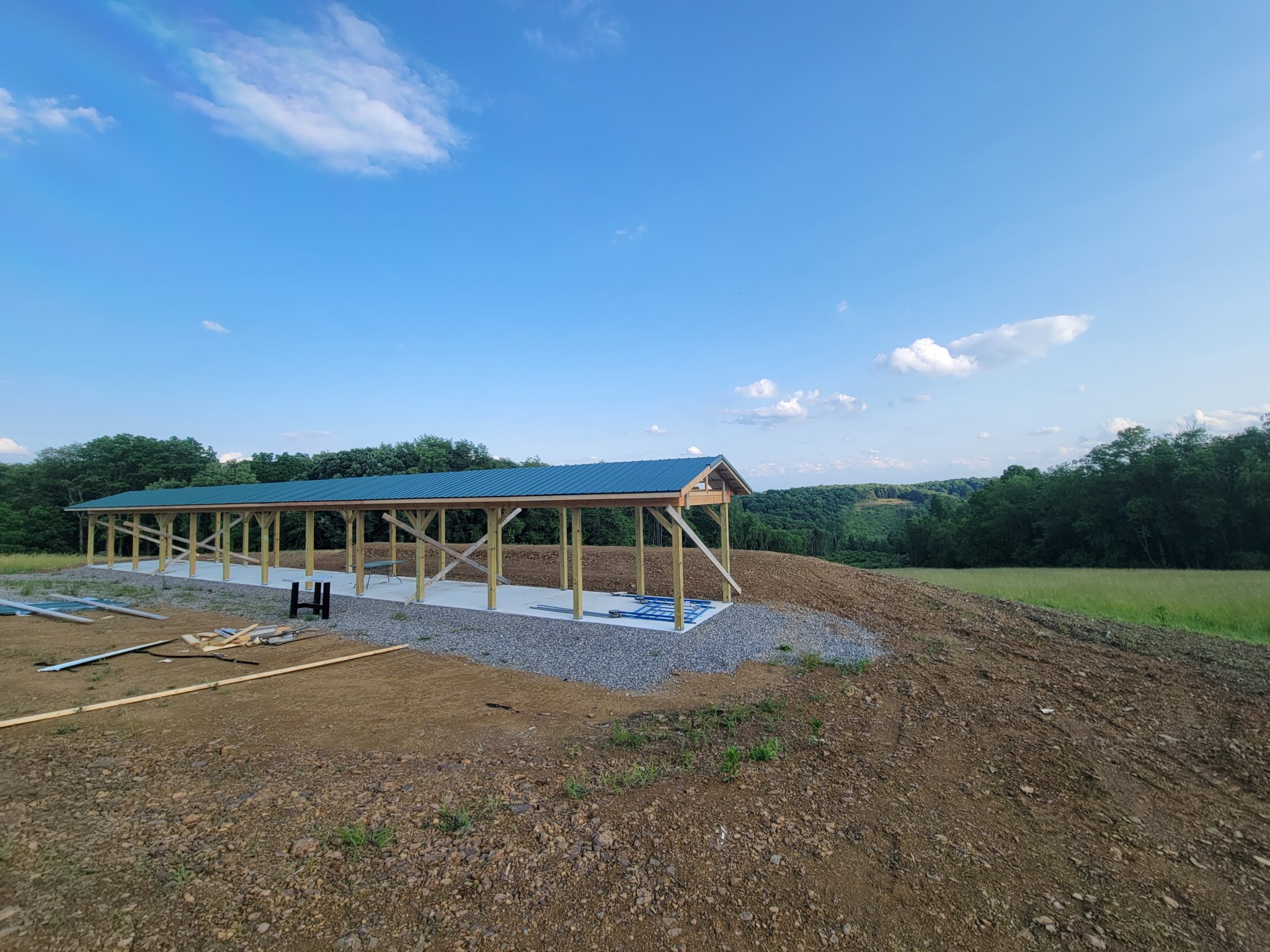

My brother drove in from base in Columbus, Ga to help me get the heavy lifting done today. Got to a stopping point where I can work on the rest solo in my spare time. Decided to go 16’ wide if for nothing else to have room for gear and 10’ tall to the plat form. Also going to run just a 4x4 post in the center on the front and rear floor joist support beam so i hopefully never have sag in it. Still a ways to go.
