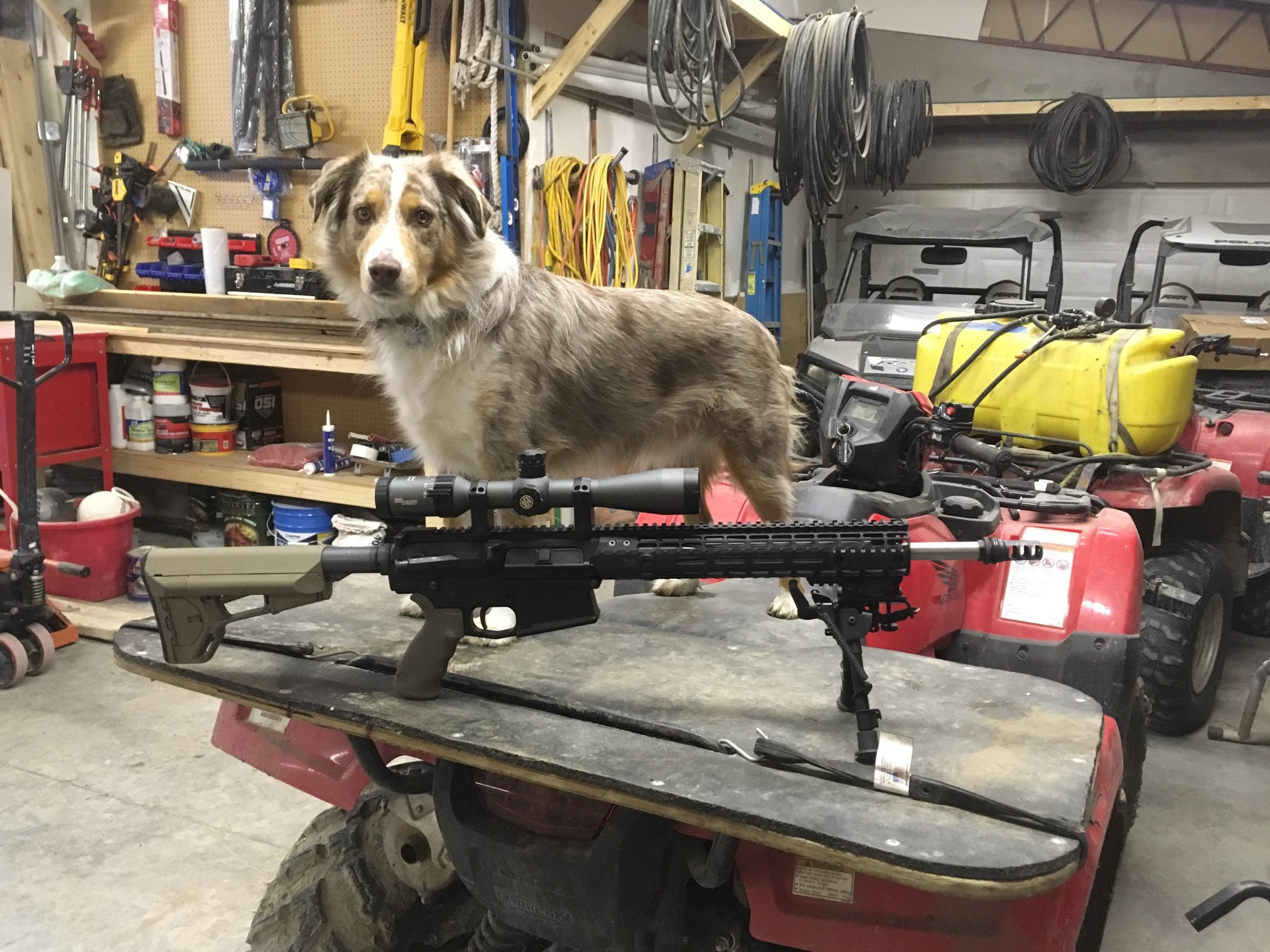

Just spun up a bartlein blank into an ar10 .308. 16" with intermediate gas system, h3 buffer. Used aero precision enhanced upper/handguard. It stacks them with a thunderbeast ultra 7 (as seen in the picture) and shoots 2-3" with a bare muzzle or with an asr brake. I have the slr adjustable block set to just lock back on empty without a can. It is was over gassed with a can, but it shoots really well. I also tried a standard buffer instead of the h3 and still shoots horrible without the can. Everything is free floating. Any ideas on what to do from here?

shoot it and have fun . if it shoots better with the can use it . nice looking gun and the hunting buddy , the dog looks ready to go .
I actually built it for a customer who doesn't have a can. He's not going to like it even if it shoots in the .3's with a can. Any ideas what the fix is?
obviously the harmonics don't match whatever you are shooting out of it, so maybe try a variety of brakes and see what works, or try different ammo.
Crazy idea that might help: Pull the gas block off and shoot it as a single shot rifle for group, to see what happens. If it shoots better than with the gas block installed- try a different brand/model of gas block.
