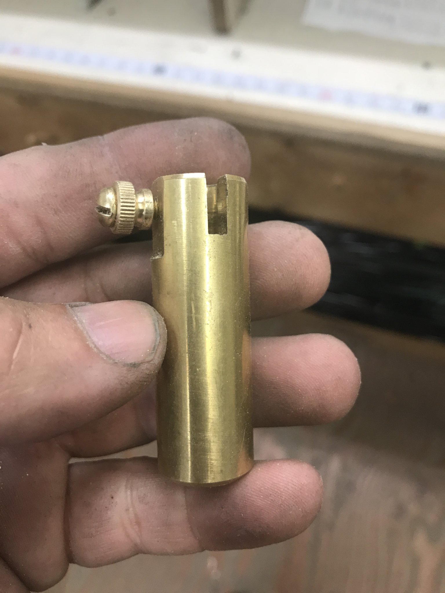

I actually just build my own but I believe it’s absolutely a necessary tool for high level reloading.
