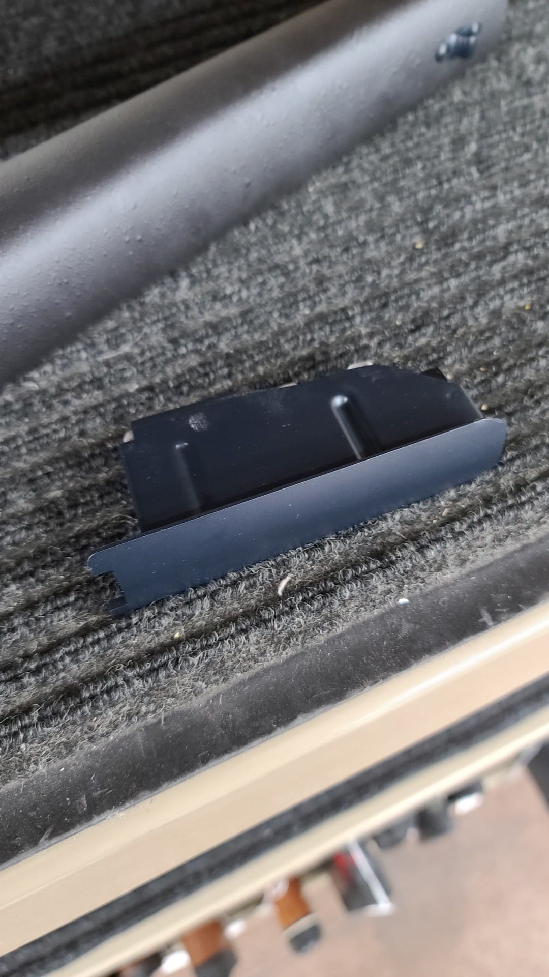

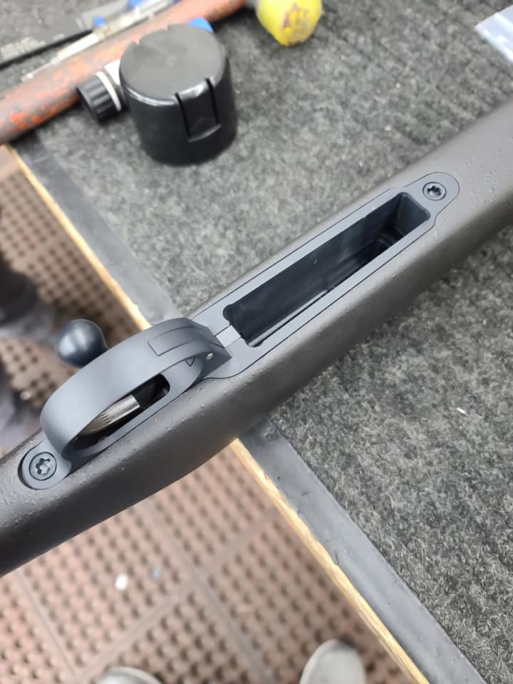

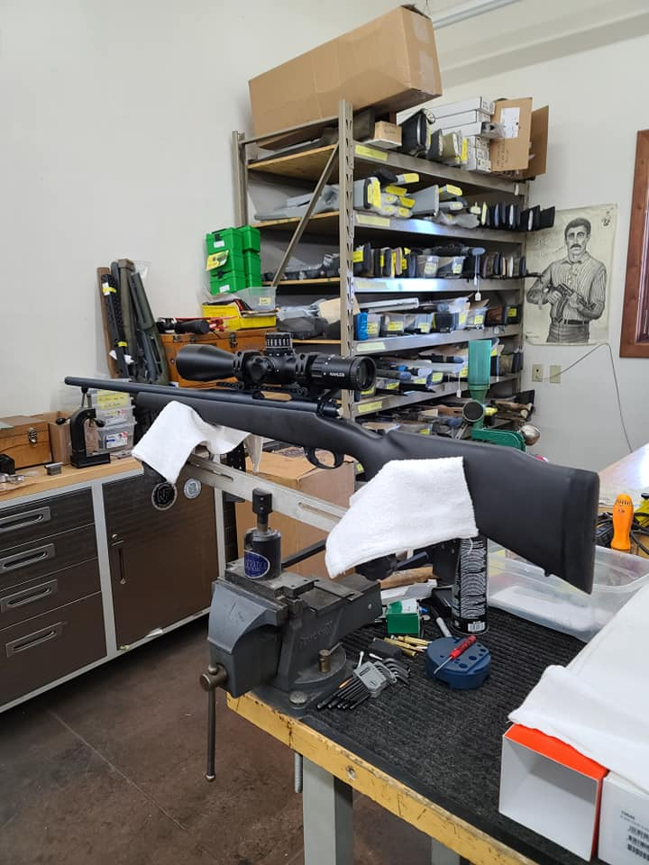

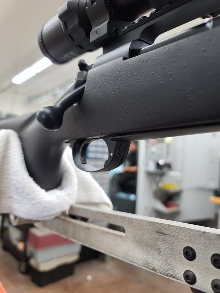

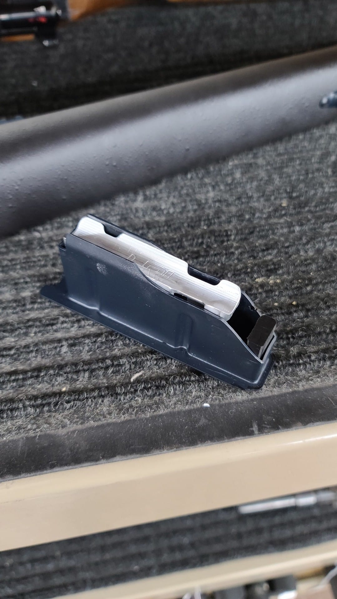

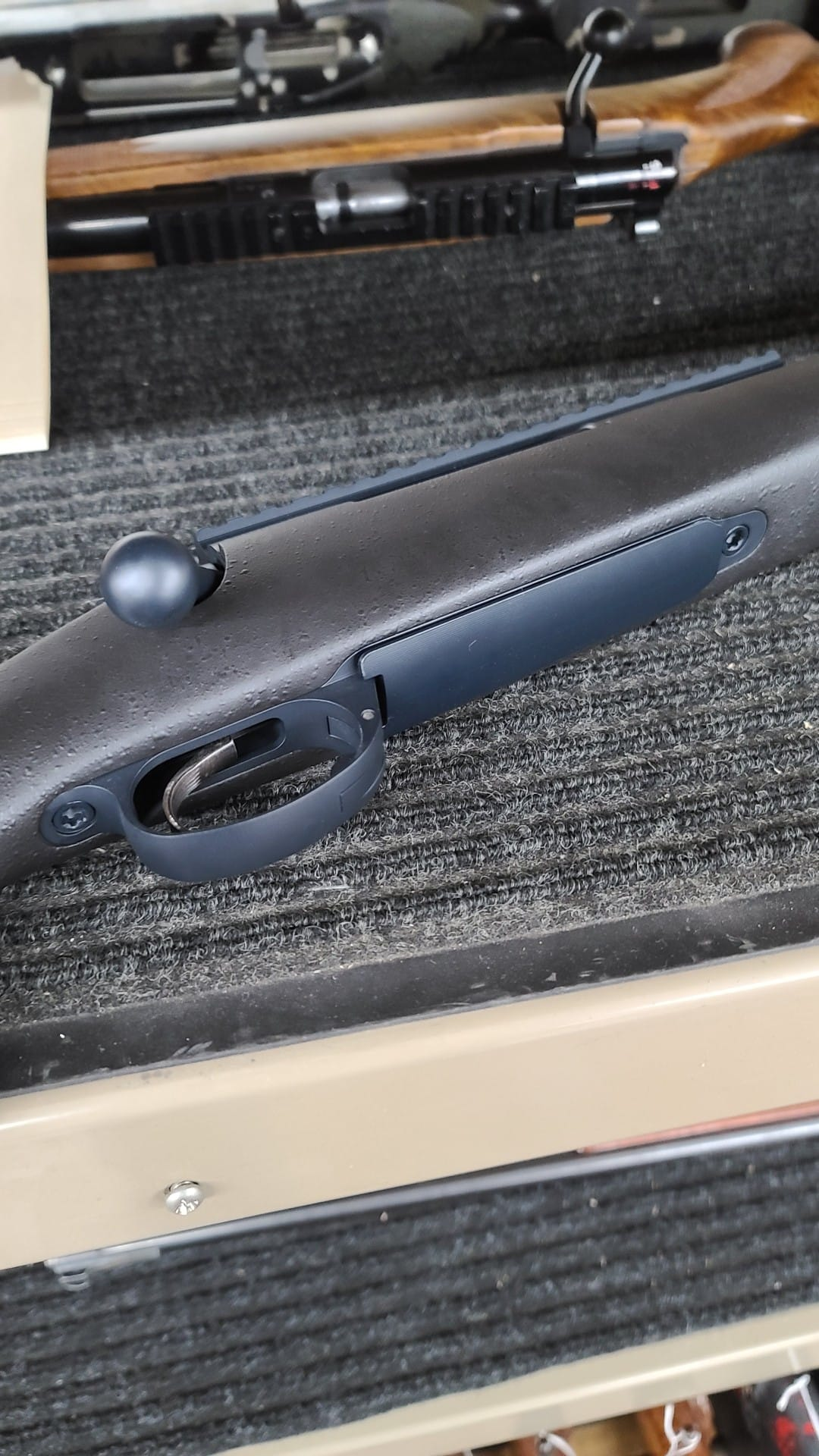

This is the rifle that started the project. I took a LA magazine from AI, whacked the bottom off, and soldered a steel plate so that it presents like a hinged floor plate. I debated on offering this as a std package, but the cost of having mag frames made for this was going to put the price in the "absurdosphere."

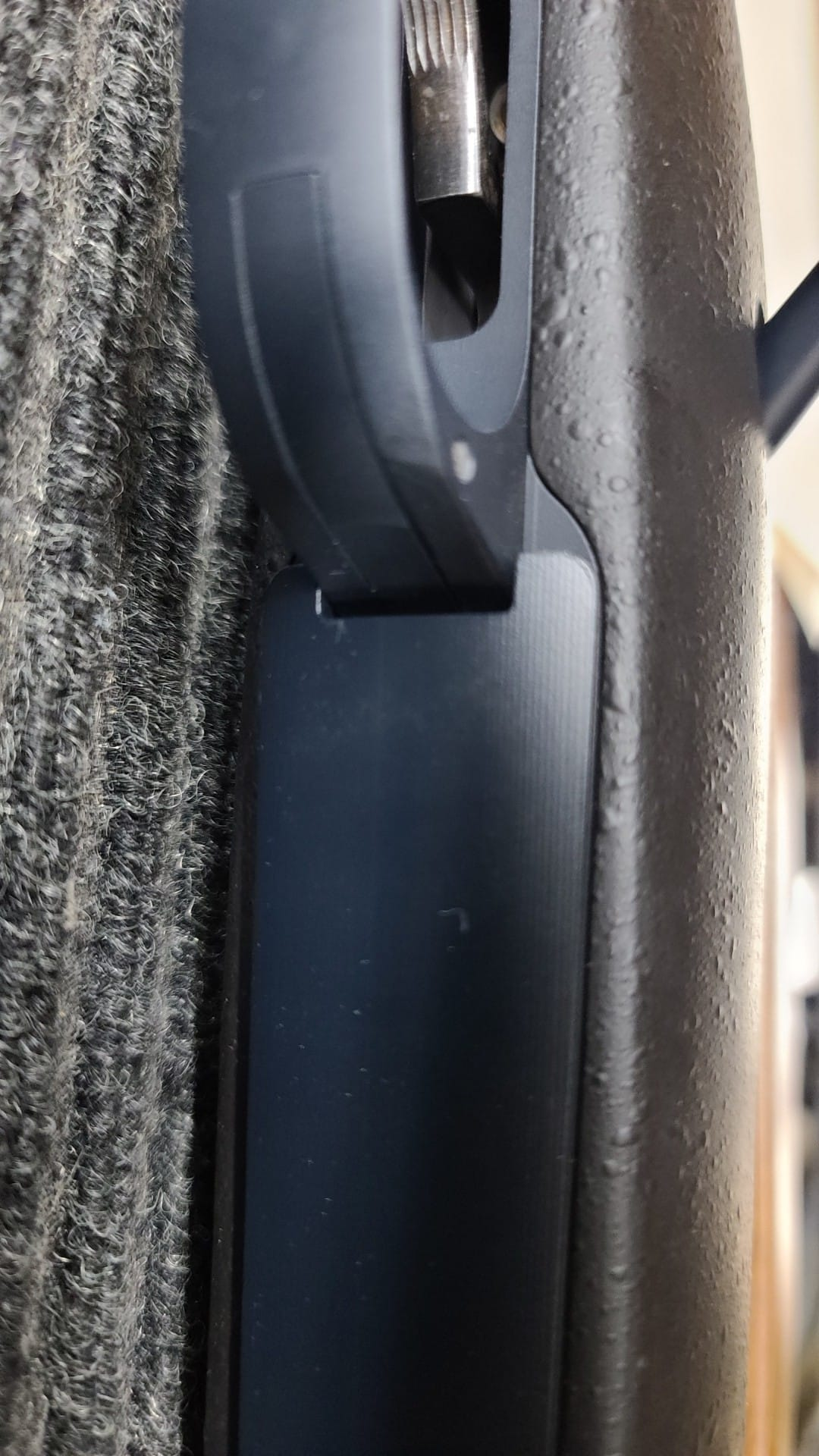

I was adament about avoiding the typical block of material the loiters in front of the trigger guard for the release lever. Instead, I went with a traditional Obendorf lever that drives a link that runs in a T slot. The link slides to/from the magazine louver on the back to retain/release the magazine from the box.
The magazine photo:
I agree; it looks a bit weird. This rifle is a low-digit clover tang. I was not about to cut it up for the sake of a magazine. Instead, I put the front of the mag box on a diet so that it'd clear the start of the magazine mortise in the receiver. It was the lesser of two sins this way.
I've got LA stuff on the shelf. Someday I'll do a SA for the F/N SPR, but it'll be awhile.
I'd love to say I'll get them on the store, but I know that won't happen today.
The magazine photo:
