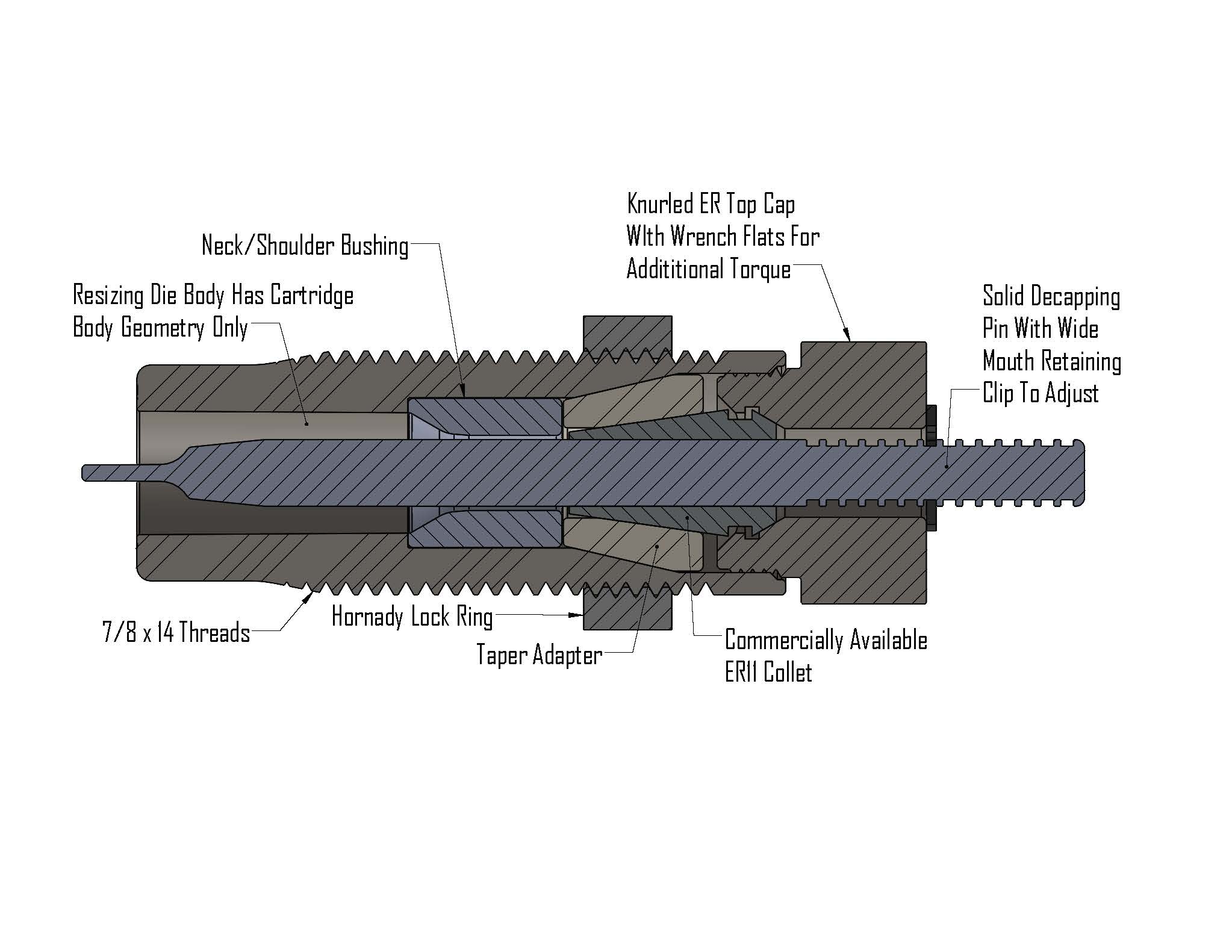

    Setting the die up to begin sizing operations was a breeze! There is some incredibly innovative tech buried in these sizers. Take a look at that unique expander/decapping assembly. The decapping rod is a nice .2355 dimension, so it's not letting the brass just flop around all over the place. It has a nice contoured bottom to ensure you won't smash the case mouth on your brass if for some reason things get off center a bit. This is a nice touch. Some other dies tend to have an oversized flat bit right next to the decapping rod which conveniently bashes the top of the case mouth and ruins your brass if you aren't super careful when the case just starts to enter the die. If that isn't cool enough for you, look at the way the assemblies are held. The top of each rod is depth set by an e-clip/groove interface. Super basic, but very functional. Then the stem itself is held into the VERY center of the die body by the use of a collet/taper setup. The collet puts the squeeze on the rod when the taper is locked down against the top of the bushing. The tighter you put the top on, the more the rod is squeezed! That old problem of having your decapping pin drift off center? Yeah, that's gone with this setup. Everything is held firmly in place and perfectly aligned. I didn't have the top screwed on tightly enough and went to resize a piece of brass, and instead of knocking the primer out, the pin was pushed up through the top of the die. I could visibly see it raise and it took just a moment to unscrew the top, pop the taper loose, re-seat it, and tighten the top back up. This demonstrated that if something does go haywire, you won't mangle your decapping assembly like you would on other dies. It will just get pushed up out of the top of something goes way wrong. Excellent design!!! High marks on this for sure.

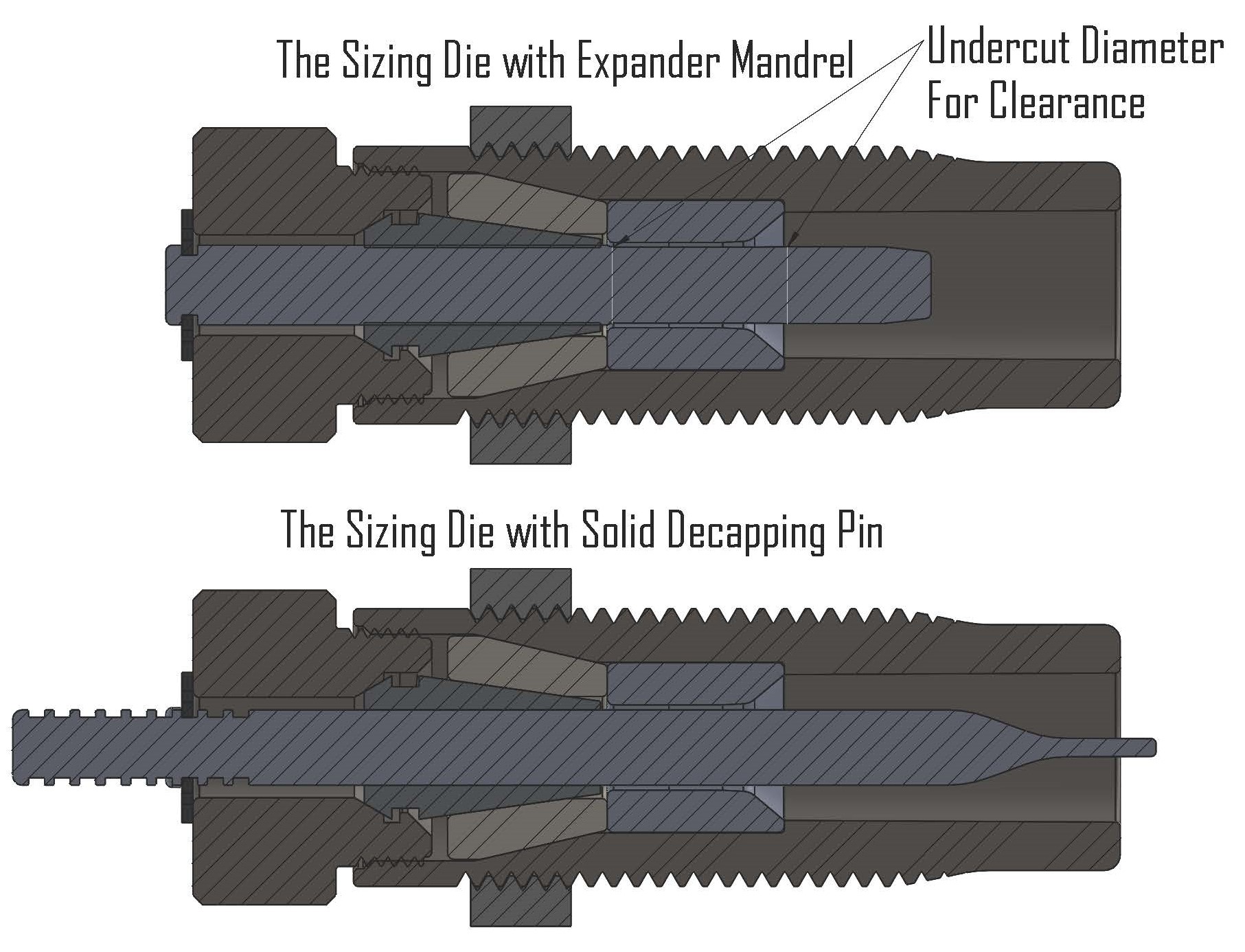

    For the mandrel - I just looked at the gram. Is the intent two steps at once, or two steps with one die?
    It looks like a traditional mandrel, I'm not sure how that would work since you'd have the mandrel holding the brass from the inside while the busing is also trying to squeeze it from the OD, unless you have a real ID/OD balancing act going on. For contrast, the Mighty Armory 'mandrel' still has a relief above it, so the neck can be sized down before the full diameter ID portion is pulled through (like an expander ball, but longer and not ball shaped).
    I designed the Expander Mandrel system to have the ground expanding detail to be right under the neck with the portion inside the neck ground smaller so even with the smallest bushing, the expander would never touch the inside of the necks. Here are two sectional views of "The" Sizing Die in a Dasher configuration. One with a .2405" expander and one with our 6mm Solid Decapping Pin.
    Keep in mind with our ER11 collet system, you can secure the Decapping Pin or Expander at any location of the ground straight diameter. So you can move the expander up and down to your liking.
