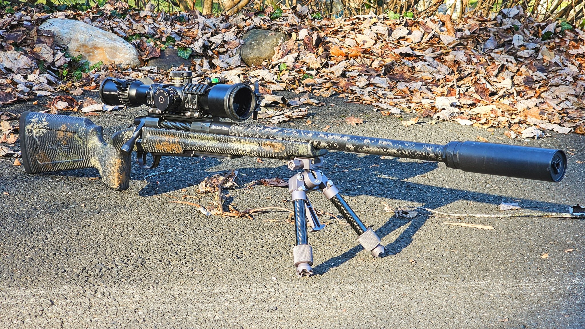

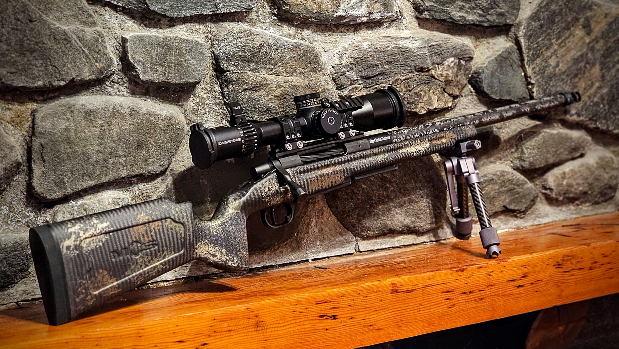

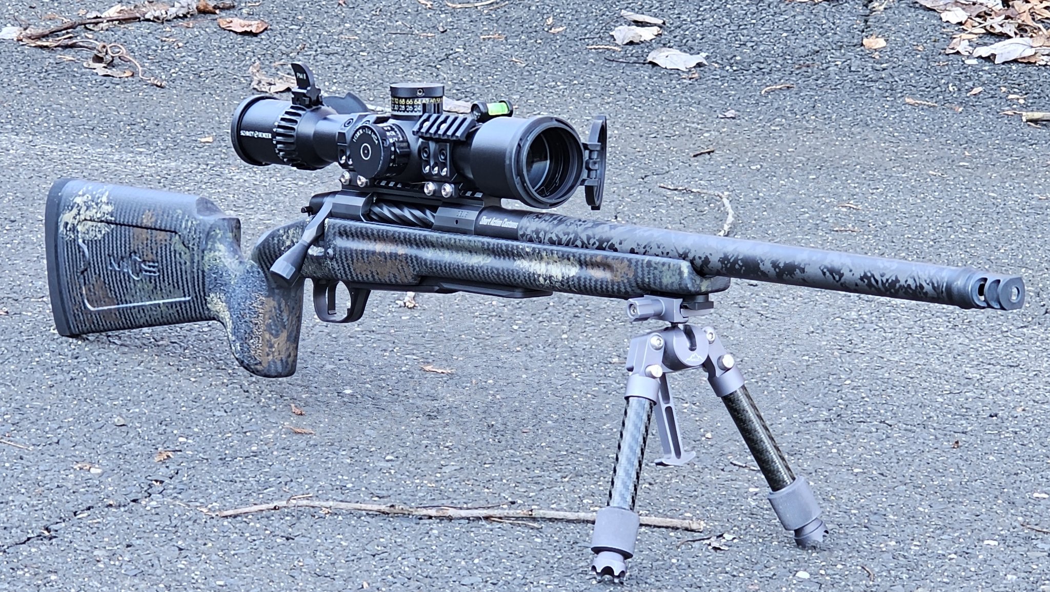

Update for anyone interested or following, I ended up purchasing a 1:8t 20 inch 30 cal proof blank during black Friday deals, and it is now on its way to be chambered by SAC. I'll post up some photos and data in the coming months when I get it back.
It's here. 20" 1:8t AW2 300 PRC. Feels incredible in the hand, I'll follow up once I have a chance to do some load development and take her out to 1100.

Very clean. Almost identical to mine but different action.
Loving the Ti bolts too 🤘
Thanks brother. Really happy with how it turned out, your commentary definitely was a driving factor in going 20" . Here's a few better pics:
Man those Ti bolts, I still get 2 pms a week asking about them. When I have some free time in life toward the end of the year I may do another batch. We'll see.

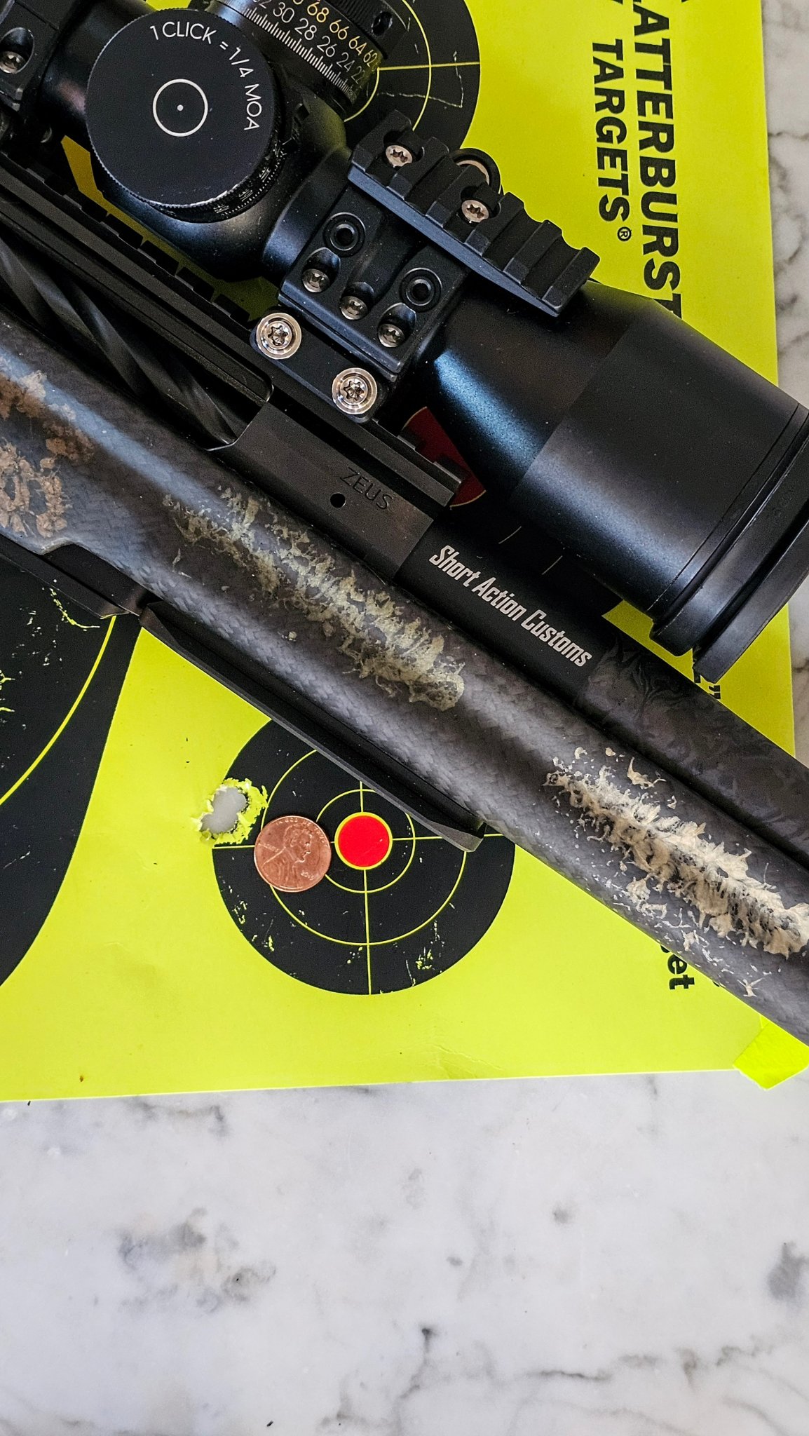

Shoots insanely well. Beyond happy with this thing. Feels like a cheat code in my hands. Huge thanks to Short Action Customs and Terminus Actions.
