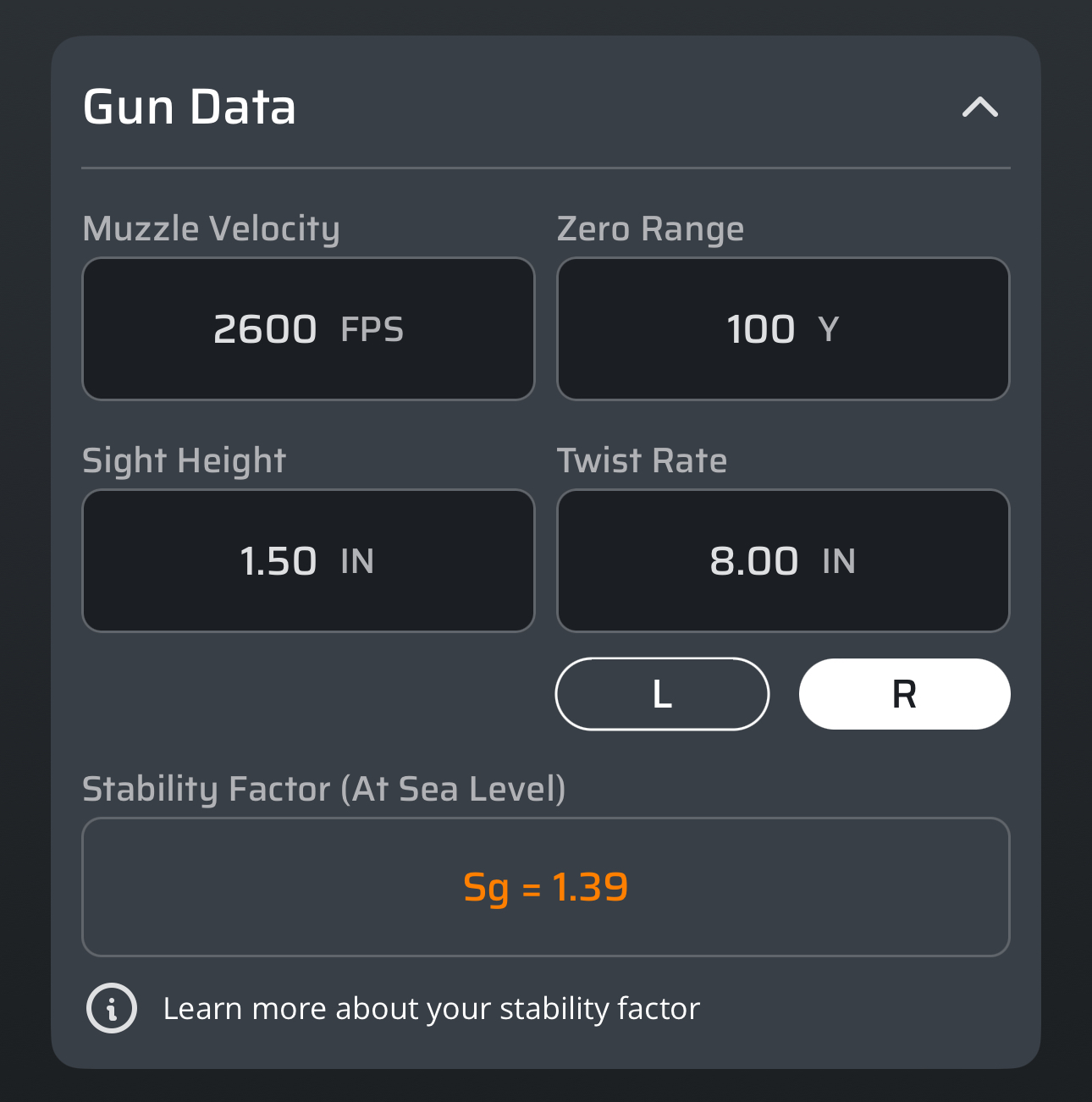

Not a reloader so plan to use Black Hills 147gr ELDM-they list 2700 fps
What twist would be best for that?
You probably won’t get what the box lists, especially if you get 16in. More over there can be variation from lot to lot.
If you get 2600 with an 8 twist according to AB Quantum your entering stability issues with 147 eldm.
With a 7.5 twist you would be over the desired 1.5 according to AB.

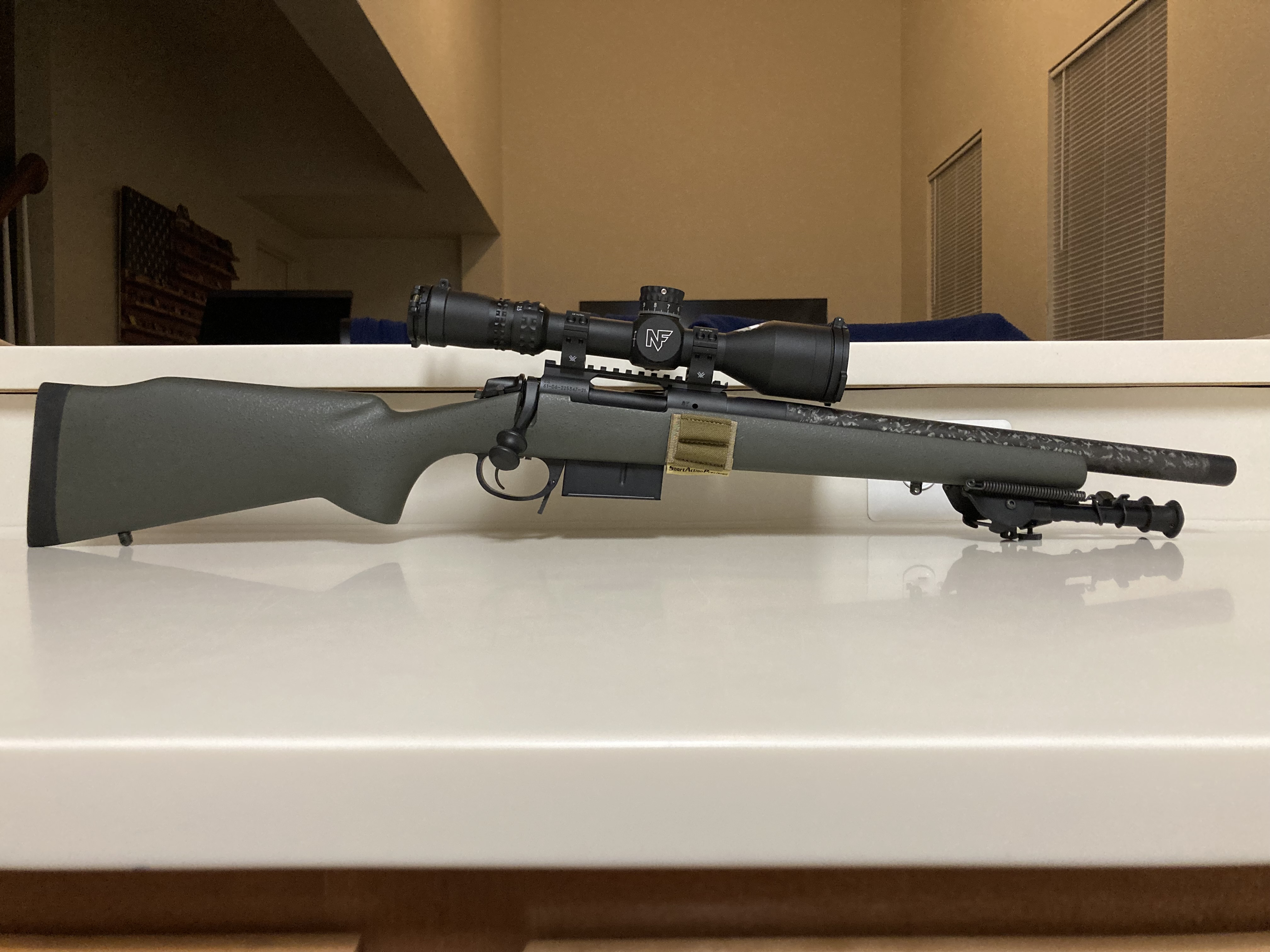

I have a Proof CF 6,5 creed at 16.5” length.
Bought a blank on a great deal on here and had my smith chamber and thread.
Just breaking in and its shooting very well.
Plan is to run 123 Absolute Hammers and see what speed I come up with.
Prior 16.5” was 2840 fps with a 123 Scenar and h4350 below Hodgdon book max.
Accurate and single digit SDs.
This CF barrel will be for suppressed hunting only.
Loads of fun. Easy to shoot.
