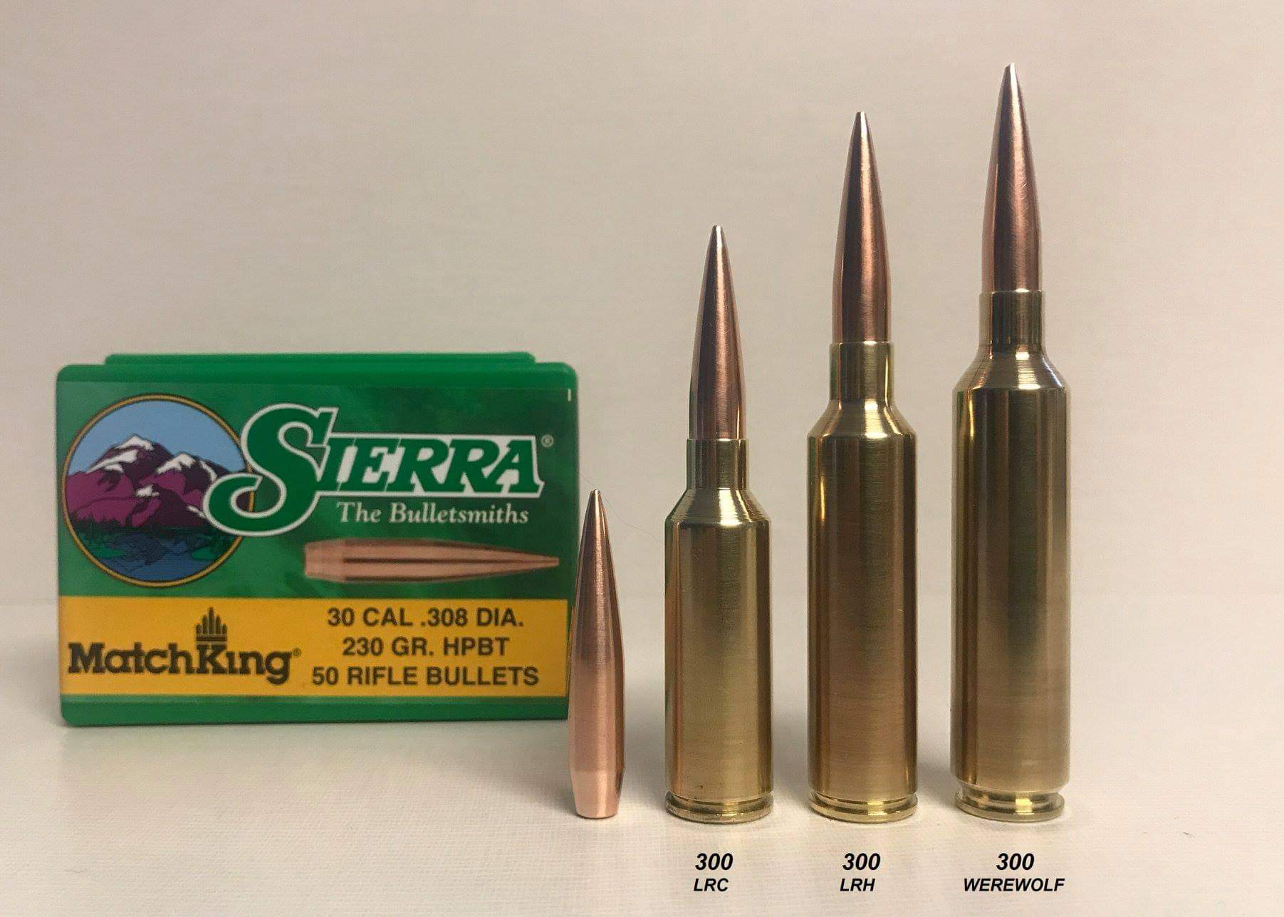

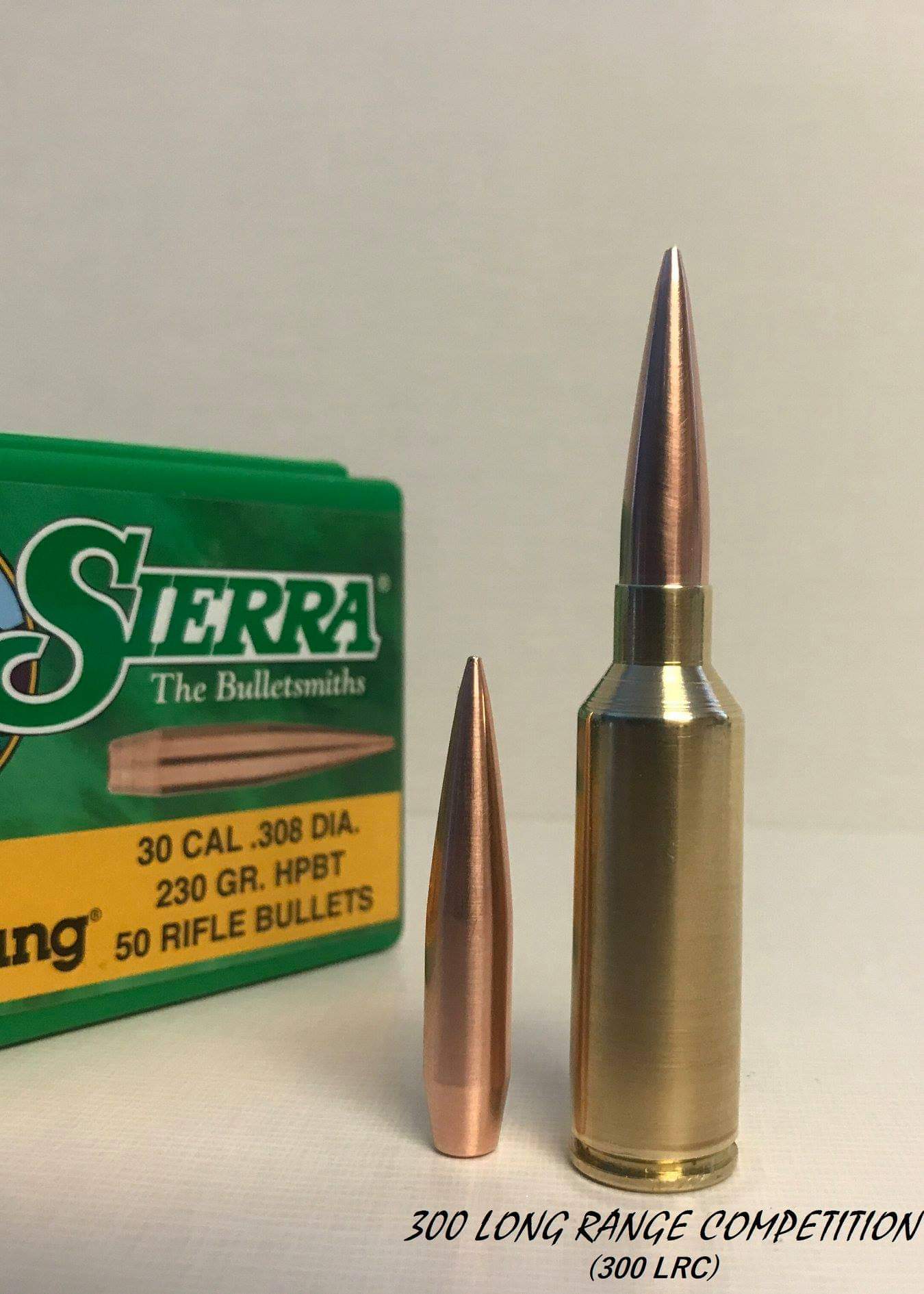

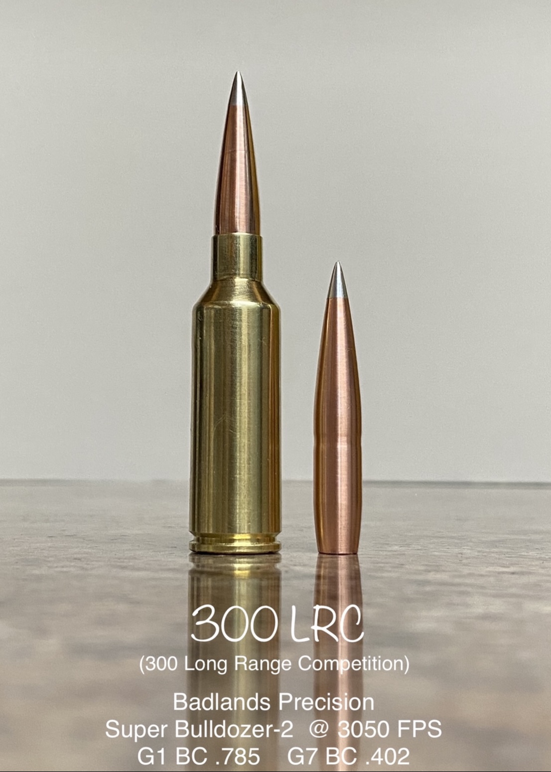

my 300 LRC is a modification of my 300 Alaskan Short Mag wildcat, it's a 338 Lapua case chopped to less than 2", also use 300 & 338 Norma Mag, 423 Dakota brass and have factory made headstamped brass by RCC, 300 LRC reamers are available in two versions , one is for short actions with a 308 Win match throat and the other is for long actions with a long throat that has shown extreme velocity & accuracy with heavy for caliber bullets seated way out in my 300 Long Range Hunter (300 LRH) ..... the 300 LRC is shown here with my 300 LRH from 2014/15 , my version of a 300 Norma Mag Improved (and wow ! there are so many imitations now... that I've completely lost interest in the Normas ) and the 300 Werewolf... now redesigned & renamed to 300 Wolverine , due to conflicts with an older "300 Warewolf" wildcat , basicaly 308-500 Jeffery Improved that I did back in 2013, has 142 gr h20 capacity and has big brothers in 338 & 375 cal

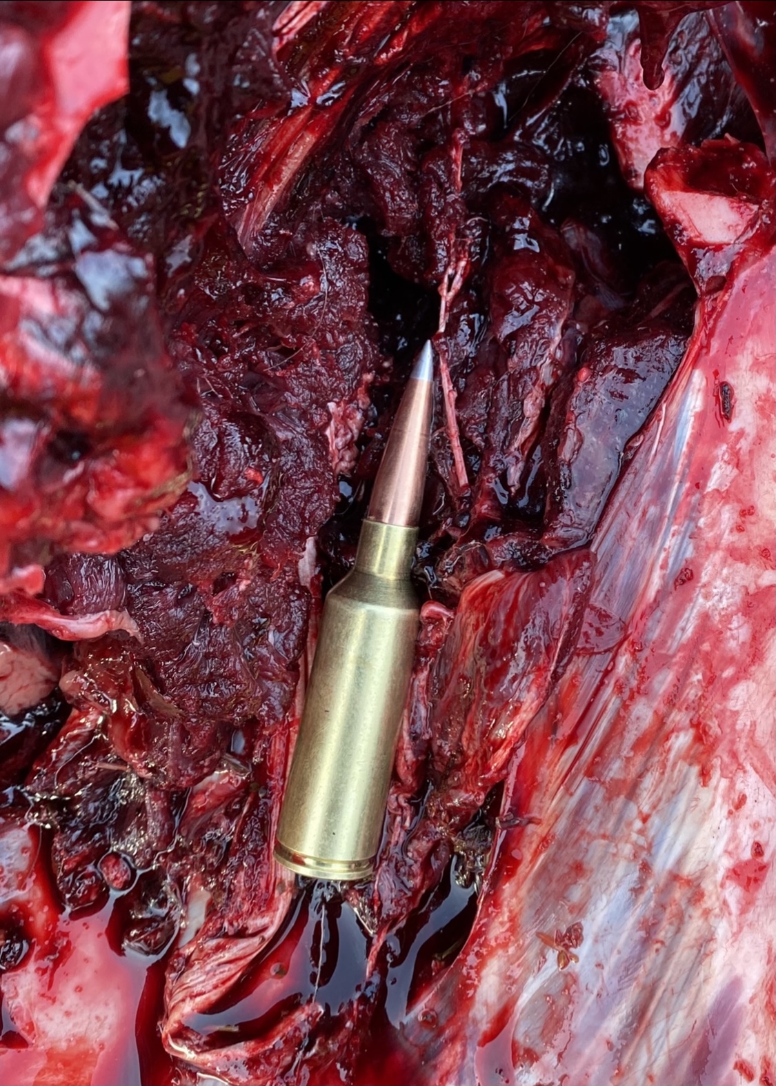

I used the 300 LRC and a Badlands SBD2 205 gr bullet on a moose from the first batch of 100 pcs, that they made for me this past September
fantastic hunting bullet at 300 WBY velocities from a case less than 2" in min trim length
personal project that has been in the works on & off since 2011-12 with a number of chamber/reamer modifications to this final form
