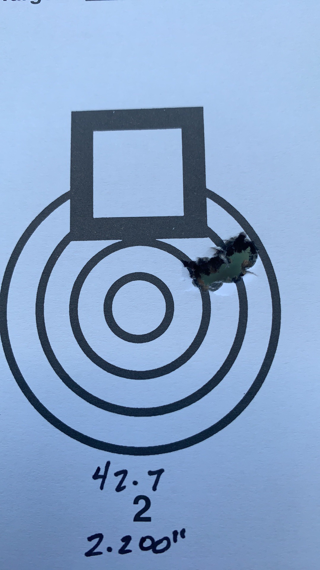

I have a .260 rem gas gun with a 20” Lilja barrel. I have been running 42.7 g of H 4350 in lapua cases with 136 gr lapua scenar l’s that have been pushing 2719 with a Sd of 6 and an Es of 13.
The only two issues is 1) even at mag length, the lapuas are hitting the barrel prior to chambering when feeding through the feed ramps...
And 2) due to the weird pressure curve in gas guns, I am beating the piss out of my brass (ejector swipes). I still have great primer retention, but I think it’s just gas gun issues. I am no expert, but i think you might have more luck pushing higher pressure/velocity with a bolt gun. If you start load dev and run an ocw or similar test, you should be good.
I just grabbed 4lbs of Reloader 16 and am reworking loaded with a 120-130 gr eld m. Hope that helps
