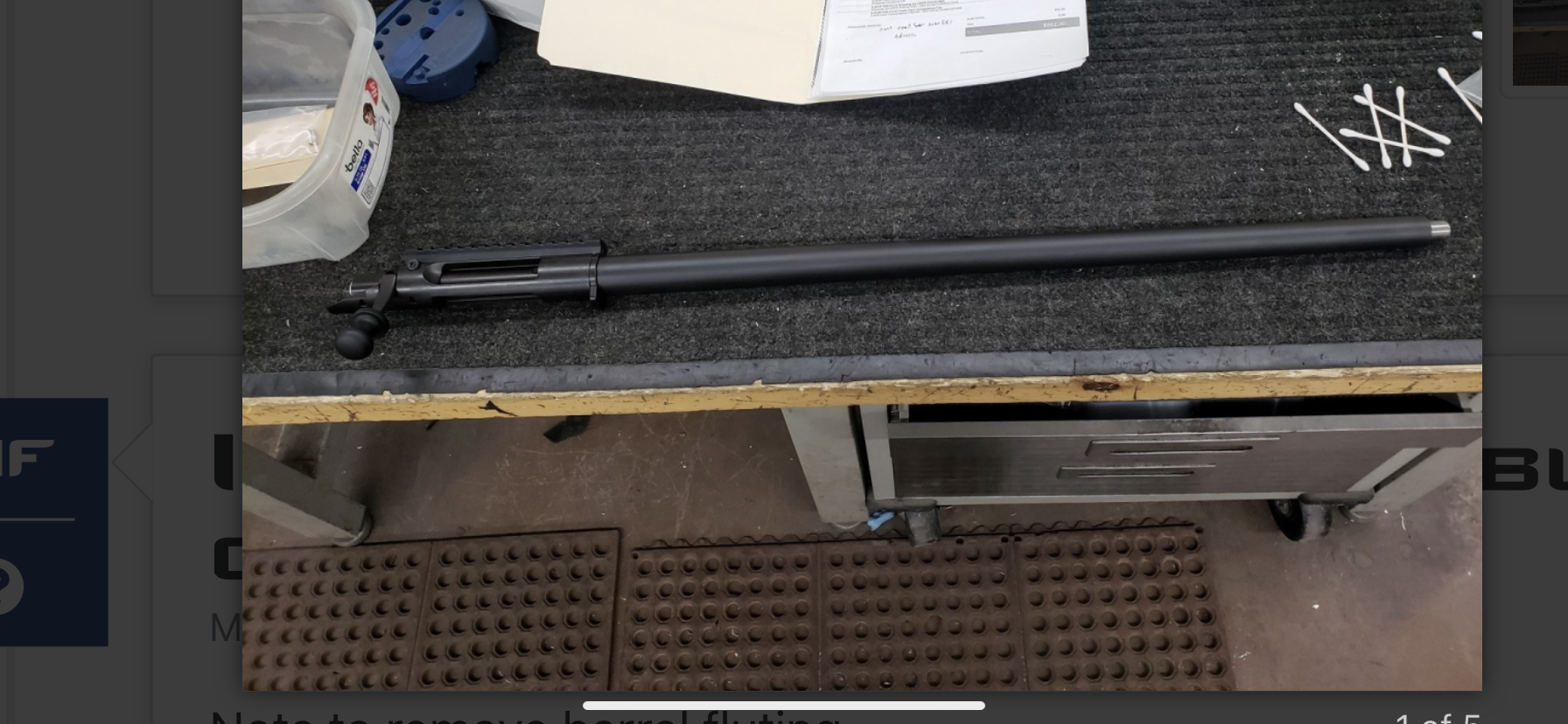

I have a 300 wsm, but its a factory barrel with a slow twist and I cut it down to 16 inches.
I will be barreling to a 16-18 inch 7 saum. The ballistics are just better with the 7 saum, you are going to have less recoil (Only really important if you are running a lightweight rig like mine), its more efficient, I'll have more energy at 1200 yards than the 300 wsm.

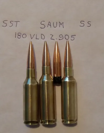

That is great insight. Thank you for sharing. I think I will go with the 7SAUM then. I do have a short action that I will be selling. I could always just re-barrel it, but I am a little worried about running heavy bullets and running into feeding or magazine issues. Maybe it would be better to just start over?
This is a very interesting wildcat and it’s new to me. The velocity Is pretty attractive. Any real world experience on feeding and extraction in a repeater?
@BoltActionBrotherhood - raised a good point. Medium action for the Saum is better.
The SST has a 30 degree shoulder that is pushed back a little to optimize for short action mag feeding.
For a short light hunting rig it's a legit consideration.
The other upside is, although it's a wildcat Sherman has ready to load ADG brass & dies in stock. 25 cal bullets accept Blackjack are in stock.
LRI test fired mine (ARC Nuke 7.5T Bartlain) with a piece of brass Sherman sent him. Just loaded and fired, no crazy prep.
Hunting bullets available from Berger, Hammer, PVA, & hopefully soon 131 Blackjack/Sierra

You could go 7mm SST if you want more thump, the smooth feeding, and true short action coal. Not sure if the 7mm version has same availability of brass and dies though?
Here is a snap I clipped from Sherman's sight showing a good comparison of short action magnums.

I've got a 20" barrel in the works for my 300wsm now. Through some searching on the web I found a few articles of guys who cut from 24" down to 19.5-20" and were only averaging about a 50fps loss.
