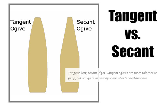

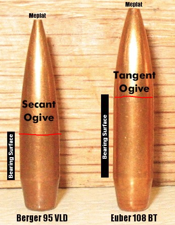

Bullet design: the VLDs are more secant, they have shorter bearing surfaces with longer straighter noses, tangent designs are a bit more short blunt nosed with a longer hearing surface.

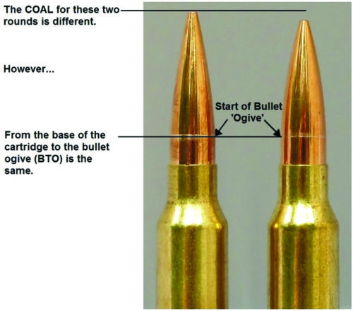

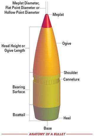

The bottom of the bearing surface is where the bullet stops interfacing with the case neck, the front of the bearing surface is where it first interacts with the barrel rifling. The dimensions of your bullet and chamber (reamer) will dictate how much of the case is held by the neck and your resulting measurements.

Since the secant vlds have a shorter bearing surface and a long skinny nose the point at which they interact with the rifling will allow/require you to either
  1. allow you run a shorter freebore length to hit the desired amount of bullet jump with more of the bullet held in the neck and shorter over al lengths to fit in a mag but that can lead to issues if you go for heavier longer bullets at a later point in time or
  2. require you to seat them out further in the case to reach your desired amount of jump and possibly limit how far you can load and thus effect your ability to seat them where you would like to in the case.
7038154
This lumps a couple different variables all in together but you can see that the lighter secant bullet will hit the rifling at a shorter loaded length than the heavier tangent.
7038158
If you had along throat and a secant bullet you might find that you run out of case neck to hold the bullet before you get to your desired amount of jump.
If you had a short throat and a tangent bullet you might find that you are having to shove the bullet deeper into the case which robs case volume and powder capacity.
  1. allow you run a shorter freebore length to hit the desired amount of bullet jump which can lead to issues if you go for heavier longer bullets later or
  2. require you to seat them out further in the case to reach your desired amount of jump and possibly limit how far you can load and thus effect your ability to seat them where you would like to.
This lumps a couple different variables in together but you can see that the lighter secant bullet will hit the rifling at a shorter loaded length than the heavier tangent.
