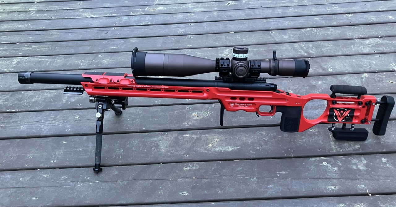

What rifle is it on? Seems odd you can’t get it back far enough with either mount. Here is the Area419 with a Gen III Razor on my Vudoo. Plenty of slots in the base to move back but no need with the eye relief.
