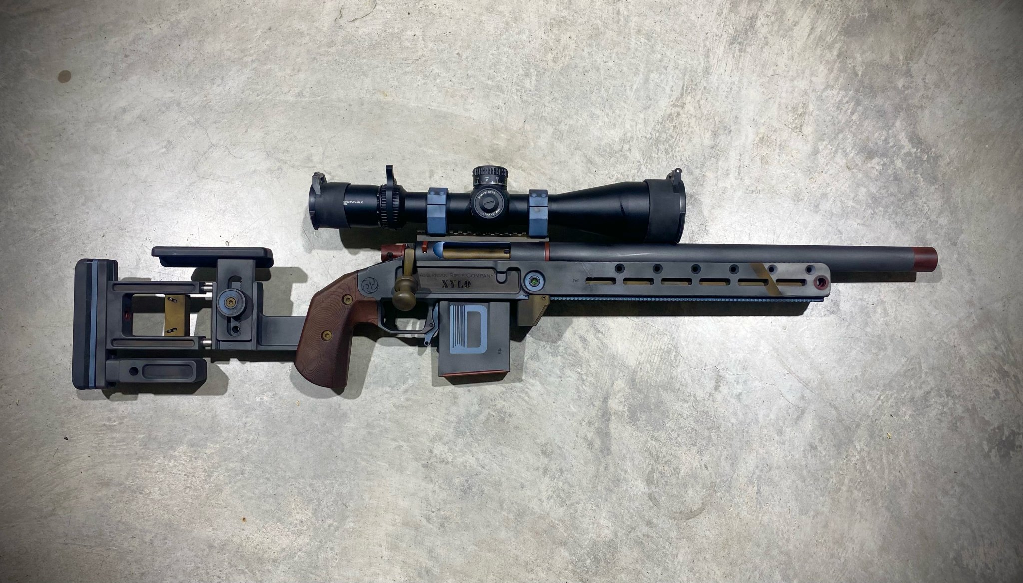

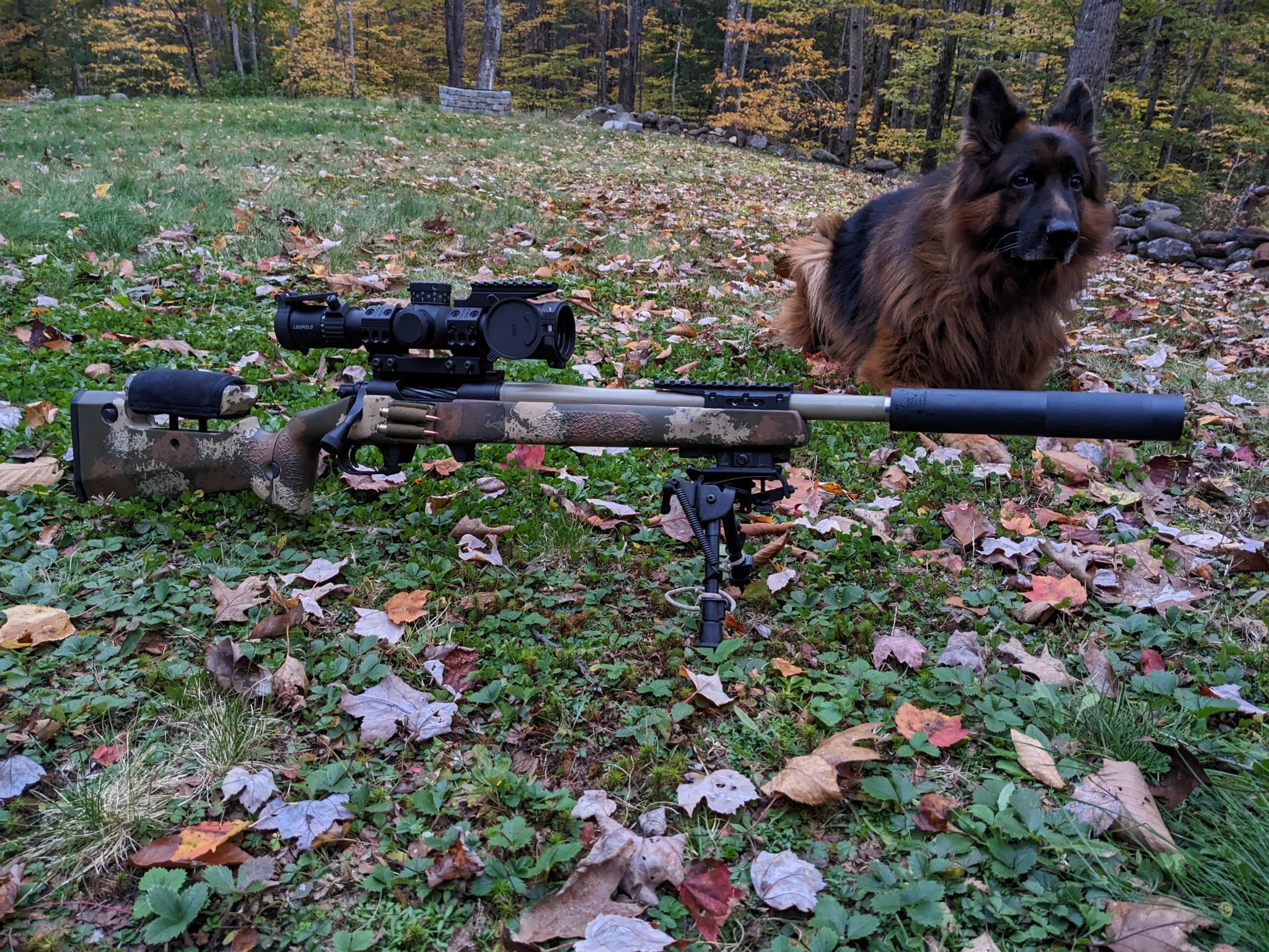

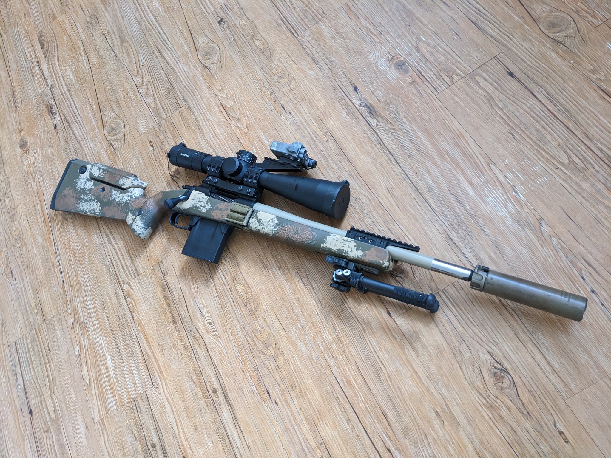

    So @WillHugh and I sent out 223AI barreled actions to get turned down to 18" and profiled for OCM5/AEM5 suppressors. The goal was to build intermediate range, low recoil, bolt guns that bridged the gap between Mk12 gas guns and 6.5CM capabilities. If velocities of 2850fps with 80gr ELDs are achieved, the guns are transonic to 750-800 yards and supersonic past 1000.
    The 223AI of mine was cut down from 24" to 18". I was running 25.6gr of Varget in Winchester brass behind Hornady 80gr ELDM and 80gr Amax. Velocity prior to the cut was 2950fps and it shot clovers at 100 yards.
    Got the barreled actions back yesterday although my Manners TF3A is still with the gunsmith being inleted for a Badger EFR, so I put it in a spare Manners EH2. I did learn that I needed to dremel out the front of the Accurate metal mags to get clearance for the 80gr Amax bullets whereas the plastic MDTs have always had room.
    The range trips today was promising! The rifle shot around 1/2 MOA, with 2 of the 5-shot groups a clover leaf around under .4" at 100 yards. Velocity averaged 2803fps at 87'F. The surprise for me was how high the SD was at 17. The translates to an ES of 57fps, or about 0.5 mils at 1000 yards. At 500 yards, this load is about 2.7mils of elevation and about 9.7 mils at 1000 yards.
    Since I have about 60 rounds left, I plan to shoot the rest and then try some StaBall Match was had great results in my Mk12 and my Dad's .223 bolt gun. I am hoping the SD can tighten up to high single digits with velocity in the high 2800s.
    Will has his rifle setup in a sweet Manners T5 and unlike me, his OCM5 isn't in NFA jail, so the rifle looks amazing.
    These promise to be relatively lightweight and fun guns, looking forward to stretching them over the summer and during some night shoots.

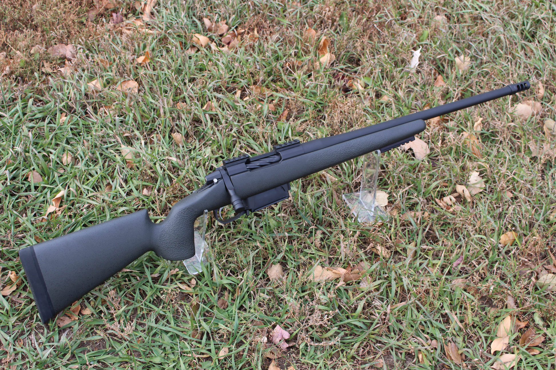

    I’ve had this photo saved on my phone forever. It was posted for sale here a few years ago and birthed my desire for a short .223AI.
    14.5” P/W brake.
    I have a CZ527/HS Precision in .223, currently a 24” barrel. I plan to chop the barrel similarly and ream out to .223AI. Should make my favorite coyote rifle even more favorite’r.

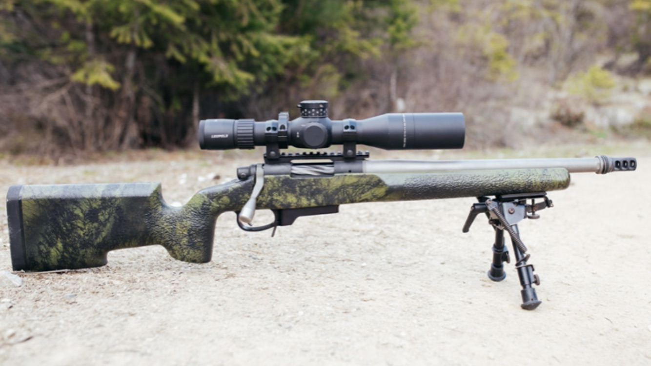

    I do have a 15" H-S Precision HSP in 223 Rem. Run 77 grain TMK's, Varget, and Lapua brass - 2675 fps.
    We have ran it out to 1300 yards on steel, and killed pd's past a grand.
    A newbie shooting it last summer-Her first day of LR shooting.

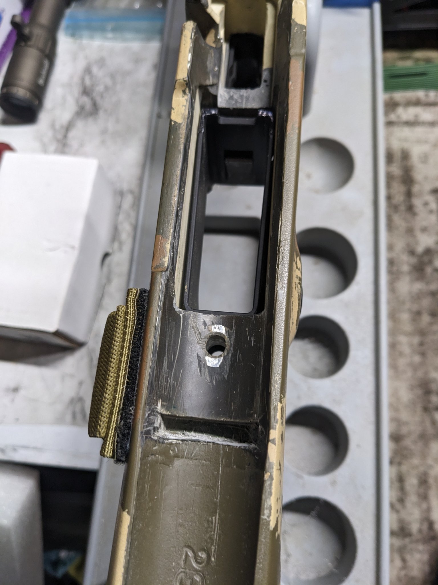

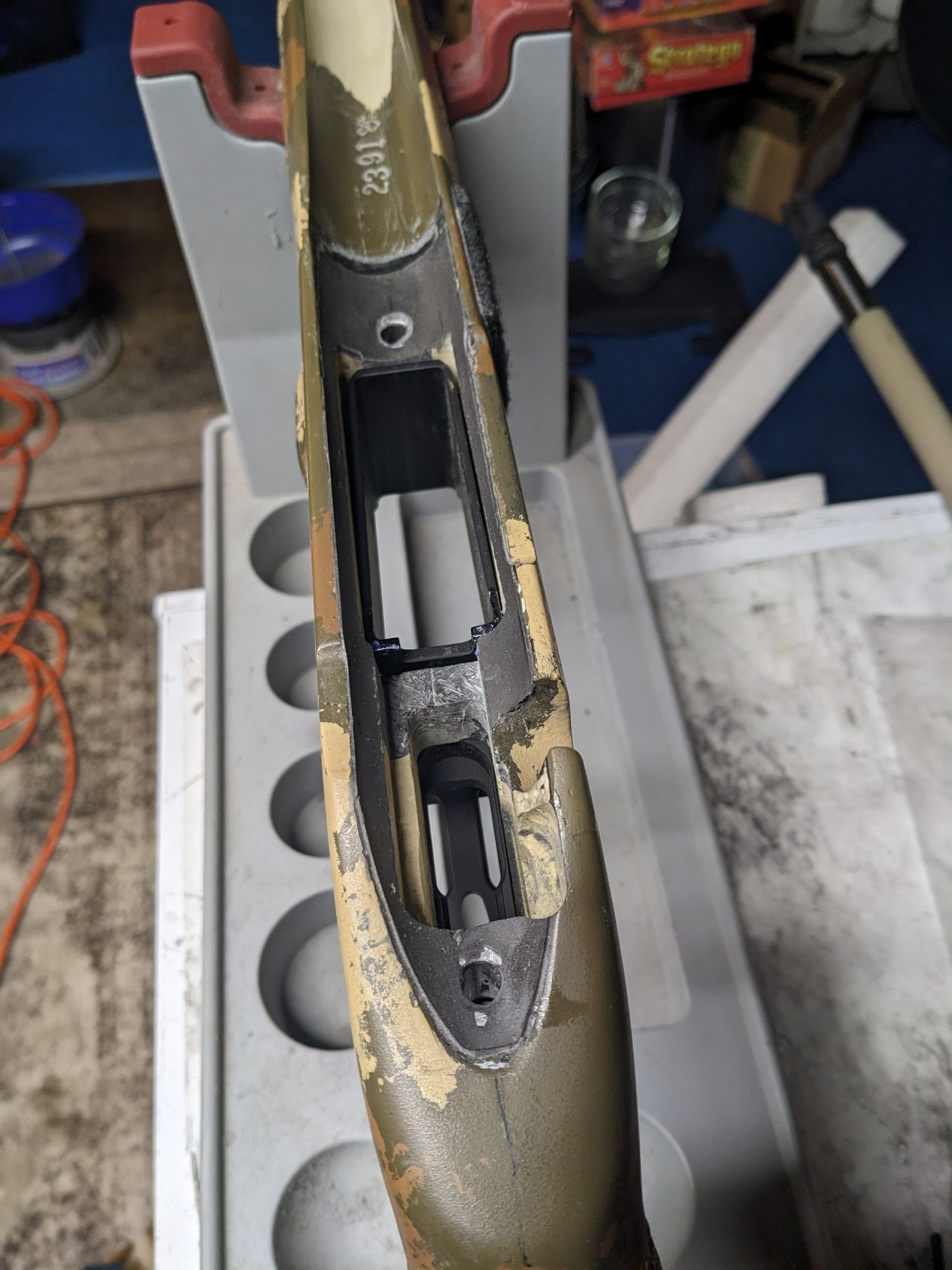

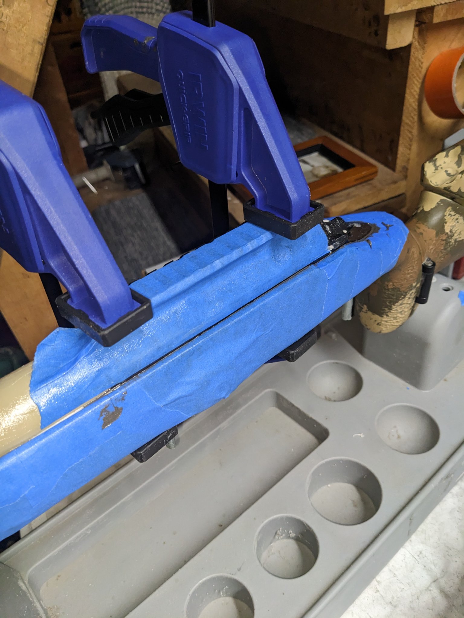

    The TF 3A showed up and looks great. I threw a couple pieces of electrical tape inside the lockup mechanism so that it is slightly firmer. Took the gun up to the range and unfortunately the groups went to crap. I think the existing bedding job in this stock sucks, the tang isn't even bedded where the front recoil lug is.
    Going to remove the existing bedding and pull out the devcon this afternoon.
    Here are a few photos though of the rifle as it sits.

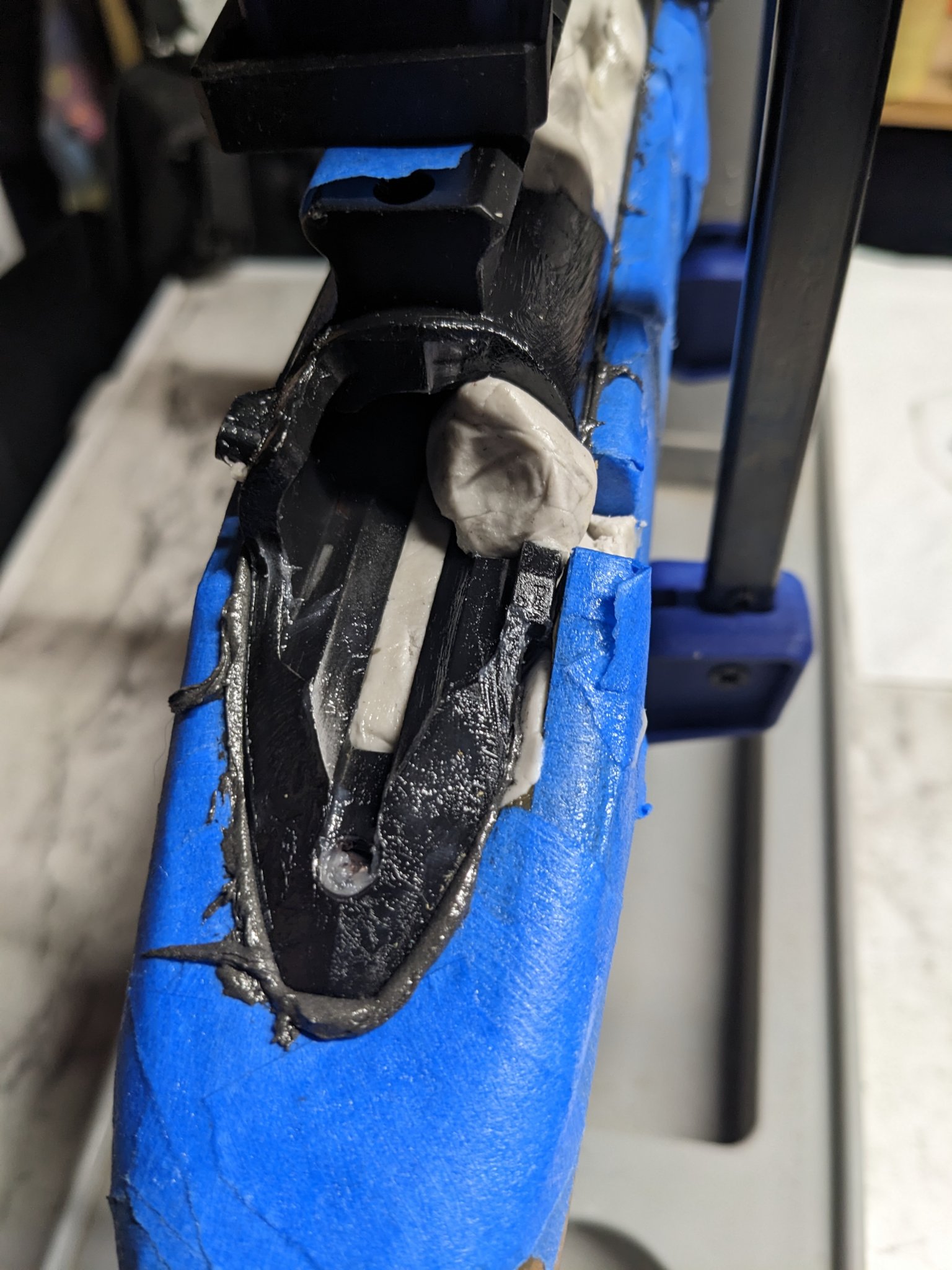

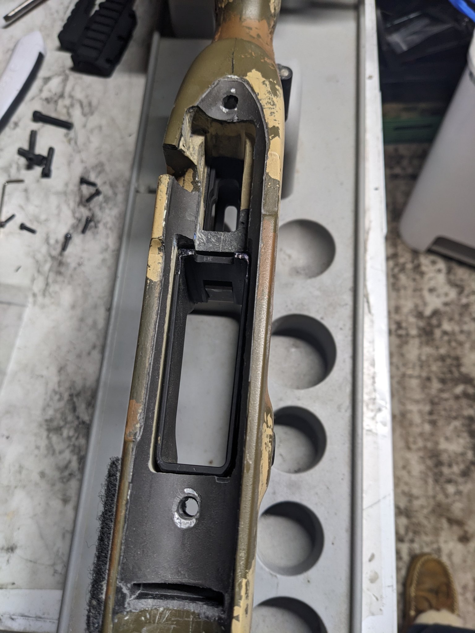

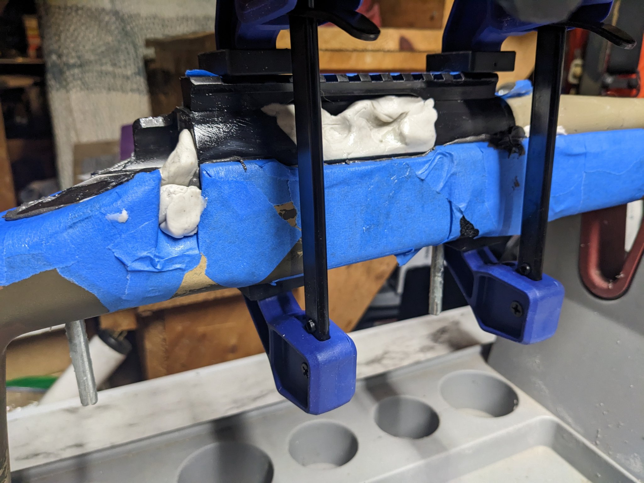

    Bedding in process. Now comes the agonizing 24hr period where we wait to see if the material took and filled all the voids it is supposed to.

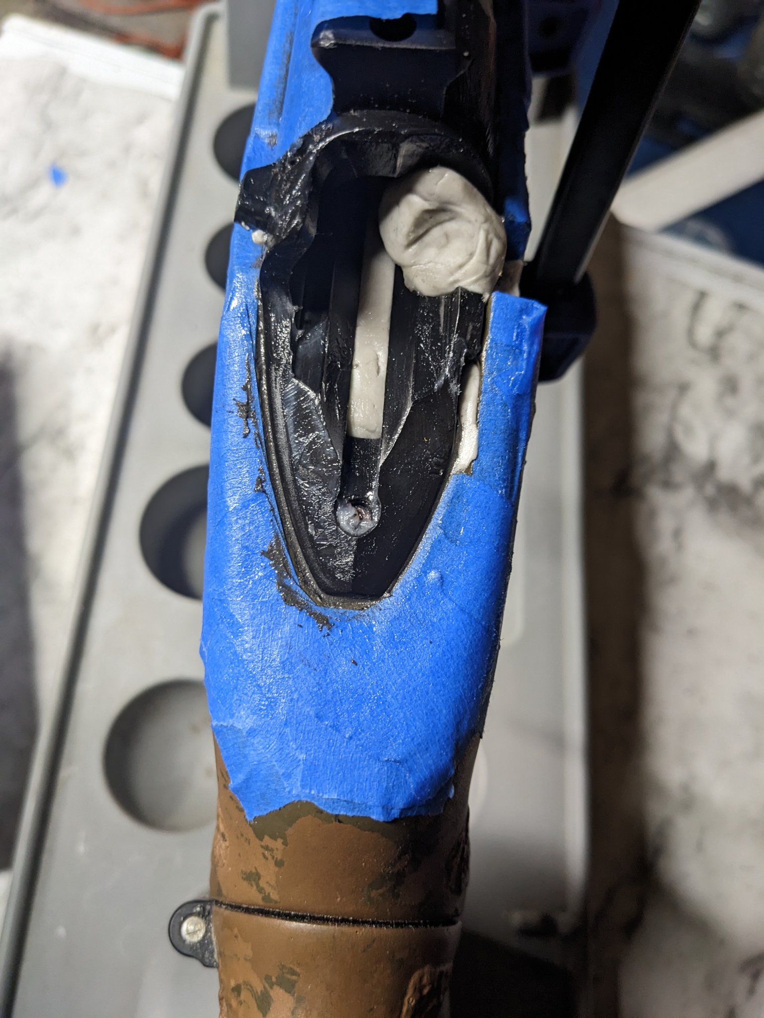

    Bedding is done. There are some spots where it chipped, but more superficial I think than relevant. The lockup is tight on the recoil lug and it now sits even inside the barrel inlet, where before it favored the right side under the EFR.

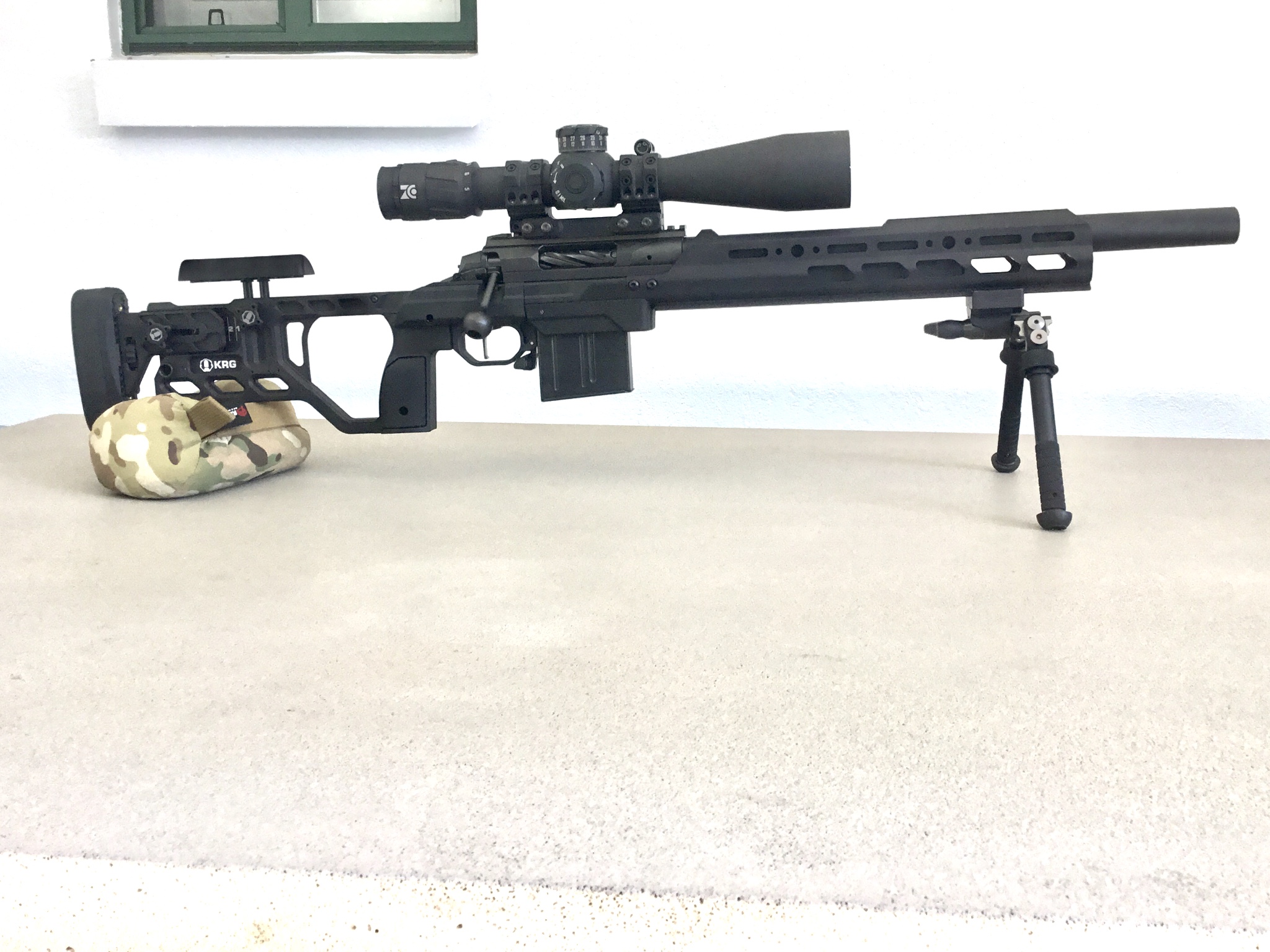

    One of my 223ai is 21 the other is 26. The 21 with a can is handy while 26 with a can is a bit rough in tight spaces.

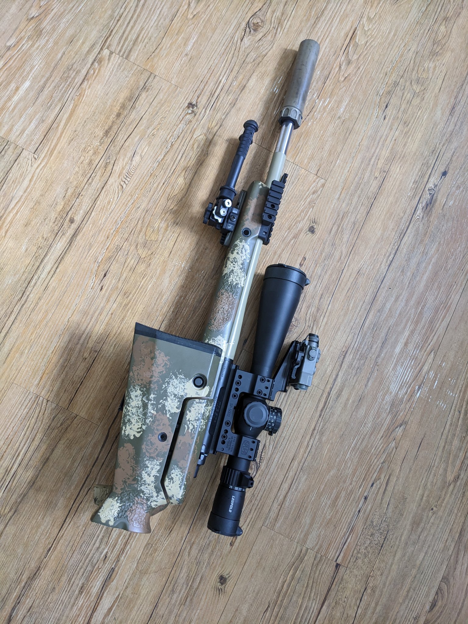

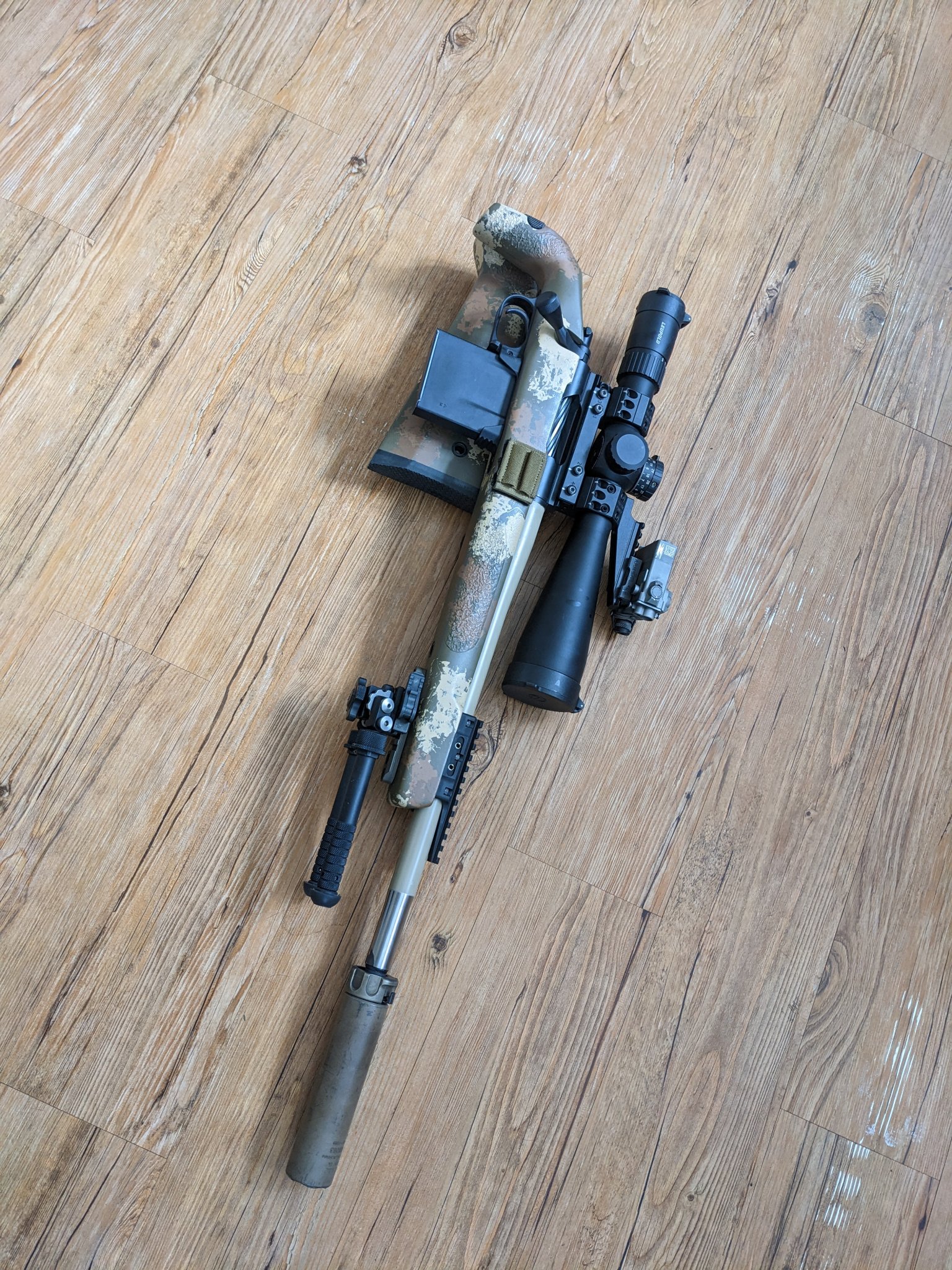

    OCM5 arrived. Sounds great on the rifle.
    On another note, I am finding that the Manners is not comfortable for me, particularly prone. I may need to add an adjustable butt plate to it so I can raise the pad.
    Maybe lower the scope, or do you typically run them that high?
