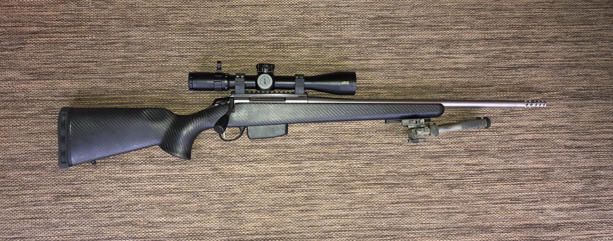

20 inch tikka lite 6.5 Creed. With the Southfort labs carbon stock, Bushnell LRTSi, and Atlas bipod it's dead on 8.8lbs

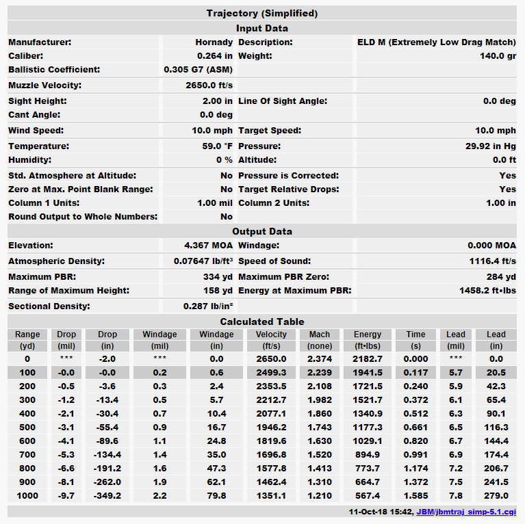

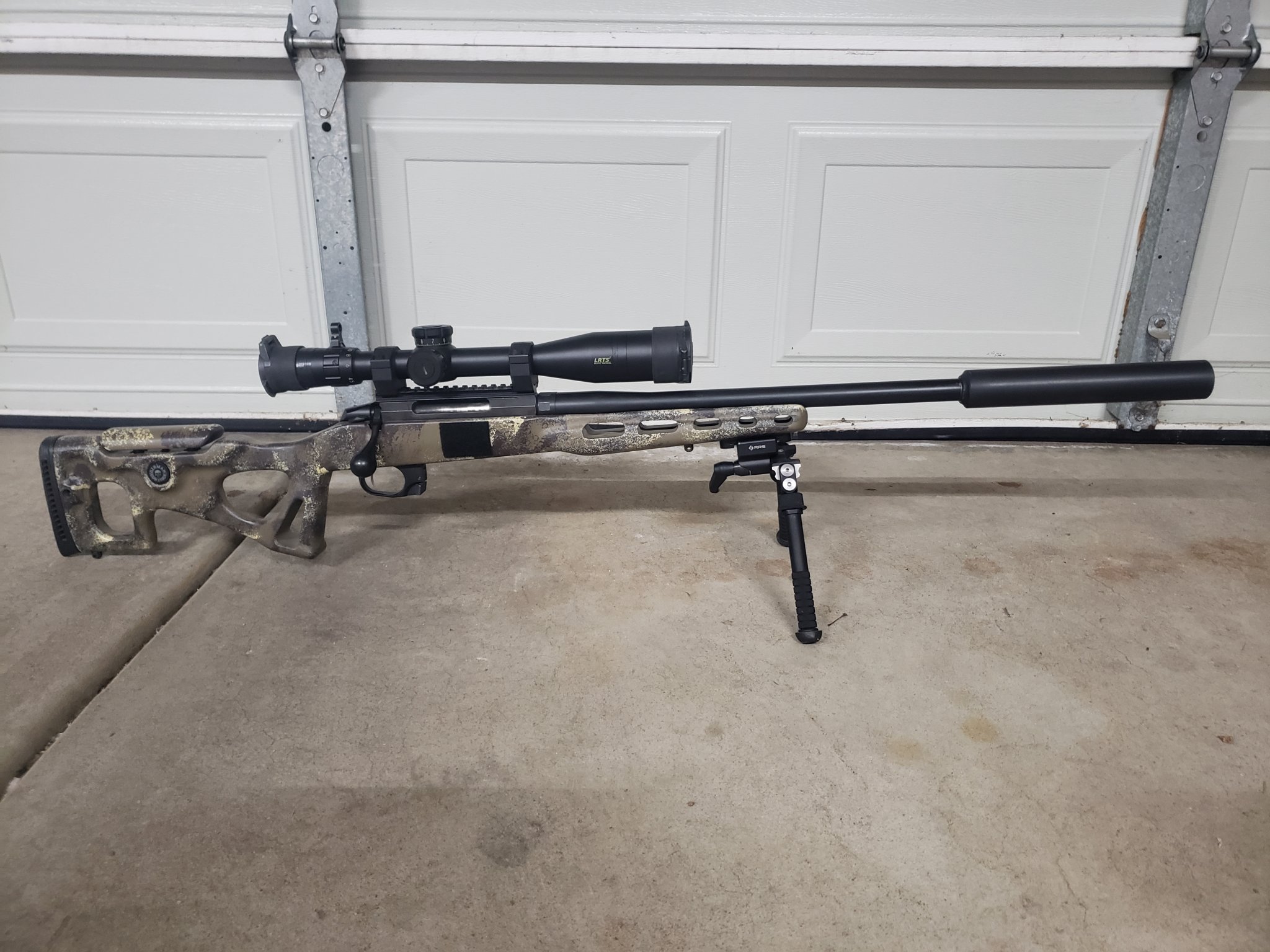

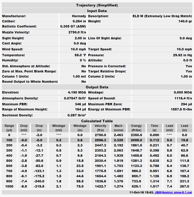

Cut down a 23.5" medium palma to 18" to replace the 20" factory CTR 6.5 Creed barrel. Gained 10 fps with the 130 Prime over the 20". Gained 76 fps with 140 ELDM with Rl16 over the 20" factory barrel. Not a lightweight, but easier to carry suppressed and very easy to shoot. Next barrel for this will be a Carbon 6 25 Creed. Have a shorted can on order, so might go longer on the barrel.
