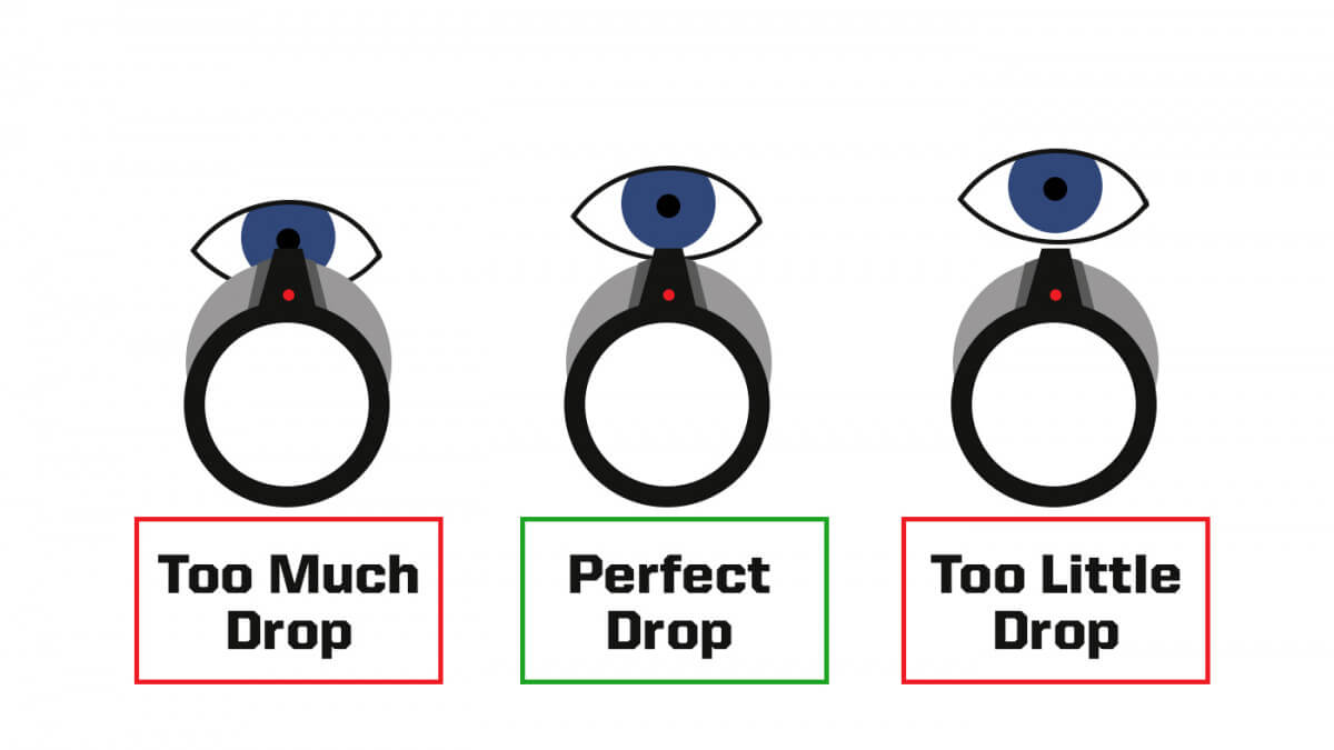

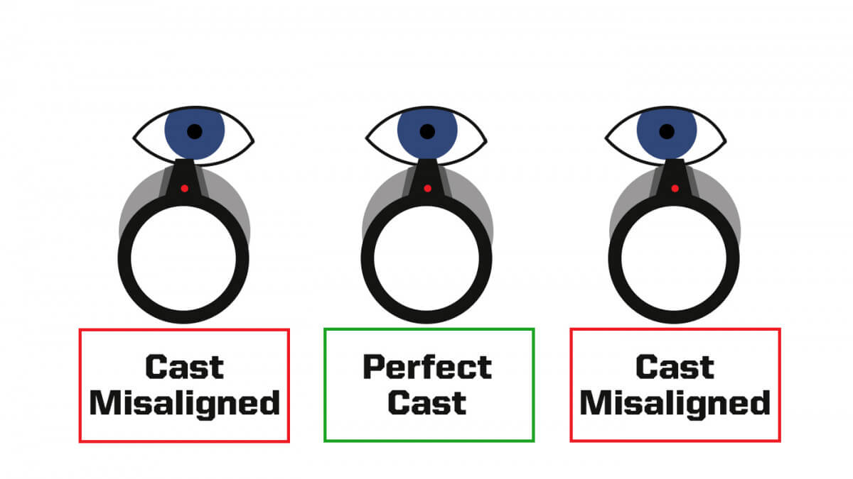

You should check to see if the 11-48 was adjusted to a particular drop and cast with stock spacers. It also sounds like it has something like a Polychoke or some form of a collet style choke system.

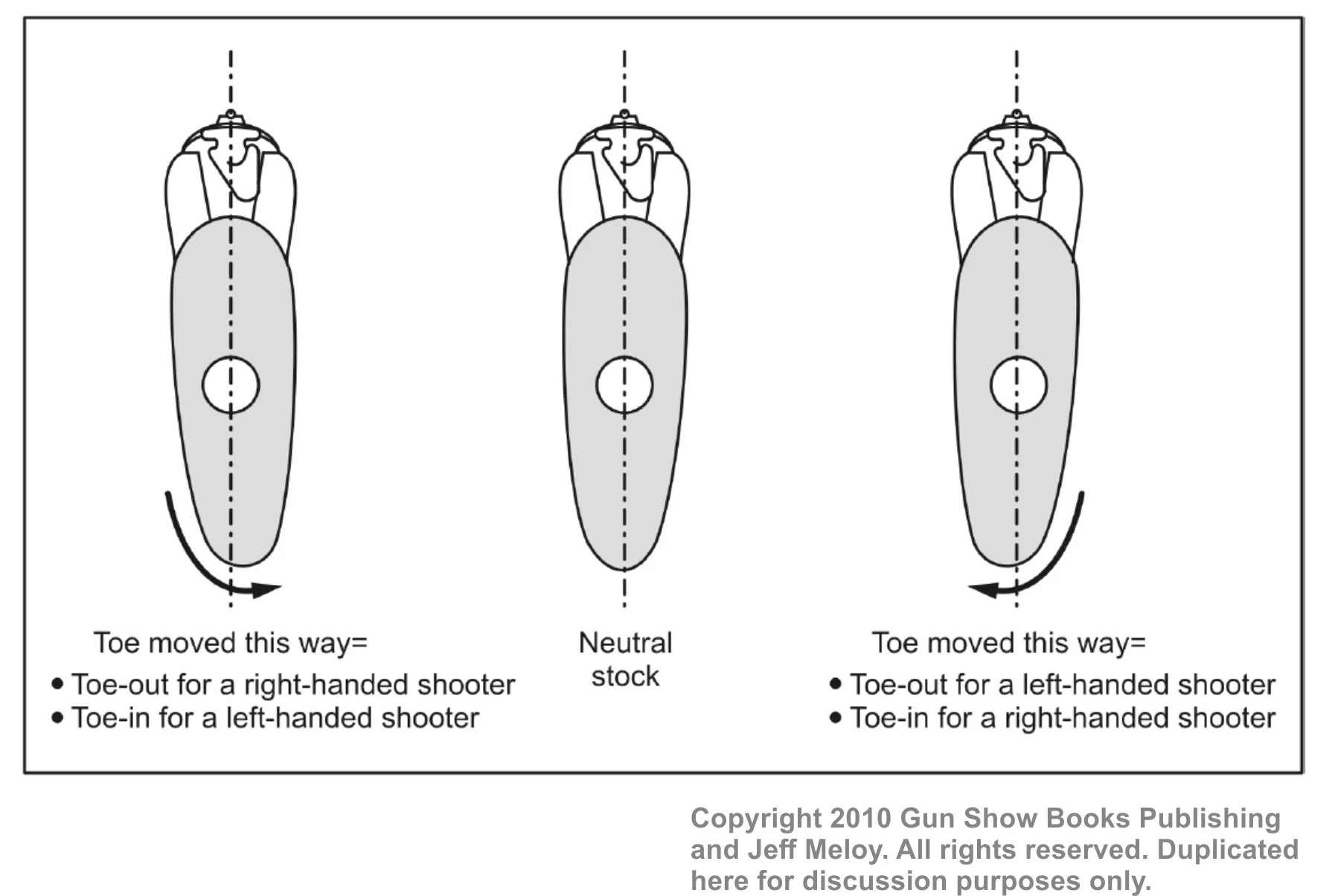

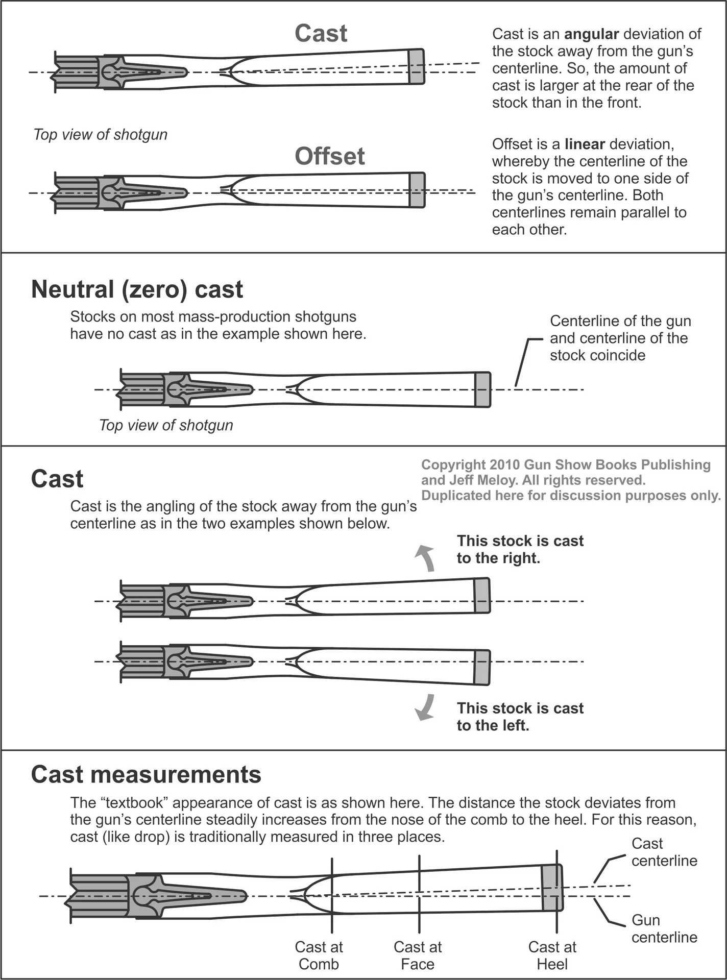

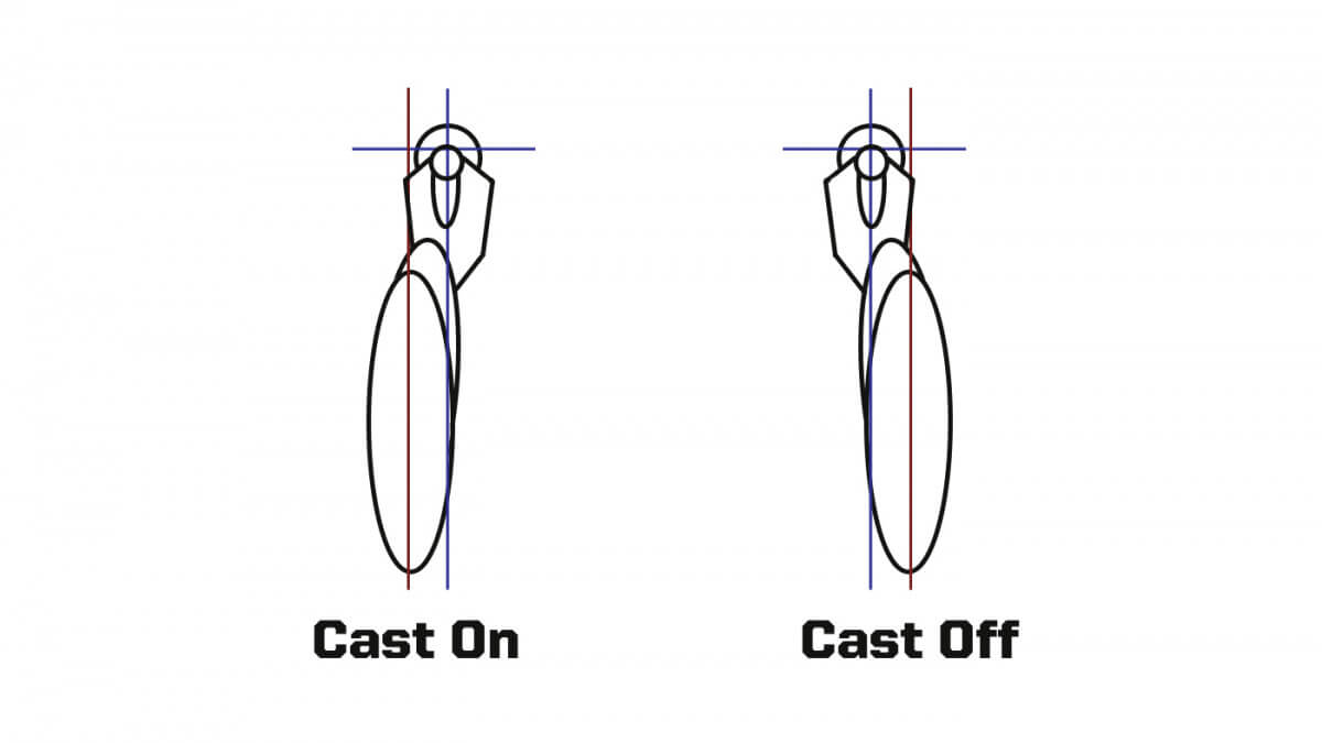

Drop/Cast are terminologies for fitment, particularly with shotguns. You either modify a stock or use spacers/shims in between the stock and receiver in order to adjust the fit to the shooter. Your observation of a potentially bent barrel could simply be a matter of a cast adjustment via shims made for the original owner. If it is adjusted for cast, then it's likely also adjusted for drop. You would unscrew the stock from the receiver and check for drop and cast shims/spacers and remove them to return it to neutral.
You can find more information by searching online for "shotgun fitting." You can also look up Polychoke in google images.
My understanding is that the OP is seeing a bend in the barrel half way to the muzzle and not a misalignment of the entire action/barrel with the center line of the stock as would be the case with cast.
