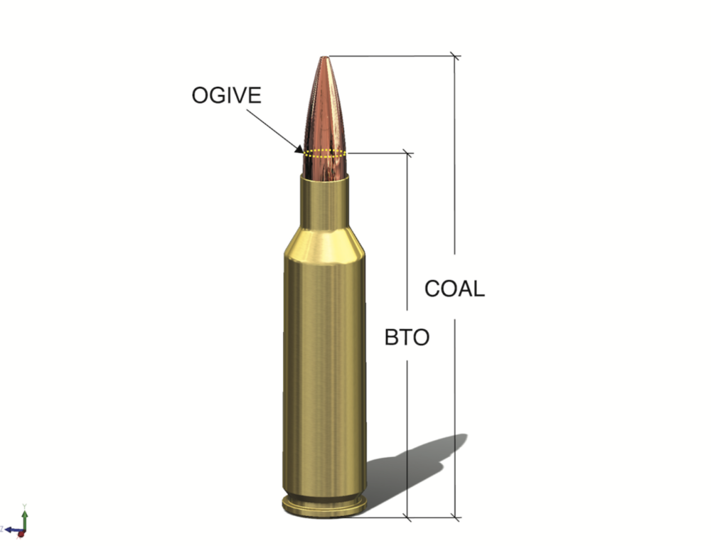

You're missing my point. I had assumed a bullet insert comparator as marketed by Hornady and Sinclair touches the o-give point of any bullet type but for the same caliber. I did NOT know that they are falsifying this. Based on all of the answers to my question it only touches somewhere on the bullet's jacket and as long as I stick to 1 brand I can still be repeatable to load off the lands as long as I know COAL to give me BTO.

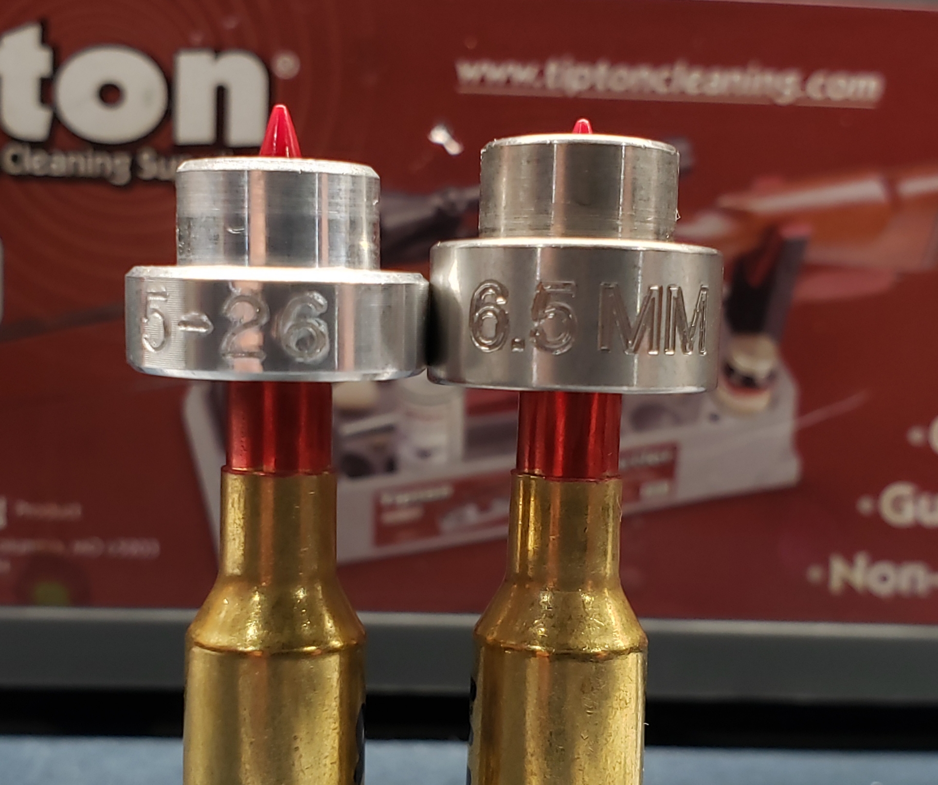

You could color a bullet with a sharpie and find on the bullet exactly where your lands touch the ogive, then compare it to where both measuring devices contact it for reference.
I use the hornady and can see the aluminum bushing that measures the ogive getting worn with use.
Stainless would be better.
Lol how are they falsifying this? You got a bto measurement didn't you? Did they advertise an exact bto for a specific bullet on their website? No... They didn't it's a tool for getting an exact bto measurement for your bullet/caliber/barrel combo nothing more nothing less... You assume too much young Padawan ?. Every bullet styles ogive point will be different even across the same chambering
Yes I just did that and the witness marks are right over the Sinclair's bushing's location.
Using the hornady can you see where the .05 difference lines up?
I don't know. For the last 7 weeks I've been using Hornady bushing (it was available locally) in a Sinclair body. The Sinclair 6.5 creedmoor bushing was on backorder and I just got it Saturday.
So it should work then? I would rather have the SS Sinclair bushing.
Past weekend I loaded 115 DTAC's and 105 Noslers. Set to same jump the 105's were near .004 longer OAL. Obvious the ogive of each is dramatically different.
Looking at the Sinclair website description does the inside where the bullet ogive touches the bushing have a bevel? That could be where the .05 difference is coming from. The caliper zero isn't at the same point the bullet touches.
Both Sinclair and Hornady have a very small beveled edge so that will throw the true BTO off.
Sinclair is cut with a 1’30” taper just like most chambers. Hornady does not. That’s why there is a difference in measurement. Sinclair will give you a better comparison if you are working off a reamer print. Is it perfect no, is it a more accurate measurement of the olive, yep.
