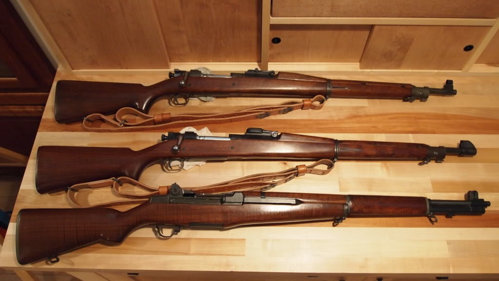

    I usually load 30-06 with my Garand in mind and stick with I4064 or I4895.

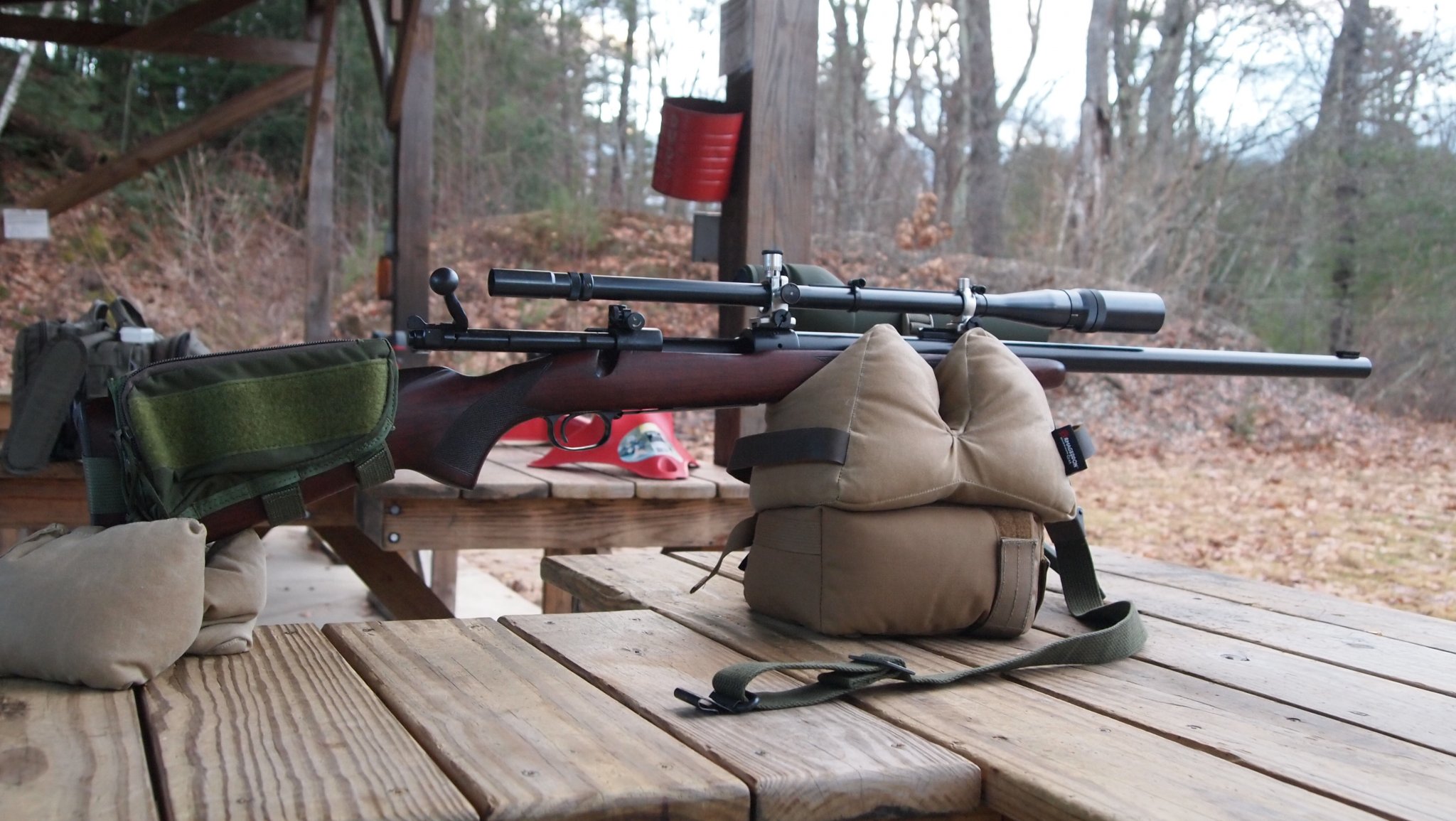

    I had a Pre 64 Wnchester Model 70 with Douglas barrel made up and Im willing to move on from the Garand safe powders to something better suited for bolt guns - My springfield 03s and my Model 70.

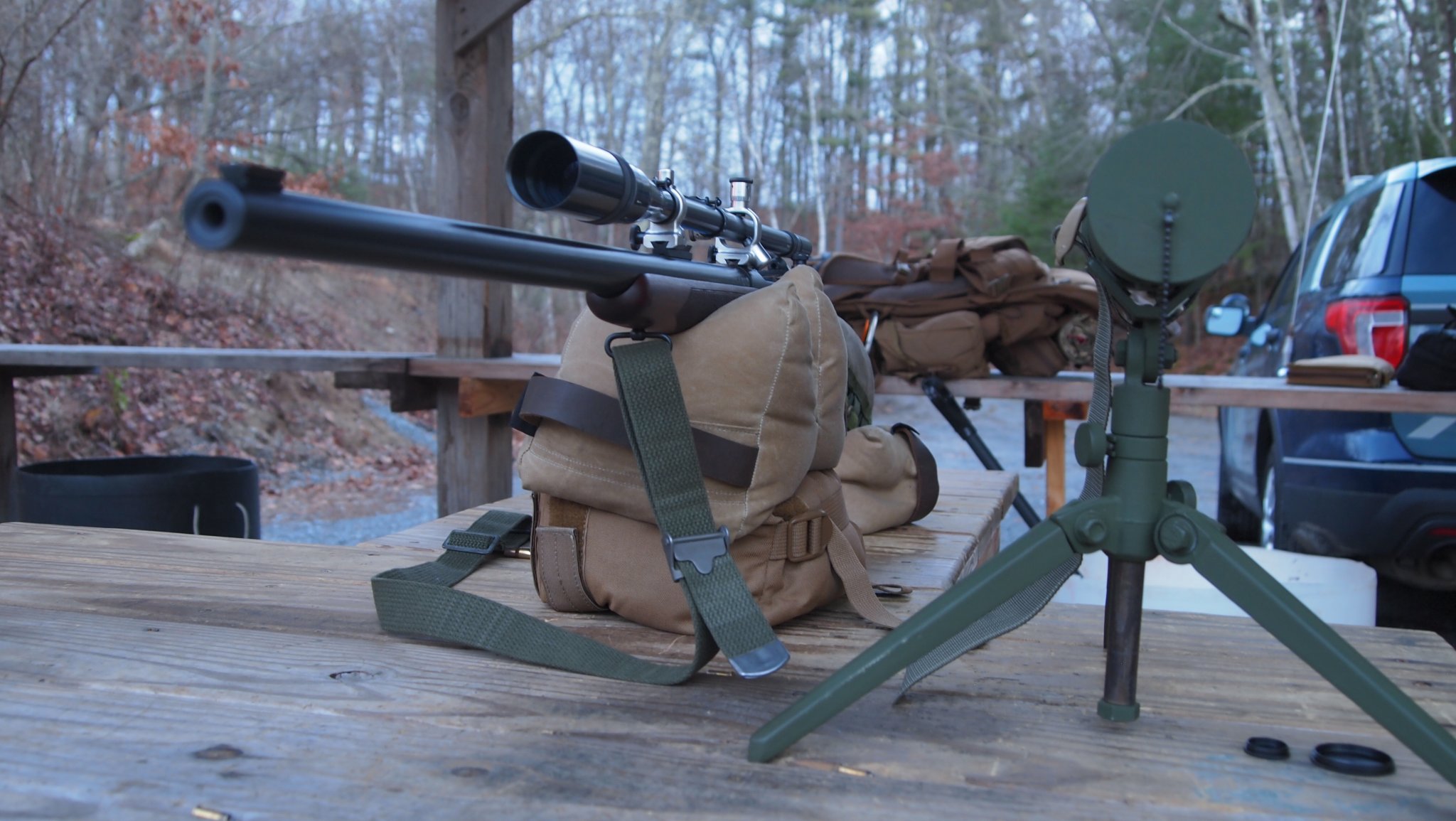

    Im thinking 2650 or so will be a good velocity and I may use a little less powder than you.

    Ill be using that in my Garand, 46.5 +/- and want to try some in my .308s, 42 +/-
