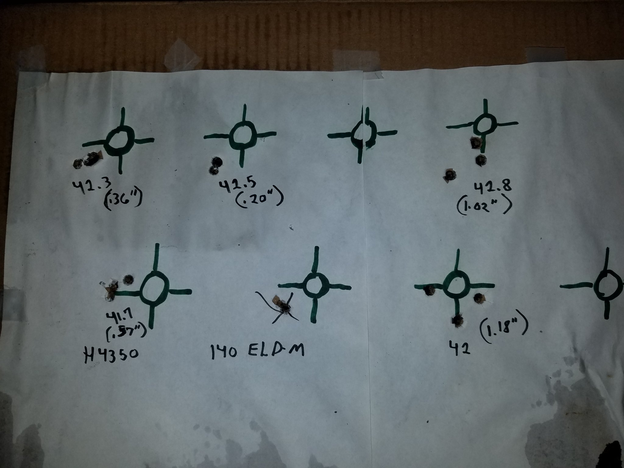

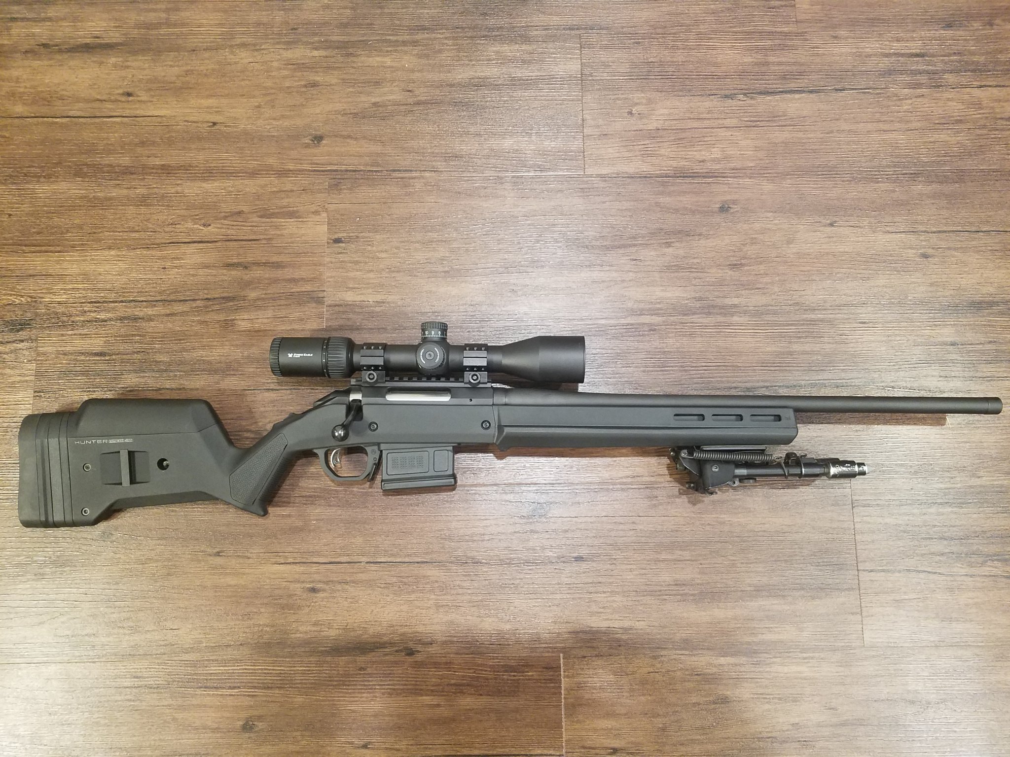

I bought a Ruger American Predator and a magpul stock for a light hunting/ steel shooting rig. Turns out this thing will shoot. My load I've started working up:
-140 eldm
-h4350 (41.8-42.8)
- new Lapua brass
-cci 400 SR
The plan was to find a decent load to run a couple hundred rounds to speed the barrel up, but since its showing great accuracy, I don't want to push it real hard right out of the gate. The accuracy node seems to be around the 42.3 mark but without a chrono, it seems like I'm pushing it too fast to start with? No pressure signs and from what I'm reading, this is a common node area. I still have more testing to do but I'm deciding on dropping down lower or not?
I know it's just a factory ruger barrel, so I'm not overly worried like I would with an expensive barrel.

From an OCW standpoint, does 42.3 or 42.4 look optimal?
Looking at your targets, the centers of the 42.3 and 42.5 groups are in pretty close to the same area, while 42.0 and 42.8 are impacting in different areas. I'd split the difference, load at 42.4, and move on to seating depth tests, as long as you aren't seeing pressure signs. That 42 grain range is a pretty well established node for 6.5 Creedmoor, so it's not a surprise to see you'd fall in that area. Just know you may have to revisit your testing once you have a hundred or so more rounds down the barrel.

These were loaded .020 off the lands. That puts the ogive measurement at 2.227 (so 2.207 with the jump). Unless things start to open up I'm going to run that for the next hundred rounds or so and re work it only if needed.
I couldn't believe a ruger american shot this well. I would have settled for .5 - .75 groups. The next test I'm going to shoot 5 round groups tho.
