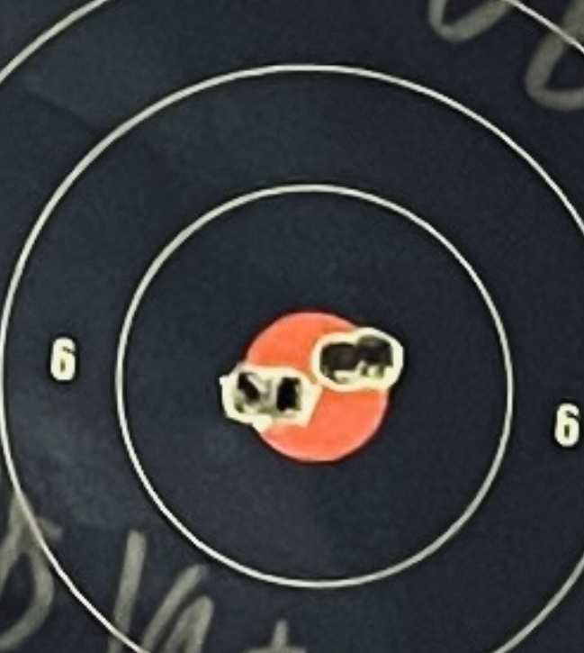

For the record, here's the best group I ever shot with my old Criterion, using factory IMI ammo. 5 shots in there.
