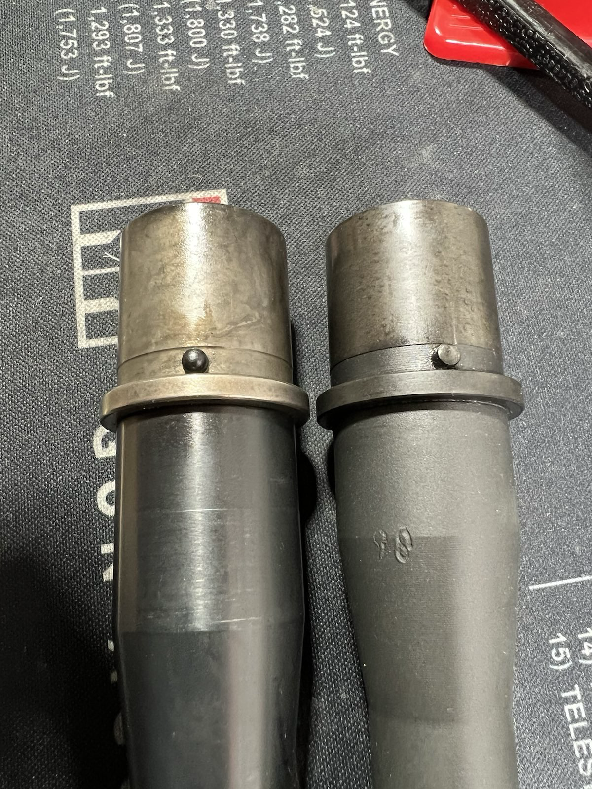

    Is the barrel extension in their DI guns the same as standard ARs? I thought I heard something about that.
    What kind of barrel swap? I asked about having a barrel swapped to a different caliber they make and was told no.
    It’s the index pin.

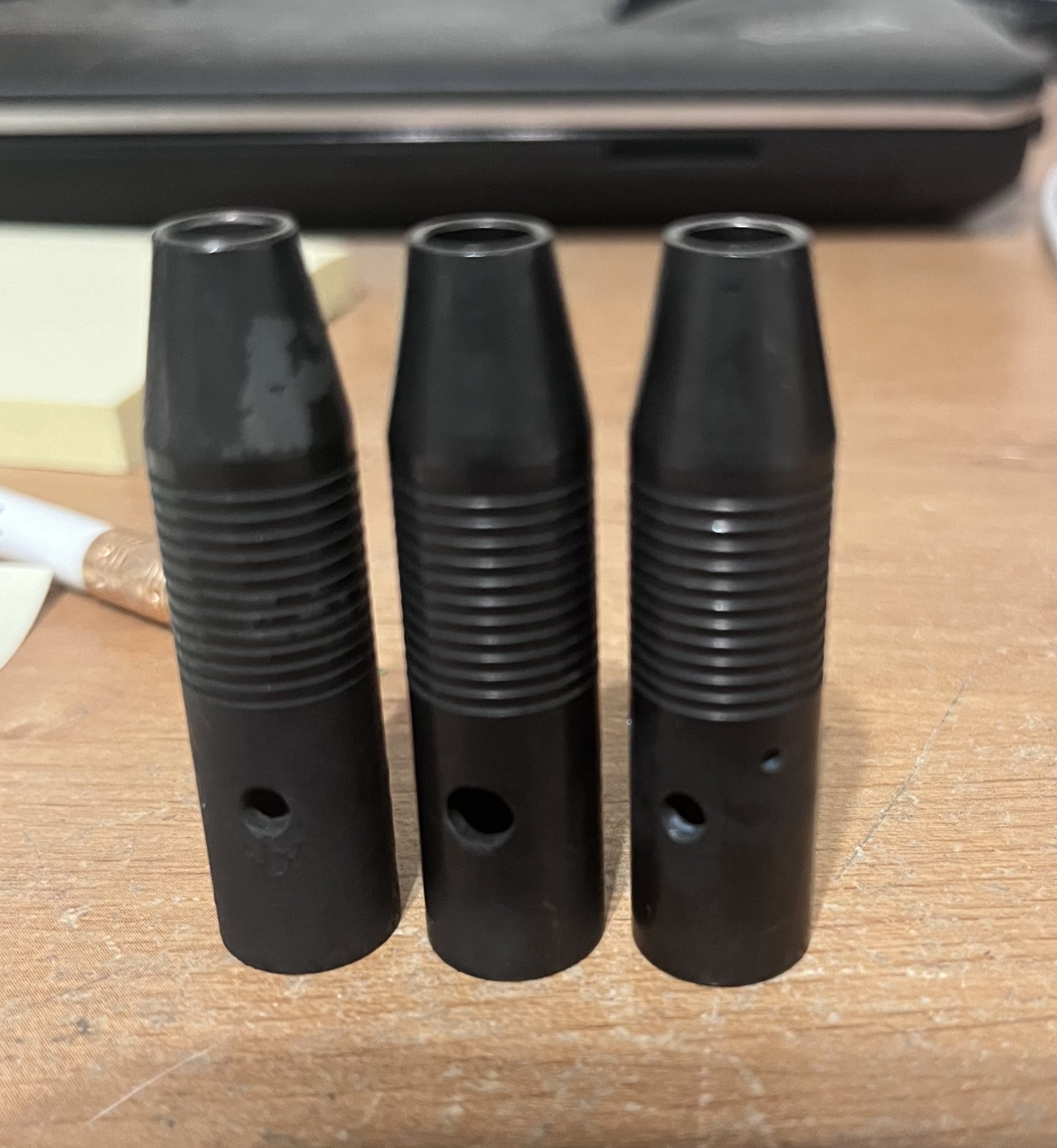

    on a side note; if anyone is interested in reducing the gas in their piston version you can drill extra cent holes or enlarge the existing ones in the piston cup
    adding holes would be to vent gas early, so behind the existing ones
    i bought extra piston cups to experiment with different sizes of holes.
    the larger existing worked too but was more temperamental to weak ammo.
    both my 12.5” and 16” came with H buffers and continued using those with the modified piston cup and the gas setting on suppressed.
    in the pic:
    left side: unmodified
    middle: enlarged original holes
    right: original holes with extra
    those were a little small. made some other cups with larger extra holes.
