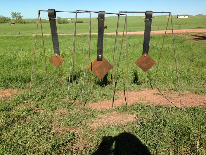

Not my targets, but just scrap steel misc parts for a stand.
I think this one was closer than 500 but the others at 5, 6, 7, 8, and 1300 are similar.
they make a nice audible "bong" and react pretty good when struck.
