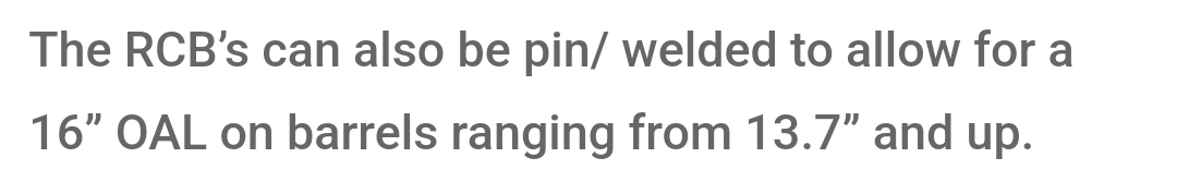

    The Criterion 14.5 is a shorter wait than the 16”.
    Other barrel options for a “SHTF” CONOPS include Daniel Defense and Centurion Arms. But they’re hard to source at the moment.

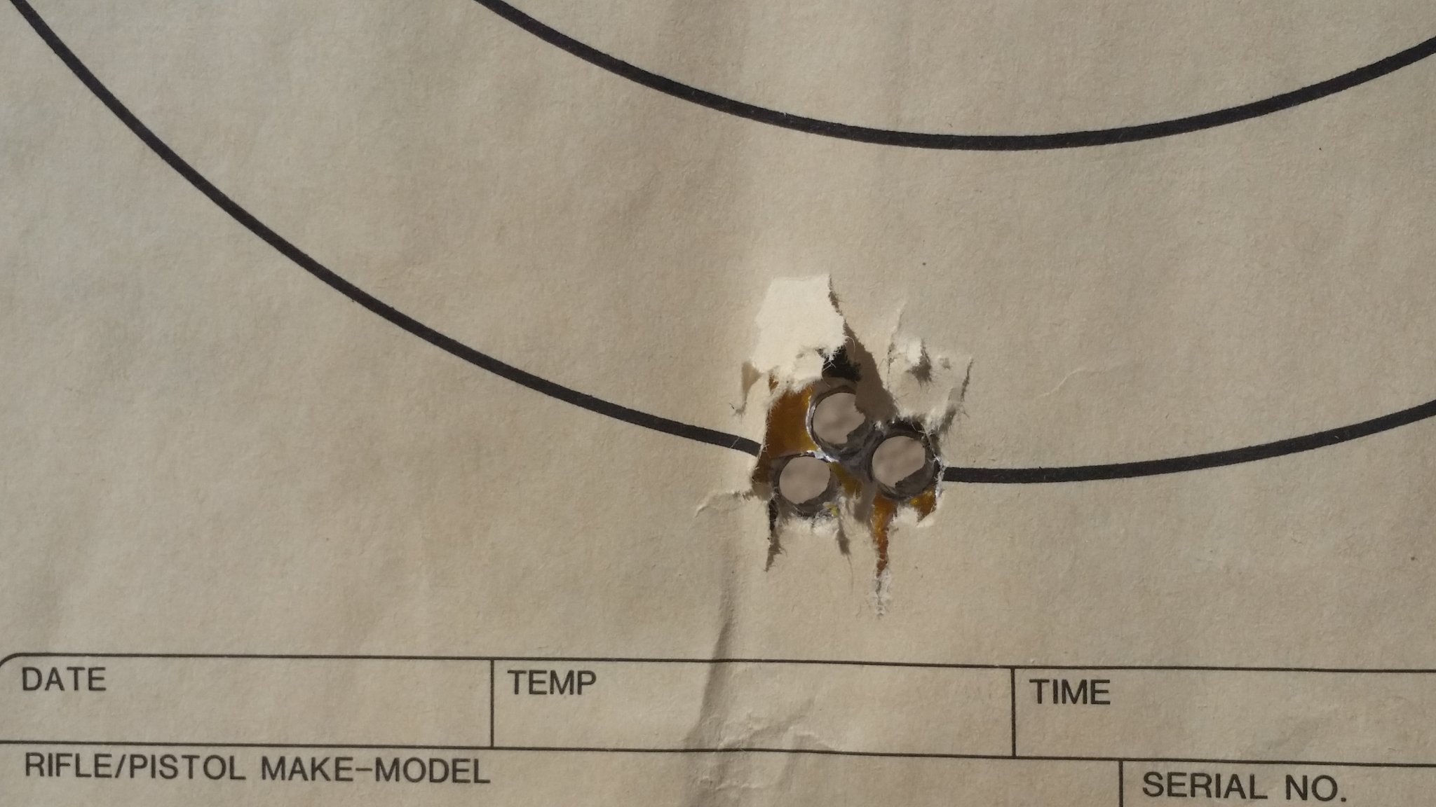

    Chrome lined CHF FN barrel.
    Nothing out there will live thru the amount of rounds you can put thru one.
    They will keep chugging when everything else has long since burned out.
    I've had ones that were wickedly accurate too.
    This one...

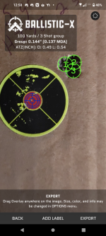

    When I first got it I tried probably 10 different types of ammo, and could not get a 3 shot group under sub moa. And the gov profile puts the weight in the front which I don't like at all. Before anyone says I can't shoot, I shot this 3 round group yesterday at 100 yards with handloads from a WOA barrel. Obviously, not looking for that type of accuracy out of this new build, but you'd think with premium ammo it would at least group better sub MOA. Never thought about returning the barrel because I dimpled the barrel for the gas block and figured they wouldn't take it back. I'll look into rosco barrels as well. Thanks!

    BA has accuracy guarantee, send it back and get another. Dimpling may be an issue like you say but worth a shot. All the BA barrels I've had held moa or better so I'm surprised. The profile is personal choice of course.
    cheap accurate barrels, KAK and Rosco. you won't be disappointed imho
    BA has accuracy guarantee, send it back and get another. All the BA barrels I've had held moa or better so I'm surprised. The profile is personal choice of course.
    Not to sound like a dip shit, but they will take it back if I've had it for over a year? If they do take it back maybe I'll sell the new one, and pick up a rosco. I see them for sale all the time, and a buddy of mine got one but hasn't shot it yet.
    I don't know but cs is pretty decent so I'd give them a call and explain that you've had the barrel, have tried a ton of different brands etc and it won't print moa. Can't hurt to call

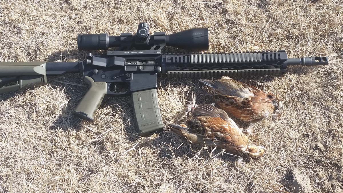

    I bought my LaRue Stealth a few years ago for this purpose. I didn't look at the weight when ordered. Once recieved I immediately decided it was too hefty for what I wanted to do.
    It's now a range and coyote rifle. Shoots very good, I ended up putting an adjustable block on it because it was way to gassy, borderline unreliable.

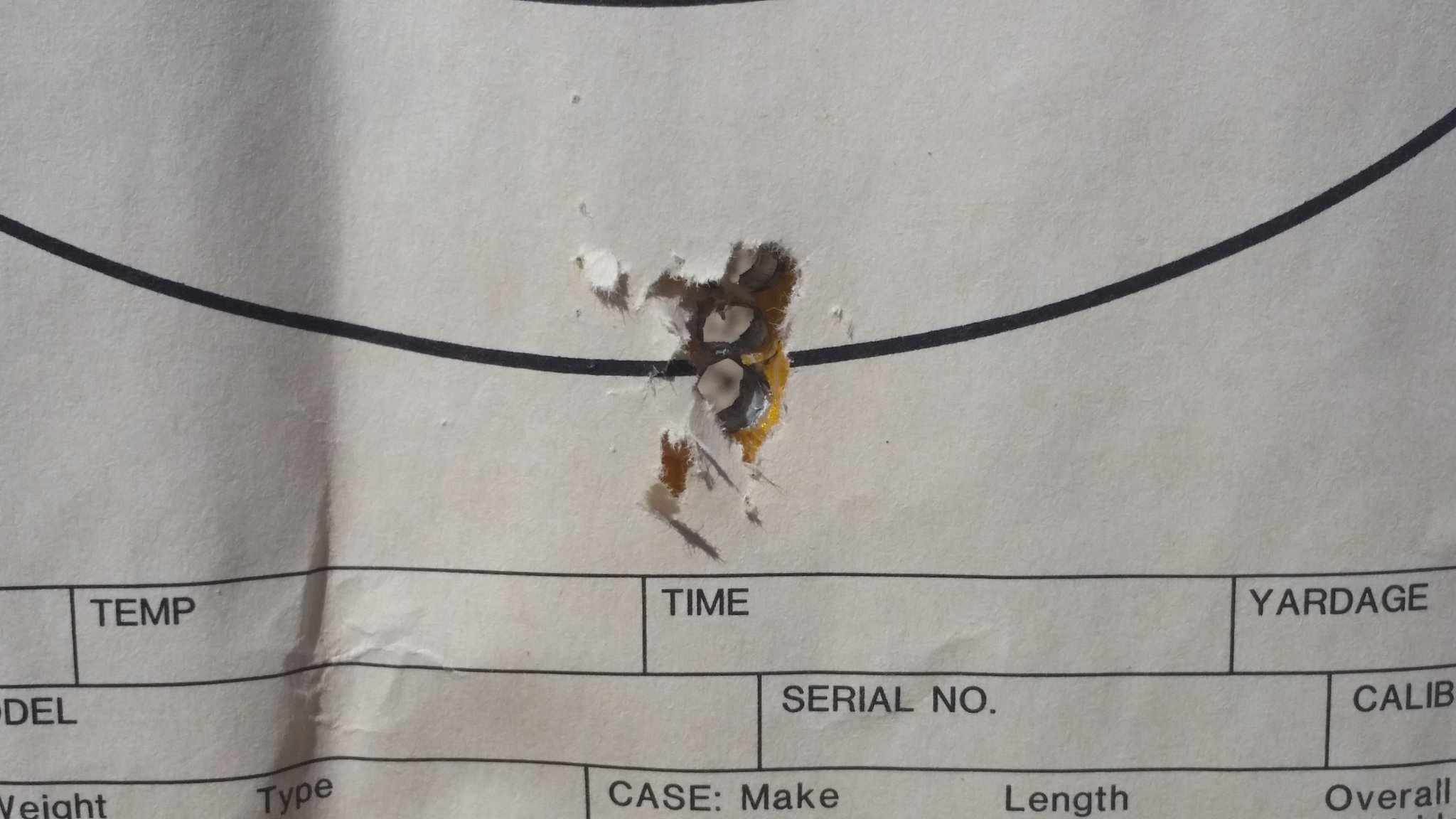

    Bravo Company 14.5” ELW Accuracy: A Quick Look
    ELW stands for enhanced light-weight. This barrel is from Bravo Company’s cold-hammer forged series of barrels. The barrel has a “continuous taper” design with a smooth shoulder at the gas block journal, which reportedly improves barrel harmonics. This barrel has a mid-length gas system and a 0.625” gas block journal.
    According to Bravo Company, this barrel has a stripped weight of 1 pound, 5 ounces. For comparison, a Colt 14.5” M4 barrel has a stripped weight of 1 pound, 9 ounces.
    BCM 14.5” ELW
    Colt 14.5” M4 barrel. (not stripped)
    I purchased this barrel as part of a BCM factory assembled upper receiver group with the MCMR 13” free-float hand guard. The barrel has BCM’s pinned and welded A2X flash hider.
    Shooting off-the-bench at a distance of 100 yards (using a high magnification scope), this barrel produced a 10-shot group that has an extreme spread of 0.946” with a mean radius of 0.33”.

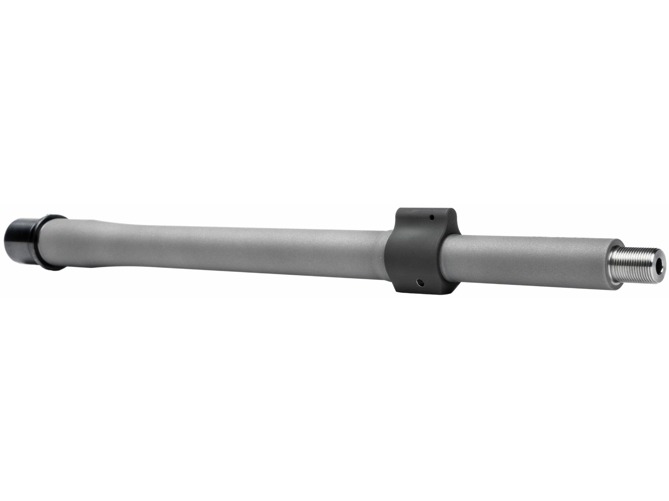

    My SHTF M4 has a Rainier Arms Select 14.5" barrel. It's lightweight, and ridiculously accurate with 55gr ammo. Haven't tried anything heavier, as I mostly shoot LC XM193 and Tula 55gr steel. Both shoot sub-MOA at 100 yards. Rainier builds a hell of a barrel. I also recommend buying your gas block from them, and having them drill/pin them for you before you build your upper. Or, just piecing your upper together through parts on their site, and then having them assemble and drill/pin GB and pin & weld the muzzle device of your choice. SHTF, you want absolute guarantees that nothing will come loose or fail.
    Reactions: Dildobaggins
    Good to hear about the Select barrels. I just noticed they now sell a Select 16" RLGS barrel which is my favorite configuration, and the price is right.
    Reactions: FuhQ
    That seems like a smokin deal. I have read so much info on who they use for blanks, and never found a straight answer. Any idea what blanks they use?
