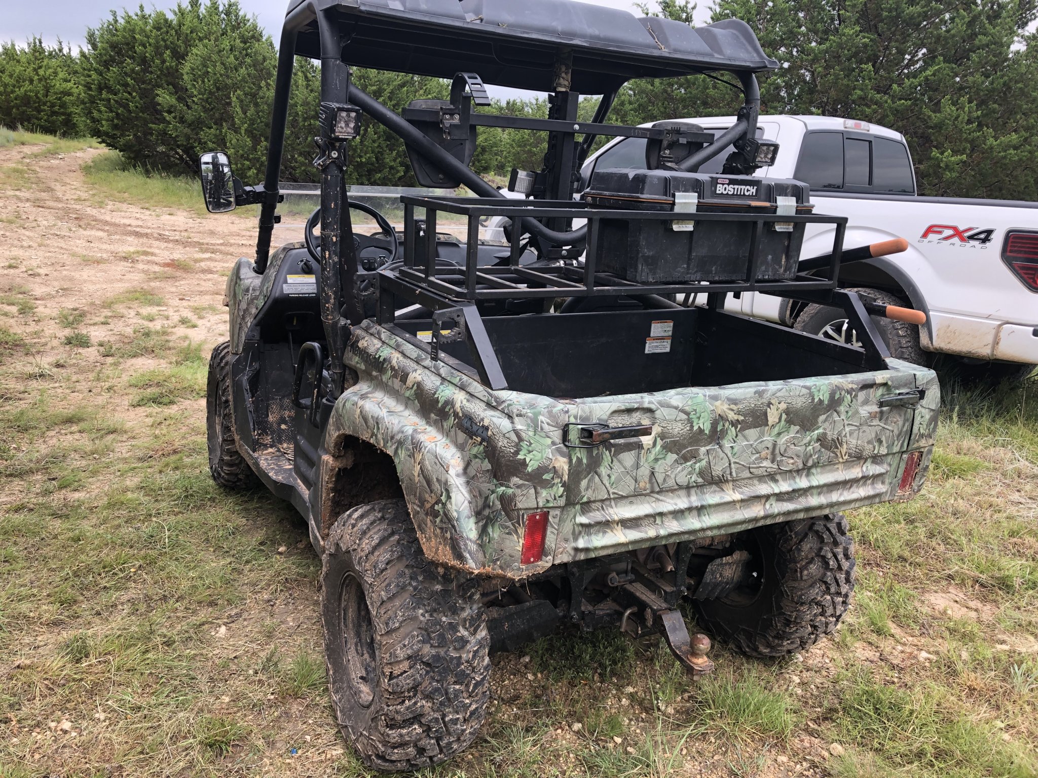

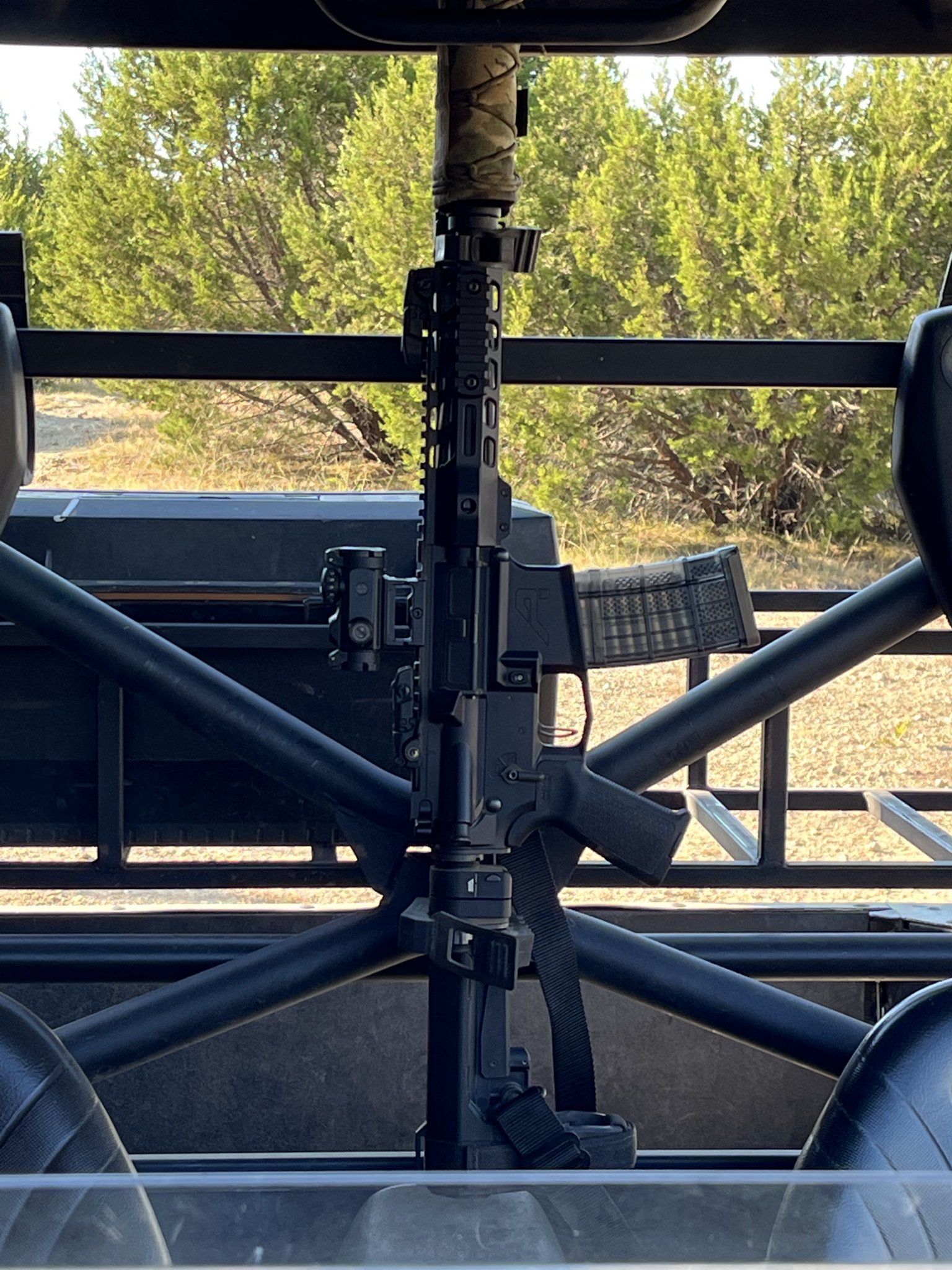

Put together these for my Teryx with square tubing, rivet nuts and Quick fist clamps. A horizontal tube is held on by the headrest bolts and uses Quick fist’s weapon mount. The vertical tube between the seats bolts to the horizontal tube on top and a bolt through the bracket where the roll bars cross on the bottom and uses a mini clamp on the barrel and a regular on the buffer tube. The 300 BO comes out in seconds in the cab and the long rifle comes out while standing on the drivers side of the bed. The guns are secure as the rubber like clamps can be cinched tight and yet the mount still has some give. They have held up well over the years in sun, dust and rocks of west Texas. I use a similar setup for carrying a shovel and loppers on the bed rails.
May not fit up exactly the same on your Mule, but might give you some ideas for something inexpensive and customized for your purposes.
