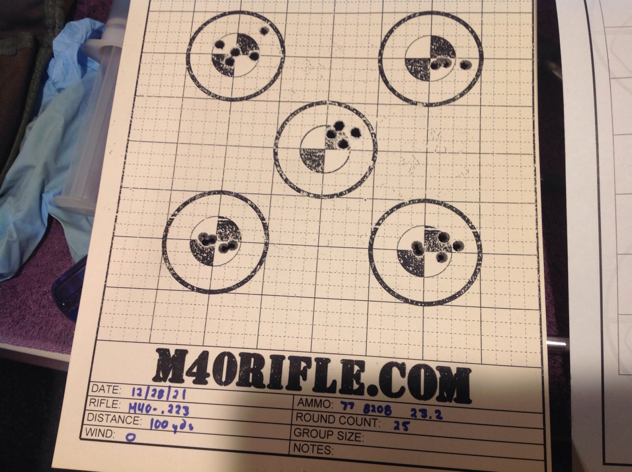

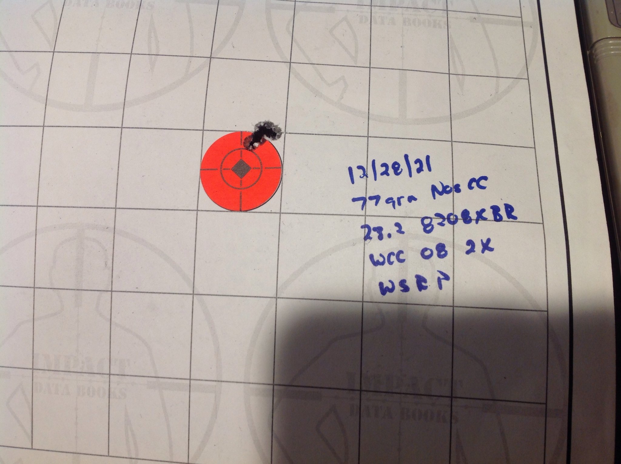

Looks like 23.2 for me this is in the bolt 700.....
I choot them out o' my LMT with 20" barrel too.
Others like 23.3 but I stay safe with 23.2 and diligent mask wearing.
