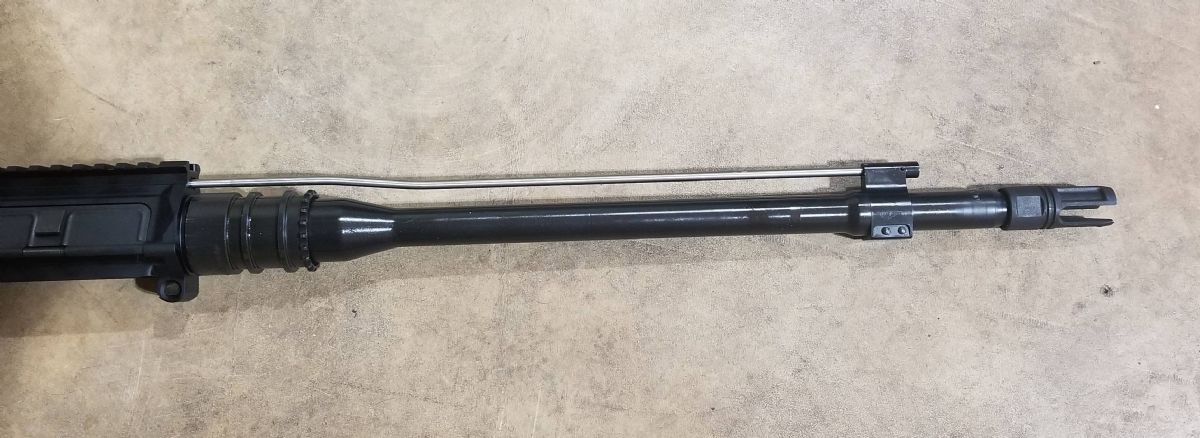

gas tube roll pin looks to be a little further forward than on a std AR-15 gas block. does not bode well for standardized gas tube length? unless that's a really really short gas block. can't say without measurements.

Maybe that stub on the front is the gas tube? I actually think the proprietary stuff is interesting, usually the cheap ARs are just off the shelf parts that they put into a big box, shake it up and out comes a rifle.
I wonder if the gas block body is shorter than a 1" standard. If so, the journal is short too.

GLD's photo looks like they're using a standard 5.56-style pinned gas block and rifle=length gas tube. The little "Wenis" at the end is just to protect the end of the gas tube -- see the gas tube roll pin location.
The barrel "Coning" behind the threads would help taper / center-align a single-point suppressor.

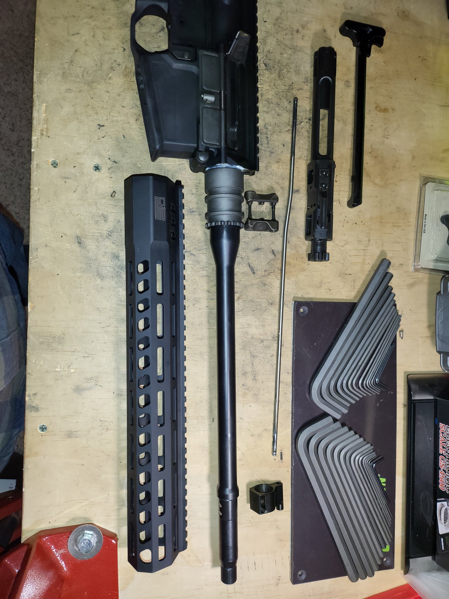

Update on the rifle:

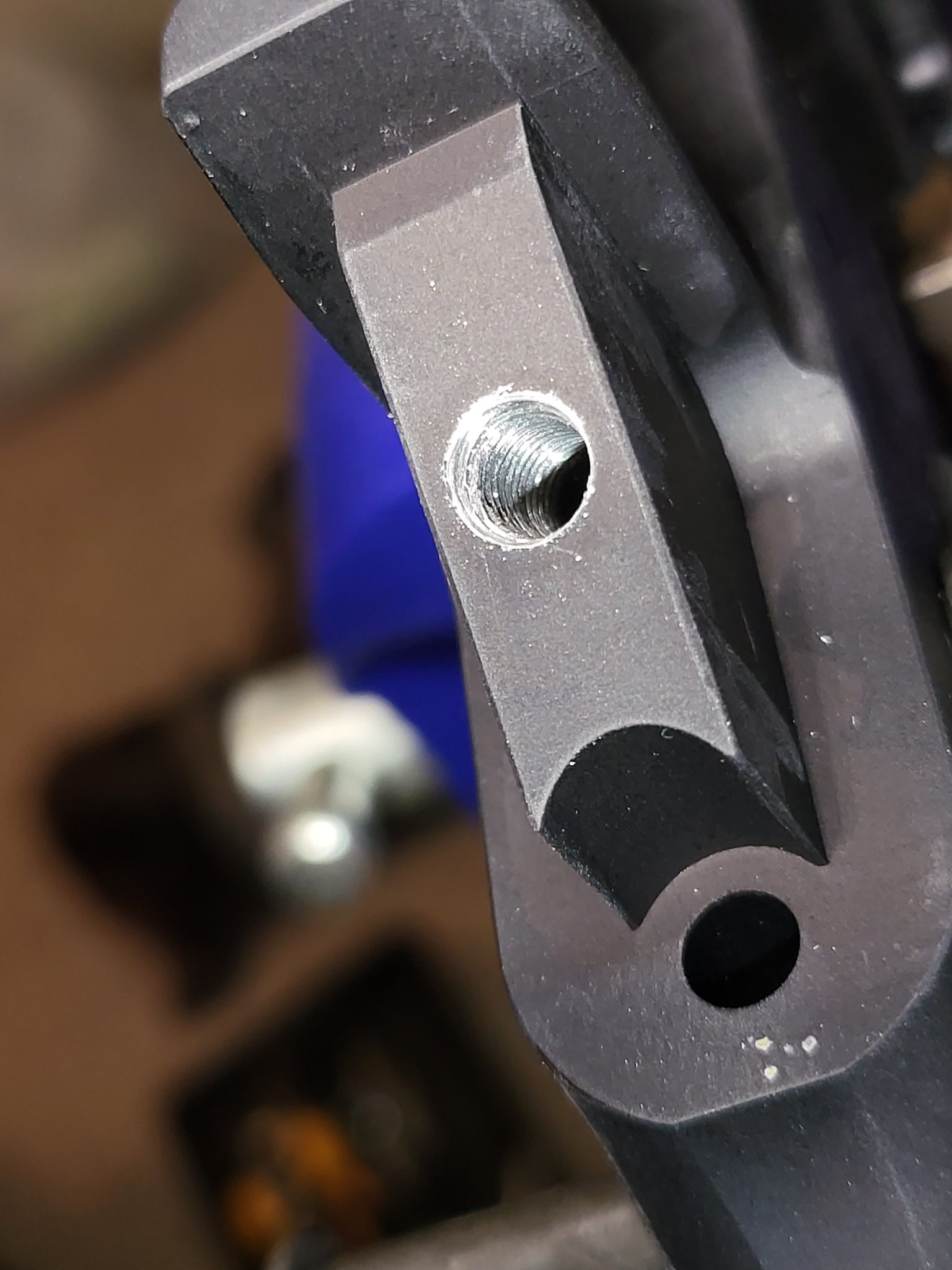

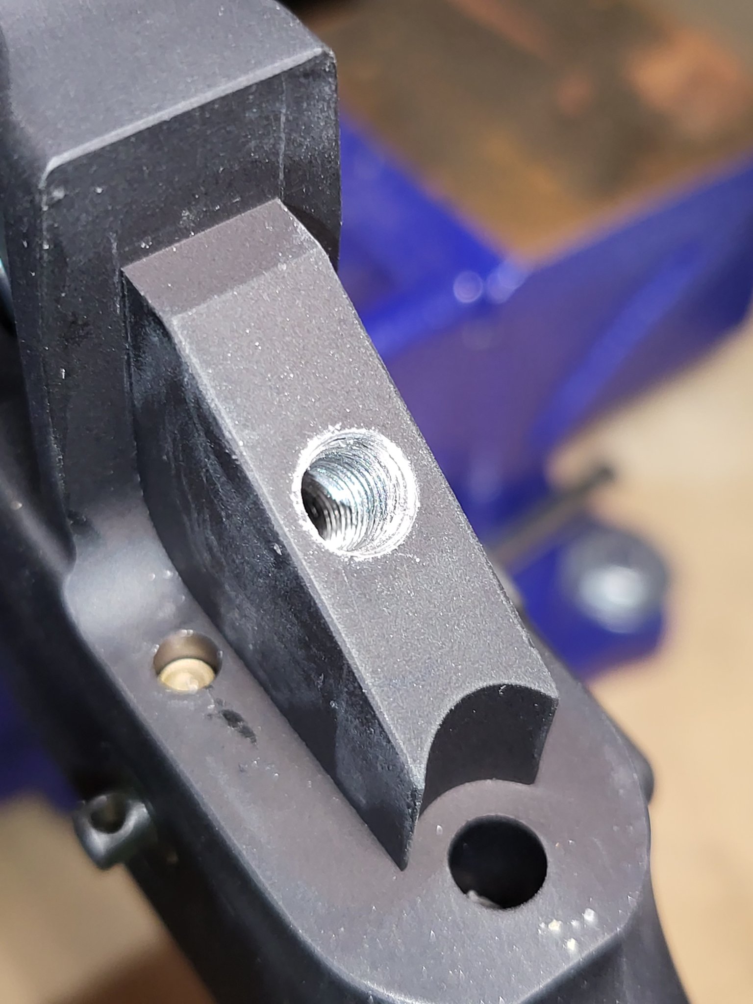

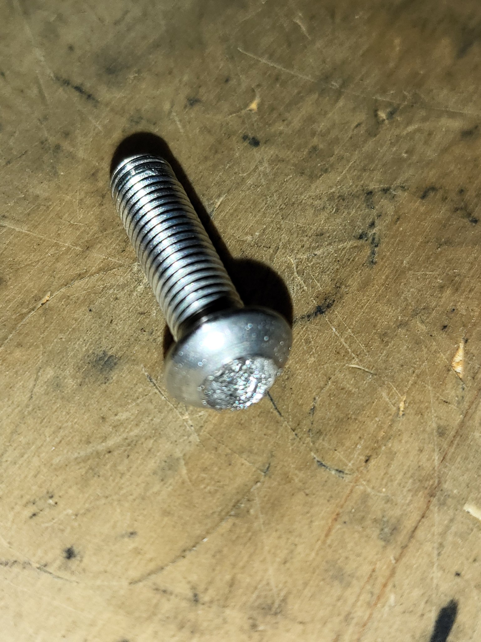

I have not yet messed with the gas block, but I did take the screw out that holds the pistol grip in. Unfortunately this was a button head screw that was cross threaded into the lower.
I stripped the flippity flapping fuc* out of that thing to get it off, to no avail. Then finally reverted to a screw removal bit and it came right out. I called customer service and they answered and promptly made me an account while explaining to me the process of sending back the lower. The return label was free and they said turn around time would be roughly 2 weeks. I assume I'm going to get another lower since this type of problem is not easily fixed, and I don't want helicoil threads in my lower. I have yet to ship it out because I'm currently traveling for work. When I get back I will work on the gas block while they have the lower, and see if I can fit an adjustable one on there. A three and a half pound, single stage CMC trigger is going in once I get the lower back.
I will keep you all updated on the project.

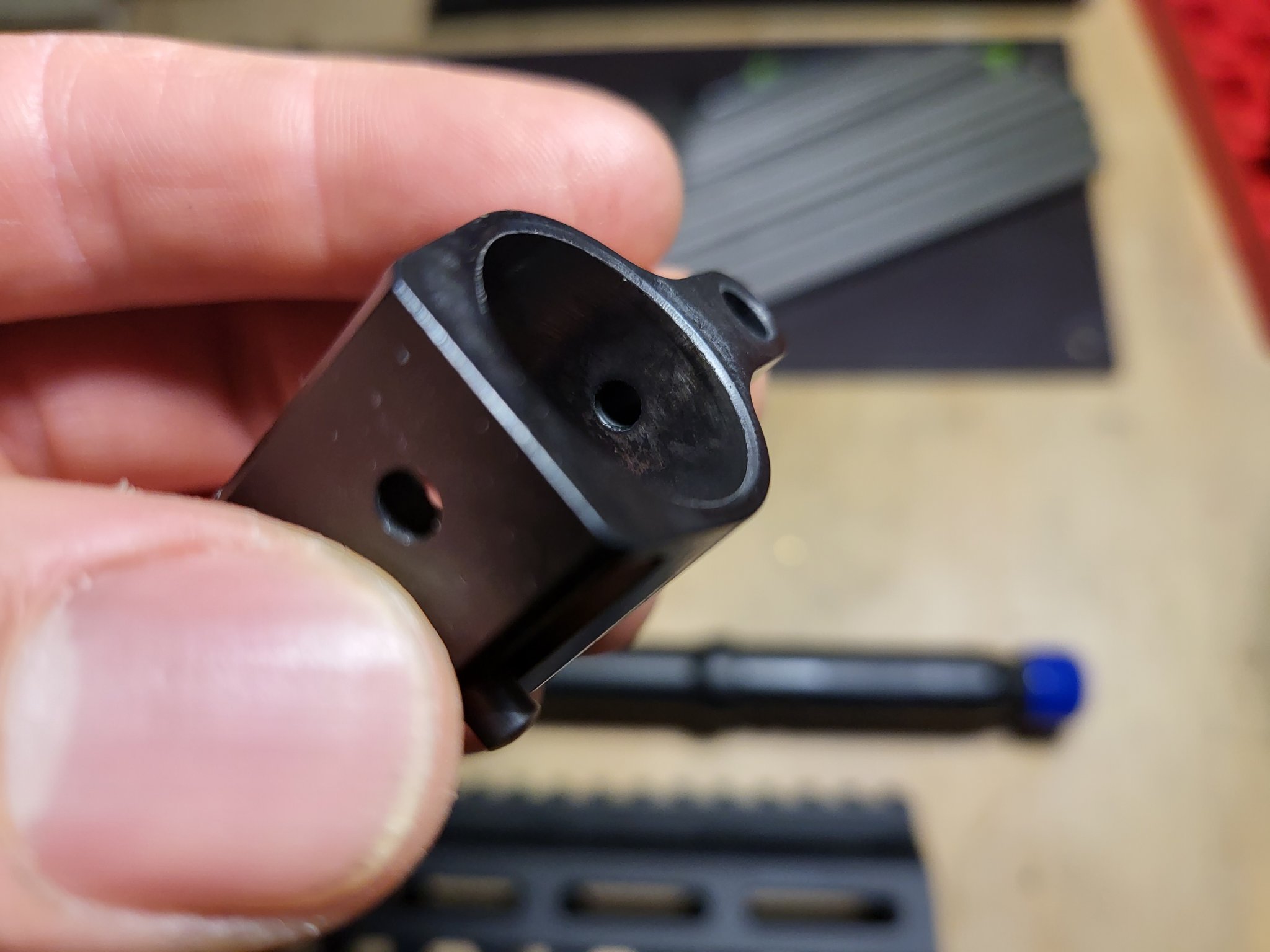

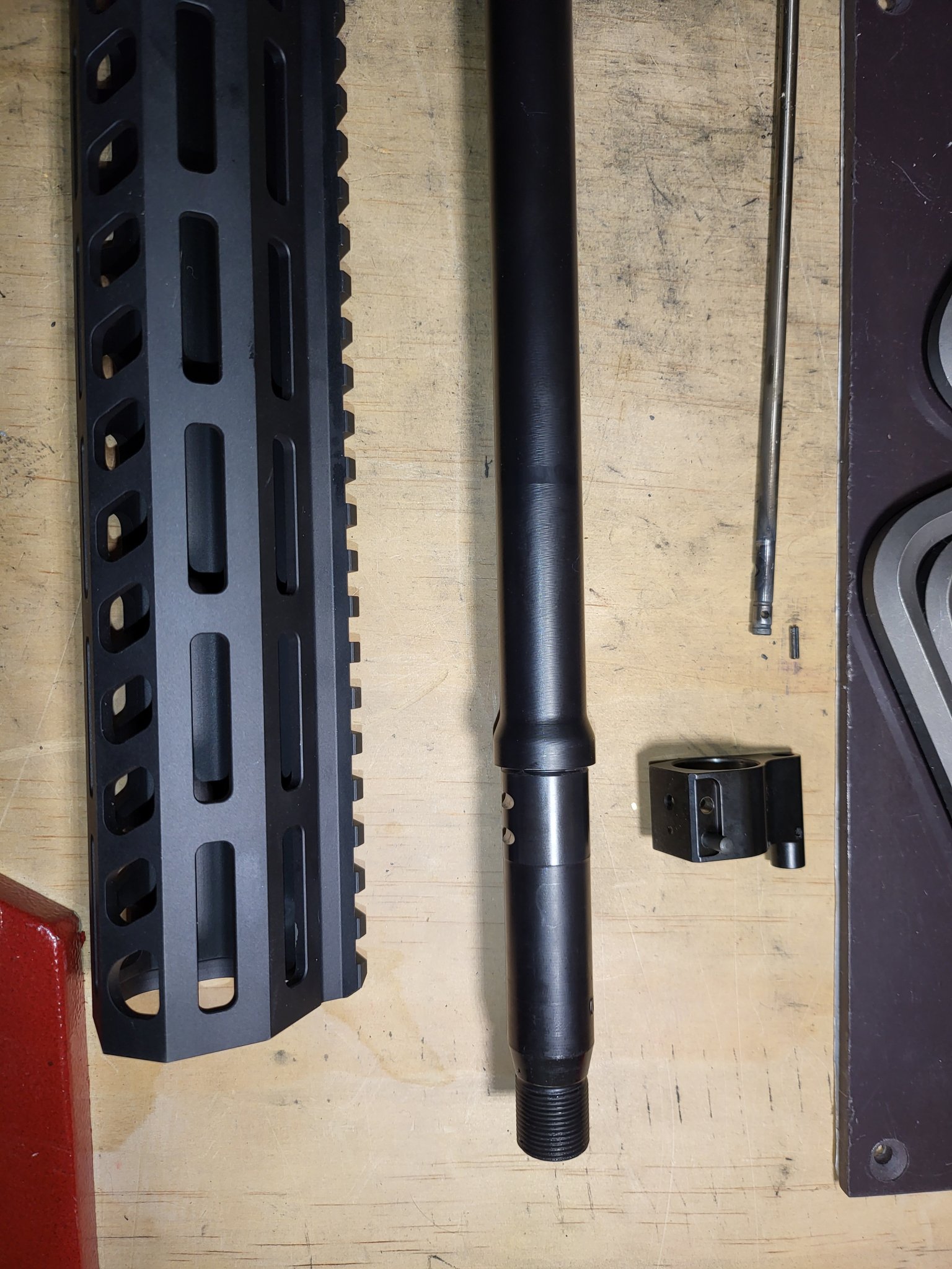

After much dremeling, the pressed taper pins are finally free. I had to dremel them off before I could punch them out. Afterwards they punched out with a 4 lb hammer and a steel dewalt punch tool. The second one went flying after the final blow... It has yet to be found.
I slid a spare Aero Precision .750 non adjustable gas block on to see if it fits, and it is a tiny bit loose. Usually gas blocks are a little tough to slide on but this one spins around too easily. So, I will be Installing the clamp style adjustable gas block from SLR, the Sentry 7. When I get that in I will install it and update the thread. Here are some other pictures for those who are curious as to what the barrel looks like after the gas block is off.
While it sucks the screw was cross threaded, a properly installed heli-coil is actually stronger then aluminum threads.
snip....
It's probably best to to use a clamp-on GB anyway. Set screw blocks on previously drilled taper pin holes can be a pain.

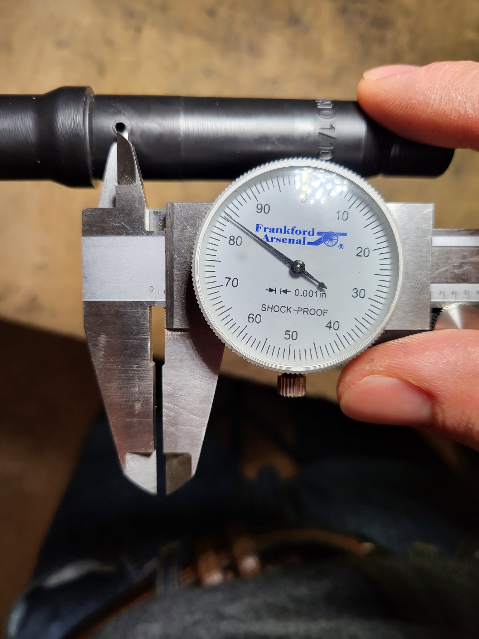

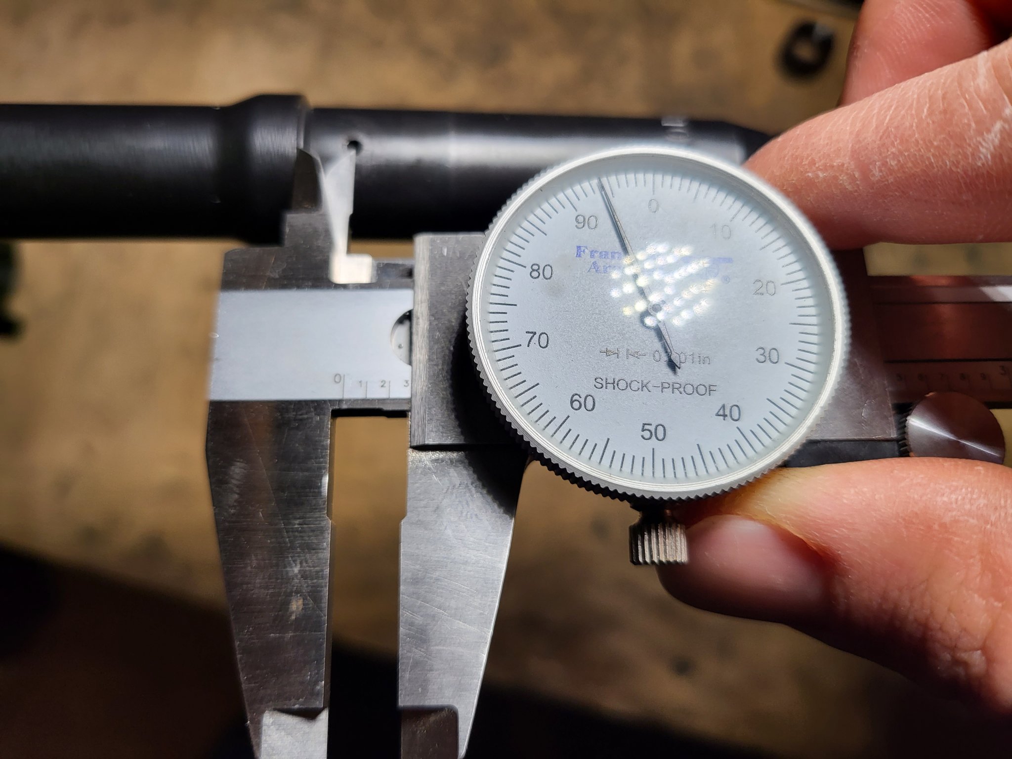

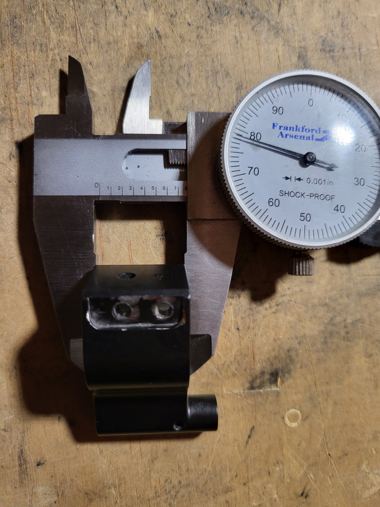

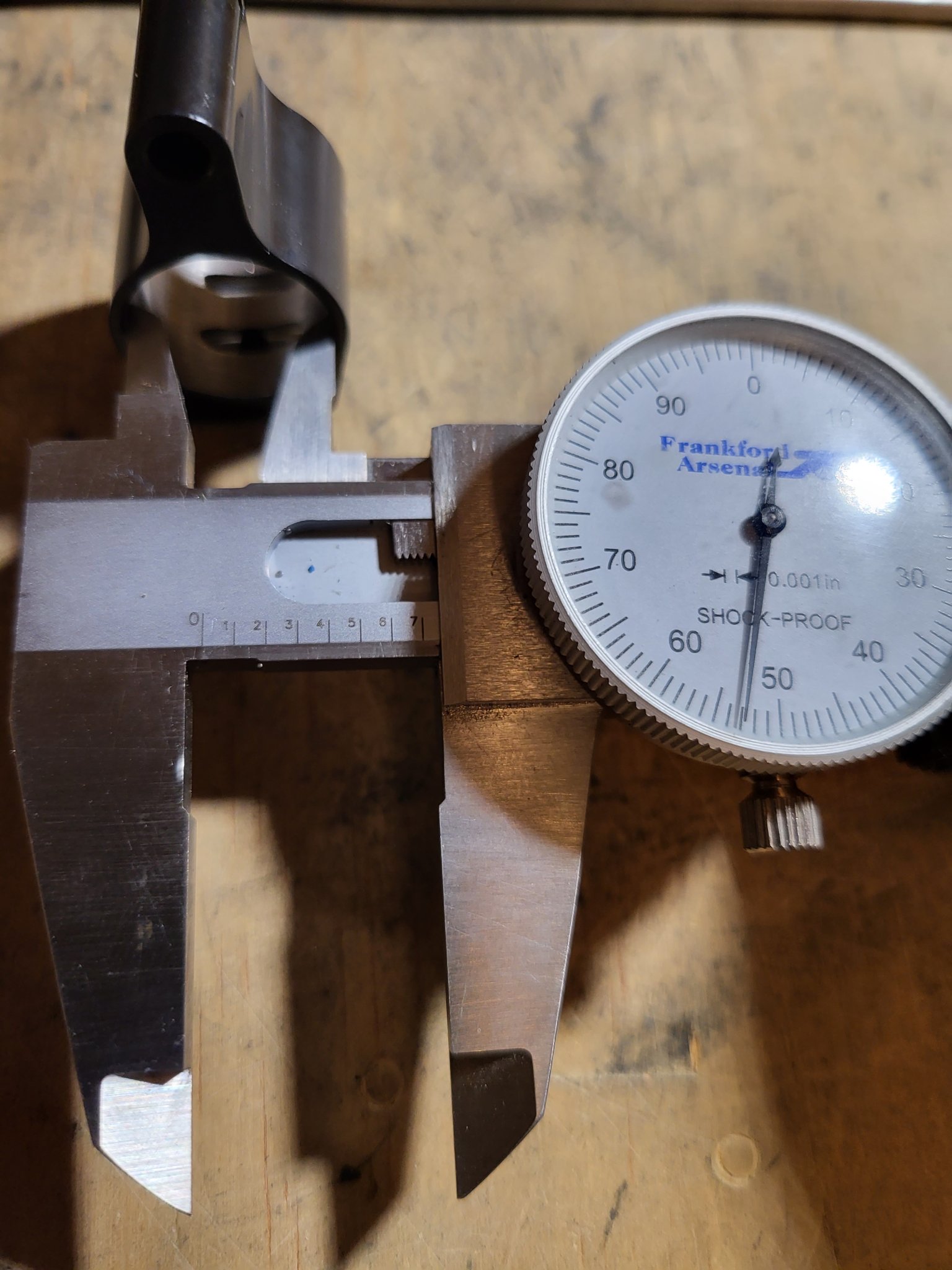

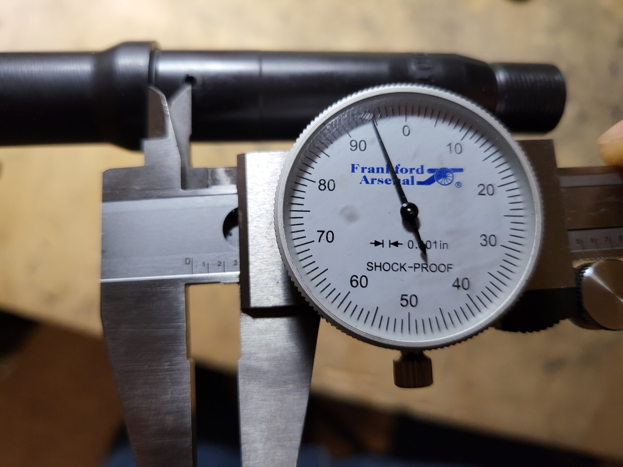

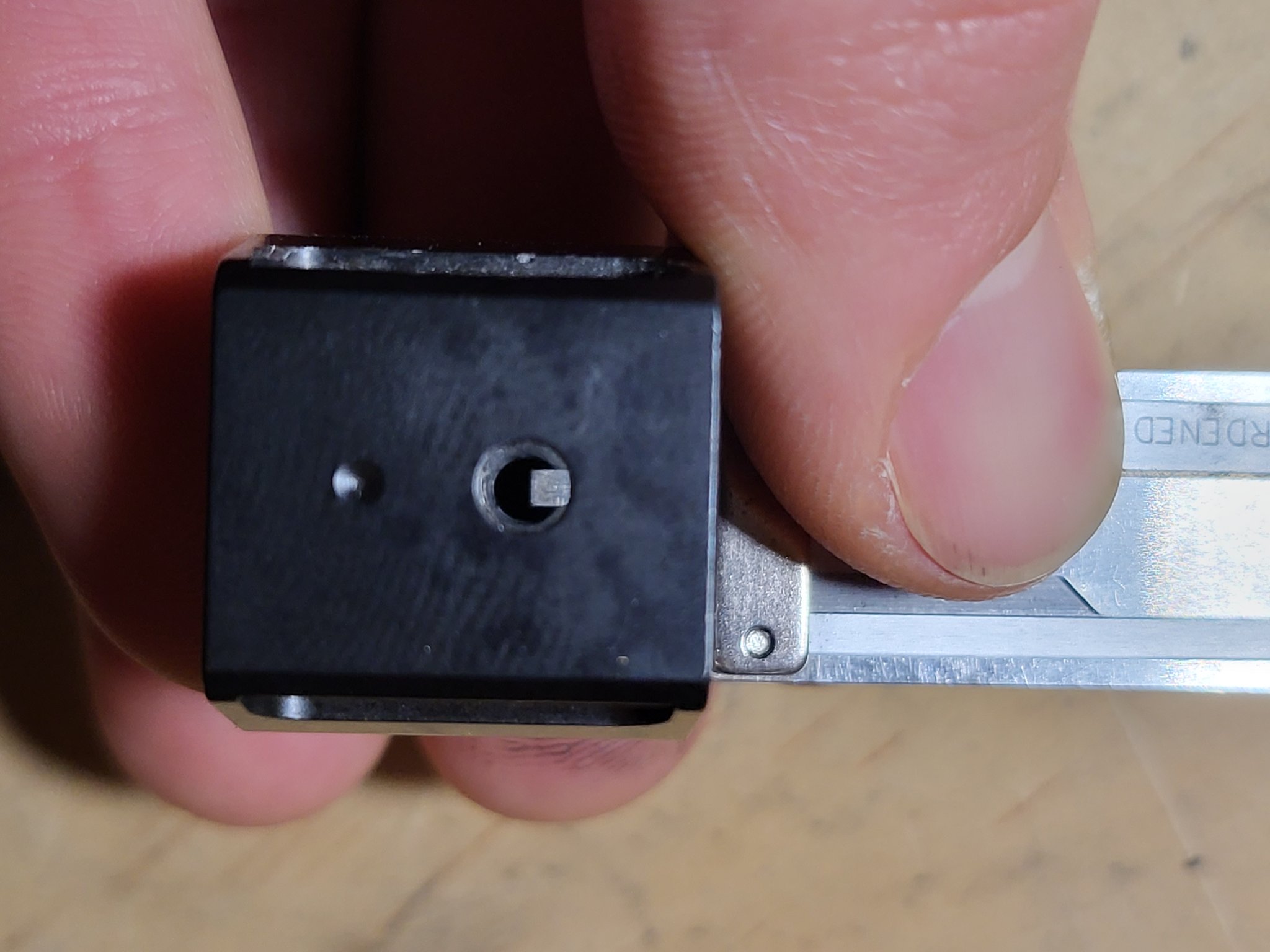

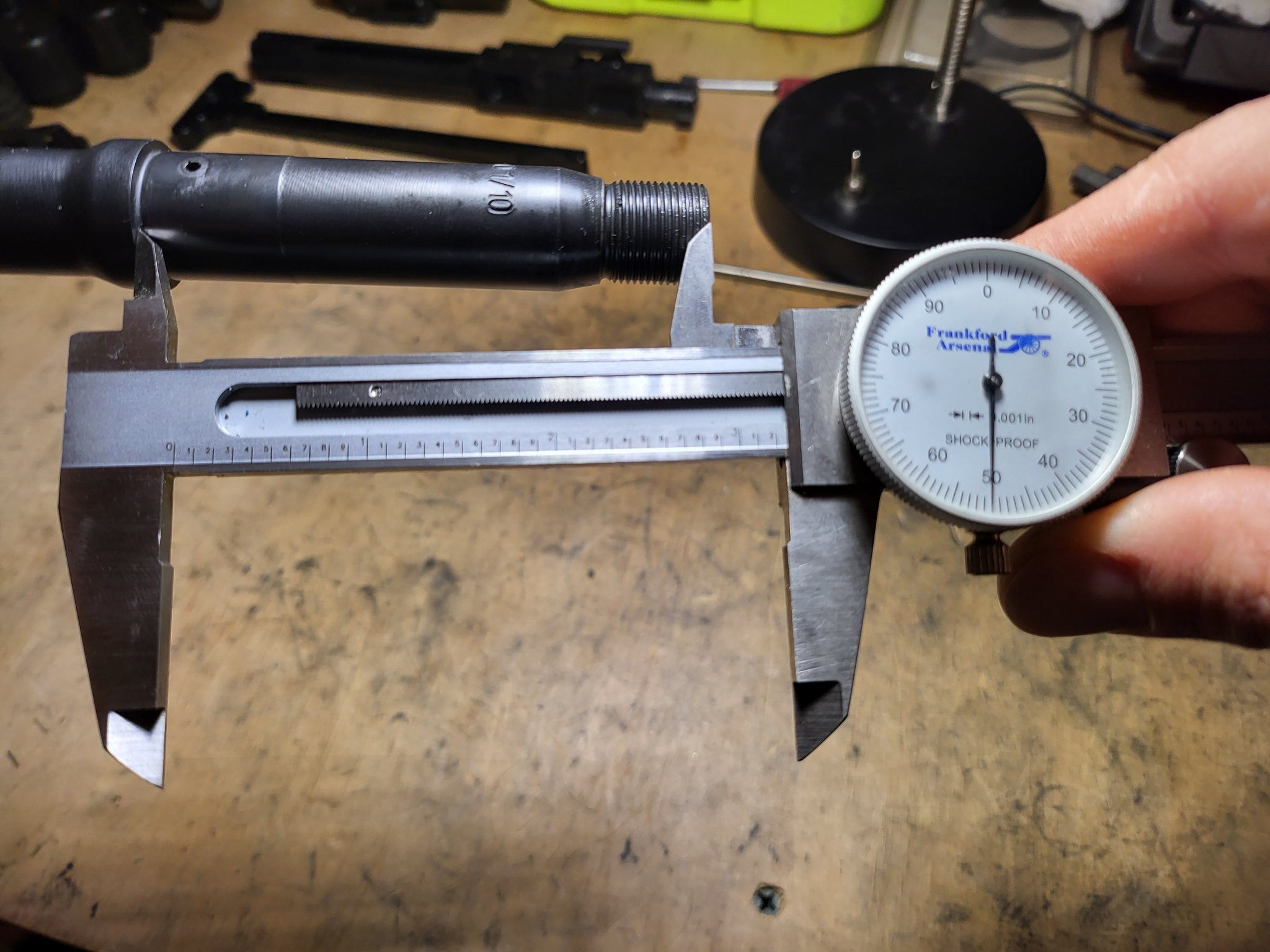

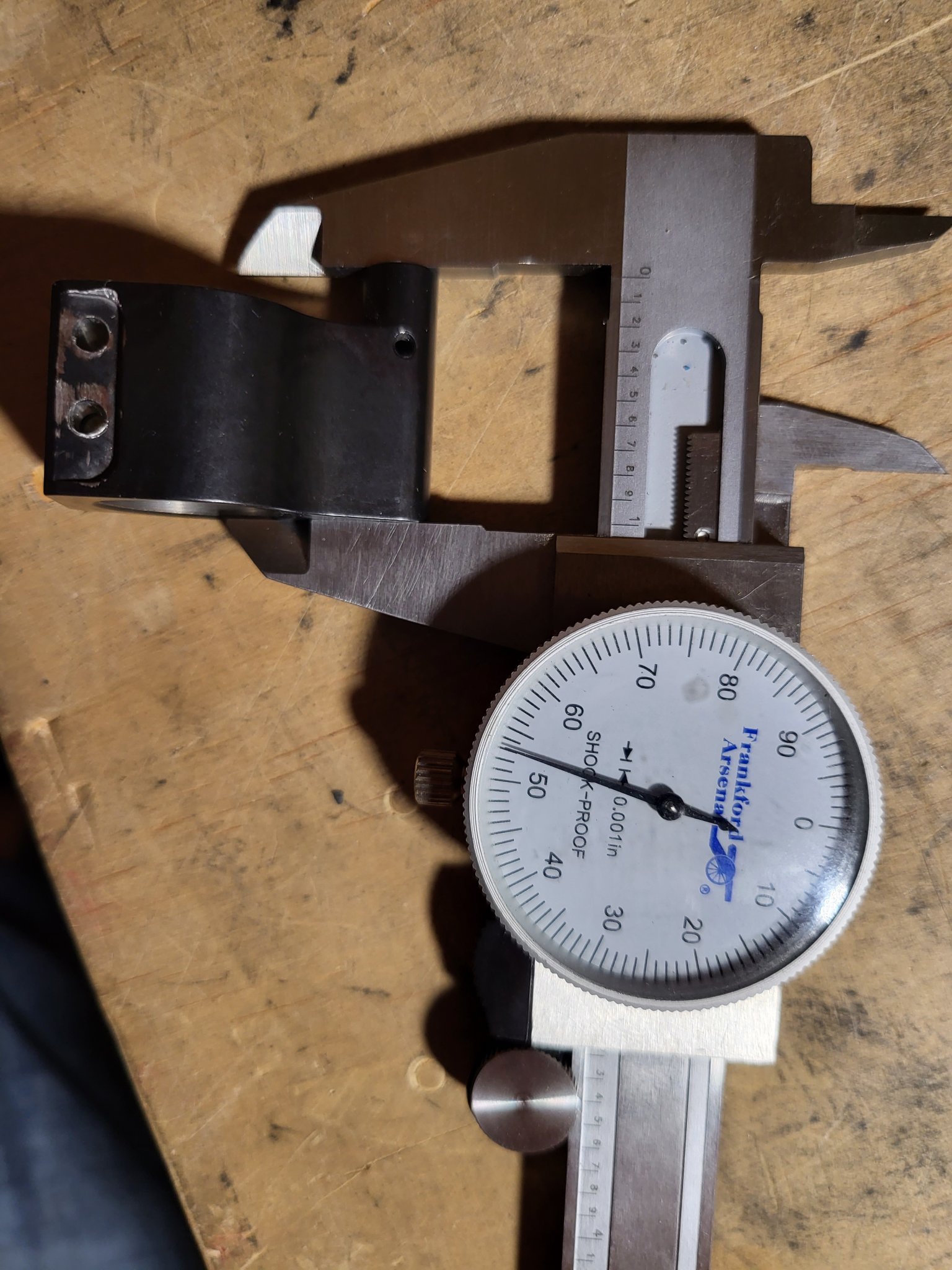

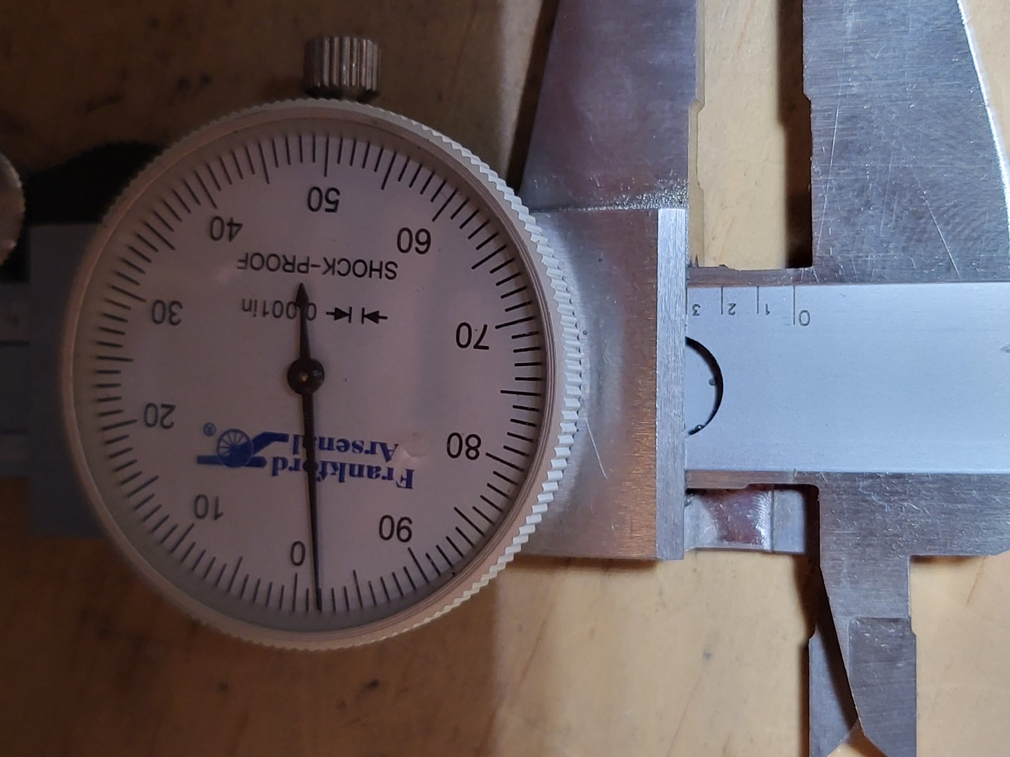

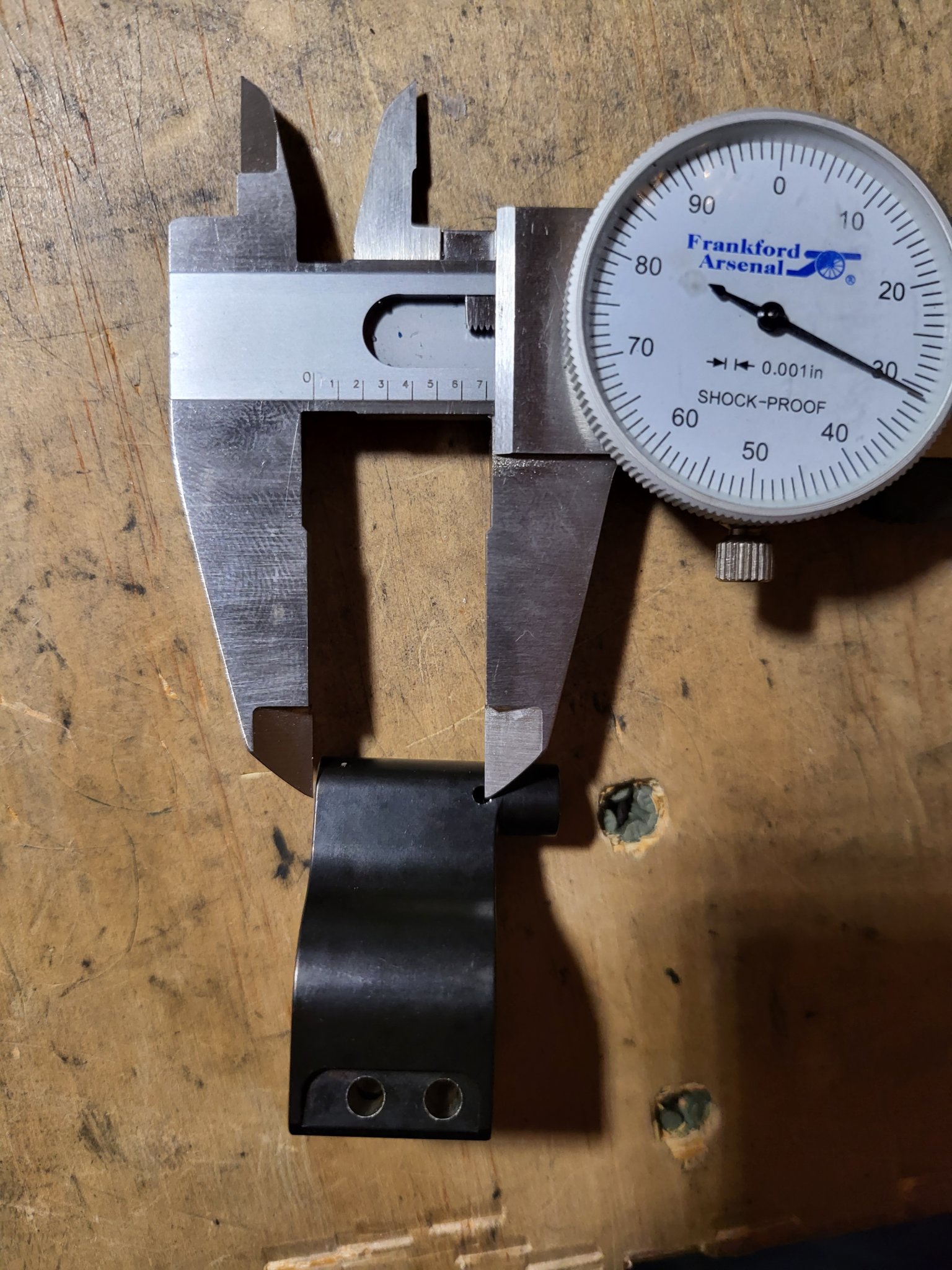

It would be nice to know a few measurements if so inclined, but you would need calipers, etc :
Gas journal length and diameter
Gas port diameter
Distance from shoulder to center of gas port
Distance from shoulder to muzzle
Gas tube actual length
Reactions: Hunters Mark
Gas tube length is 15 and 1/8 in
Distance from the shoulder to the center of the gas port is .3 inches from the rear of the gas port (most proximal side when installed)
Gasport diameter is .137 inches
I assume the gas journal length is this measurement?
Gas block actual length:
Gas port diameter:
Shoulder to muzzle: 3.25 inches
Hopefully that gives people some insight.
