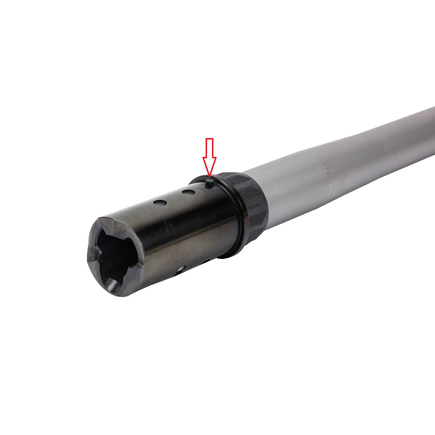

Hey I'm about to attempt this barrel swap, but what did you mean by the "dowel pin"? Do you happen to have a picture of it? TIH
The aluminum receiver, specifically the area that mates with this pin is a weak point. Do not put any pressure on the receiver in any way. This part of the design is definitely disappointing.
