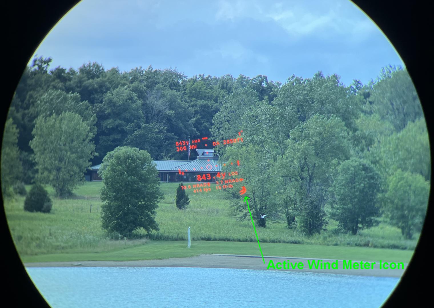

The weather meter and the binos can communicate directly between each other. They do not need the phone to be on as an intermediary. Once the binos and wind meter have been paired using the app, turning the wind meter on while ranging will automatically substitute it's wind speed value in place of whatever value had been entered in the app. When it does this, a wind symbol will appear instead of the mph number you had typed in. I can't say this is an ideal solution as it doesn't give you any display of wind speed at any time so that you can see what it is fluctuating between but that is how it works. It takes the wind speed if it's on at the time you range a target and uses that speed in the ballistic calculation. As for the strength of the connection between the meter and the binos, yea it's a bit shaky. Very short range.

1) Pair both the rangefinder and weatherflow meter in the Sig app. This is a one time thing and does not have to be done when your actually out ranging.
2) Turn on the binos
3)Turn on the Weatherflow meter
4) Hold the Weatherflow meter correctly oriented to the wind the directing it is blowing and the direction you have entered for wind directing in the binoculars menu on wind. It needs to be held this way when you perform the ranging as it is at that time the binos query the wind meter for the wind velocity. If it worked, and the connection is not super strong so sometimes it dosen't, the wind meter symbol will appear where the wind speed usually does in the bottom right corner of the post ranging HUD.
