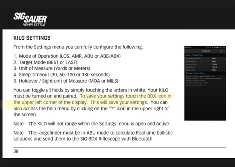

    Also, try the highlighted instruction. Its possible you overlooked this step.

    Tried this again... followed @Powder_Burns directions carefully. This time I used my phone. That seems to control the bino timer as long as it remains connected to the BDX app AND in ABU mode. However, if I change mode or turn off the app, no control. If I go to ABX mode and connect to kestrel - timeout in <15 seconds.
    This time I tried with the app on the phone. Previously was using the app on an iPad. Doesn't seem to make a difference on my unit.
