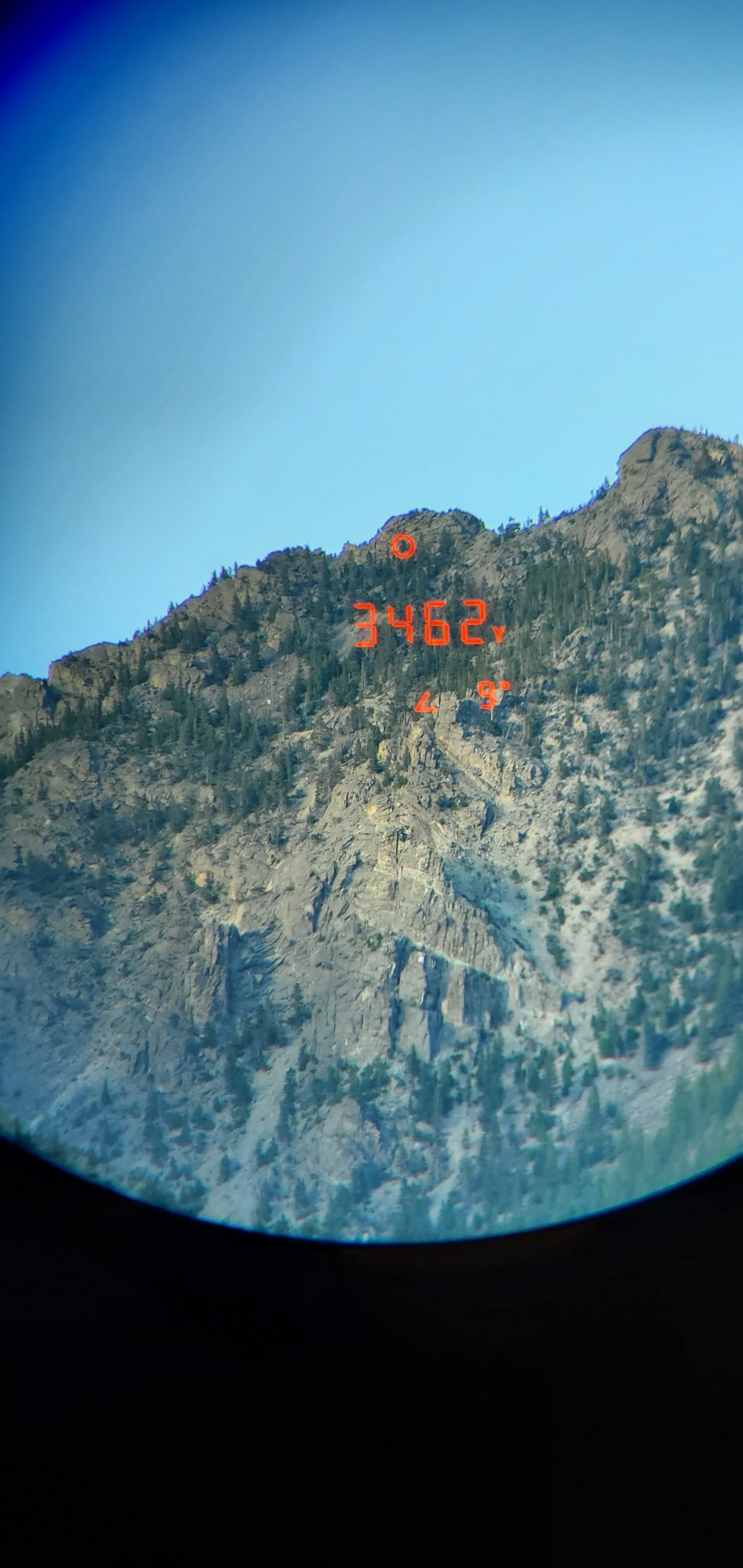

  • Furthest range I could get in broad daylight was 4770 yards. Inside 2500 was a hit every time. Around 3300 is where its starts getting spotty.

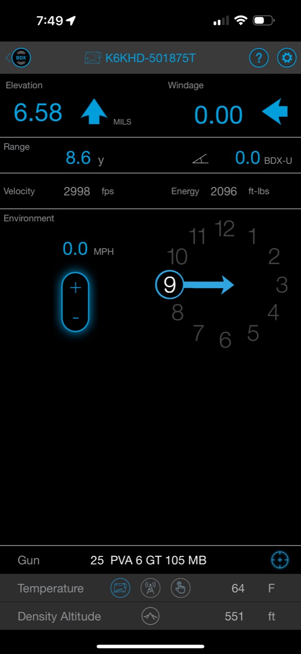

Anyone else have there 6k not show solutions in the binos in ABX mode? It shows the drop on the kestrel and even the bdx app but the binos only show range and angle.
