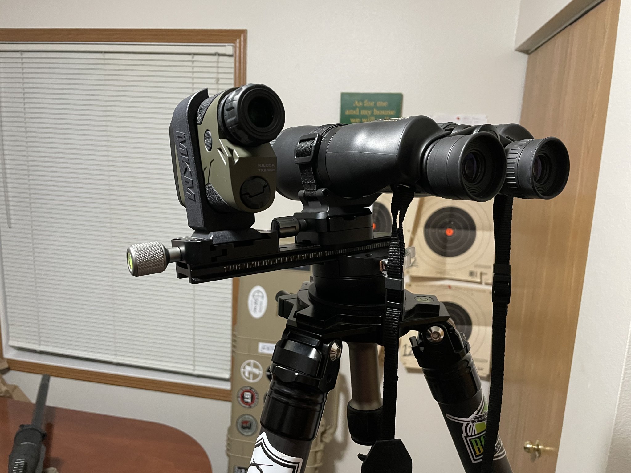

The Sig Kilo mount works great from MKM machining. Ill attach a picture. Ignore the cheap bino’s, waiting for my backorder of Meopta’s B1 Plus’s 15x to ship from Doug at Cameraland.

I’ve been emailing MKM about their mount, they don’t know if it will fit and asked for a few measurement. Thanks for posting the pic of yours, I’ll look into it as I can always use the RRS for binoculars.
