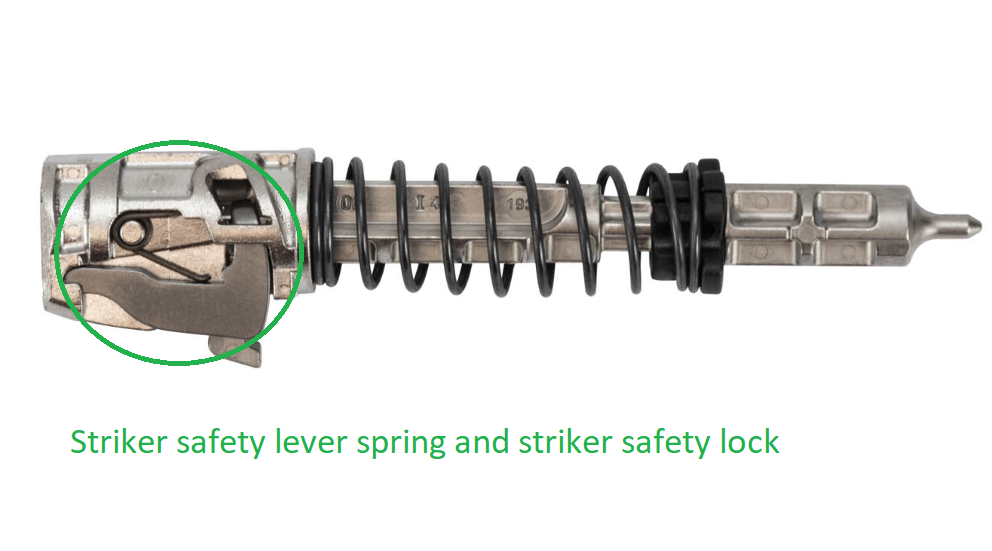

Interesting that he says Sig said it was a failed firing pin spring.

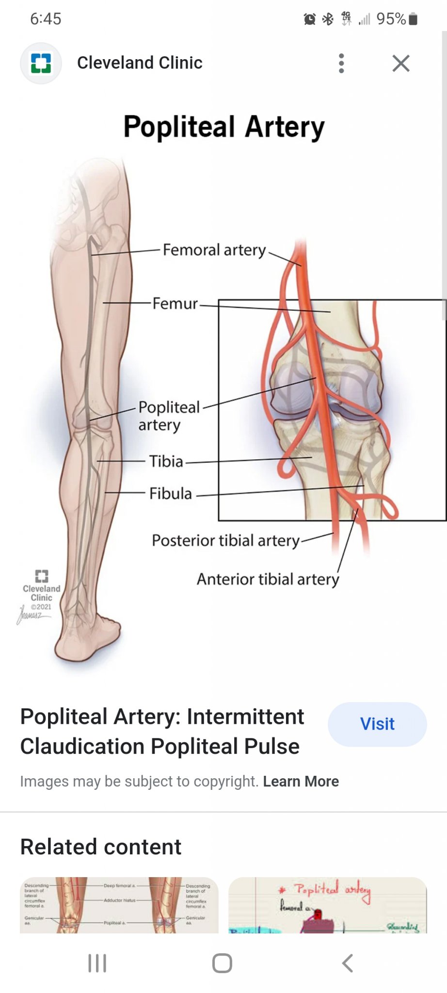

I carry appendix but I don't carry a gun that is 0.1mm away from shooting frank or my femoral artery.
Who the fuck carries AIWB with a gun pointed at the femoral artery?
You'd have to have the gun at 2 oclock for that to happen and then the holster would dig in your thigh mercilessly every time you sat.
Do people even know where the femoral is?
SMFH

Yes thank you. My holsteted pistol never points at the center of my legs which is where the artery is. It doesn't even point anywhere close to my legs.
Not afraid of my junk either because it's behind the holster. So unless you walk around with a boner all day your dick and balls will be fine too.

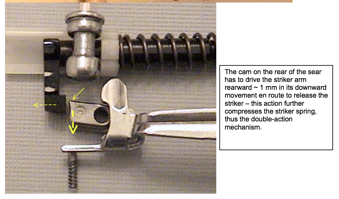

I think the firing pin spring and striker are held in full compression/retraction on the 320, no? So that would mean 100% of the energy to fire is stored and retained by the sear and various safeties. I'm not sure about that, but a brief search seemed to indicate that.

It was mentioned in the video about some safety spring being defective but there's probably more issues than just that (in my opinion). If the striker safety lever spring (part of the striker assembly) couldn't return the striker safety lock (also part of the striker assembly) into a blocking position to prevent the striker from moving forward and sear slippage occurred the striker would fire. However, the new style P320 sears have an additional safety element to it that should catch the striker should there be a striker safety failure sear slippage. If the person in the video had the old style single ledge sear in his P320 X-Five, that would explain his experience. If he had the new style sear, then there are a whole bunch of other stuff that could've been wrong.

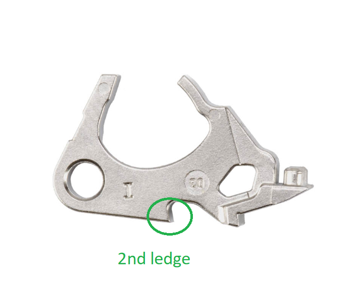

New style sear with second ledge.
Striker assembly
M&P are that way I believe.
Yes, both P320 and M&Ps are that way. The trigger pull itself does not compress the striker assembly any further and simply moves the sear downwards to allow the striker to fire.

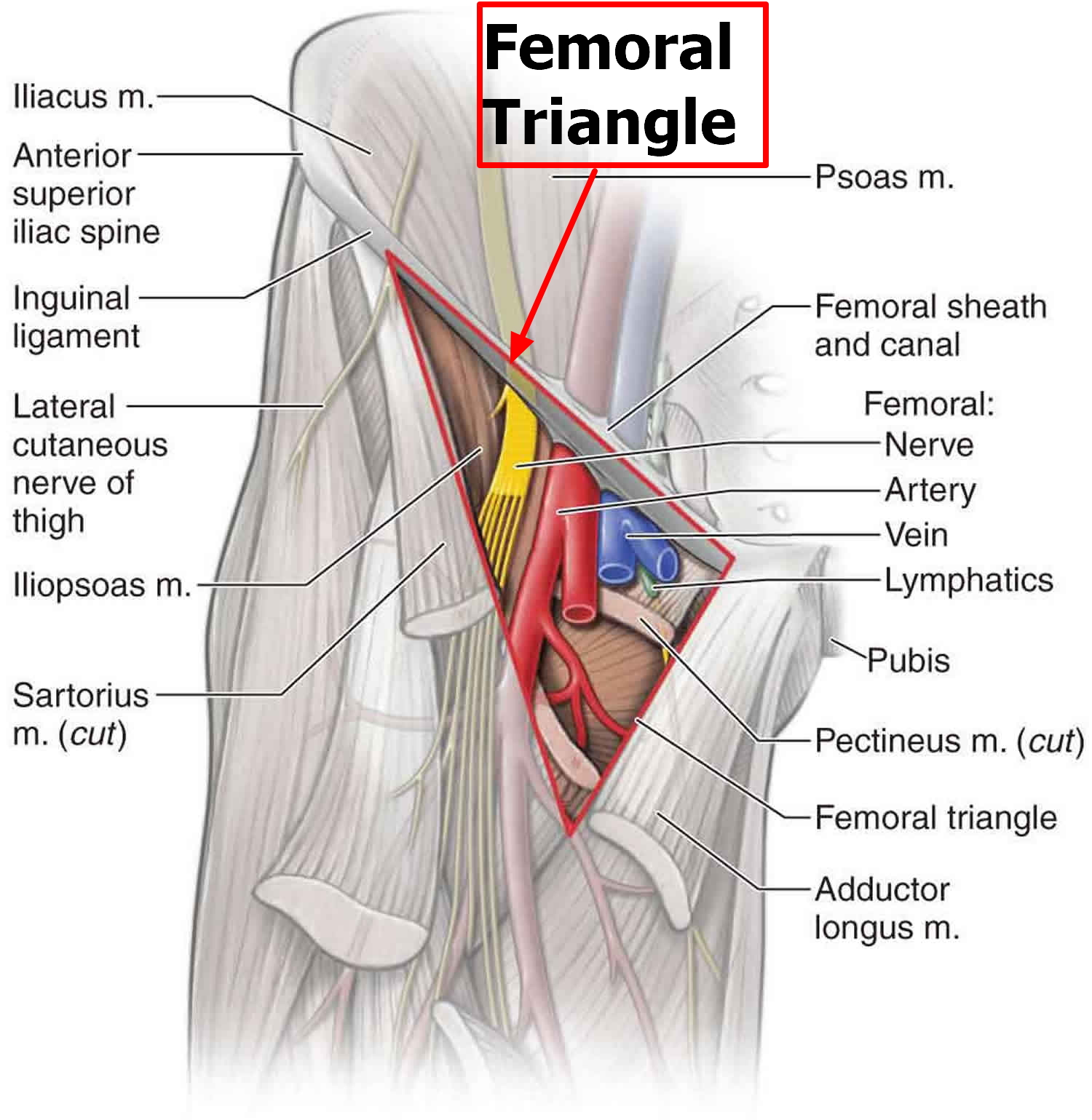

SMFH

I do know where the femoral artery is. No, my gun is not typically in a position that points the muzzle at the artery or my junk, but there are positions where it can happen.
You are correct.

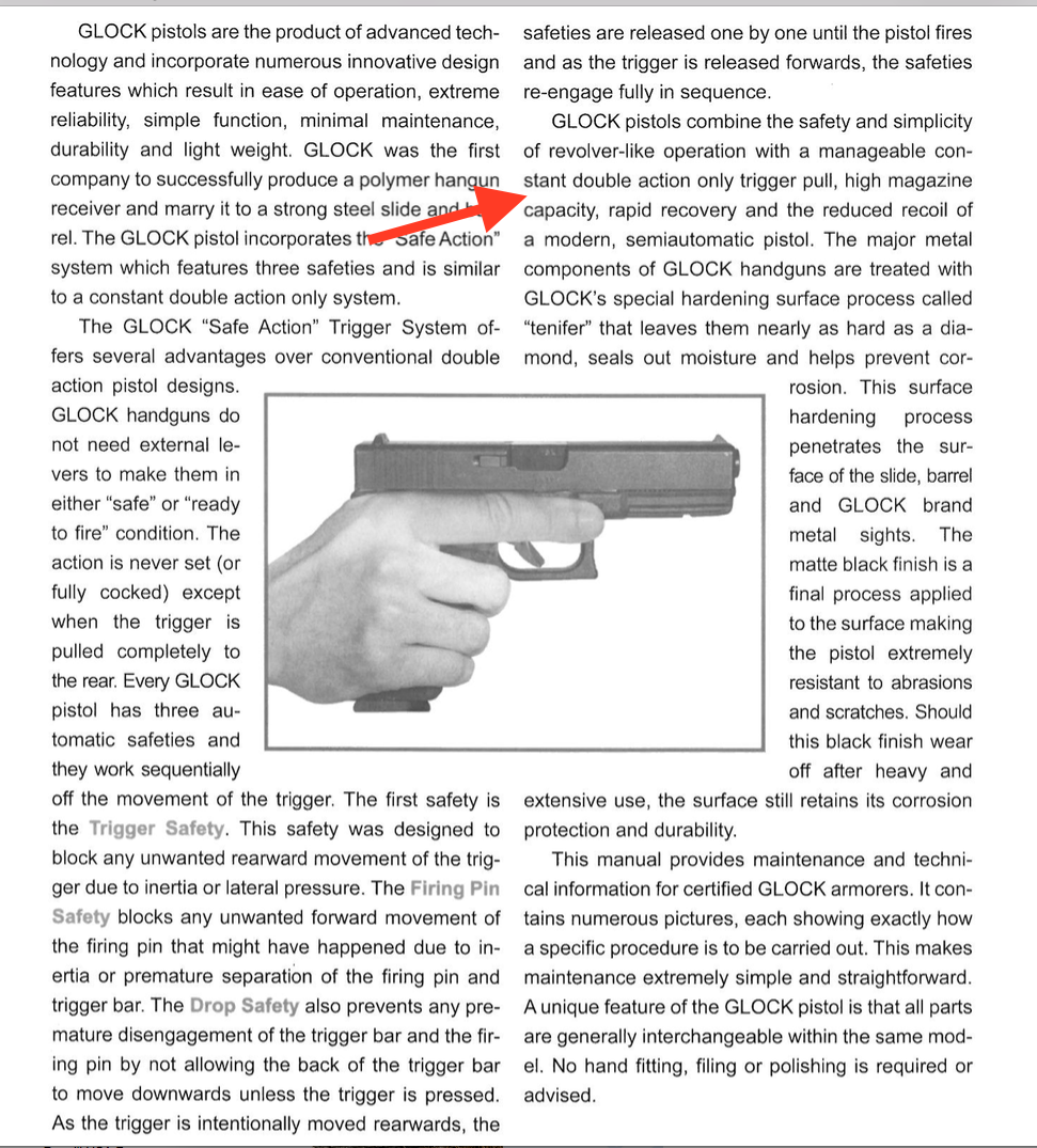

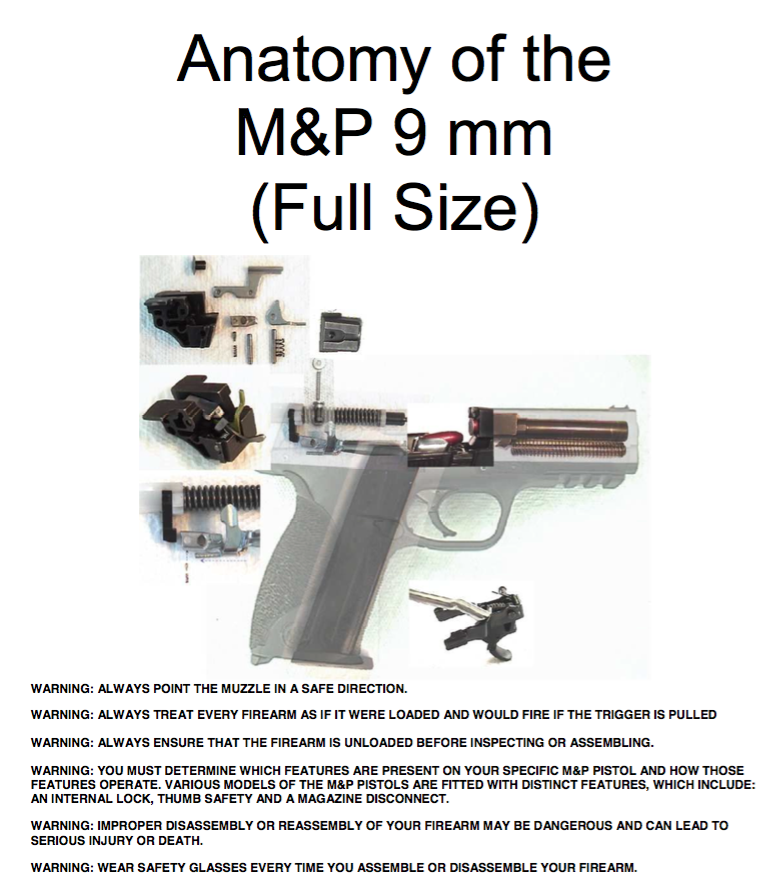

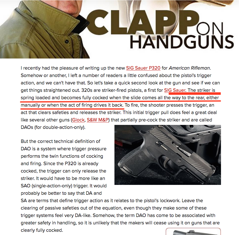

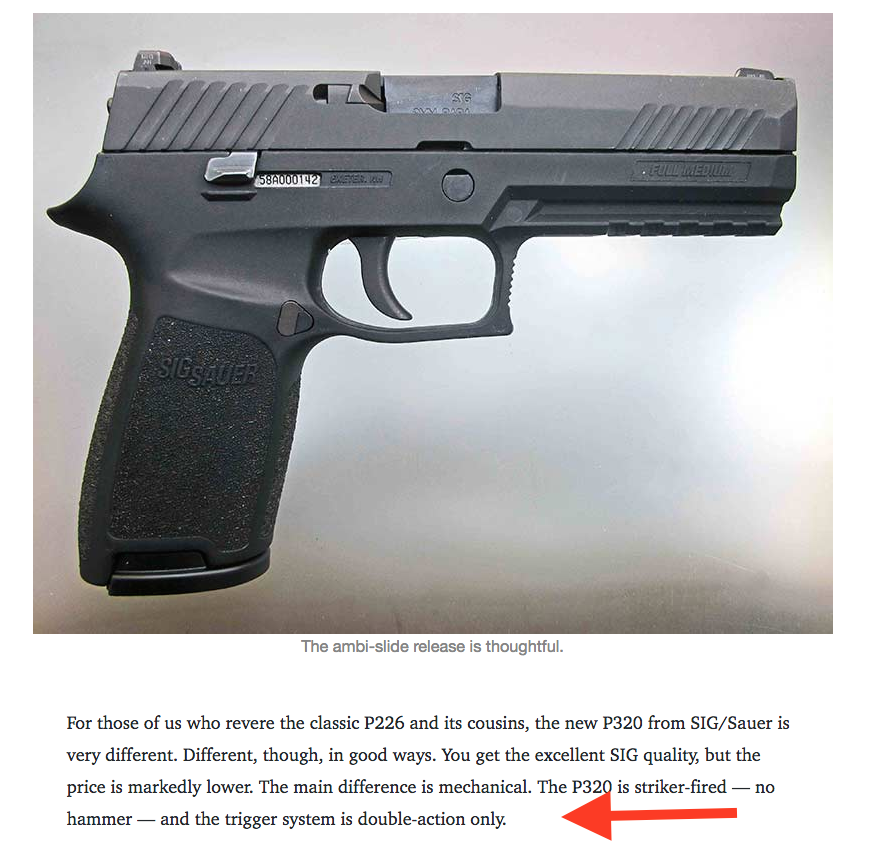

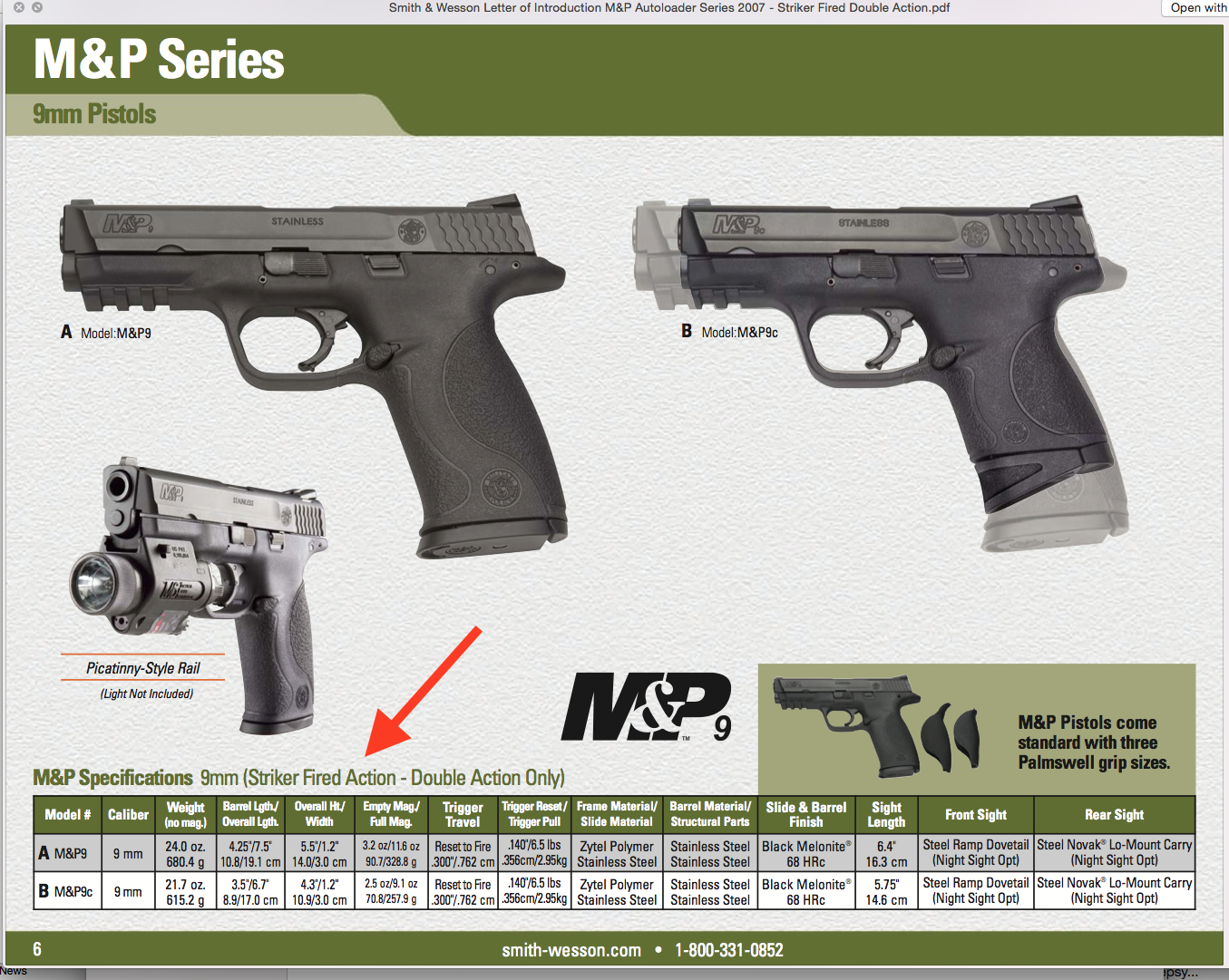

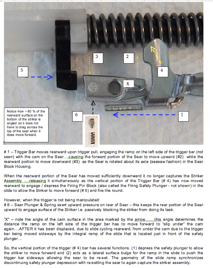

The M&P series, Glock's and Sig P320 are all designated as Double-Action-Only fire control mechanisms.
The striker is cocked 95-98% when the slide is in full battery. The trigger manipulation drives the sear mechanisms on to the arm of the striker to compress the spring 100 % before the sear mechanism releases the striker forward; all striker plunger blocking mechanisms have simultaneously been cleared from the striker path movement during the trigger pull manipulation.
M&P catalog. Glock Armorer Manual. American Rifleman.
Anatomy Series M&P Manual I authored.
Reactions: Fig
View attachment 7980669View attachment 7980670View attachment 7980671View attachment 7980672View attachment 7980674
Okay...
