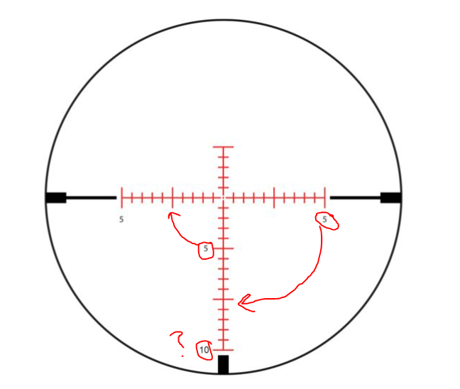

So i found this picture.
I can't make sense of the subtensions?
There was some WTFing about that awhile back too, nothing came of it though other than noting how screwed up and nonsensical the reticle is. https://www.snipershide.com/shooting/threads/perfect-ar-scope.6967261/#post-8049692
On the horizontal, if the labeled 5 mil mark is out on the end then that means they are 1/2 mil dashes with a larger dash at the 2.5 mil value.
On the elevation, its all fucked up. If its a 1/2 value as one would assume based on the windage then it is labeled way wrong. The 5 would actually be 2.5 mils and the 10 would actually be 7.5 mils.
If they are actually 1 mil holds then the 10 as labeled would actually be 15 mils.
Nothing about the reticle makes sense when you sit down and look at it.

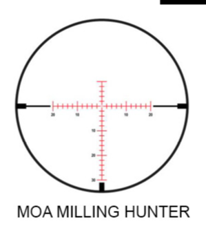

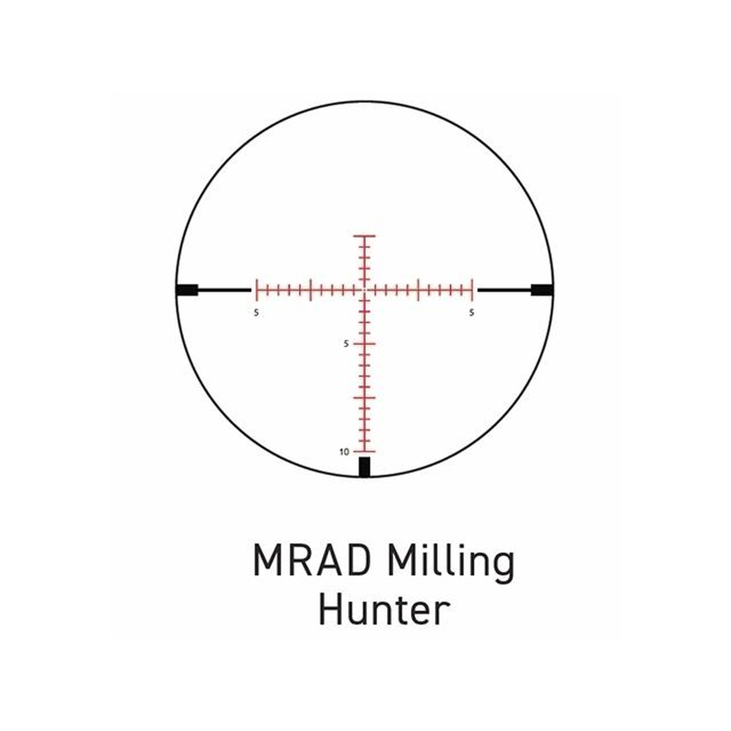

Edit: I can find that they offer a MRAD milling reticle SKU on the website still but I cant find any pictures of the reticle though. Elsewhere its either the fucked up one (optics planet) of they have the moa reticle shown instead (eurooptic)
MOA version looks fine with 2 moa dashes

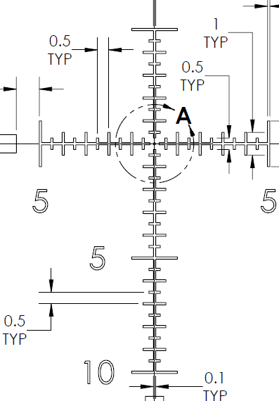

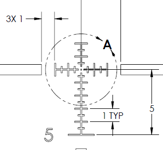

So I got in touch with SSEO and this is what they sent back.
3-15 and 2-10 reticle:
5-25 reticle:
The above abortion was a doctored MOA reticle that one of the distributors put up on their web page.
